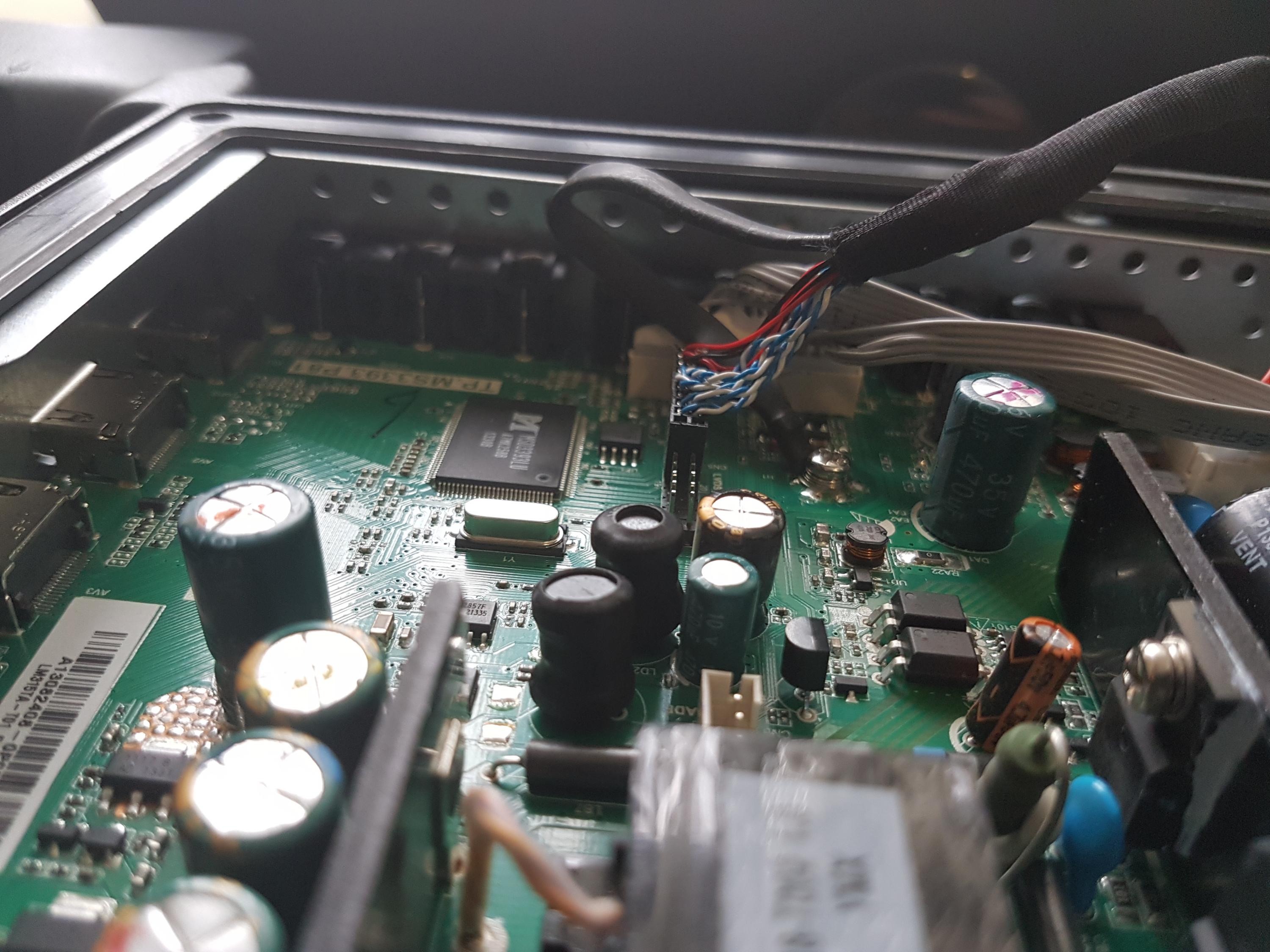

      When it's NOT working do the following:
      Measure the voltage over the big black capacitor.
      Measure the voltage at the LED output connector (little white one to the left (2nd pic))
      If you have an oscilloscope take a screenshot of what happens at this connector when you try to start to the TV. If a LED is defective it may just give a very short pulse and then shut down.
      Post your findings/measurements here.

        I noticed when i bend back and forth the board near the 110v in, Tv works fine...i redid the solder even popped it in the oven for 10min like we do in I.T. with laptop motherboards and still same issue, bend the board near the 110v in and it works, bend it some more and it doesn't..

          Tv turns on fine sometimes...and it works flawlessly but other times it does not turn on at all, I don't have an oscilloscope unfortunately, i'm wondering if it could be bad caps that work intermittently?

            From your last two posts it definitely looks like a poor solder joint if flexing the board makes it work/not work. Get the magnifier out and resolder all joints once more. Look for a crack in the tracks.

              I redid most of the solders and even put the board in the oven..yet no luck none of the capacitors look bad, and the coils seem ok as well...weird

                transformer wire issue where its soldered to the legs that go through the pcb? the part you cant see unless you desolder the transformer.

                  How about the 470 capacitor in the picture (on the upper right side near the wires), does it look ok to you? Thx

                    hard too say in the pictures but does look slightly domed can you remove and test if you have a esr meter also the multi strand wire connector lvds just in front of that capacitor is that fitted right? on all the pins the picture may just be deceiving

                      I believe the problem was the 2 capacitors, i changed them and tv started working more regularly but looks like i de-soldered the old caps without the right tools so now the little spots where i am to solder the capacitor's legs are damaged it seems, i attached 2 pictures of the crappy soldering job i did, was wondering if there was a way to repair
