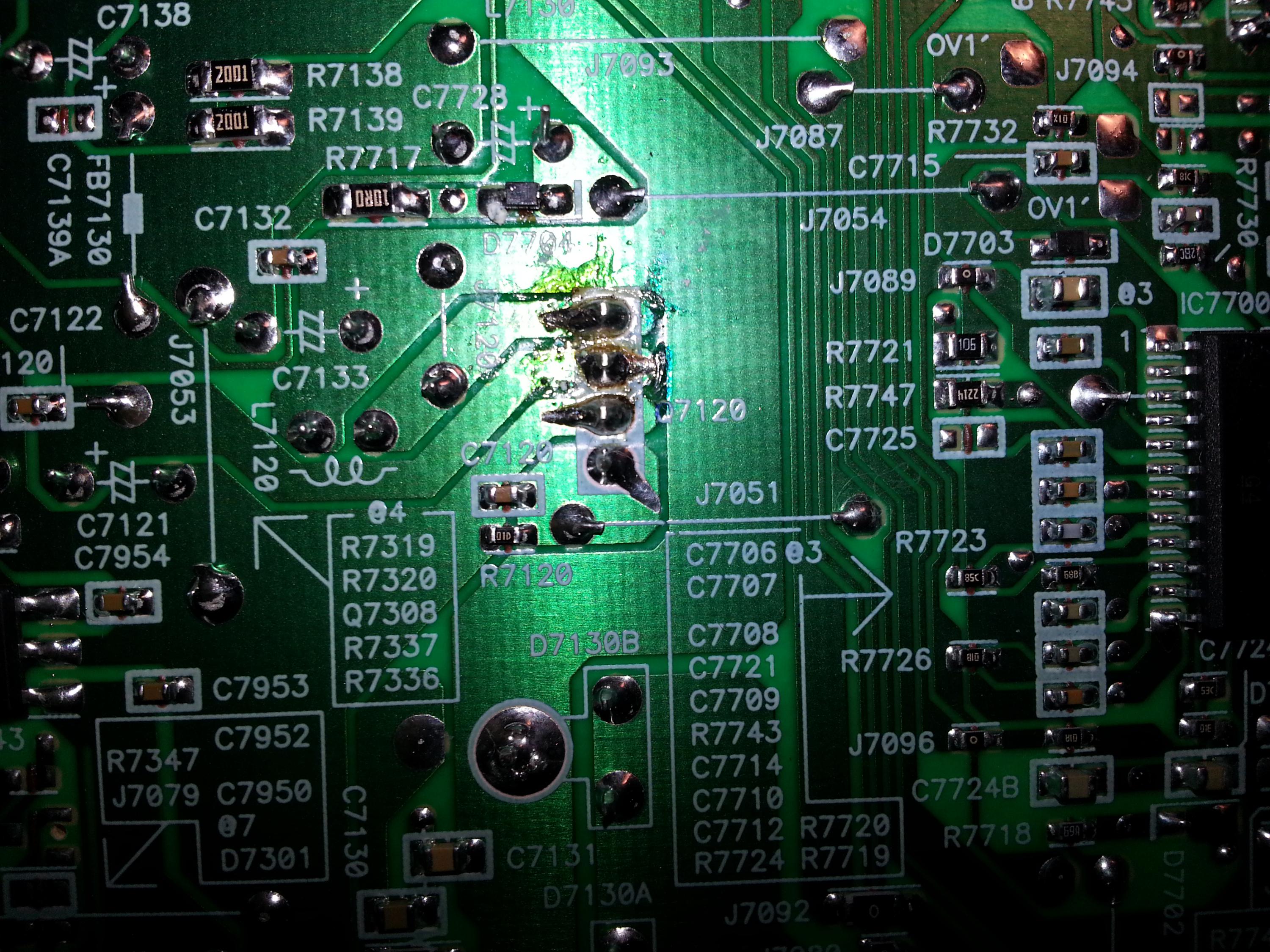

    I noted the 12V is coming from Q7120, Attached is a picture of the Q7120 from my previous post that looks like it has heat stress marks on the board. What do you think?

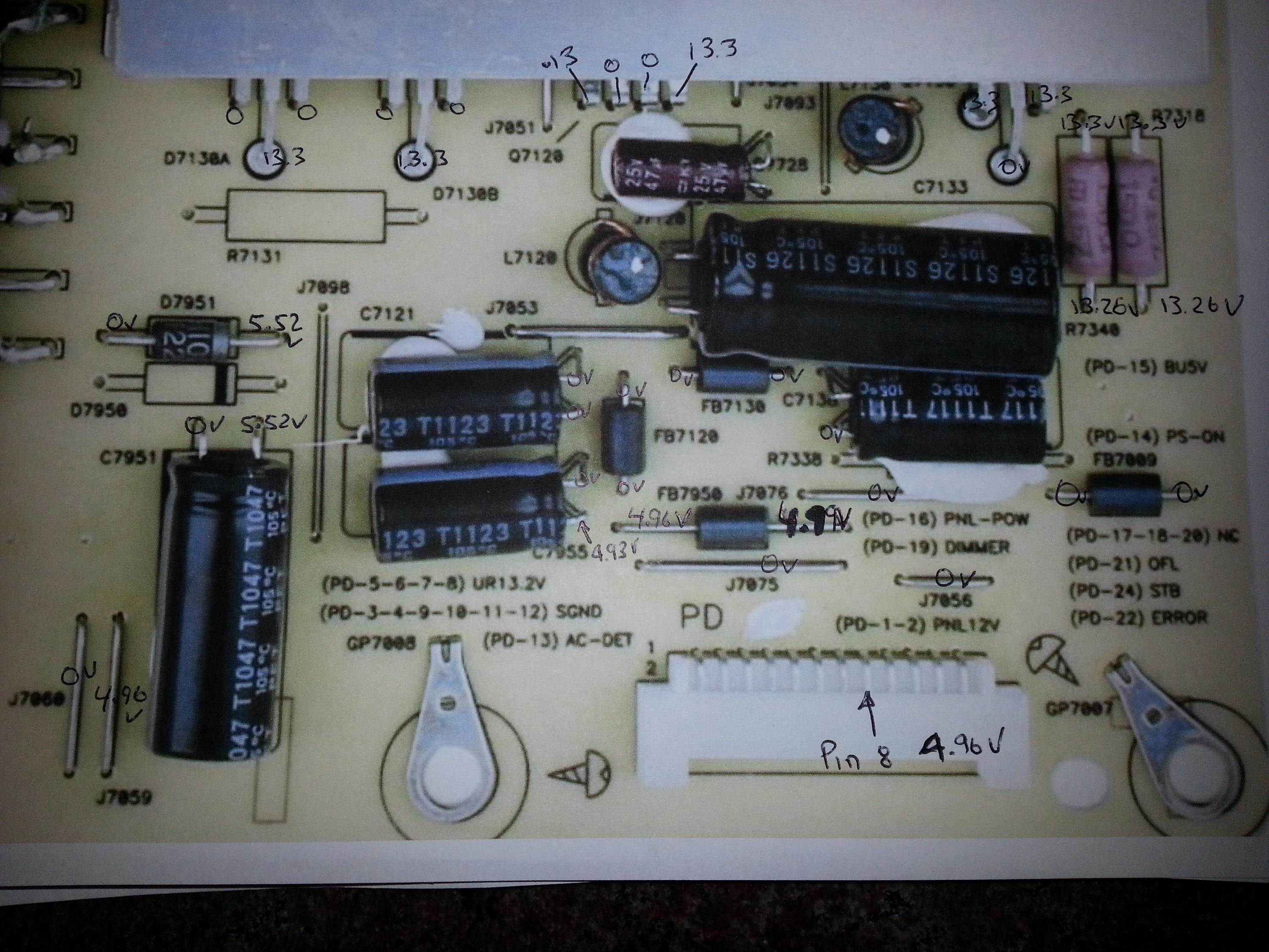

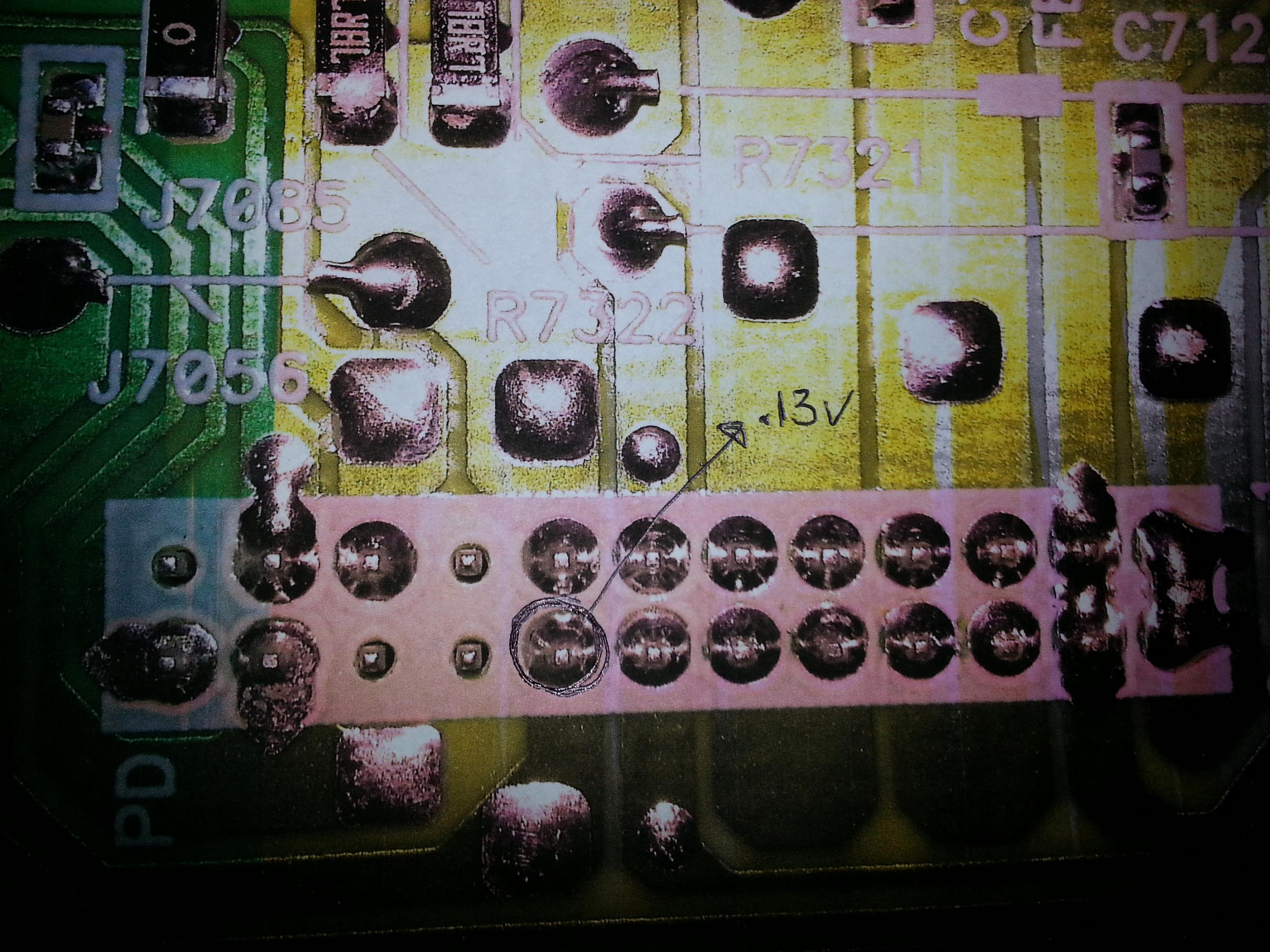

    I also took readings of the Q7120 from the top side see attachment. I took reading from jumper J7058 and it was .13V.
    Voltage reading at the PD pin 16 is .13V. Pin 15 is 4.95V all other pins are 0V. see pic PD connector voltage readings.

      OK, so the main board is not sending the signal to turn on the electronics switch Q7120.
      So troubleshooting the main board will be next.
      You can do the following, you can force on the Q7120, or jump the input-output pin of Q7120 just to verify that the T-CON is OK, The key is that they must be done AFTER the TV is turned on.

        OK, I jumped the Q7120 input output pins as you suggested after the TV was turned on and the panel power came on saw the screen turn on for about 3 seconds then went black.
        I hope this was what you were asking for.

                        Please check the resistance of the PNL-PWR pin (the control pin) against chassis GND for me, no power to the TV of course.
                        I just want to make sure it is not being grounded out.

                                          OK, I trace out the bottom side of the power supply board to see how the PNL-POW and the PNL12V are connected and generated.
                                          As you can see, you can put the meter on JUMPER J7058 to test the PNL-POW signal.
                                          The PNL12V output is from the electronics switch that is turned on by the PNL-POW signal.
                                          POWER SUPPLY BOARD PD connector pinout:
                                          PD-1-2 = PNL12V
                                          PD-3-4-9-10-11-12 = SGND
                                          PD-5-6-7-8 = UR13.2V
                                          PD-13 = AC-DET
                                          PD-14 =PS-ON
                                          PD-15 = BU5V
                                          PD-16 = PNL-POW
                                          PD-17-18-20 = N.C.
                                          PD-19 = DIMMER
                                          PD-21 = OFL
                                          PD-22 = ERROR
                                          PD-23 = NOT USED
                                          PD-24 = STB
