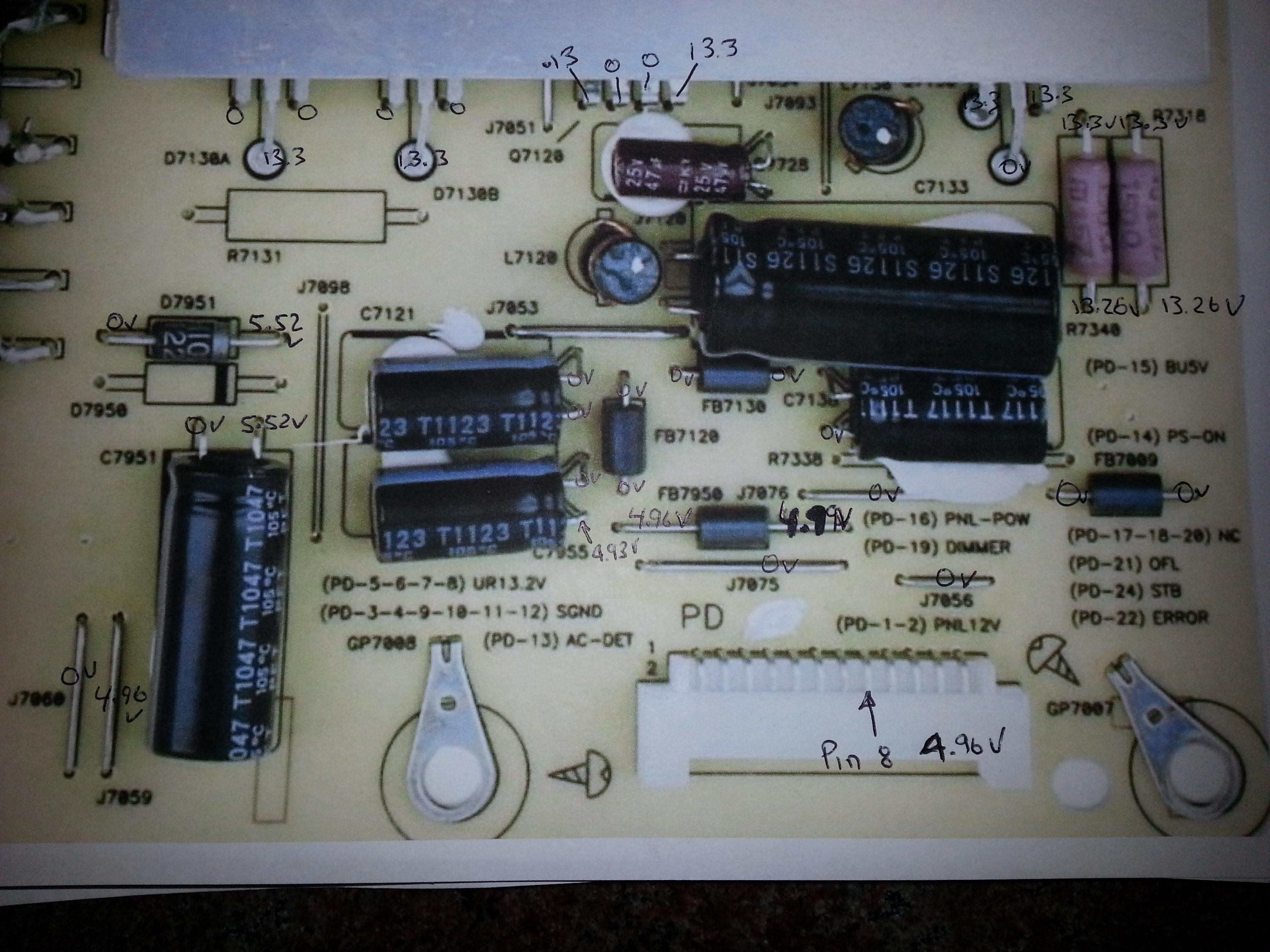

    Re: Sharp Aquos LC-70LE732U Blinking Pattern 2 -5
    Hi, took many voltage readings. For results see attachment.
    I hope this helps, TV still flashing 2 long 5 short.
    RT.

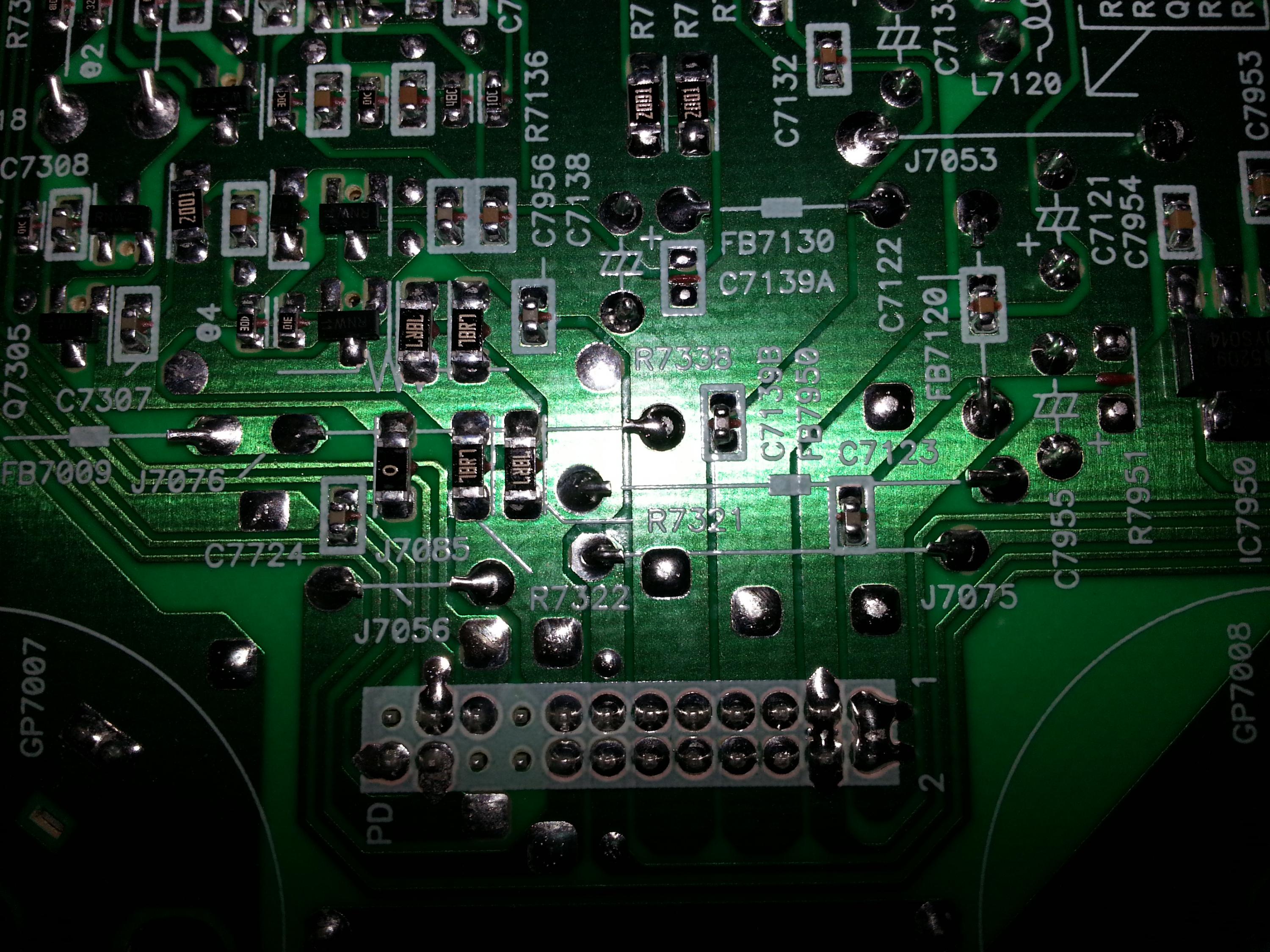

      OK, you are confused, it is connector PD pin 16 (PNL ON). what you were measuring are the jumpers, the PD-XX are not for the jumpers, they ran out of room to put the PD-XX right next to the connector.
      The PD connector is a dual row pins, the exposed pins that you see on the top side of the board are the ODD NUMBER pin, pin 1 on the left as printed on the board, next is pin 3, and so on.
      The EVEN numbers pins you have to get to it from the bottom side of the board, left bottom is pin 2, 4, .... and so on.

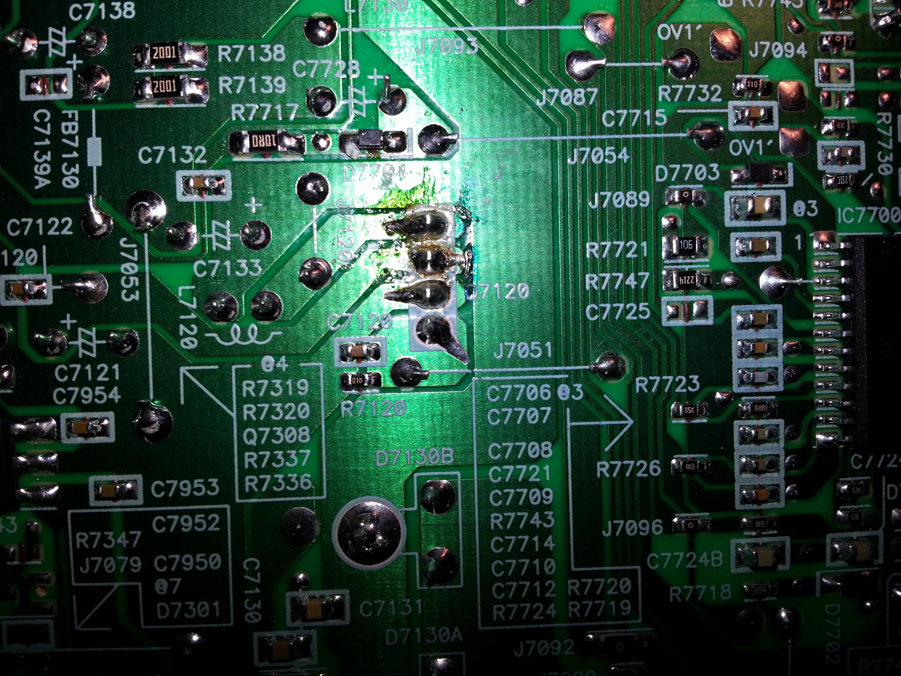

        Sorry for the confusion. Took the Power board off and noted Q7120 has heat stress marks. What do you think? see attachment.
        Took reading as you asked and have no voltage at any pin. see attachment.
        Is it possible the transistor Q7120 has overheated and failed?

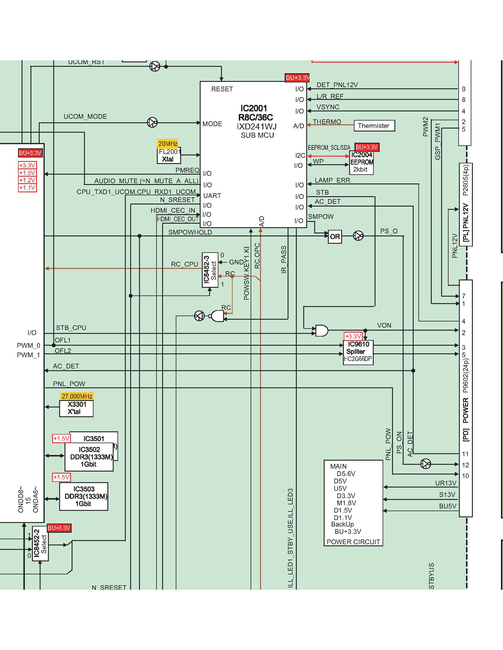

                OK, I look at the service manual page 73, it is pin 10 (PNL_PWR) of the PD connector on the main board.

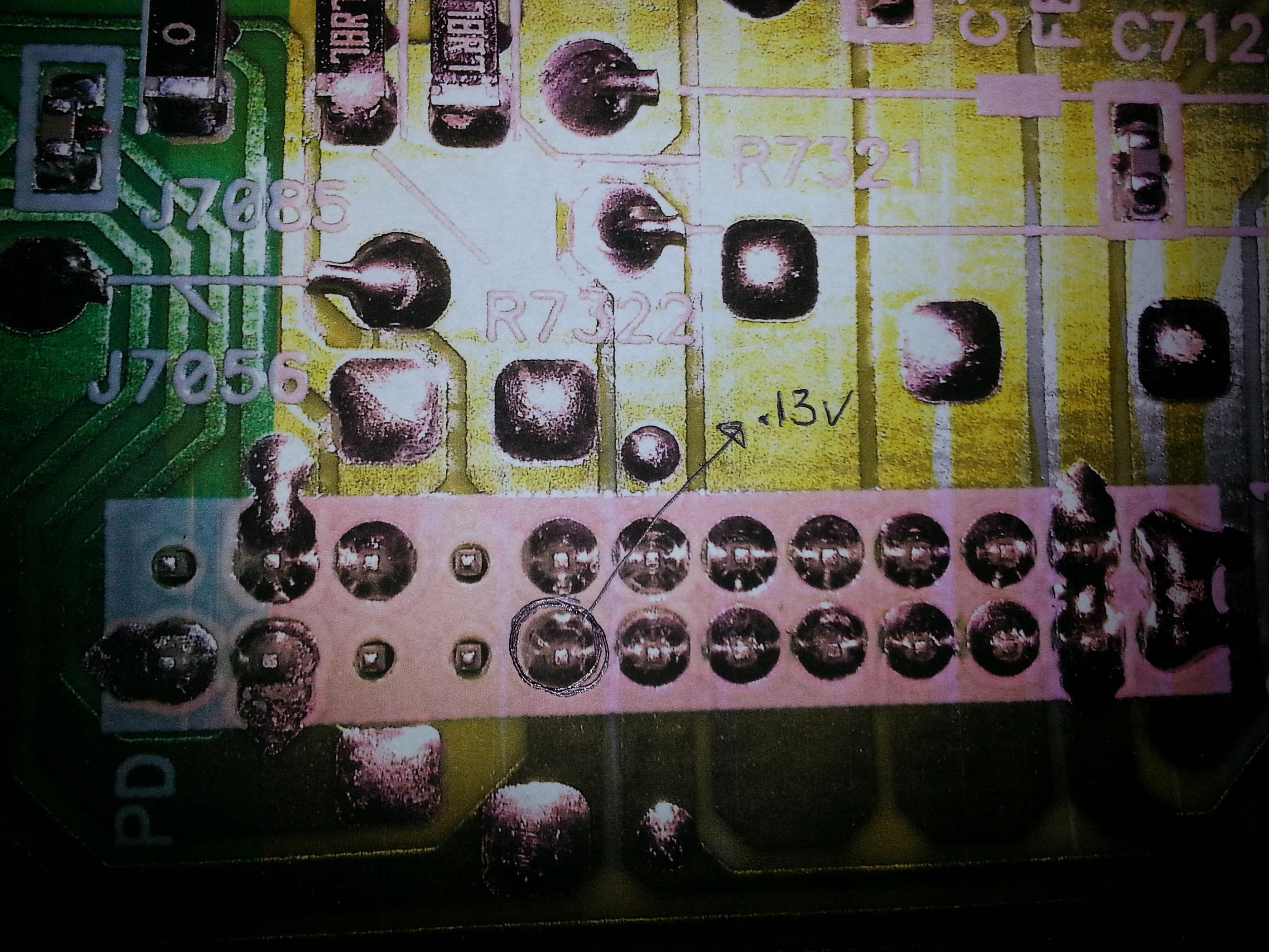

                  Attached is a close up of PD Connector, I have circled what I believe is row 2 pin - 10 voltage reading is .13 VDC, all other voltage readings on row 2 have 0 volts.
                  I hope this helps, thanks again.
                  RT
                    RT
                    Are you showing the PD connector on the main board or the power supply board? If it is on the main board and only has 0.13VDC, then you have problem with the main board.

                      #30
                      I meant to say all other readings on Row 2 have 0 VDC.
                      RT
                        PD on which board?
                          #32
                          RT
                          Cannot be right.

                            #33
                            It's from the power supply board.
                            RT
                                    I wish I had the schematic of the power board, are there any test points to verify 12VDC?
                                    Sorry I am not sure how to check for command PNL ON from the Main board. Any suggestion?
                                    Should I remove the metal cover on the Main unit and test the connector PD? What pin numbers should I check voltage on?
                                    Thanks,
                                    RT.
                                    OK, you asked me if the PNL_PWR pin can be read on the MAIN board, so I gave you the info as shown above.
                                    But now you are testing on the POWER SUPPLY BOARD PIN 10 which is not PNL_PWR pin, the PNL_PWR pin on the POWER SUPPLY board is PIN 16.
                                    I am about to give up on this thread.

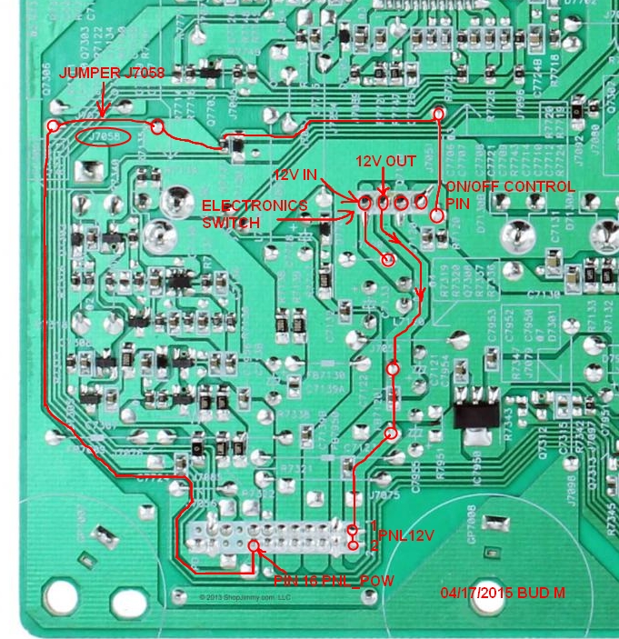

                                          #40
                                          OK, I trace out the bottom side of the power supply board to see how the PNL-POW and the PNL12V are connected and generated.
                                          As you can see, you can put the meter on JUMPER J7058 to test the PNL-POW signal.
                                          The PNL12V output is from the electronics switch that is turned on by the PNL-POW signal.
                                          POWER SUPPLY BOARD PD connector pinout:
                                          PD-1-2 = PNL12V
                                          PD-3-4-9-10-11-12 = SGND
                                          PD-5-6-7-8 = UR13.2V
                                          PD-13 = AC-DET
                                          PD-14 =PS-ON
                                          PD-15 = BU5V
                                          PD-16 = PNL-POW
                                          PD-17-18-20 = N.C.
                                          PD-19 = DIMMER
                                          PD-21 = OFL
                                          PD-22 = ERROR
                                          PD-23 = NOT USED
                                          PD-24 = STB
