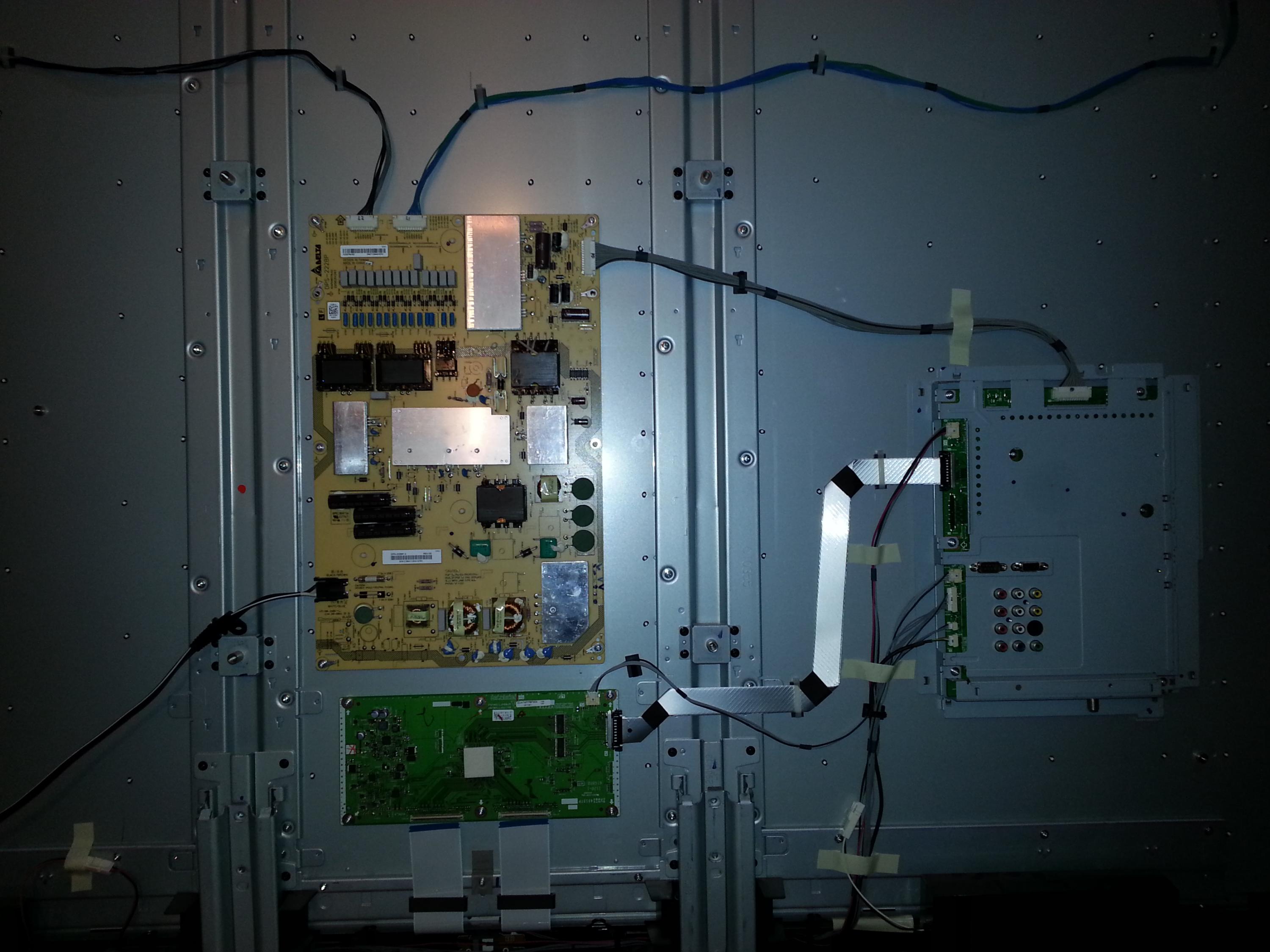

                  Get it open and give us clear pics of all your boards and layout (So we can point things out if needed) ... After that we can start helping more

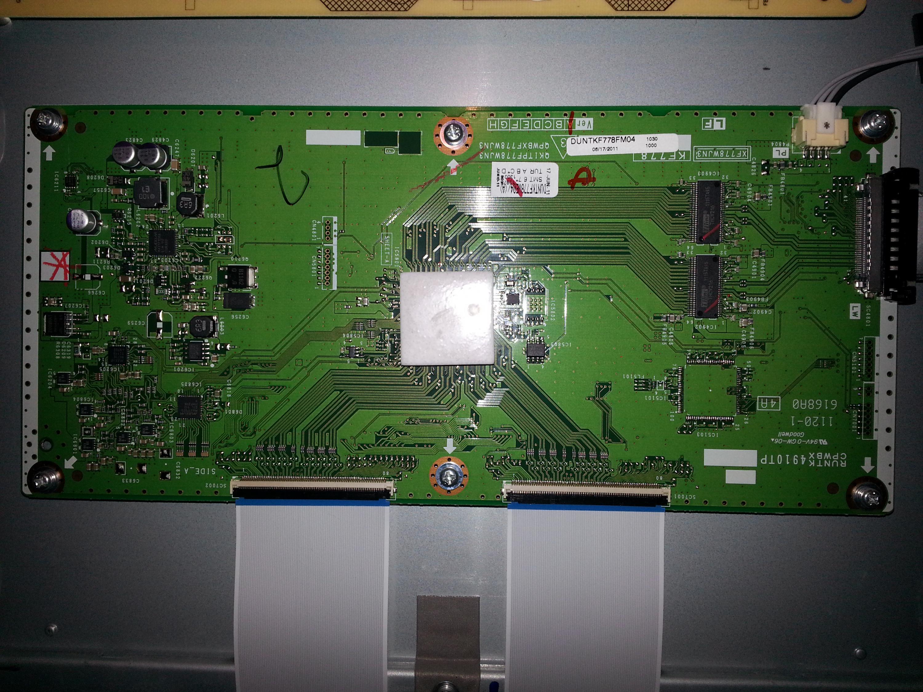

                        Her are the board pics. Tested the Tcon board voltage at connector PL no voltage at all 4 pins. TV continues to flash 2 long 5 short.
                        Thanks,
                        RT.

                          Re: Sharp Aquos LC-70LE732U Blinking Pattern 2 -5
                          Board pics done. Thanks, RT.
                              I can't say for sure but I think panel + 12 is on the PL plug on the tcon board.
                                Check for DCV on both ends of the Ferrite Bead FB4801 to see if you do have 12VDC against chassis GND.
                                  Thanks for the advise regarding 12 VDC readings.
                                  I have taken DC voltage readings at the 4 pin PL Plug with no DC voltage present. See attachment
                                    OK, you need to check PNL_ON pin and PNL12V on the power supply board PD connector.
                                    There is white glue covering up PD-10 names, I believe pin 10 is the Pnl_on PIN.
