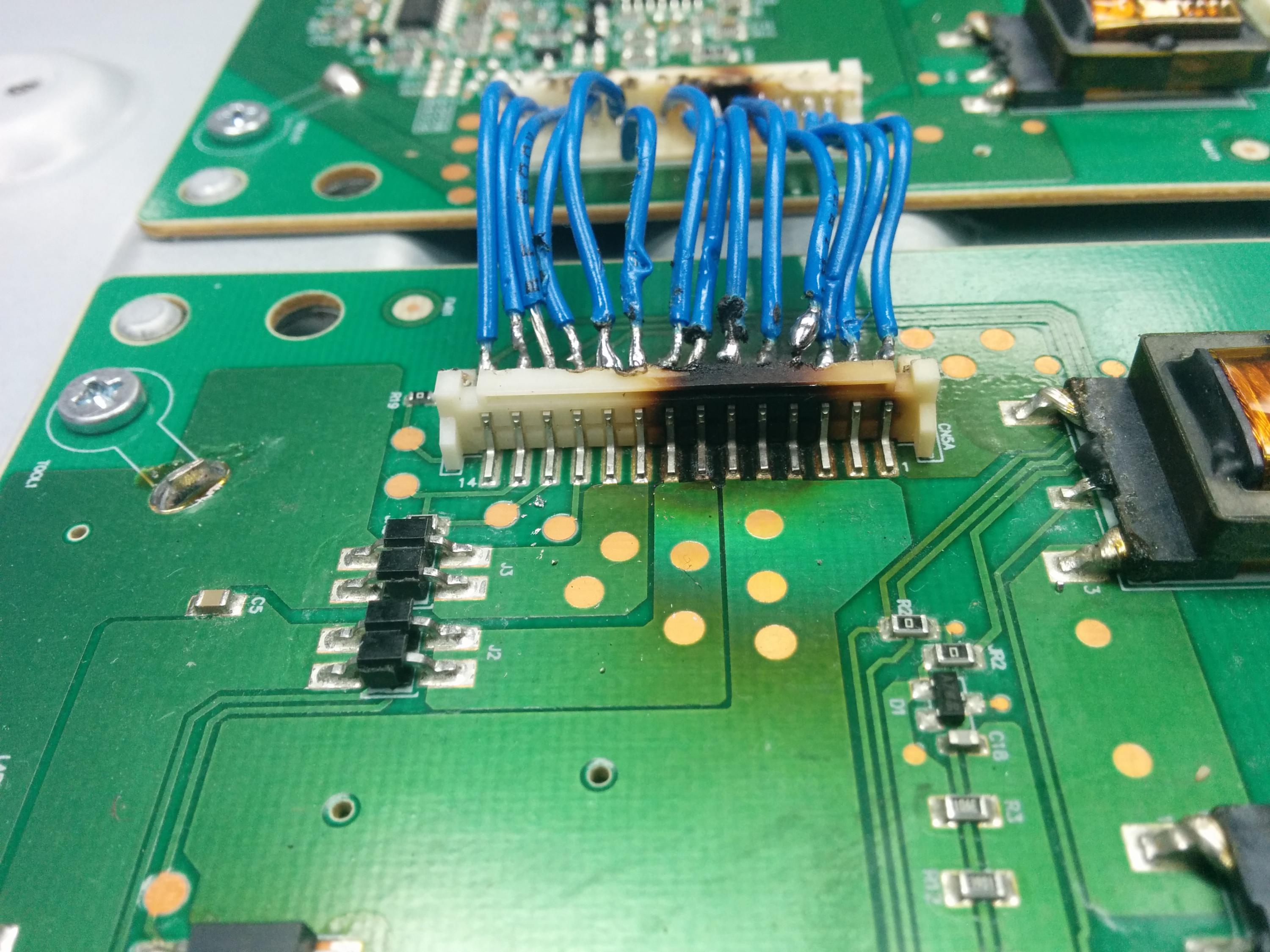

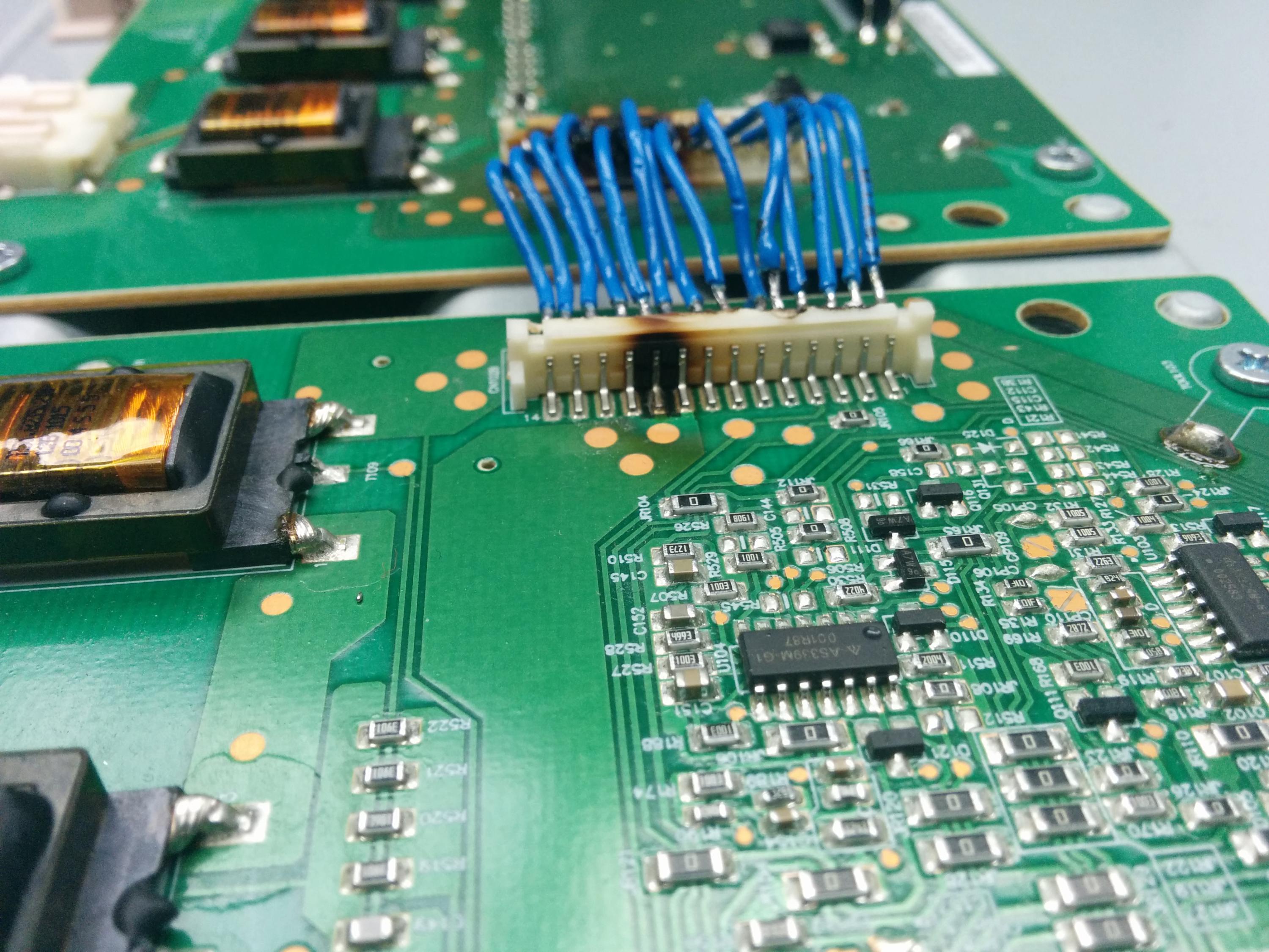

    I have a toshiba 55g300u. I replaced the power board and the jumpers on the backlight boards. When I got the TV it was broken. I opened it up and the jumpers from the master backlight board to the slave boards were burnt up on both sides. As in there are 2 sets of board. I replaced the power board and jumpers and when I did that the tv powered on but the jumpers I had put on I had just quickly soldered for the test. While running the test the TV powered on but I had a friend helping me (who isnt the most intelligent) and he kept trying to move the back light boards while the tv was on. He was trying to put them on the little knobs that hold them in place. During this some of the jumpers popped up and touched/shorted. Now I can't get it to work again. What could it be on the power board that blew? All the caps look good but I haven't tested them.

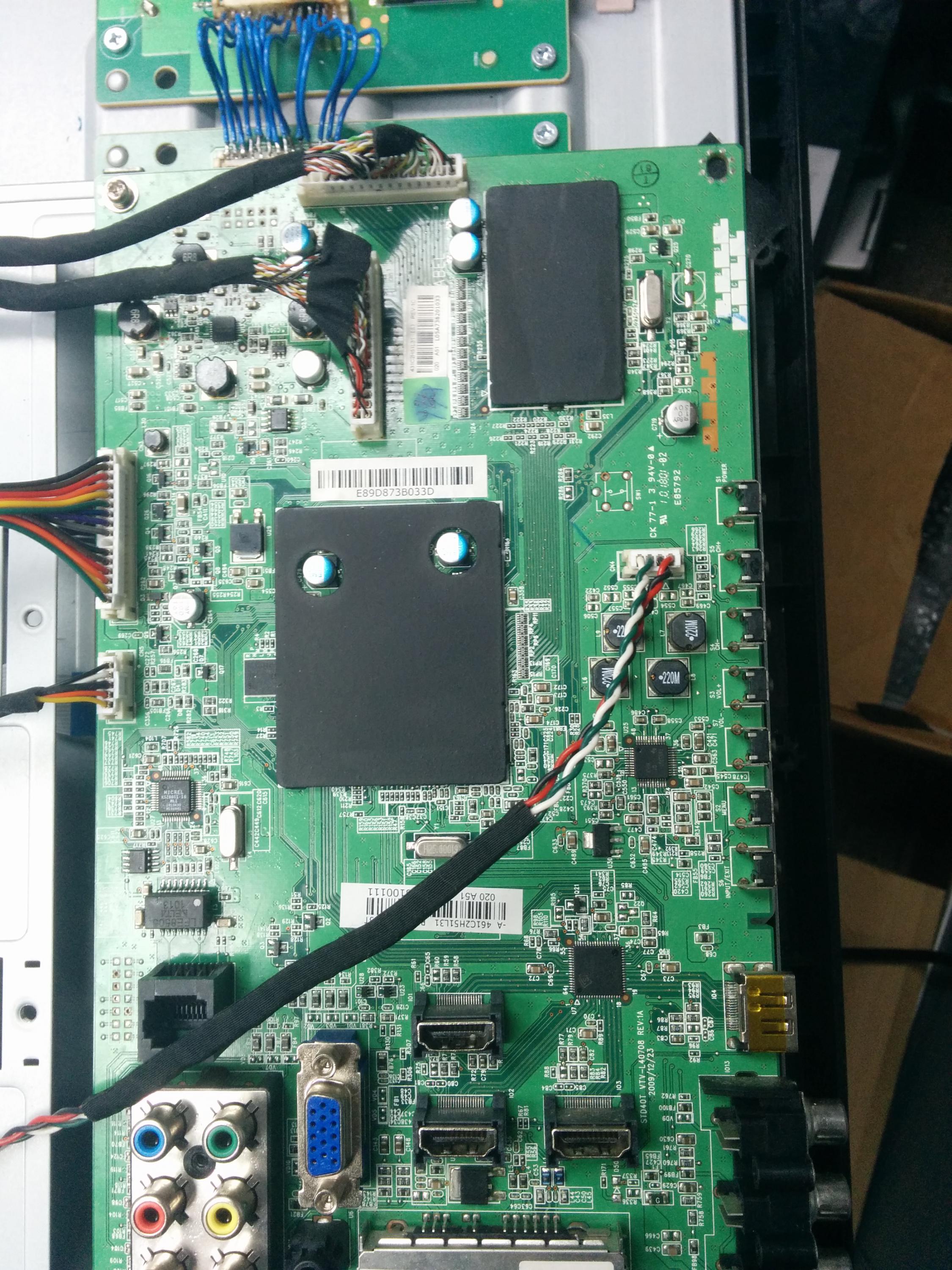

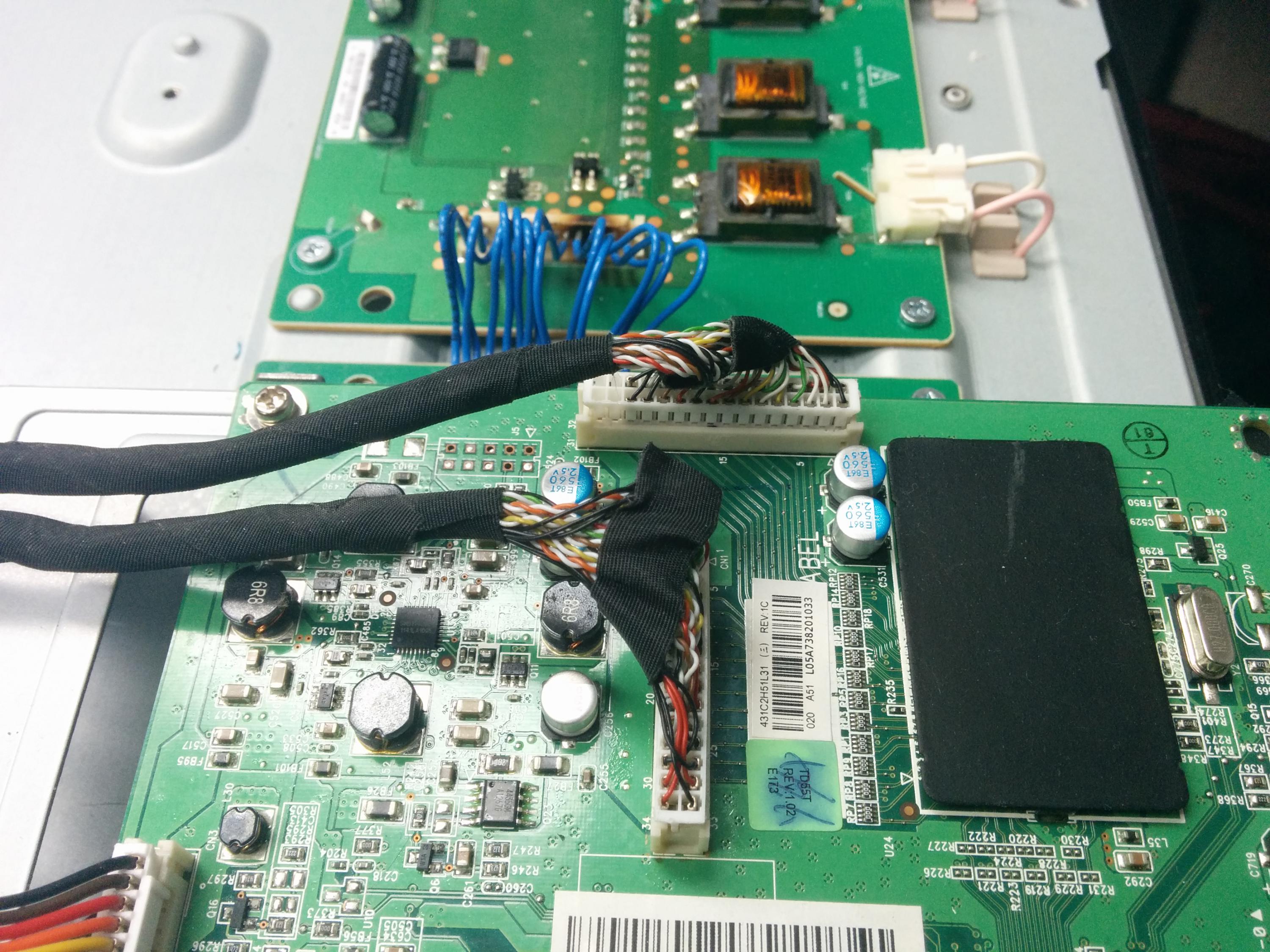

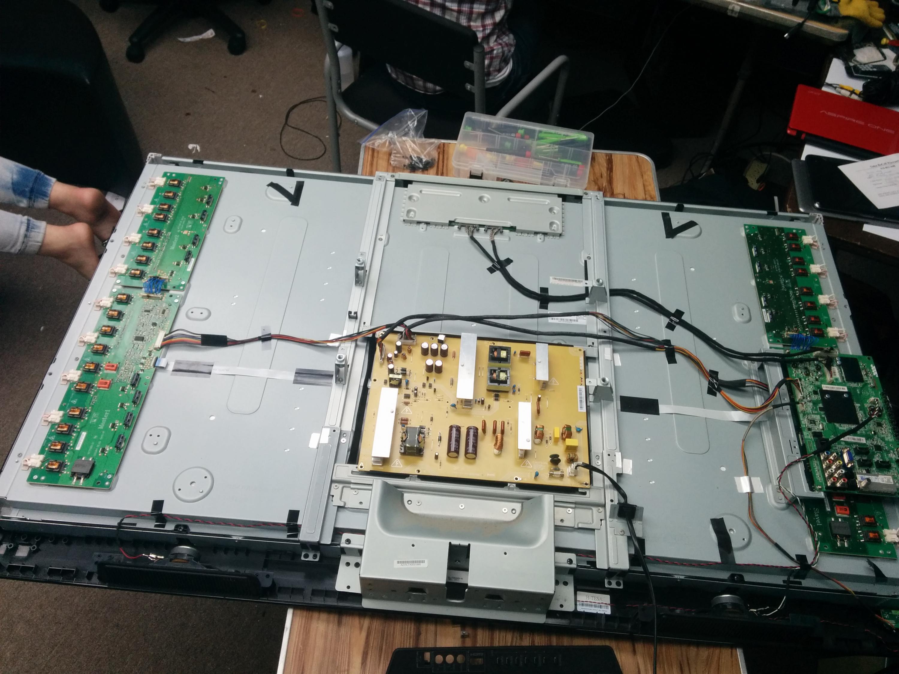

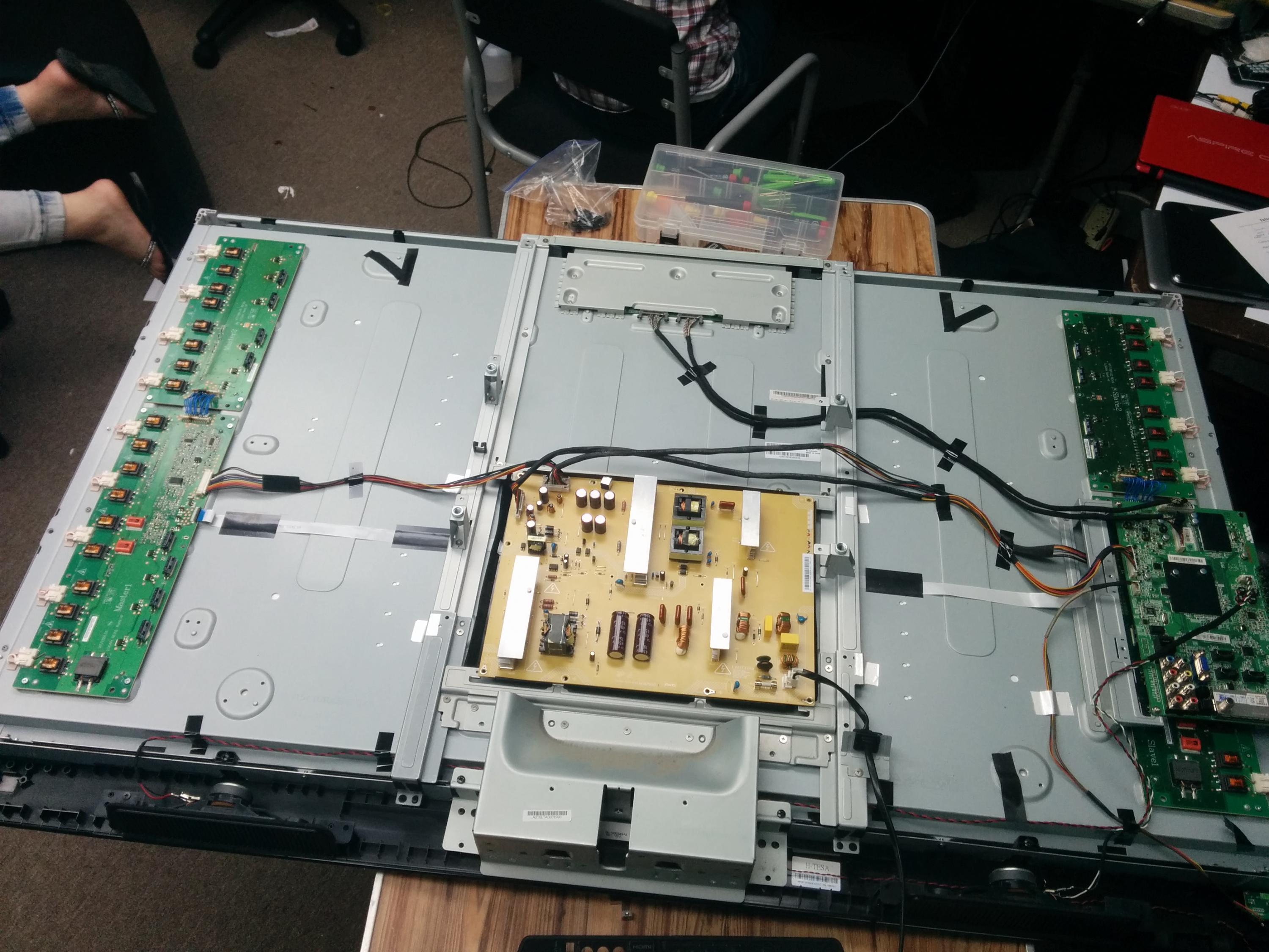

      Any good clear pictures of the all the boards, the jumper that shorted to the chassis, the whole back side of the TV?

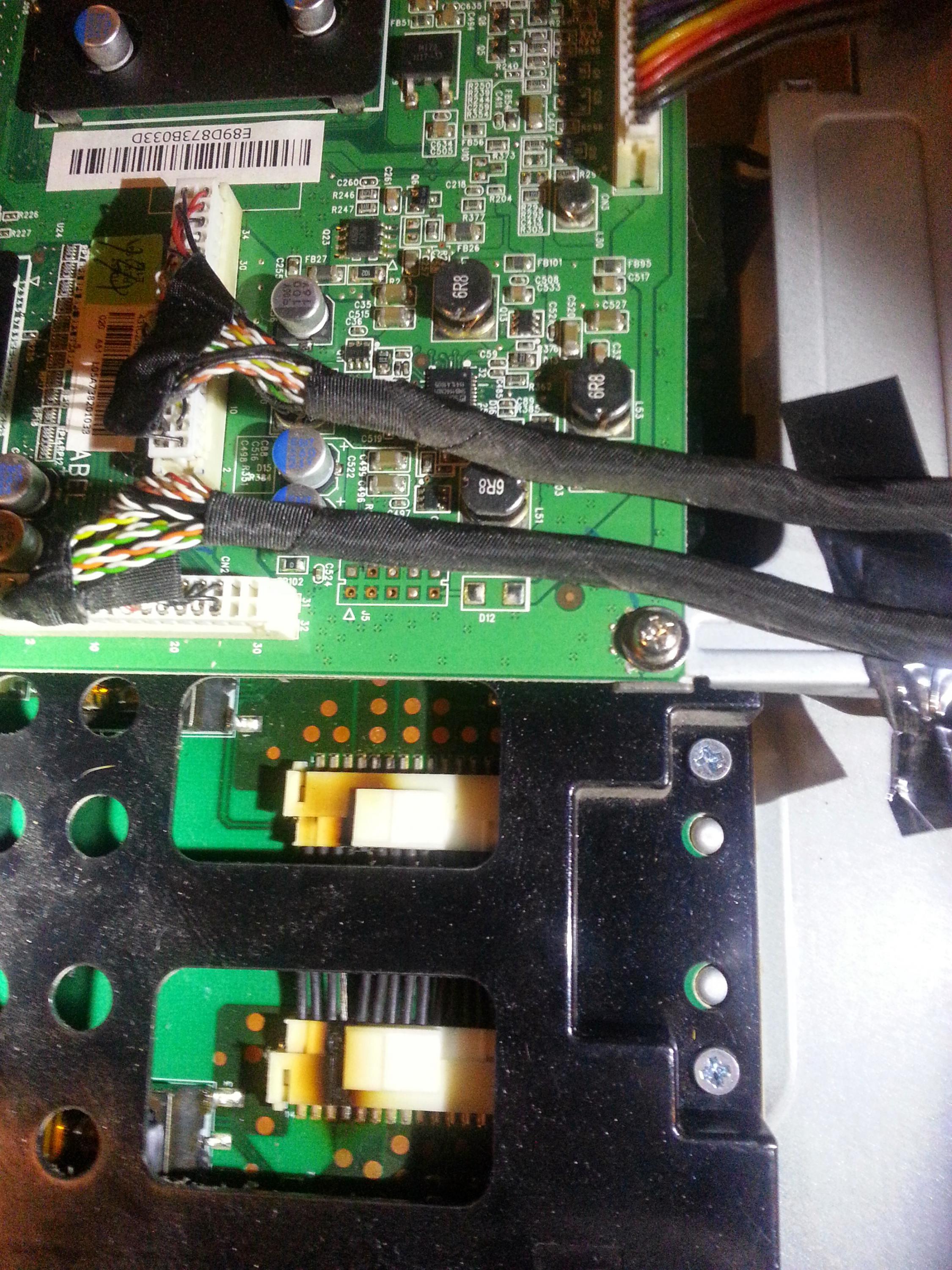

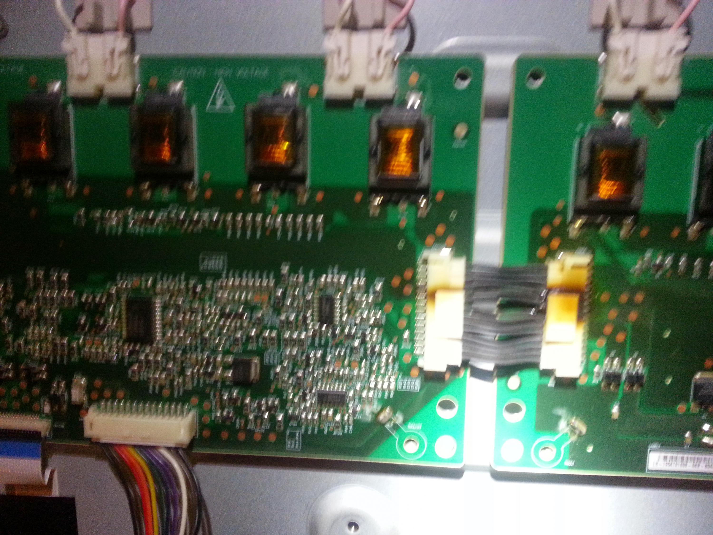

          Here are 2 pictures 1 of each bacl light boards jumpers. I will take more photos in just a few minutes. I have reploaced the jumpers multiple times now but I soldered each one since I didn't have the proper molex connectors.

            I hope they will be better pictures cause I am trying to see if the wire that touches the chassis is the B+ power wire or the transformer driver wire, right now I cannot tell form the pictures.
            Did you check all the fuses on the inverter boards?

              uff... its like I am wearing my grandmothers glasses. Check your pics... those are majorly out of focus.

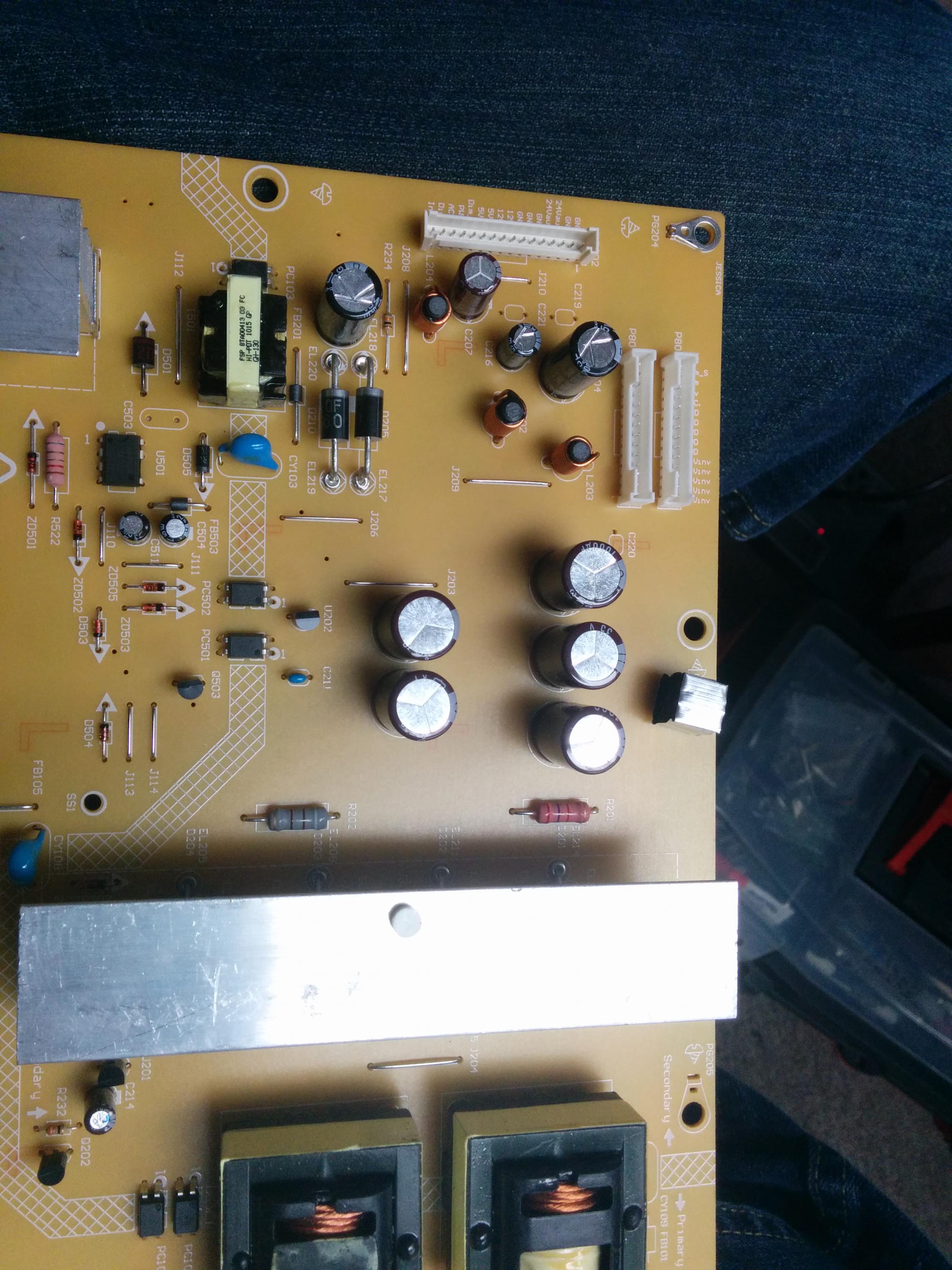

                Sorry, I quickly took those when I first opened it up to show my buddy the burnt up jumpers. I think the problem is the transformer I removed (I have a replacement board) Oh and this is not my solder job I was teaching a coworker.

                  Can we see the whole back side of the TV to see how all the boards are connected together?

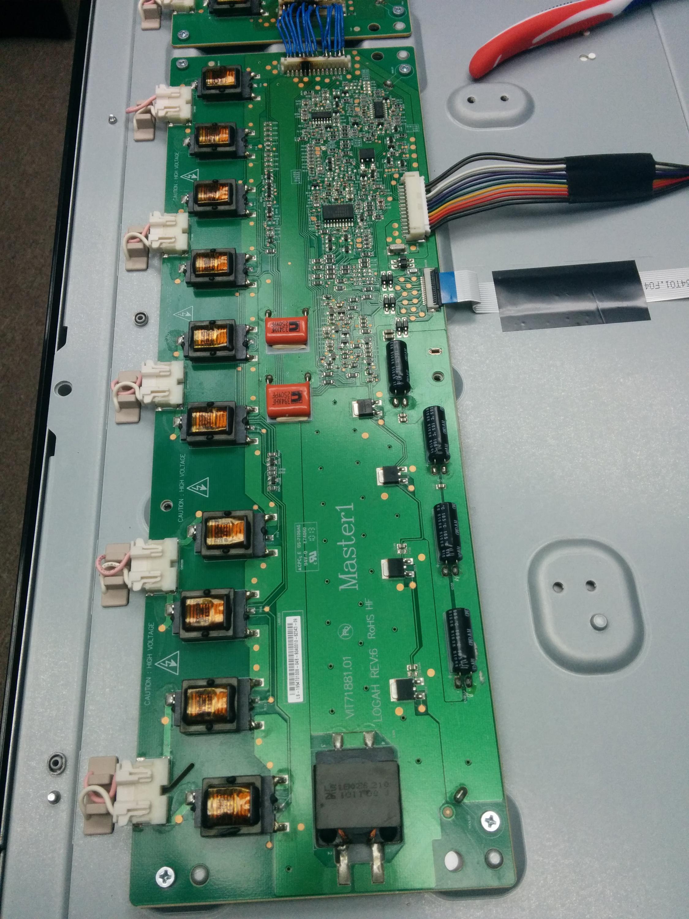

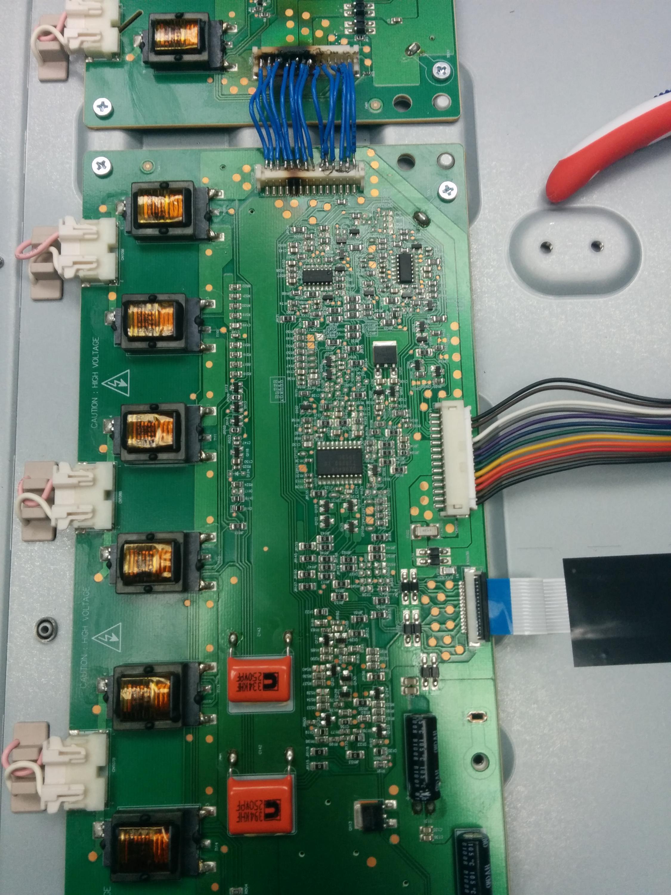

                    Here are the others

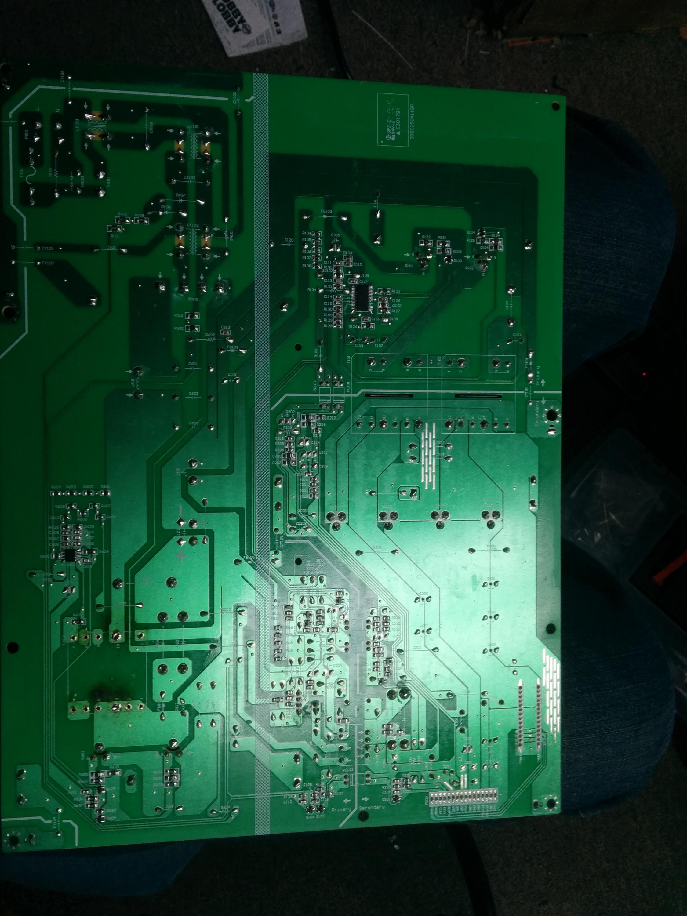

                      Oh sorry I just saw the reply wanting to see the back. Here you go. Thanks everyone. The transformer has had the kapton tape removed.
                        Re: Toshiba 55g300u issue after issue
                        So the fuses on the inverter boards are OK?

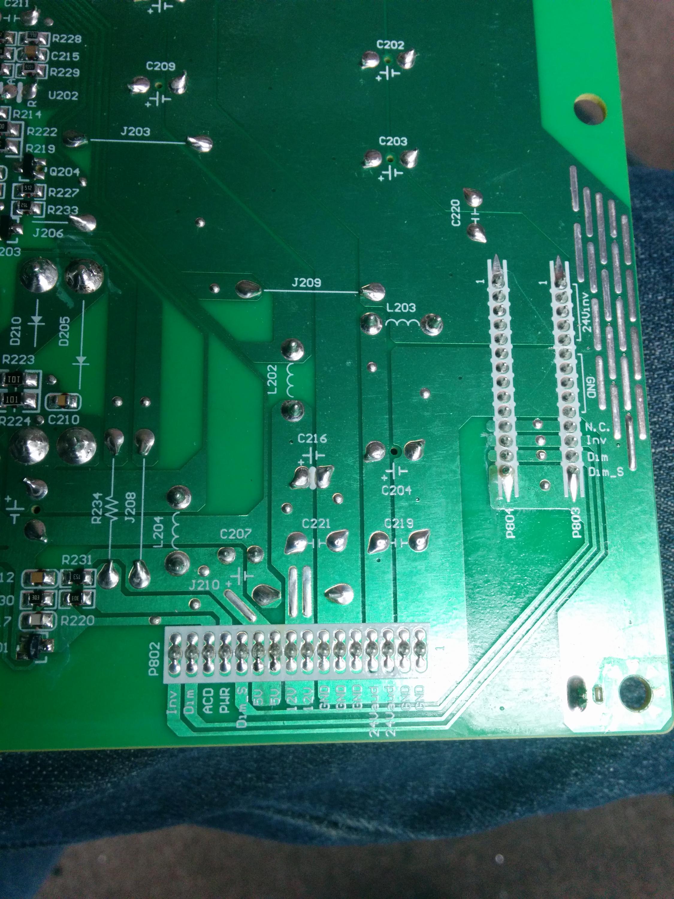

                                  12V is not used by the inverter board: look at P803, 804
                                  http://assets.shopjimmy.com/media/ca...8932-top_1.jpg
                                  You can disconnect the P803, 804 and see if the TV will power up.

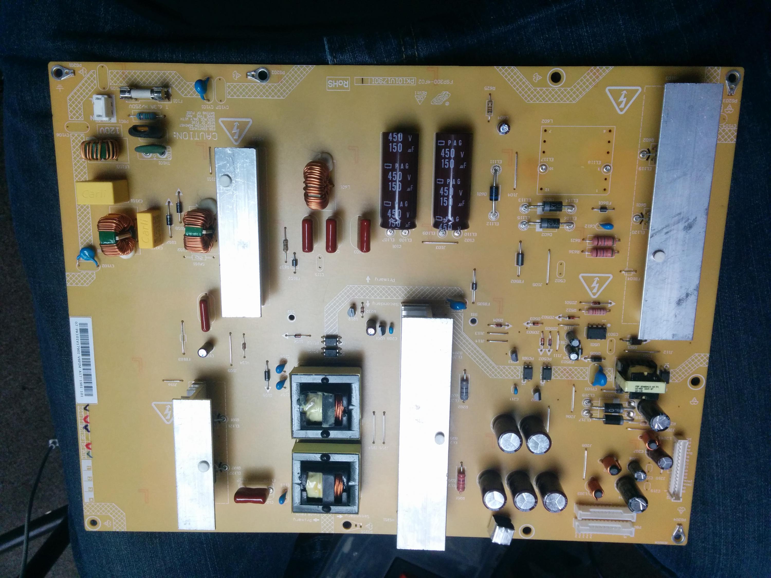

                                        OK, the inverter circuit in this TV does not generate any error signal back to the main board what is going on with the inverter board, so the TV should work without having the inverter boards connected.
                                        So lets find out the PFC Voltage booster circuit is working or not first, you will have to measure the DCV between the two legs of the main filter 450VDC caps (at any one of the two caps will be find).
                                        The DCV on the cap should jump from 160VDC to >360VDC when power switch is activated and should stay at that level until the TV is turned off.
                                        You will be working in the Deadly primary side of the circuit, so do not touch anything and do not let the probes slipped on you.
