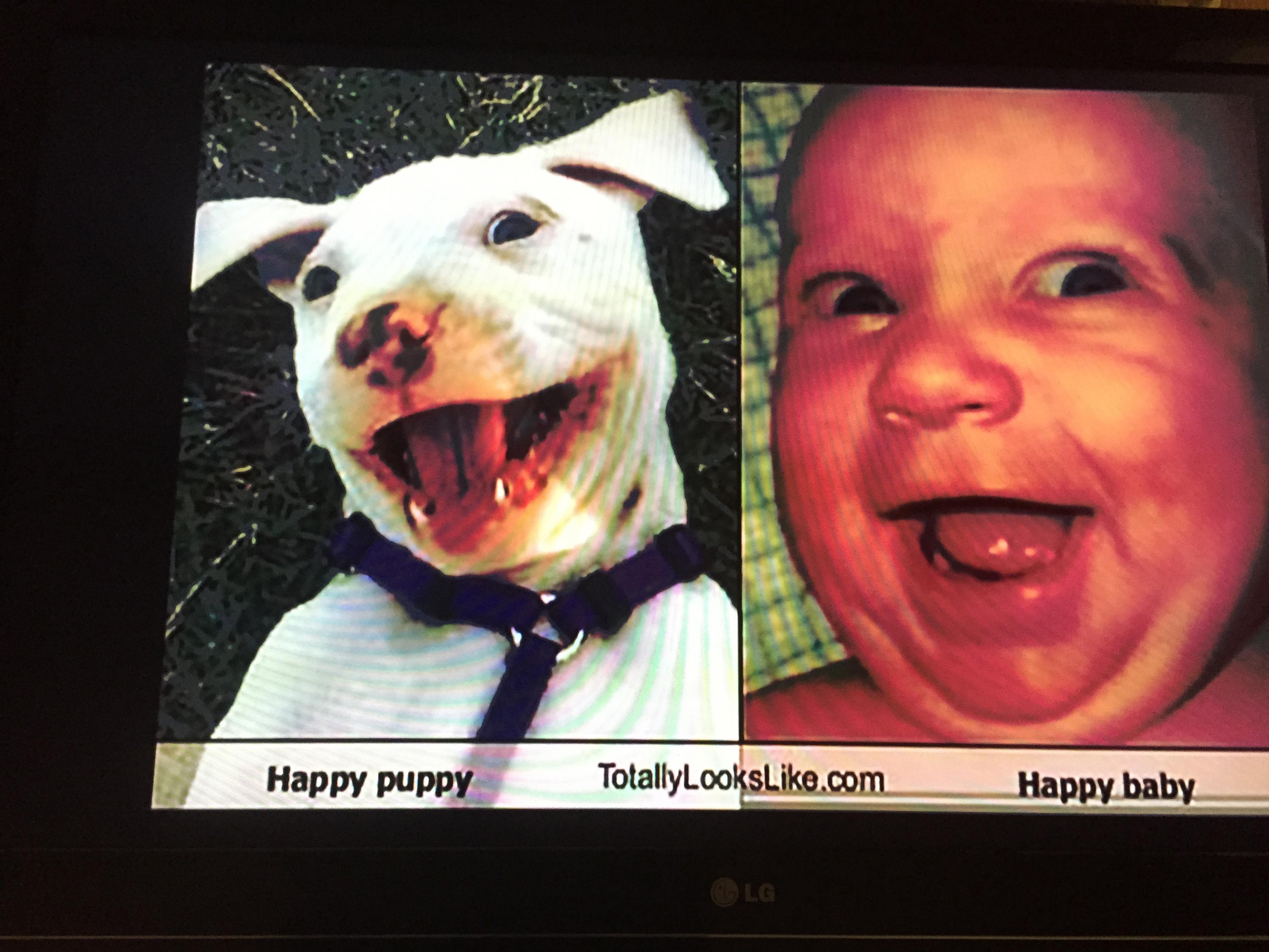

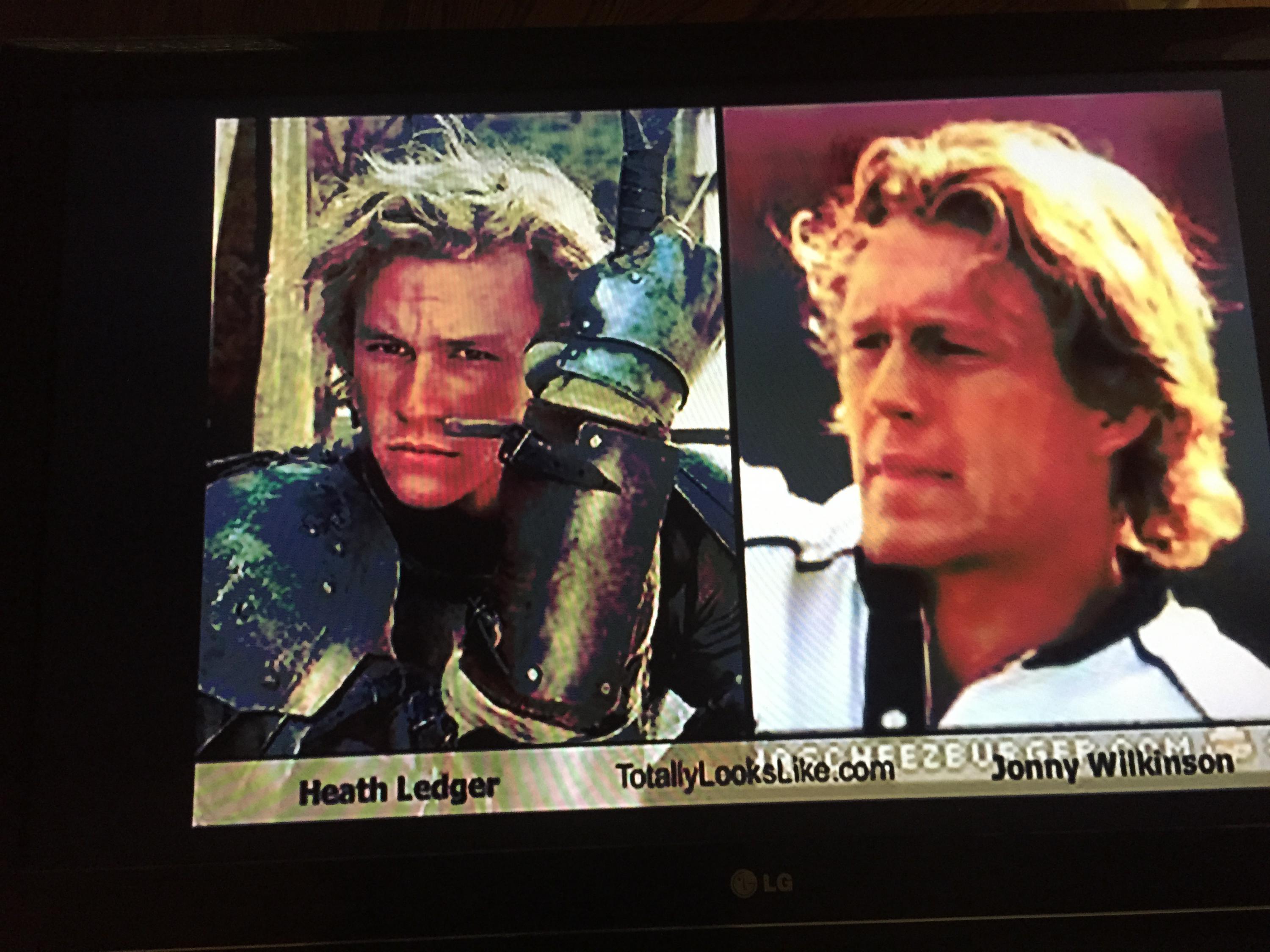

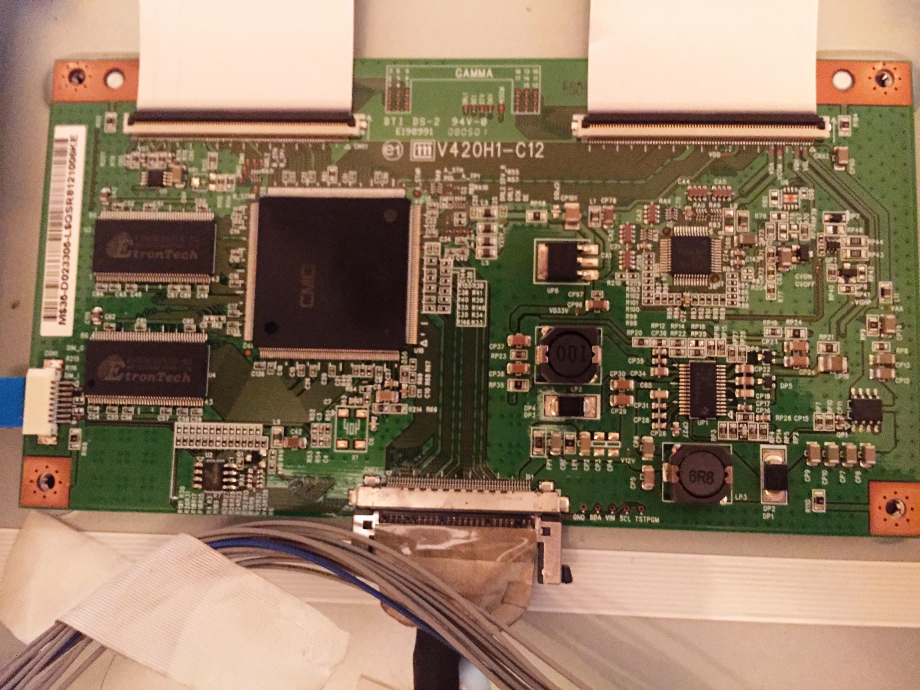

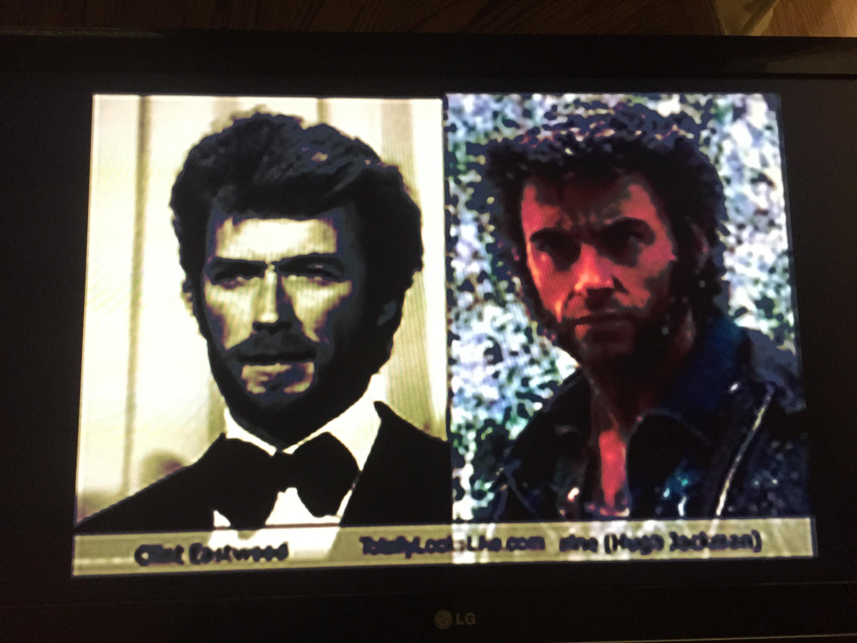

    I have a 42LG50-UA tv. When I turn the TV on, the image is good for about 30 seconds. The image then becomes increasingly saturated with red and slightly dim. Images look coarse and the problem is especially apparent in skin tones. I have a multi-meter but my experience with electronics is limited.

    can you supply a picture of the fault ?

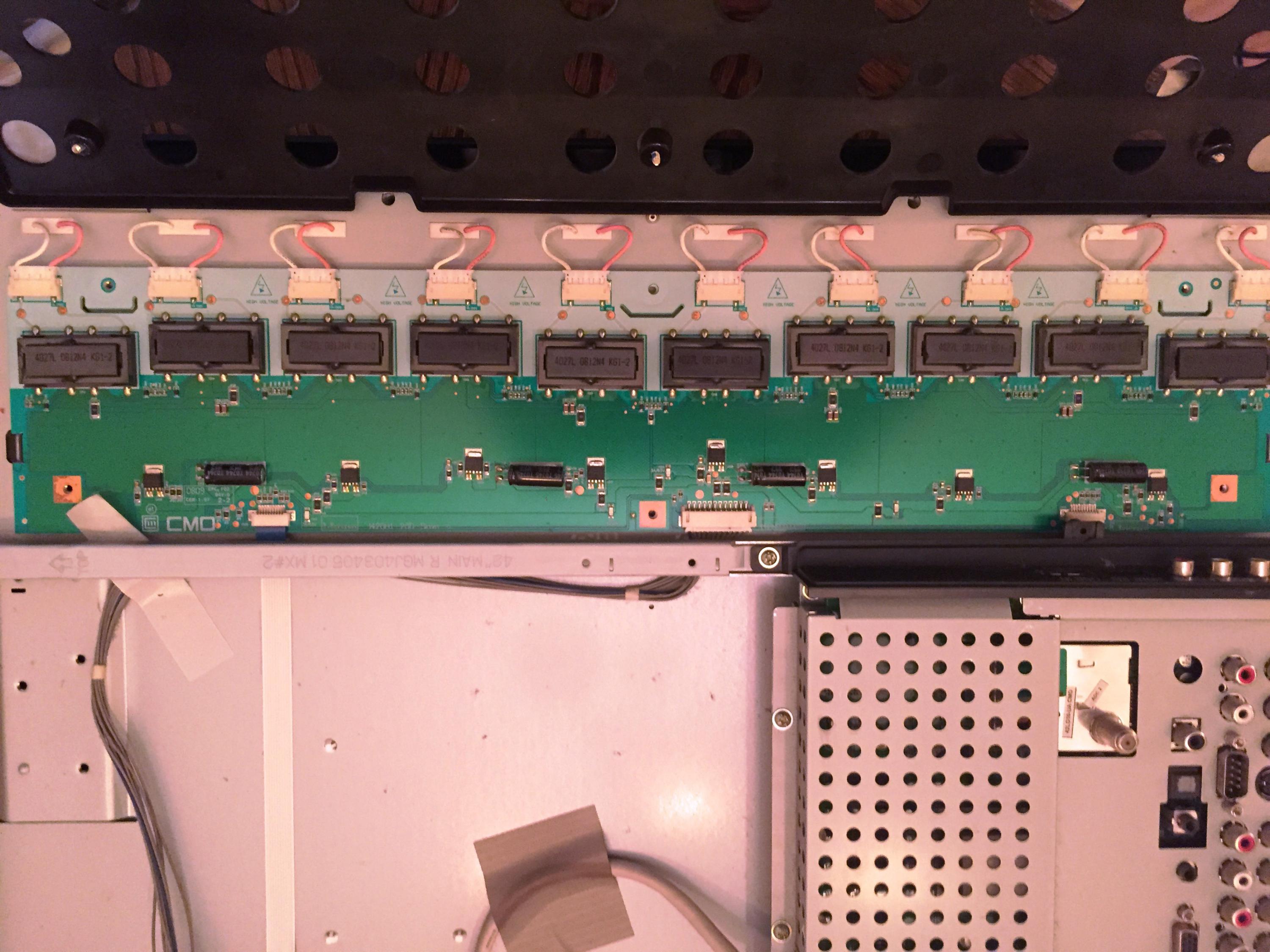

      And a picture of the T-con board will help (top of TV usually, connected to the main A/V board, which is in your 1st picture)

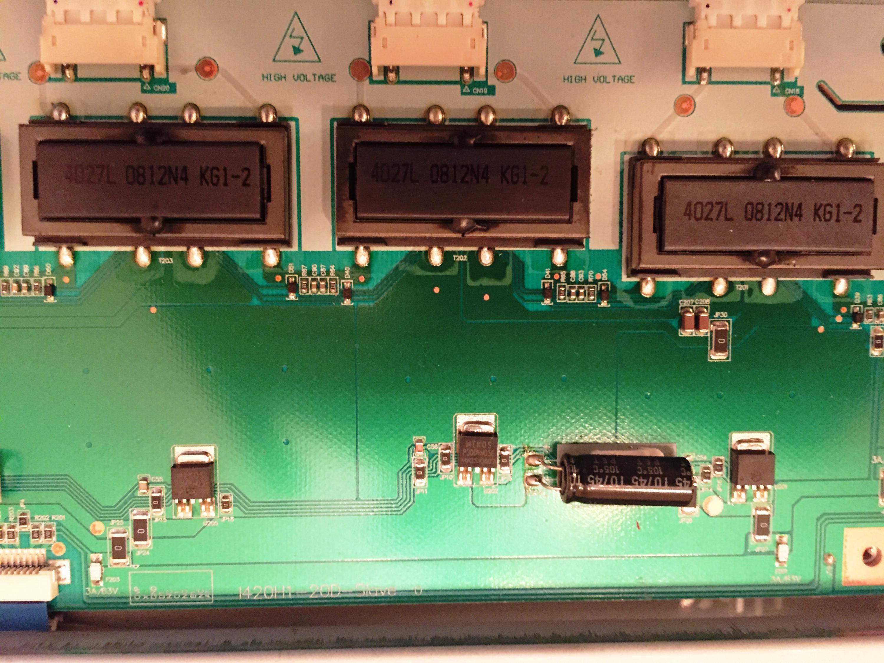

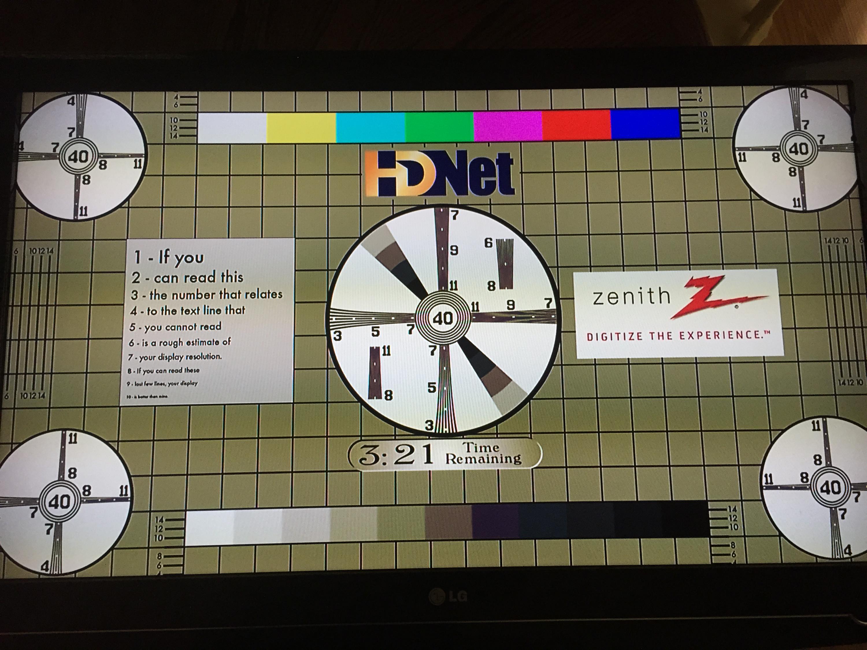

        Re: 42LG50 Red Tint and Dim Screen

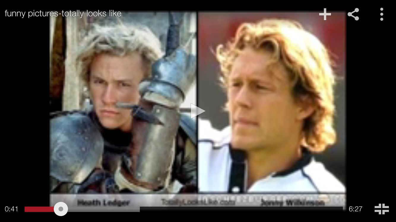

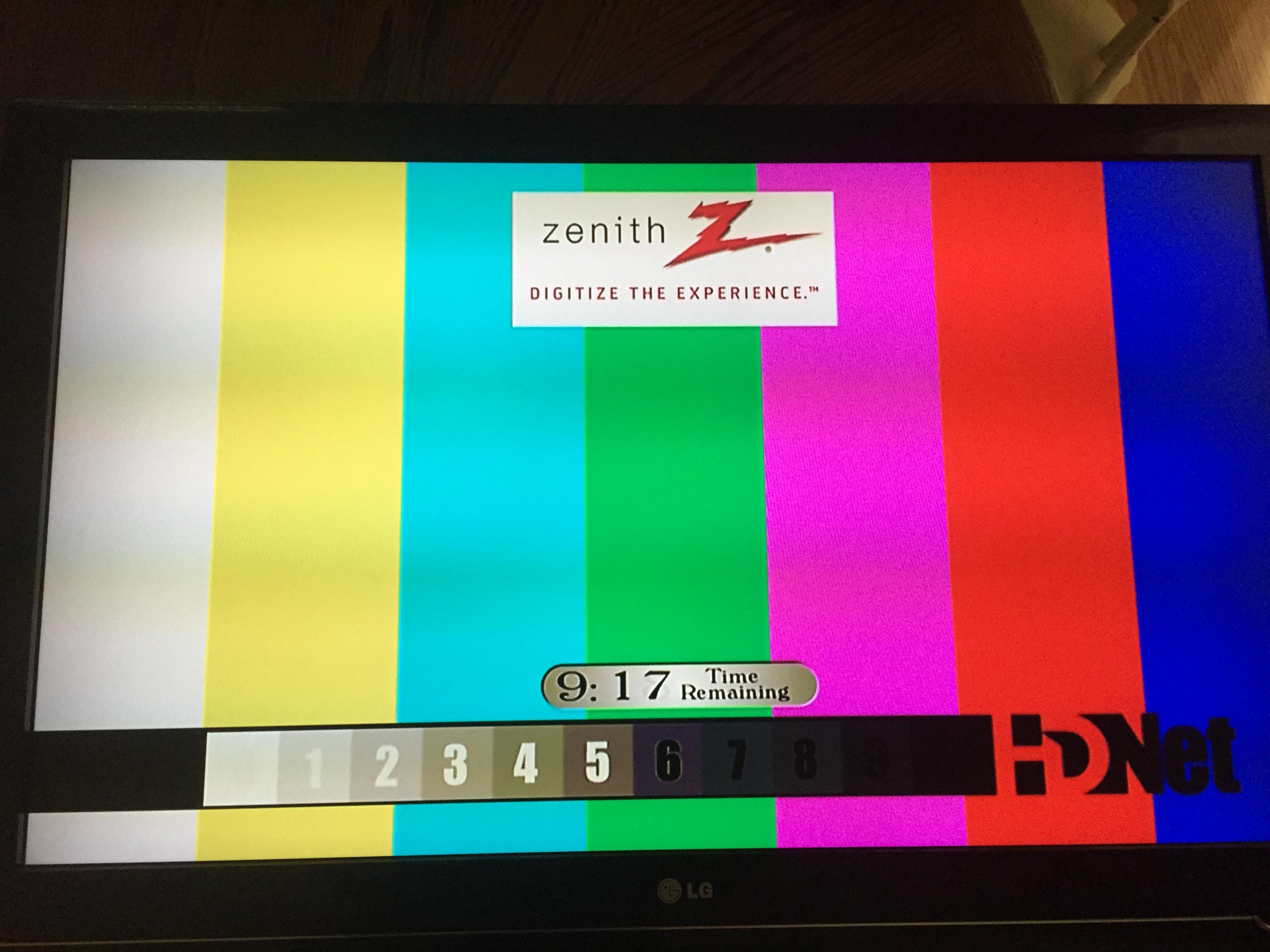

        I tried to capture the fault in the image with these pictures from the TV. The ones labeled correct were taken from my phone and the ones labeled fault were taken from the TV set. I also took a couple pictures of screen test images on my TV. The screen test pictures I found online and projected to my TV; they are not from the TV menu as I could not find any there. To my untrained eye, the test screen pictures looked good.

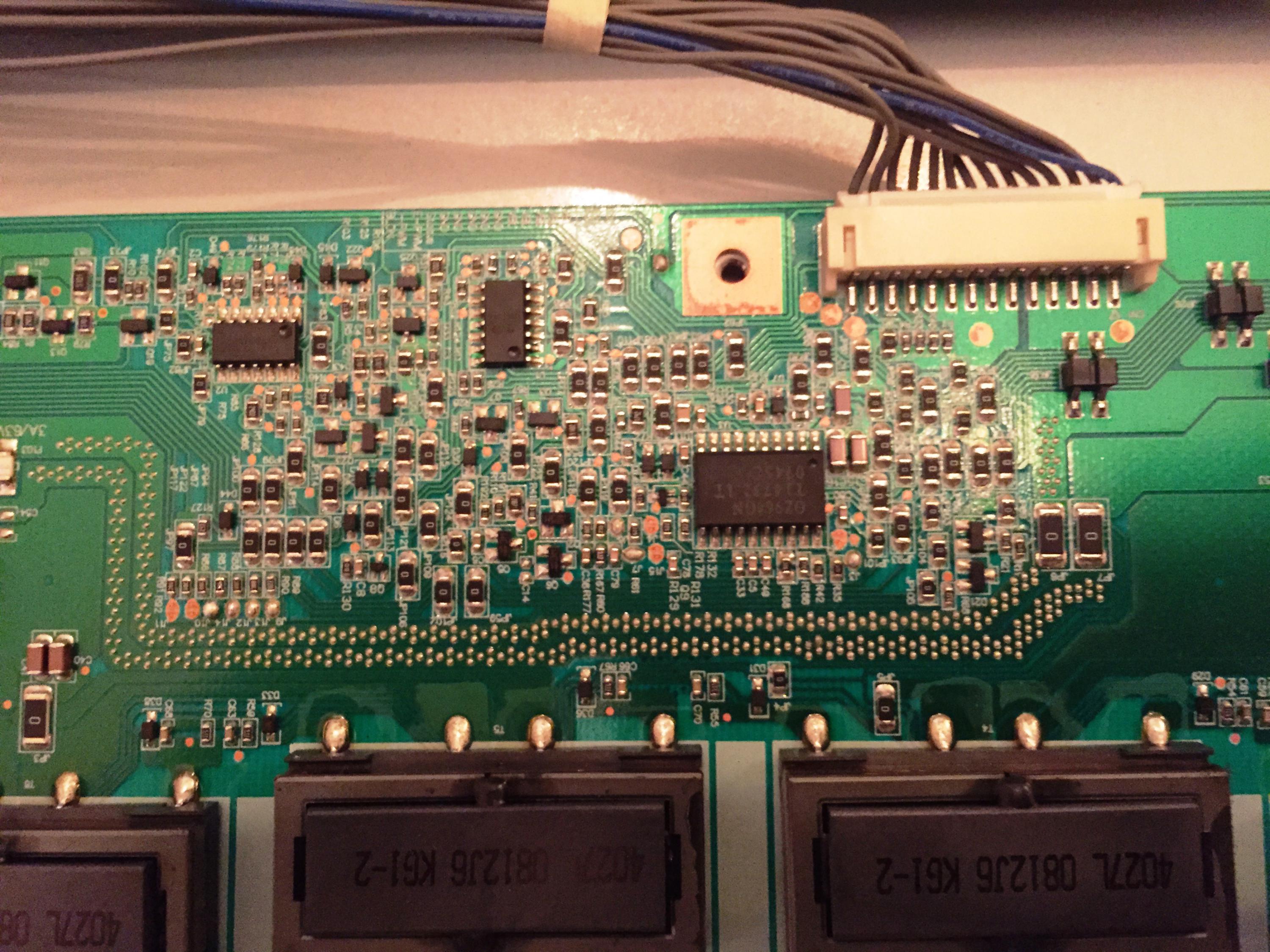

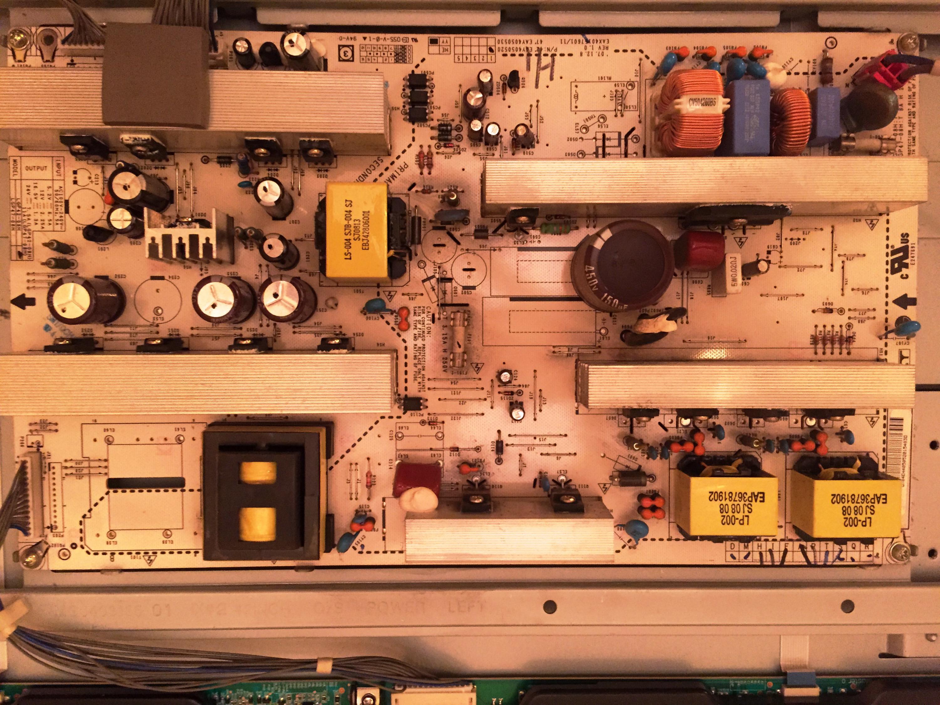

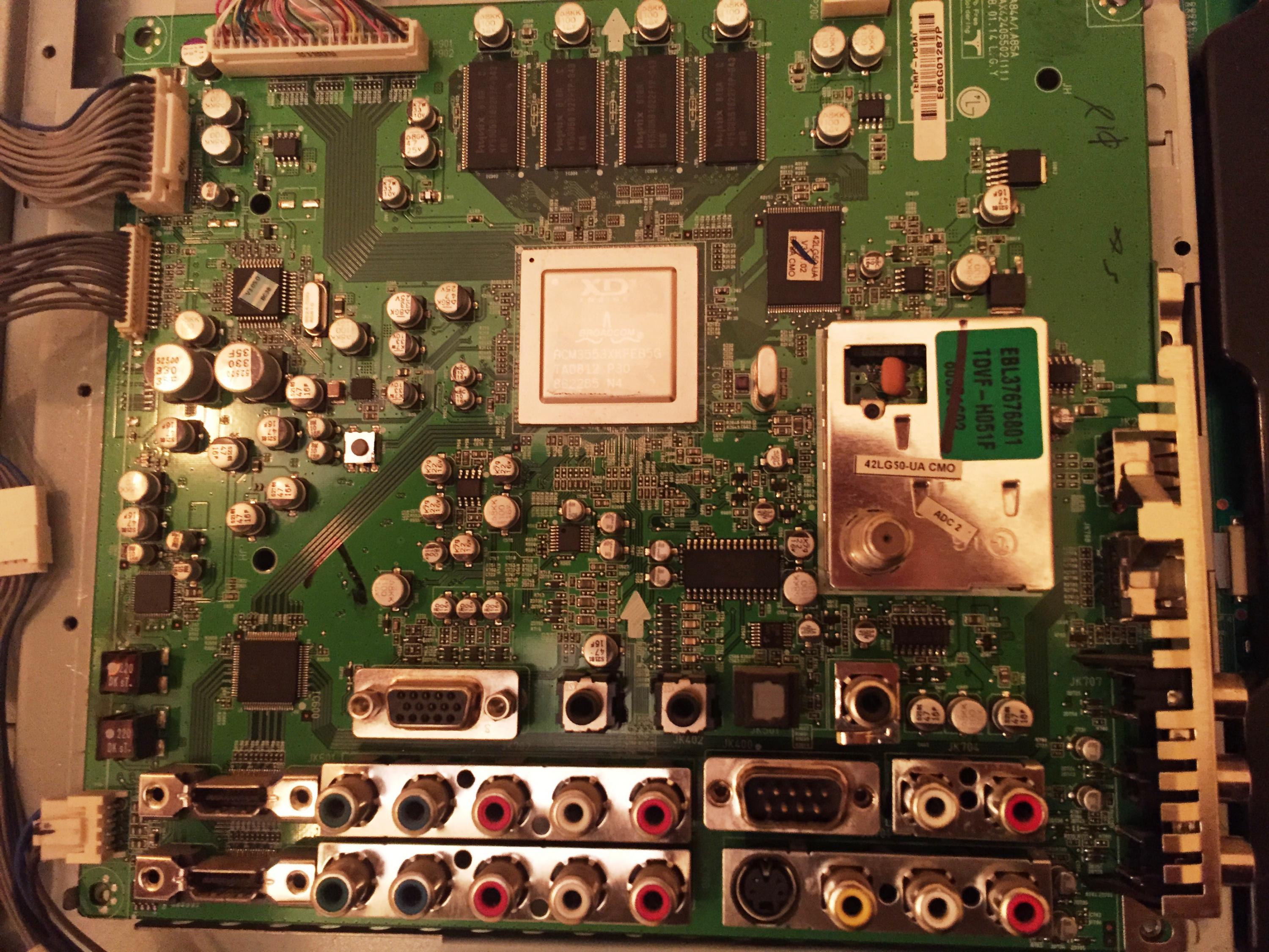

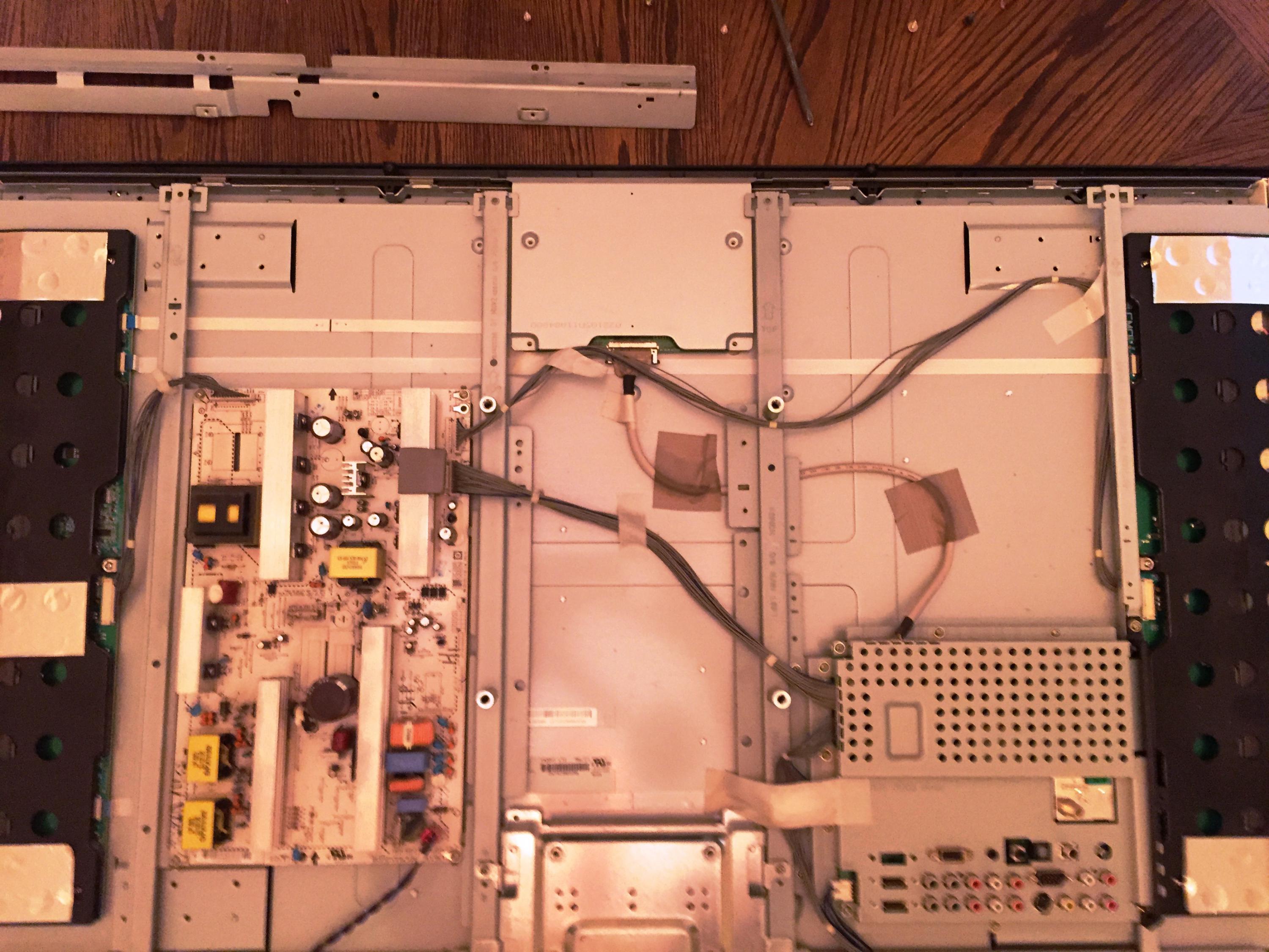

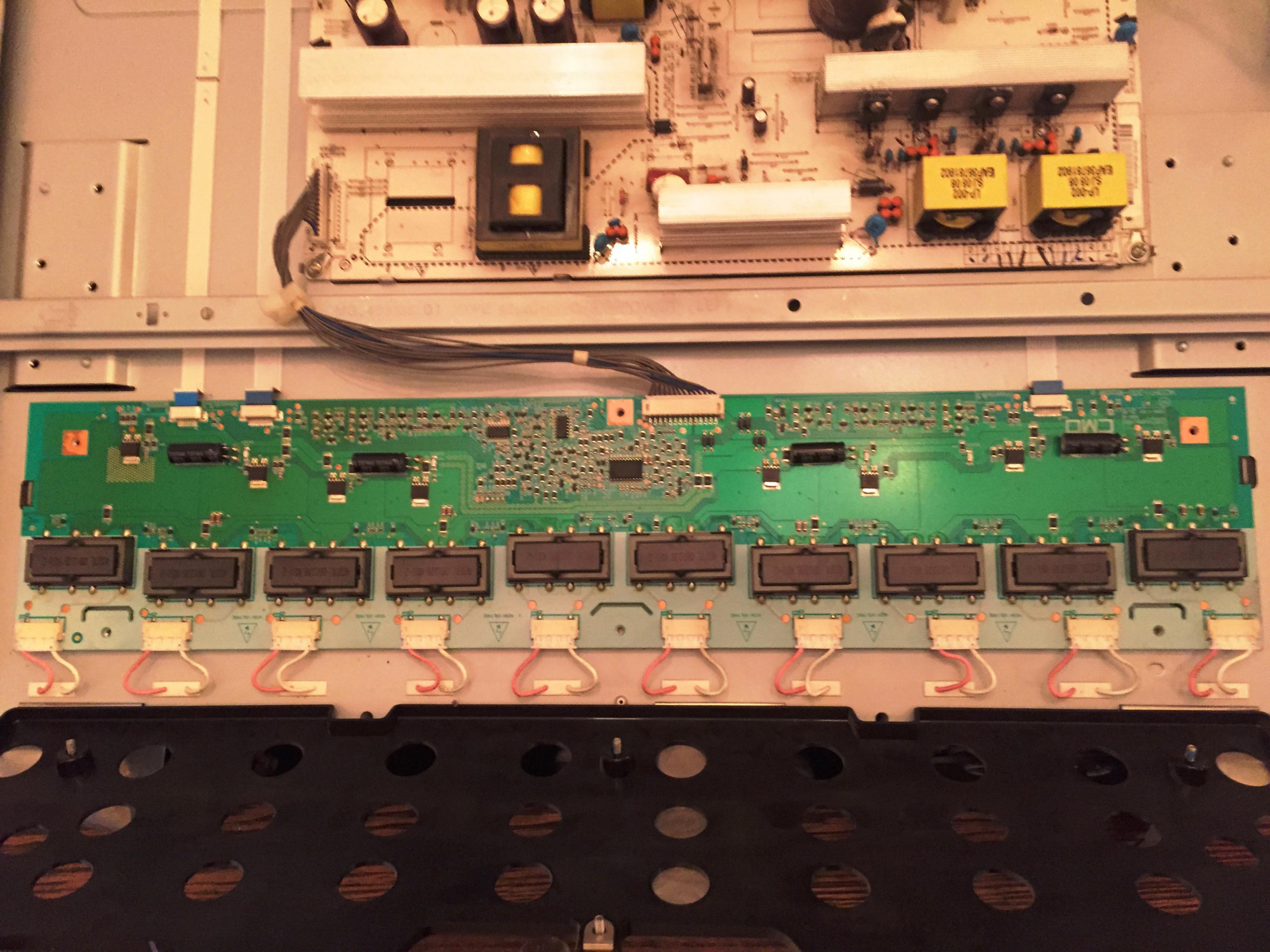

          I took these additional pictures of the TV set components.
            That looks like Gamma Voltages problem on the T-CON board, U7 is AS15??

              Thank you for the help budm. Is "U7 is AS15" a reference to a bad processor chip? Do you have a link to show the replacement of a T-CON board with similar connectors?
                AS15 is the GAMMA Voltage reference IC.
                Your T-CON board P/N is 35-D023305 as printed on the bar code sticker.
                http://www.shopjimmy.com/cmo-35-d023305-t-con-board.htm
                Please verify the numbers since your pictures are not in focused.
                You can also check the DCV of the Gamma Voltage test point #1~17 with reference to chassis GND.

                    14 Says yes the Gamma IC is bad.
                    Yes budm that is the correct part#
                    Replace T-con or if you are handy with a soldering iron or have a Hot Air station you can change the IC

                      Thanks to everyone who helped. @newtothis I ordered a new board. My hand isn't steady enough for soldering.@tom66 I read another thread you started on a different forum about the AS15 and AS19 ICs going bad. I have the AS19-H1G IC. I don't know if these events are related but my house was hit by a power surge which destroyed a couple battery chargers I had plugged in. That was about the same time the problem in my TV started. The TV is 6 years old. @newtothis are there any tips for replacing the T-CON board? Again, this is the first TV I have ever attempted to repair. I did read the manuals posted by budm.
