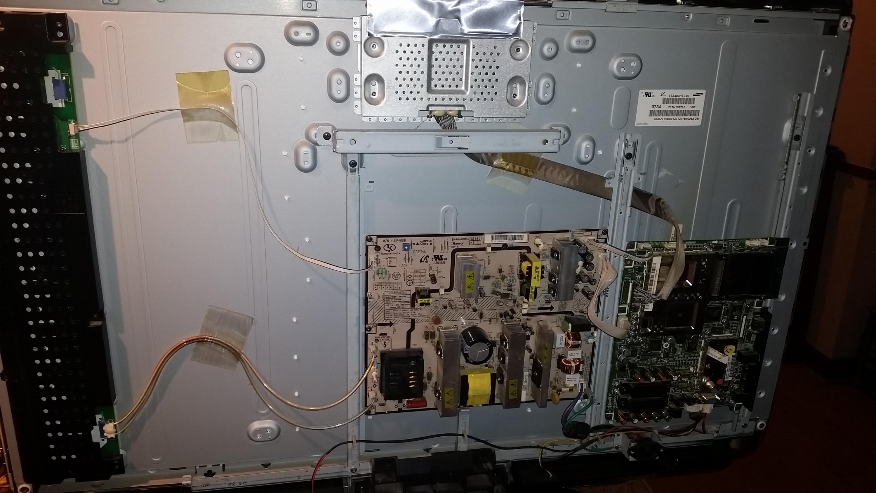

    hello
    tv keeps restarting itself voltages seem ok read it could be cold solder joints tried that tv worked all evening,but now this morning testing it again and the tv has restarted and is stuck in a loop of doing this
    just wondering if anyone has come across this fault ?
    thanks

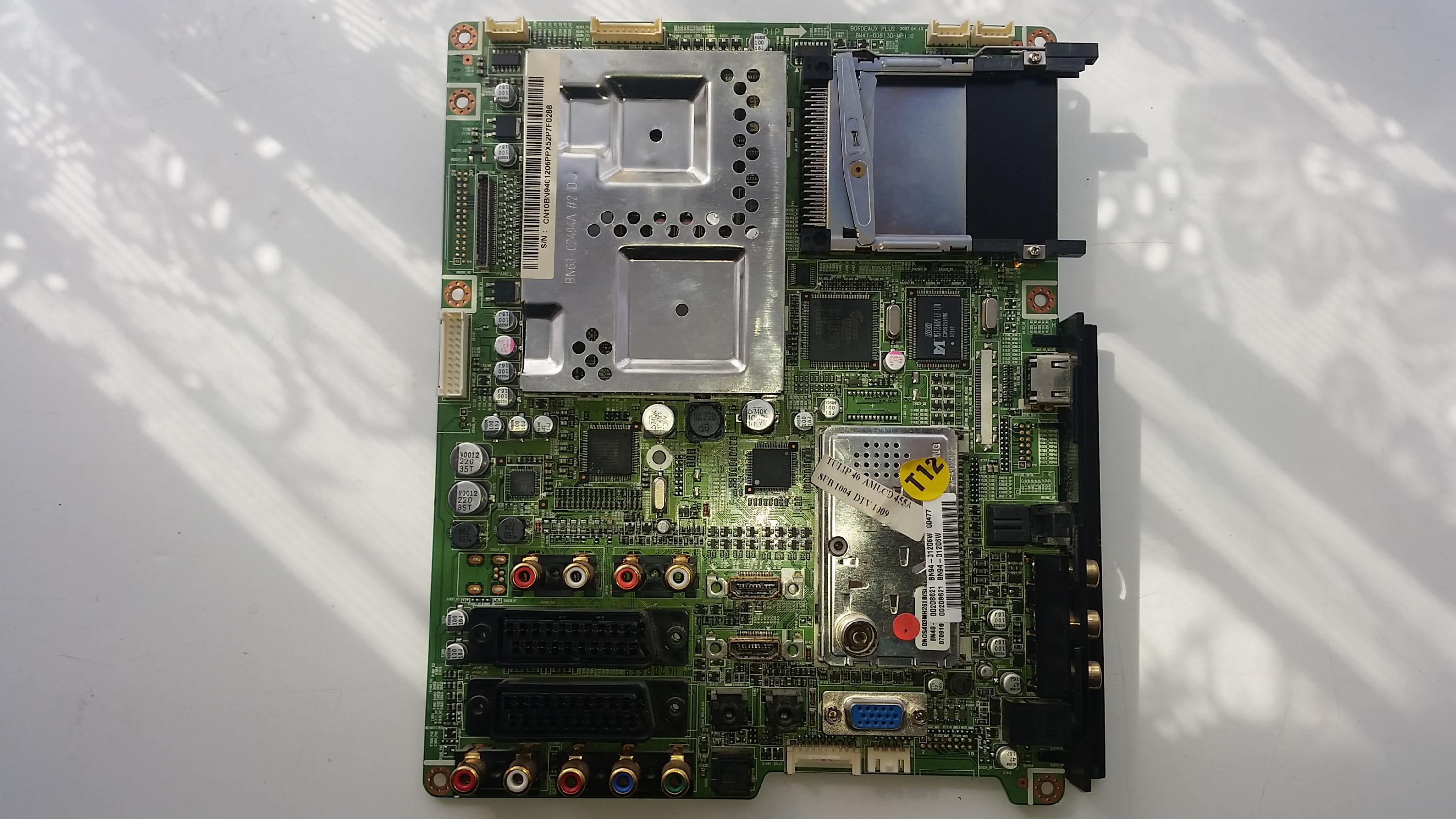

    Re: LE40M87BD restarting
    On these it's usually the main board at fault. cold solder under processor (BGA) or bad cap near processor.

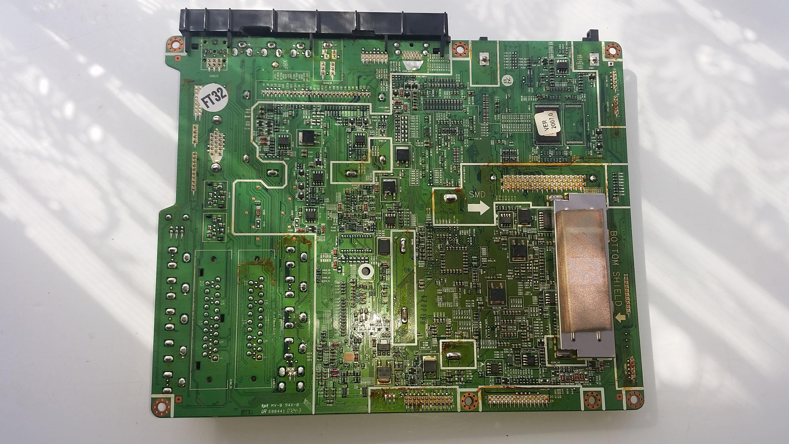

        tom do you mean under the metal heatsink with the caps etc ?
          Yeah. The shield is soldered down; Not done one myself though, so can't be sure on the exact parts that fail.

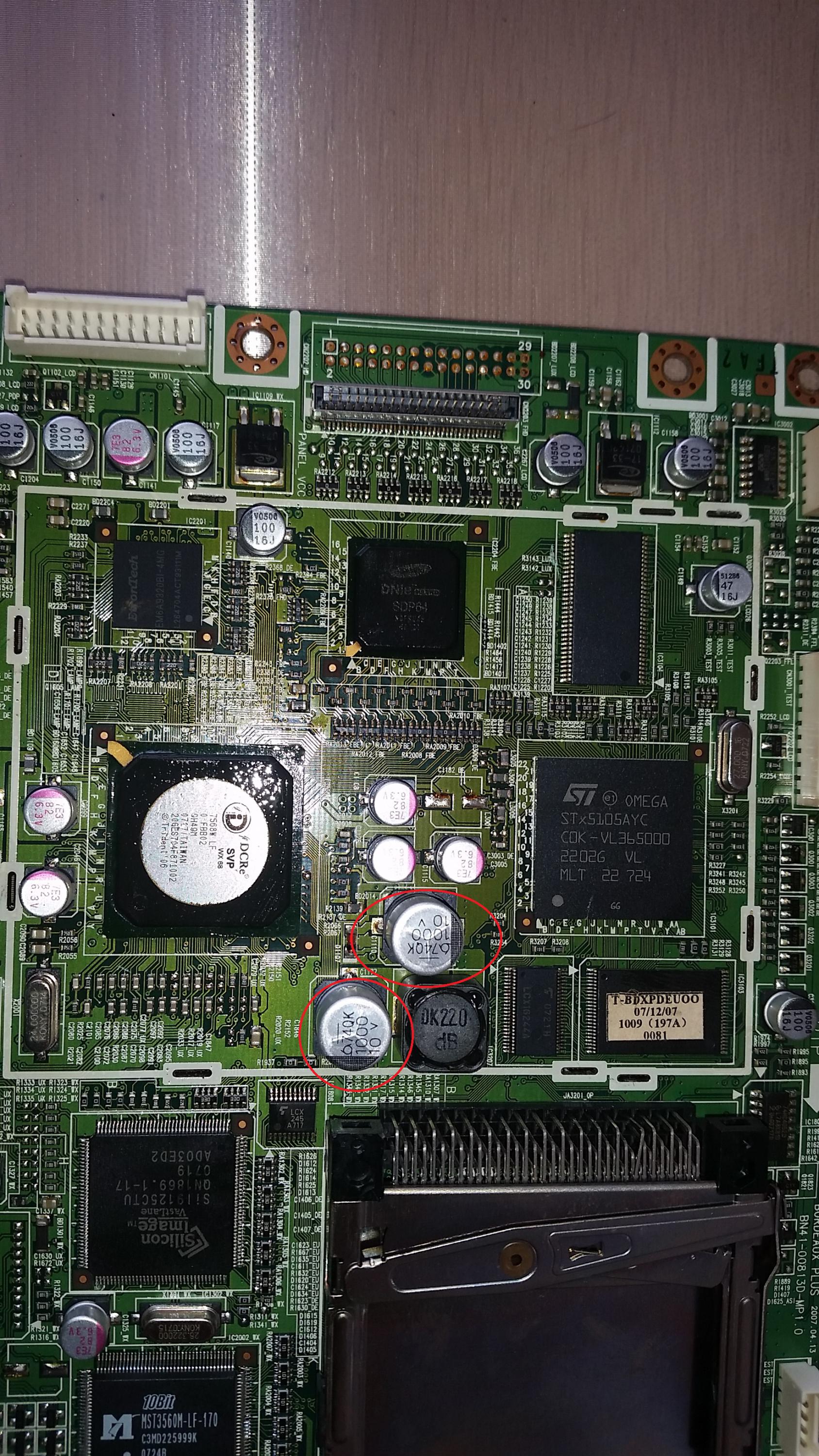

              thanks alastair i have highlighted the caps do you mean those two and can you point me to the 100uf caps please
                Yup--Those are the 1000uF caps...
                The 100uF ones are the three between the socket and the tinwork, (There's one pink-top poly cap-thats usually OK in the row) plus the couple that run at right-angles to that row and along the bottom of the tinwork--All can be suspect....
                Bung a 'Scope on them--You'll see horrible switching noise/ripple on 'em....
