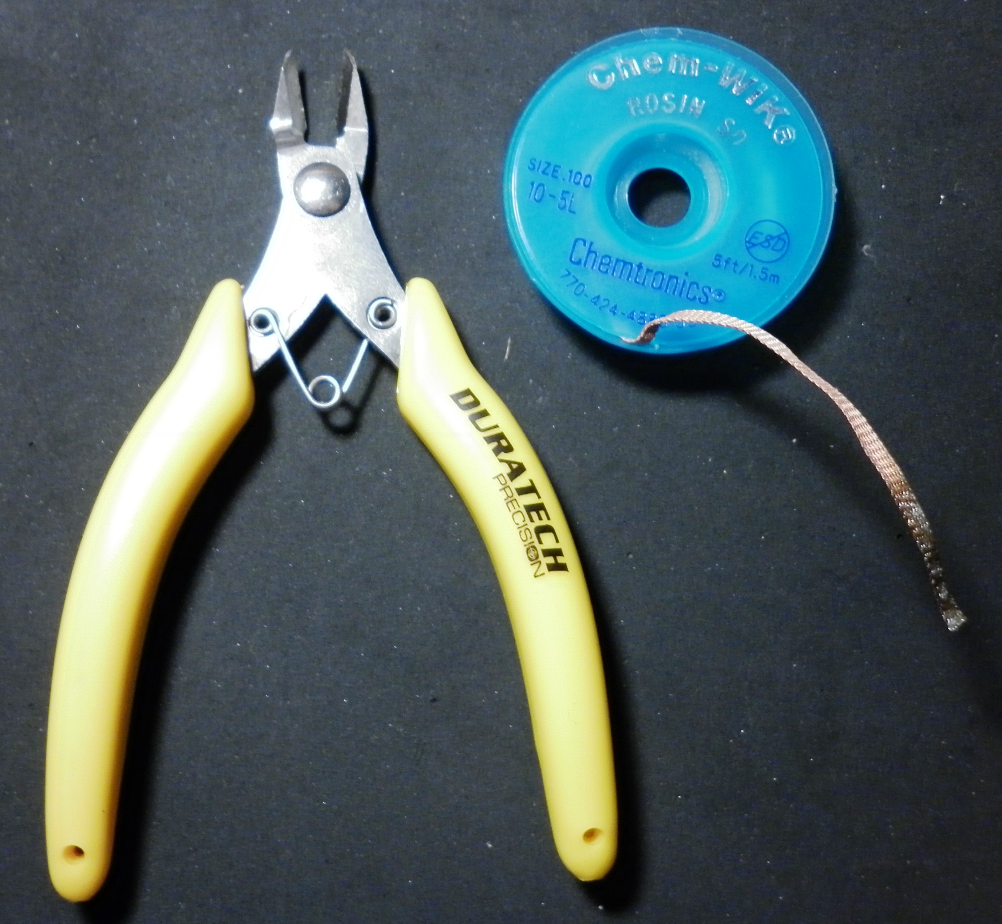

                  Here's another way to remove those M81737 Ics, use a precision set of cutters and carefully nip the legs against the casing. Desolder the remnants, use a quality braid like chem-wik to remove all solder , clean with IPA, get some flux or flux pen and prep the pads and legs, tack 2 corners to get it nicely in position and use fine solder and fine tip.

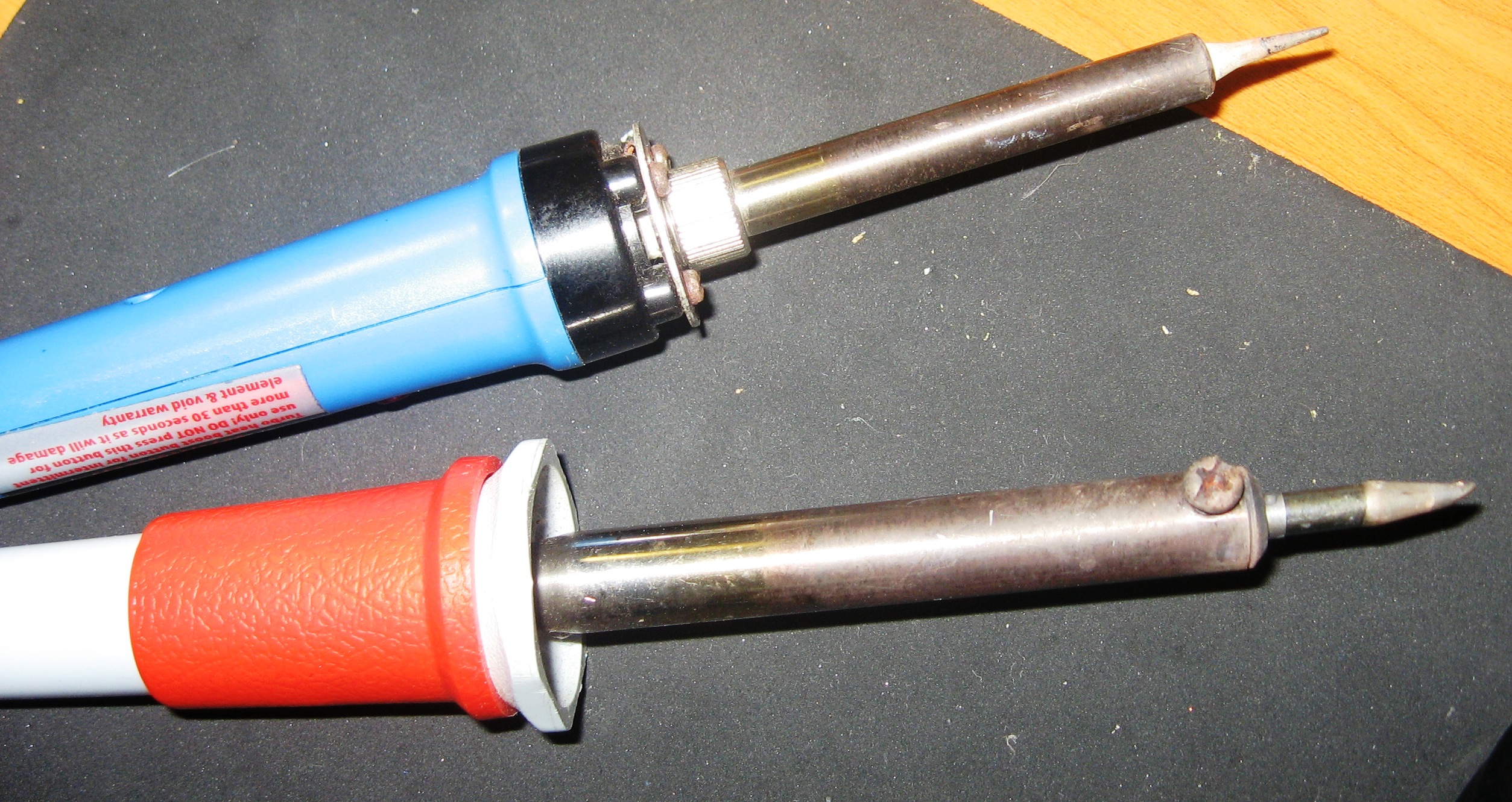

                          I only have the most basic gear, use 2 irons to remove these smaller items heating both sides and use the tips to move them. I have a headband magnifier and a 5x loupe to get a good look at the finer pitch items like those 20 pin octal buffers which are large compared to the 5081 boards. have tried flooding the pins on the FET drivers but mixed results and the heat easily lifts the no connection pads plus very cramped.
                          I think anyone who has hot air and experience may do a better job.

                          Cutting the pins makes it easy and I think once you've done a few for what these parts cost better to just replace and treat these drivers as suspect but I must admit with so litle blown on my first 4782 I got lazy and skipped it.

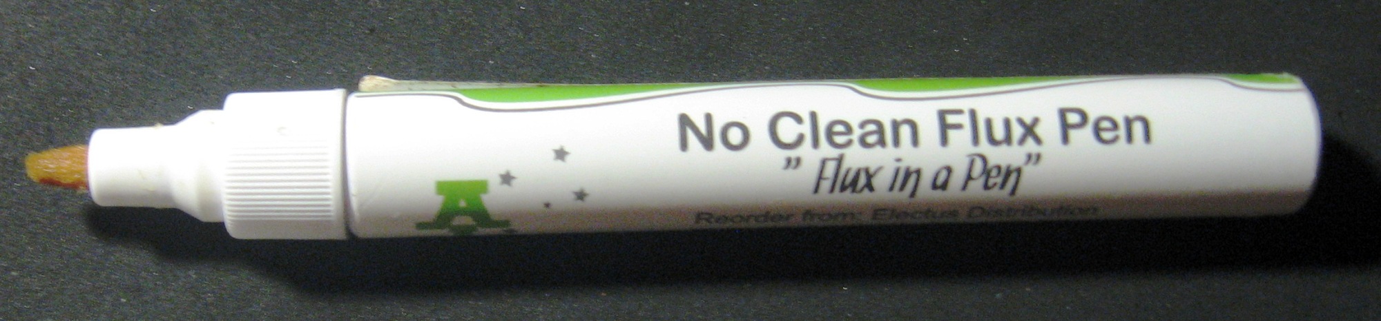

                              Oh, I should mention FLUX, flux pen, makes a world of difference and flows so nice which is what you need to avoids bridges.

                                my 2 very cheap irons, 20W & 40W with a quality tip in the 40w
                                Also a set of quality fine tip tweezers is handy for handling and placement of the SMD stuff

                                  cool thanks i have most of the stuff already minus flux pen (have you got a link which one you use) also need a jewlers loupe they always come in handy i guess cheers again.
                                    No, just a generic flux pen from a local electronic shops Jaycar. Called No clean flux pen. They're not cheap about $12 AUD but for this work I find it invaluable.

                                      Re: TH-P50G15A - 6 Blinks- Bad TNPA4782
                                      maybe something like this but it's a pack of 5 so over 20GBP
                                      http://uk.rs-online.com/web/c/?sra=o...hTerm=flux+pen
                                      http://uk.rs-online.com/web/p/solder-fluxes/2513637/
