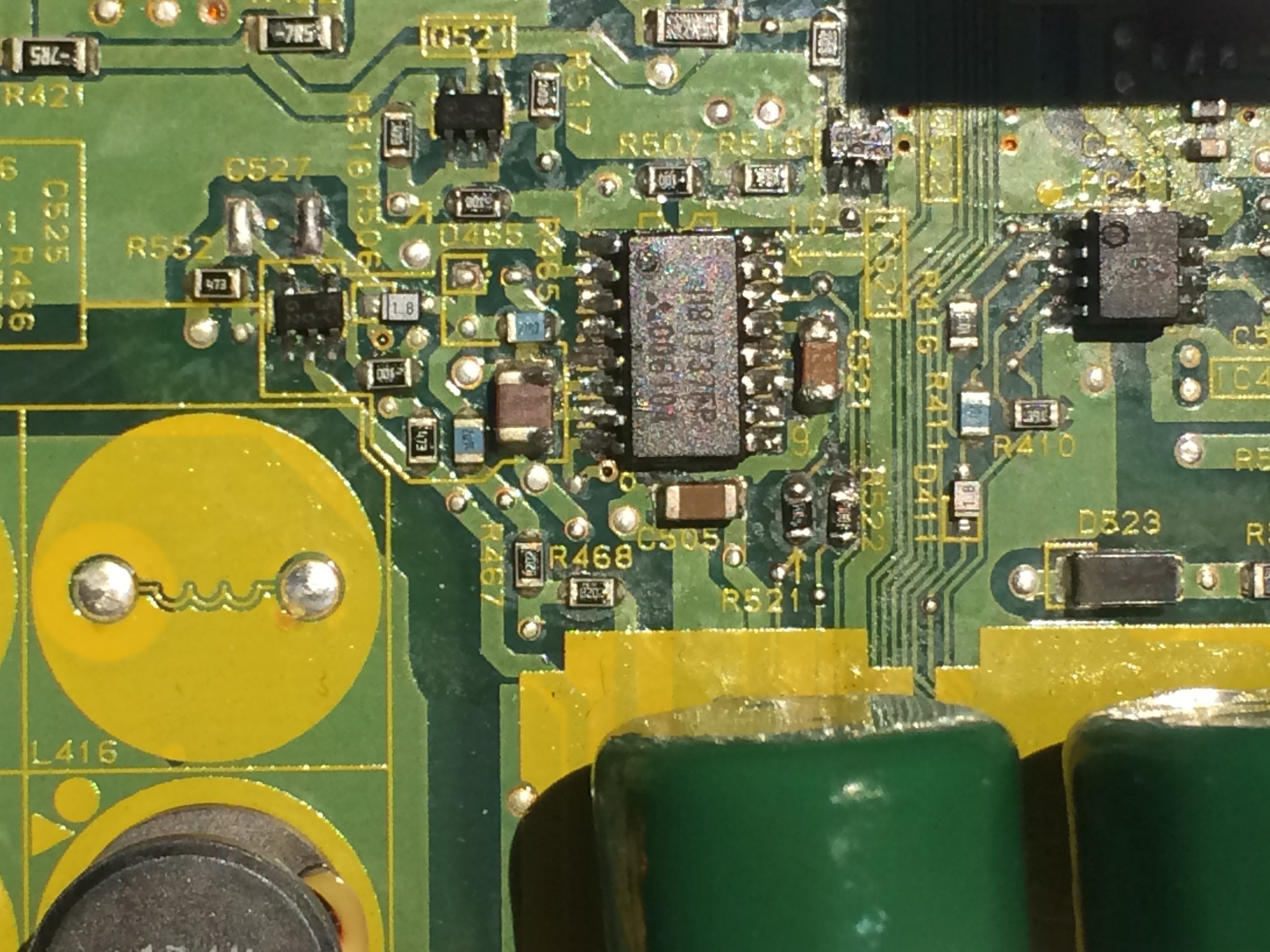

TH-P50G15A - 6 Blinks- Bad TNPA4782
  • tw2005
    • Oct 2011
    • 6458

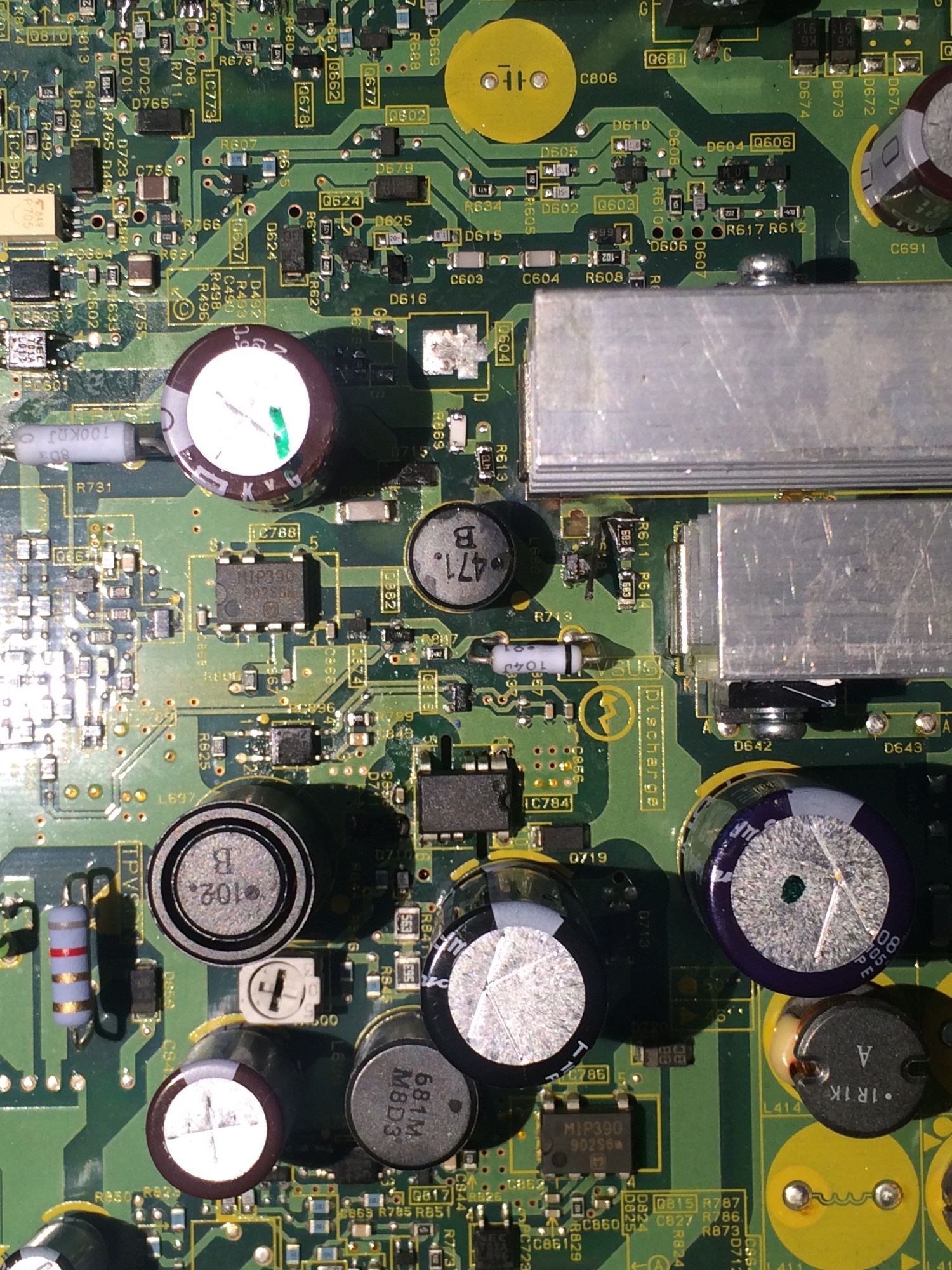

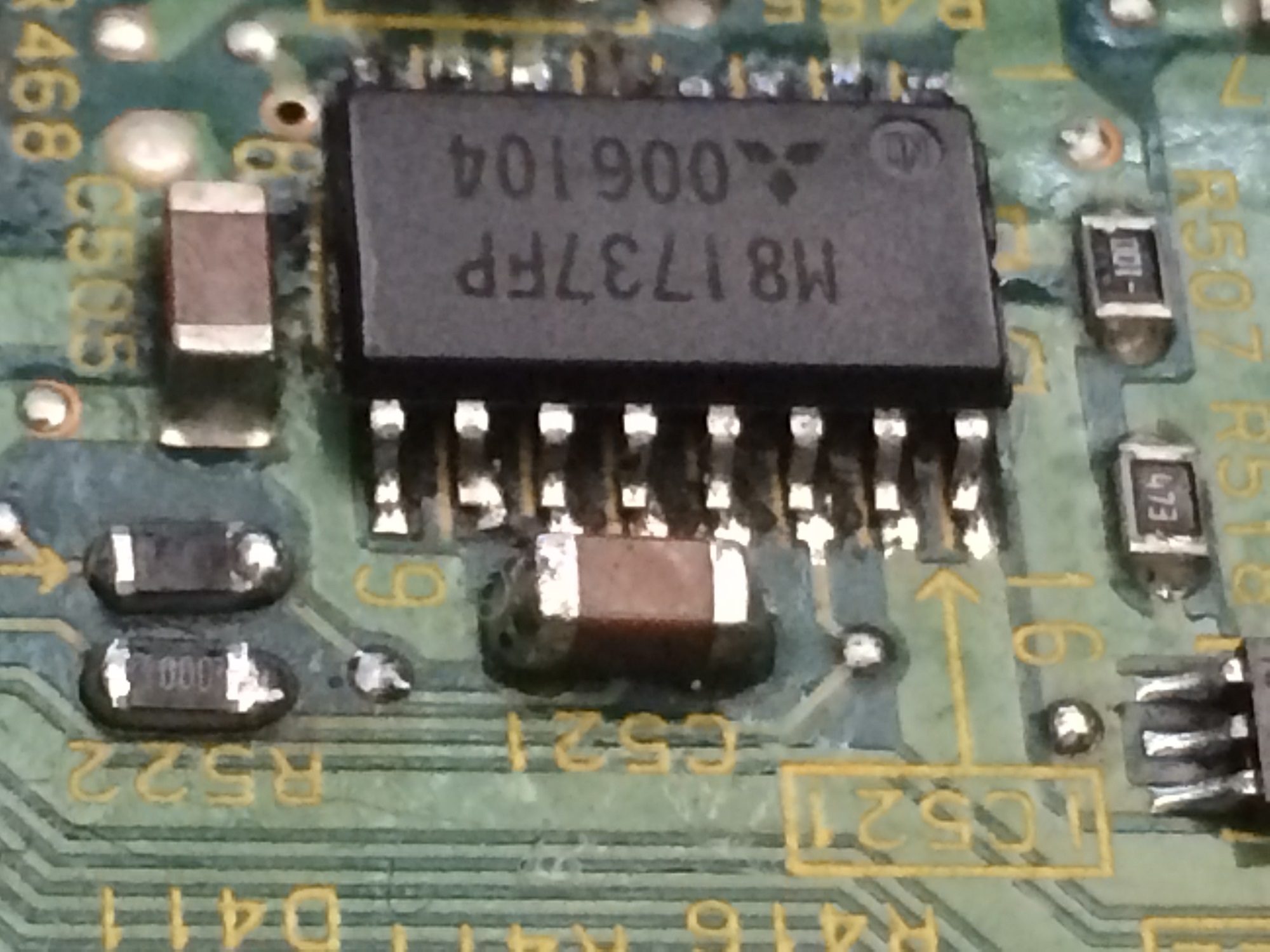

    #101
    Re: TH-P50G15A - 6 Blinks- Bad TNPA4782
    Also close ups of ic521 including q551 and ic501 please
    • tw2005
      • Oct 2011
      • 6458
      #102
      and ic773

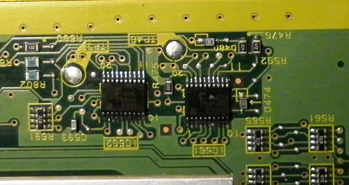

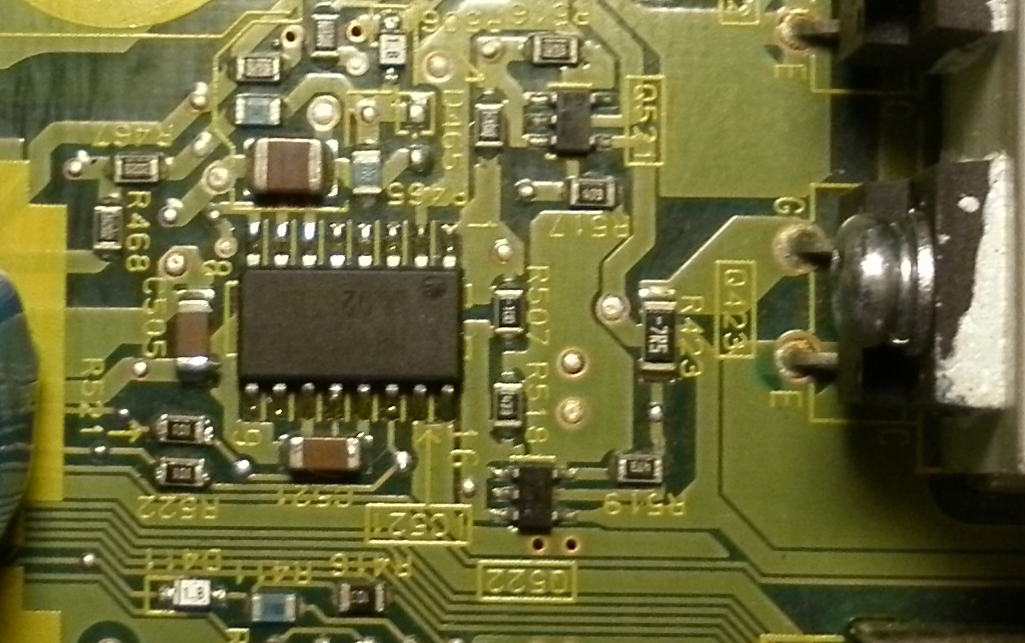

          #104

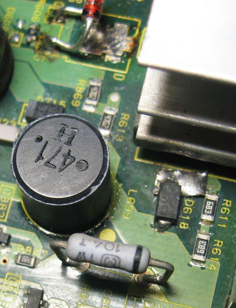

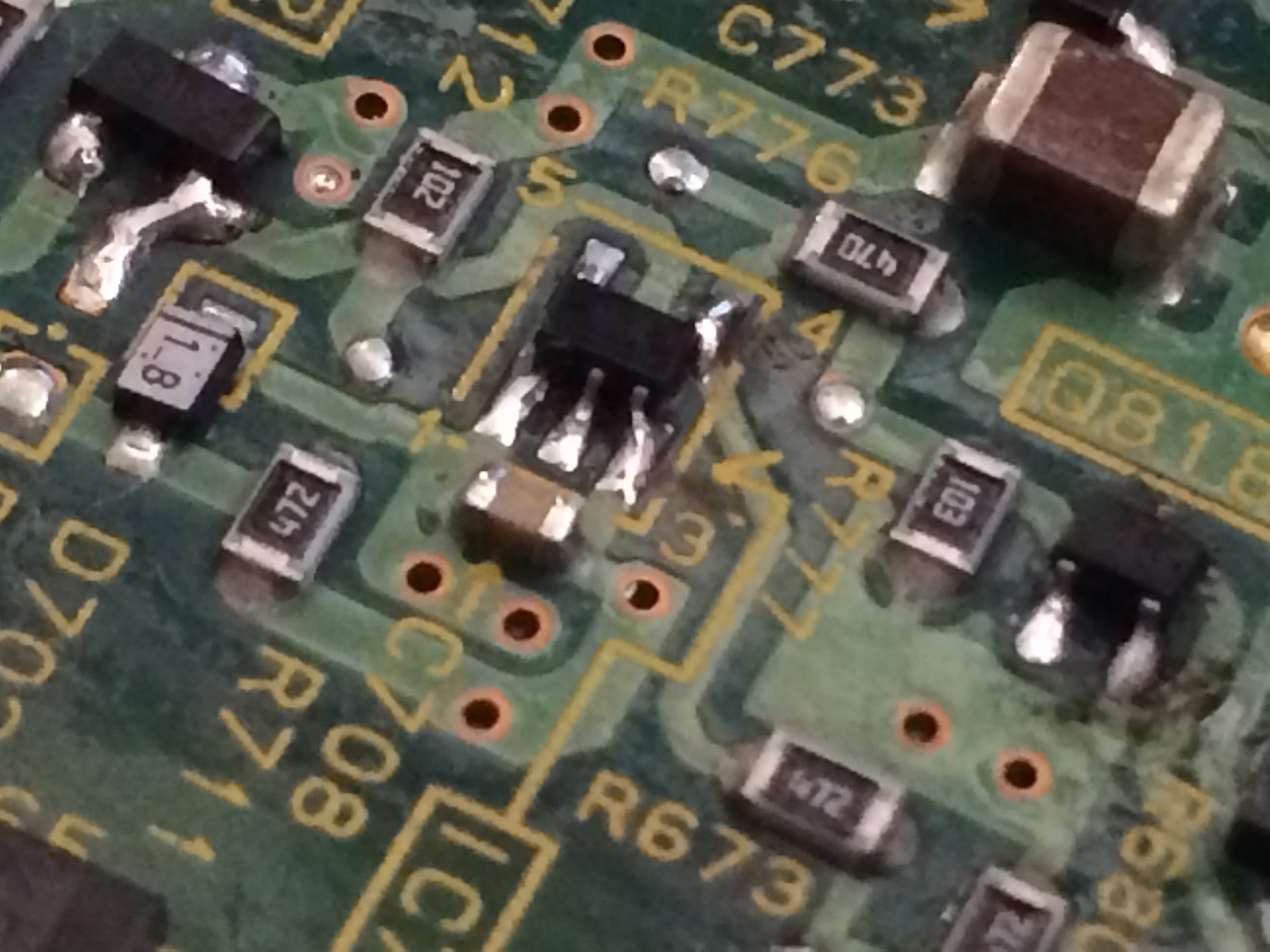

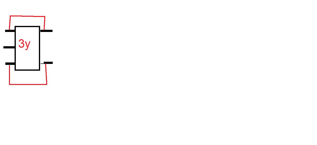

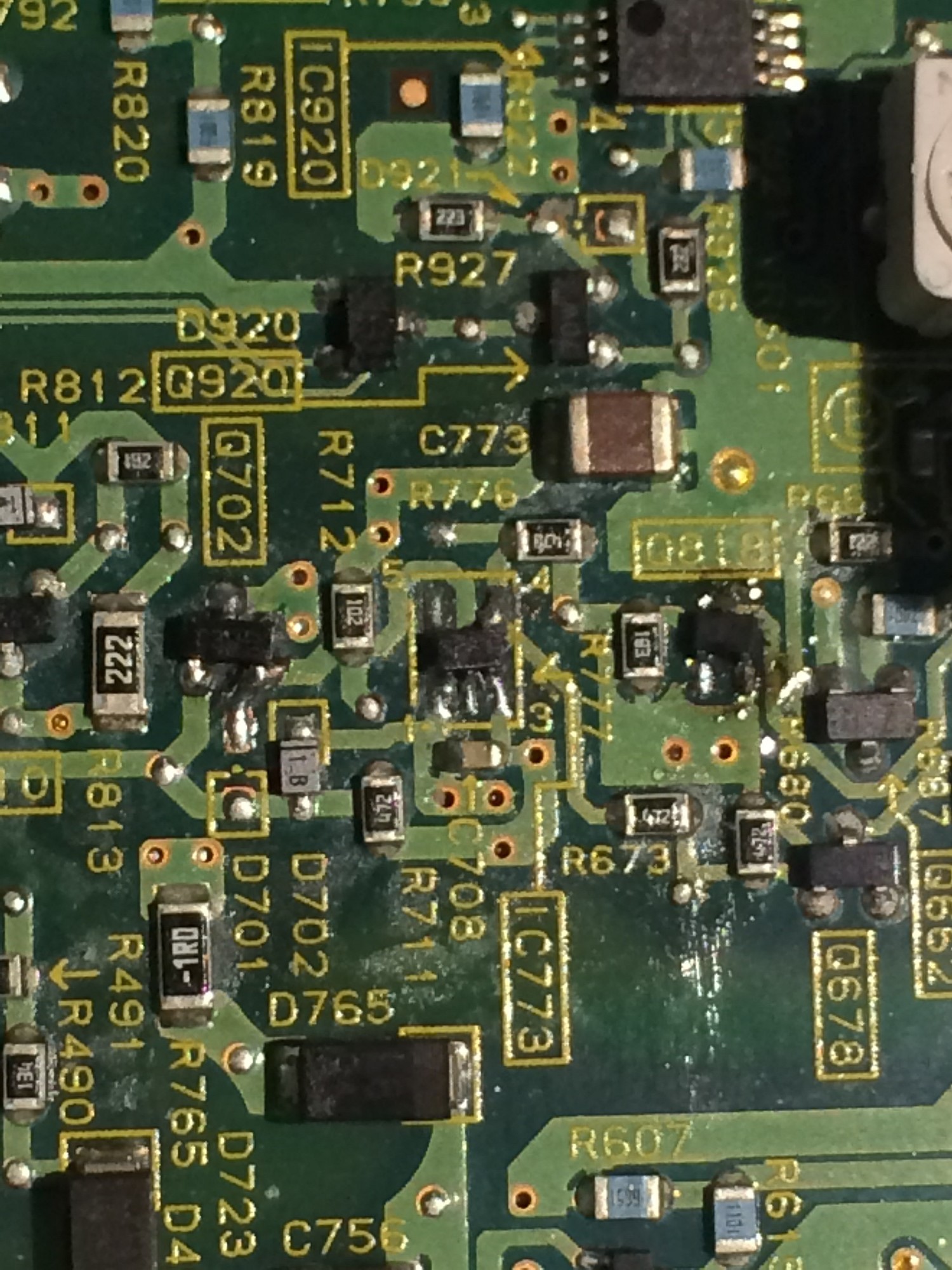

          Originally posted by Glitcher
          Here you go, and yes R451 and R441 measure 5.6 ohms
          picture#1
          confirm from blob of solder on underside of r869 has continuity to Gate of missing Q604
          D618, I can't make out the diode at all. I see the hard wire in the air. How's that set up? ids the white band of the diode soldered to that wire?
          Picture #2
          double check there's no bridges or little balls of solder between the pins, 10 & 11 looks sus but not clear
          R521,522, what marking is on them? Do they measure 100 ohms
          Pic 4 , check pins 2,3 for any dags or bridge ic773
          D652 in front of Q660 did that check out?
          I've attached how I rebuilt the track for D618 using some used braid

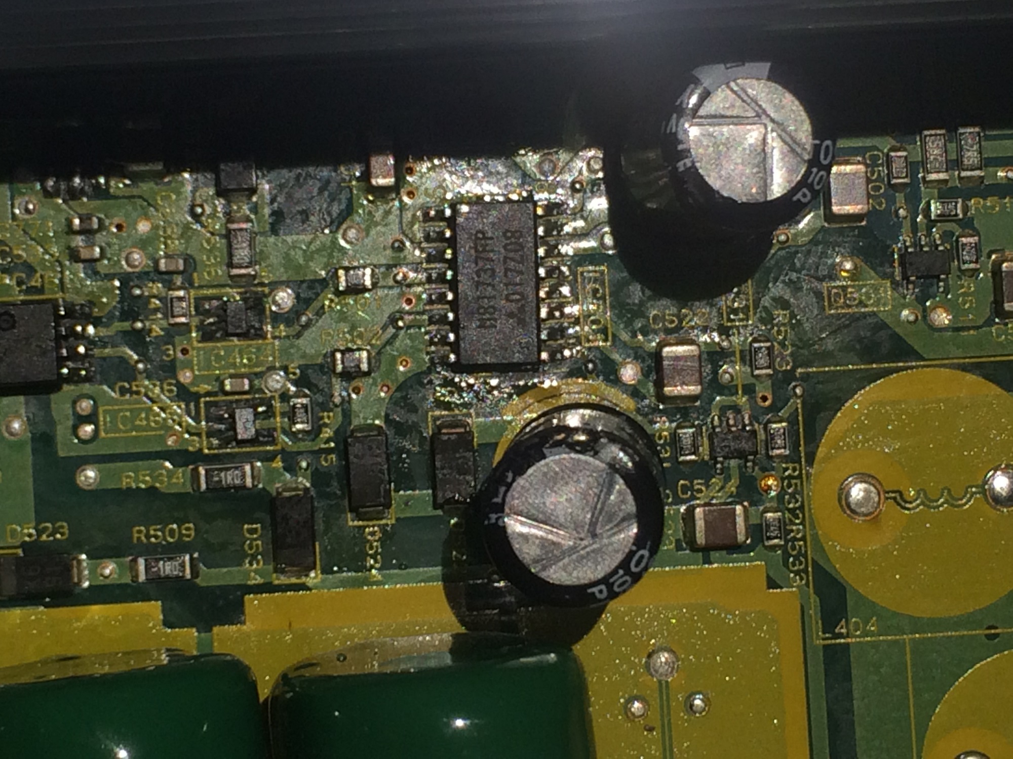

            #105
            Yep R869 has continuity to the gate of Q604. Also measuring from the top of R613 and Q604 G gives me around 42k ohms.
            D618 I basically soldered it upright with the wire connected to the top of the diode (white band) and other end of wire to the end of R611.
            R521, and R522 are marked 1000, measuring 100 ohms both.
            D652 measures 0.482, OL
            Rechecked and resoldered some of the ICs, a trace came off from IC521, but looking on the datasheet it seems to be NC so I don't think it should be a problem.
            I just noticed that C691 (The big electrolytic cap near Q661) won't dissipate its charge. I left the board over night and this morning still got a little shock from it.

                #107

                    #109
                    I got another, opto pc461, right in the middle between the 2 fet drivers, diode mode red lead on 5, then probe 6 & 7 with blk = 0.535
                    red on #1 blk on 2 = 1.45, reverse 1.7
                    red on #3 blk on #4 0.745 reverse 1.35

                        #111
                        well it's all matching and thats from those IGBTs that produce the MID right throught to the drivers. I can only wonder now about ic561,562 how cleanly you've soldered those or whether there are any of those pins shorted because the drive signal come from those.
                        If you can get pictures as good as the last for them. Do you have a jewellers loupe or get really good look at the pins just in case?
                        1 am in 8m minutes that's my deadline, may not see your reply.

                          #112
                          IC562 has the drive signals for both those fet drivers
                          • Glitcher
                            • Mar 2013
                            • 673
                            • USa

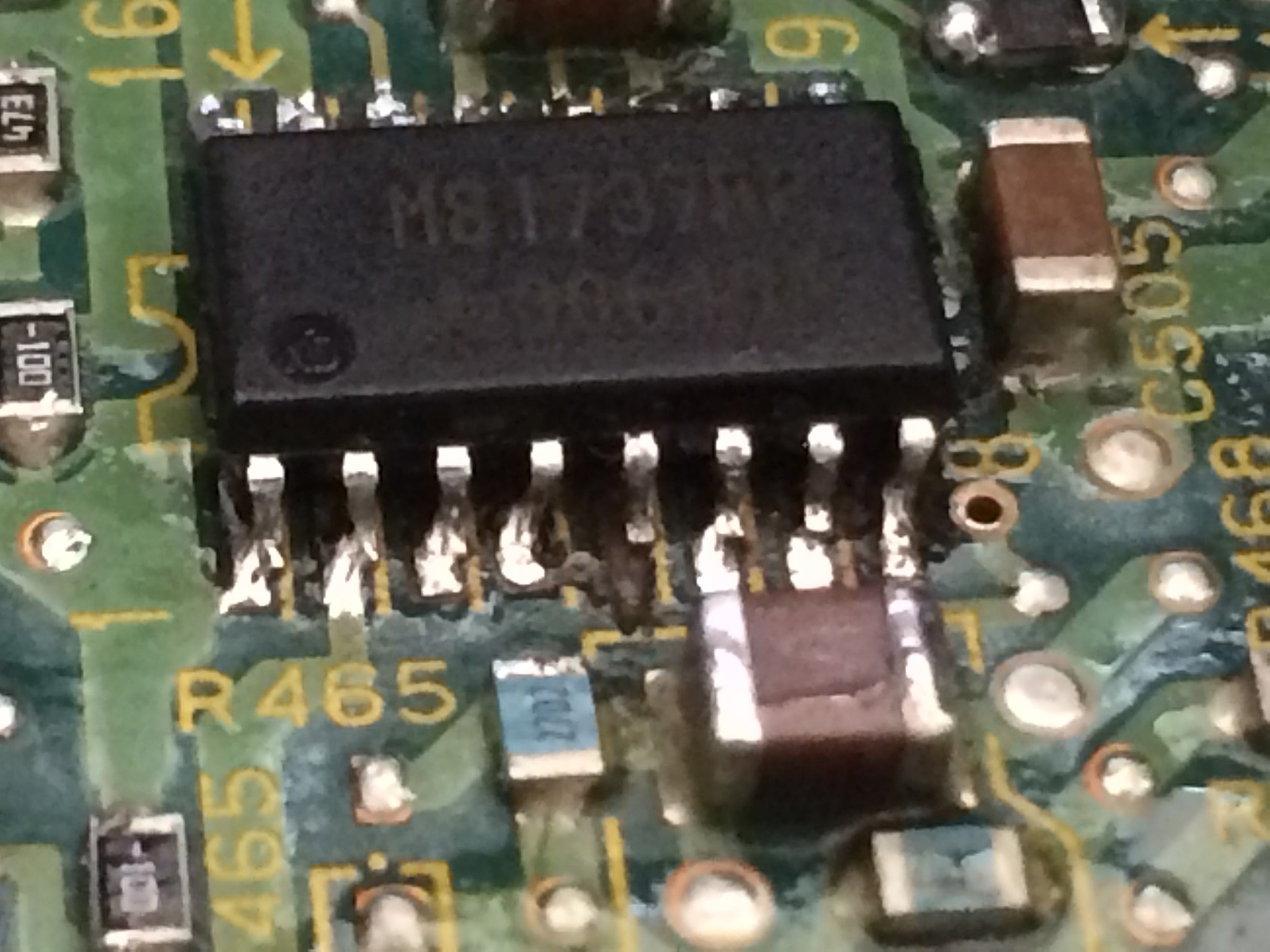

                            #113
                            Progress!!! I decided to put back the original IC563 and finally it stays on! So it seems it does run without the Q604 FET.
                            Now I just need to make sure there are no problems with the buffers before I put them back on.

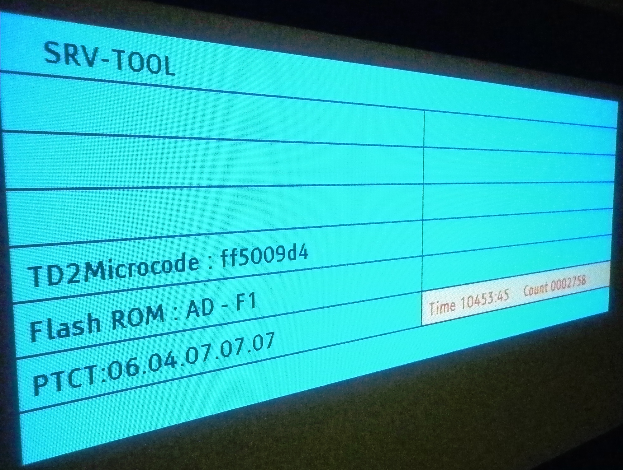

                                #115
                                sounds good. Any particular reason you decided on 563?
                                I'd like you to try something once it's running. Go into serv tool and get the hours. then on the remote hold the return button to force the tv to reset and start again. I'm looking for it not to start and go 7 blinks. Turn off then turn on and see if it starts normal again.

                                  #116
                                  I had a feeling about the spare that I salvaged from another board and I remember you said that your ic563 survived so I assumed mine could of also and I replaced it back to the original.
                                  How do you get into serv tool?
                                  • tw2005
                                    • Oct 2011
                                    • 6458
                                    #117
                                    page 8-10 in the service manual TC-P50S1. Once you are done with srv-tool, press and hold the return button to force the TV to reset. let me know what happens.
                                    • tw2005
                                      • Oct 2011
                                      • 6458
