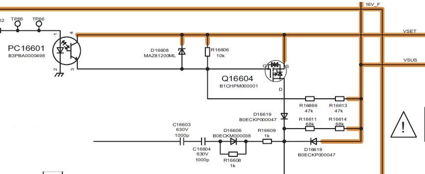

    Any chance we can start referring to D806 as d608, i keep looking for a diode that does not exist
    Ahh sorry bout that, Don't know why I keep getting them confused. Must be from a past board I worked on.

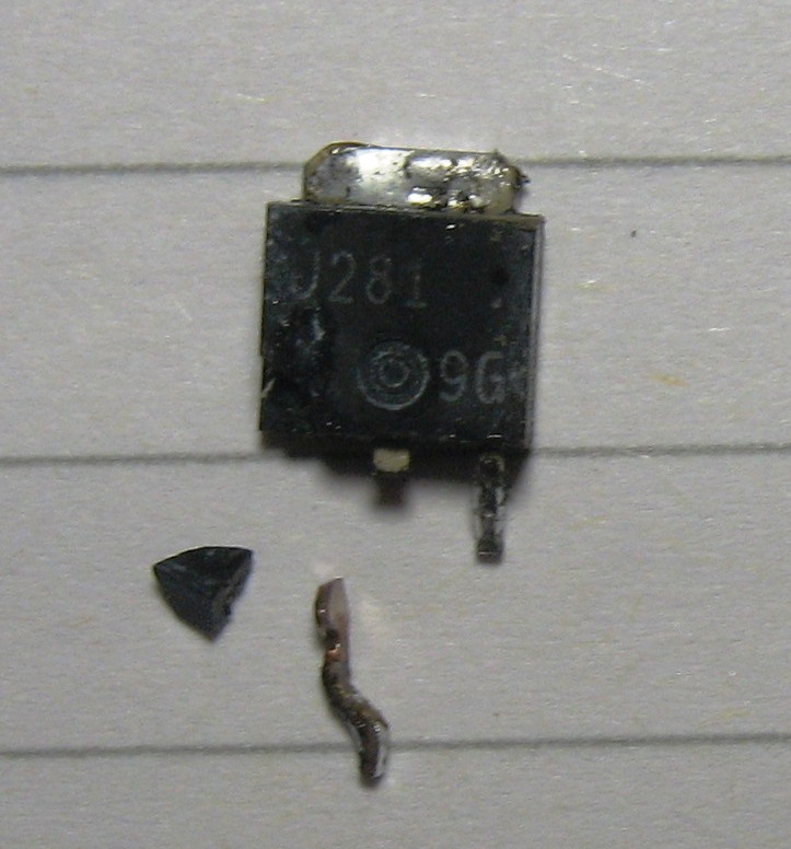

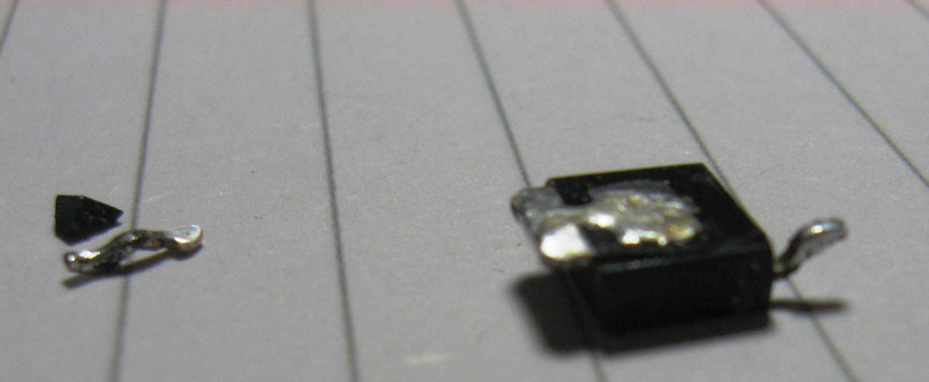

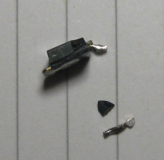

      well game over for my board. just destroyed the Pfet. casing cracked and leg fell out.
      bugger
      Not sure you're on the right track though as i get the same results with the FET out. I don't think you can get more open cct than what i got with no FET at all now!

        Dang that sucks wait are you getting the same readings on the pads with the fet removed? As in post 53?

          FQD4P25 may be ok not that helps me find one any easier
            yep little or no difference. you never know but maybe my fet was open ? I actually wanted to test the FET out but that chance is gone

              Actually, i was being sarcastic and now i'm not joking but I think this FET is shot. the whole casing is cracked that's why that leg crumbled out. But this board was working like this except that anomally I discussed with Tom. Which brings me back to these boards working with this part of the cct omitted.
              So maybe get a FET, I am LOL.

                Even with the FET removed I'm still not getting the same readings as you. I'm thinking theres a problem somewhere in the area where D608 is. My D608 reads .707 and OL

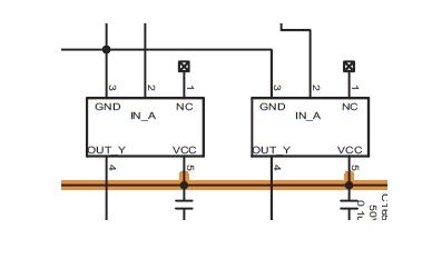

                  Try opto PC601, they're pretty common on sc,ss boards if you have scraps

                    Just tested PC601 out and changed it, doesn't seem to change my readings for D608 though. I was trying to replaced some extra parts IC464, IC465 near the M81707 FET drivers to be safe but ended up peeling these traces off... Barely even touched it with my iron and it came right off for both of them too! it doesn't seem like the trace goes anywhere, are they just place holders?

                      Pin 1 is NC. Well that's pretty rough. Do you have flux pen and a very fine conical tip?

                        What exactly is NC?

                            What exactly is NC?
                            No Connection

                              So I guess I'm fine without those traces? Explains why it would peel off so easily I guess.

                                  answered in post #40 but now with this huge 1watt zener 0.663 & 1.7.
                                  Its that 1.7 that's different from mine. I'm getting 0.704 & OL.

                                    blk lead on D, I get is 9.36k G-S, ol on any other
                                    red lead on D, 2.26Meg D-G, 2.31Meg D-S
                                    blk lead on D I have 9.75k G-S, ol on any other
                                    red lead on D 7.35Meg D-g, 7.34Meg D-S

                                      I get about 9.5k in either direction and there's a 10k rsistor across where we are testing> I don't think we can get clear picture of what's going on and I can't see where to go next or if i's worth the time

                                        Is d619 ok?

                                          Well going through all the IGBTs again I just found Q660 is short... I didn't replace this one yet since it wasn't shorted the first few times I went over it.
