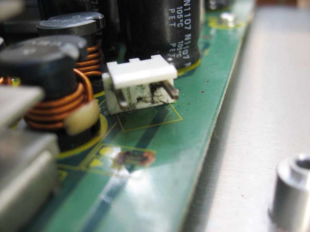

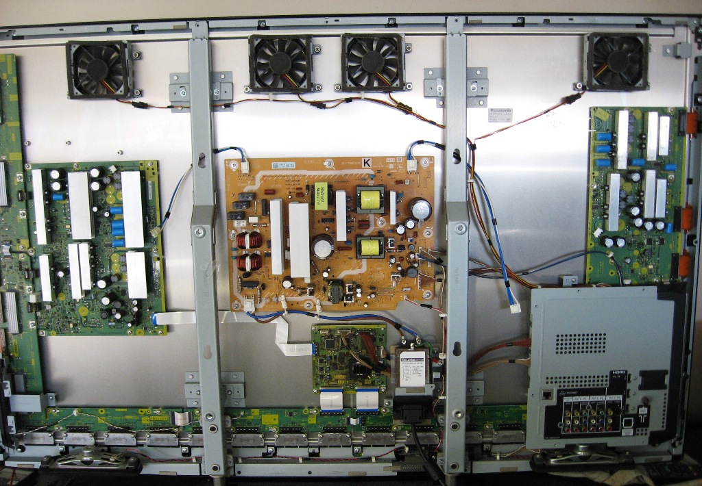

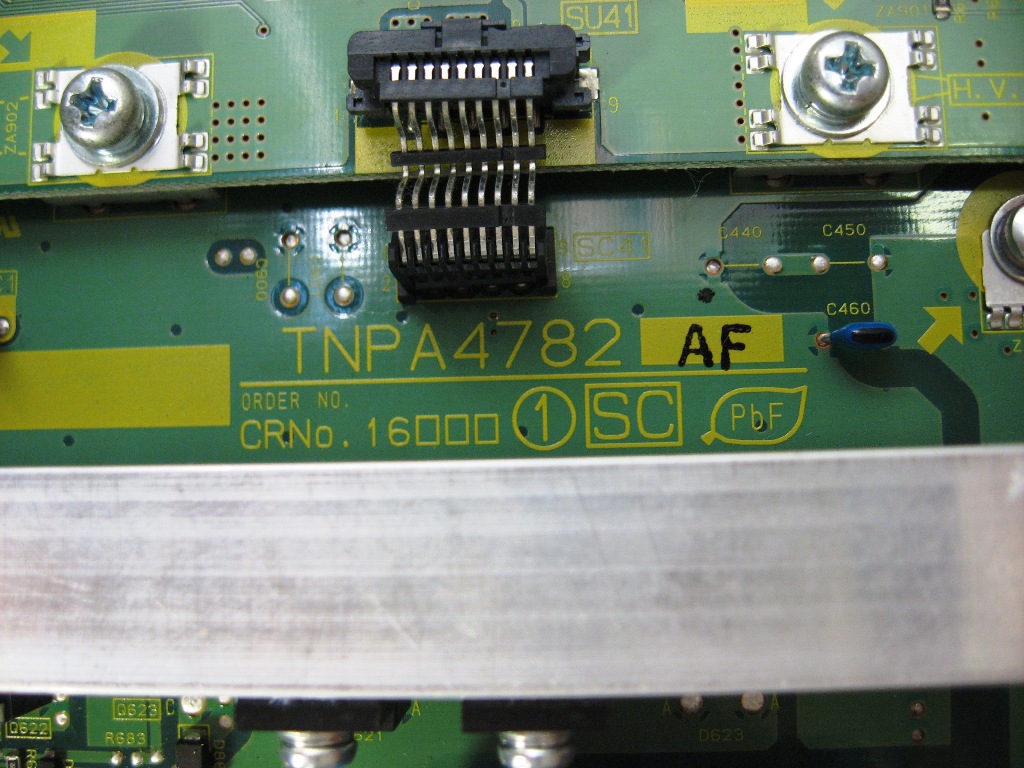

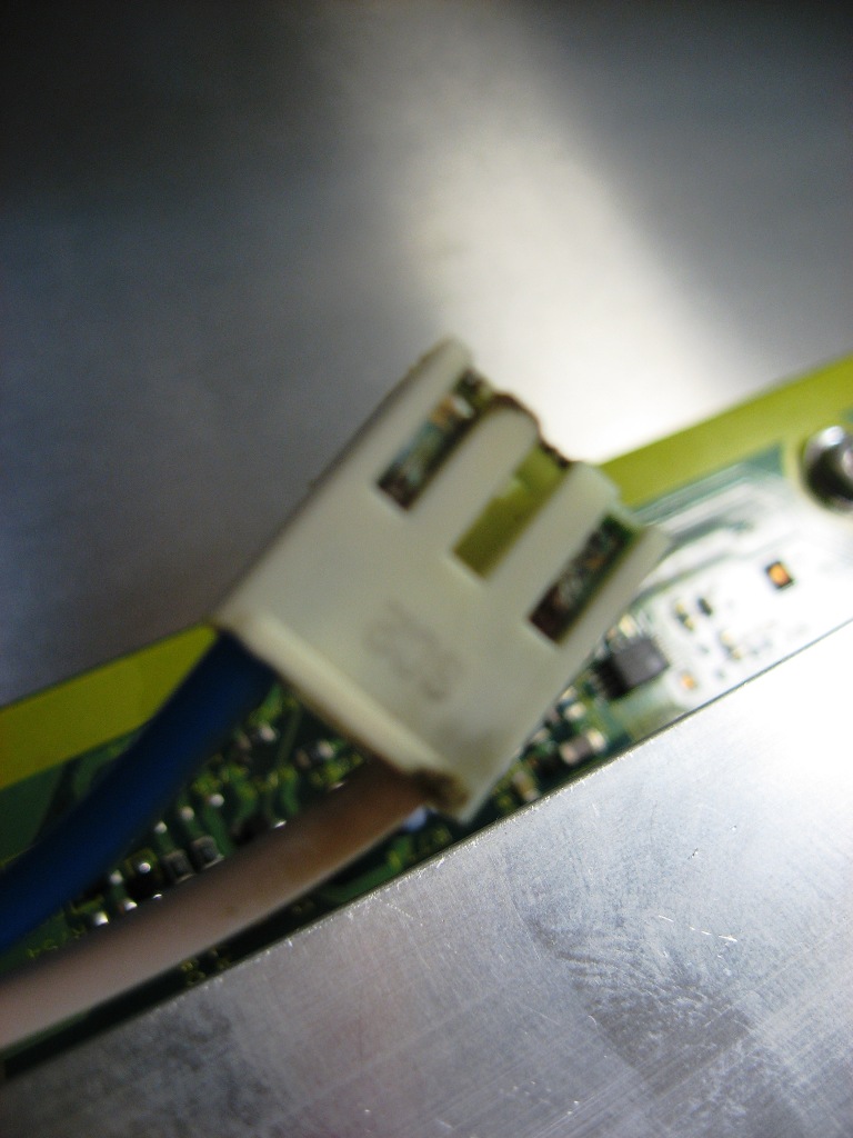

    Well, I've finally got an opportunity to have a crack at a TV with the TNPA4782.
    6 Blink, SOS 6. Expectations are SC board with blown IGBTs everywhere.

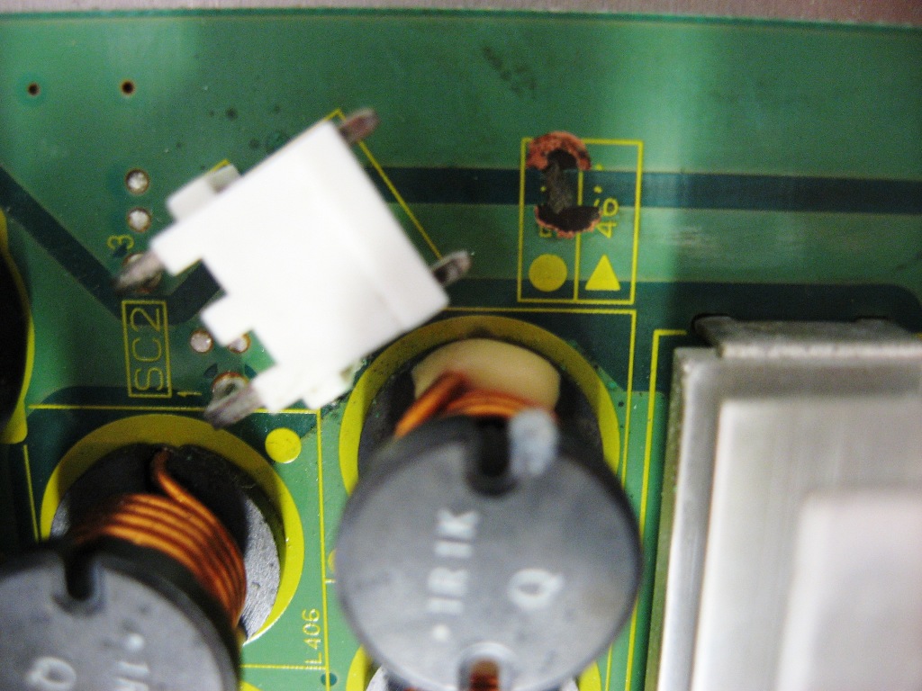

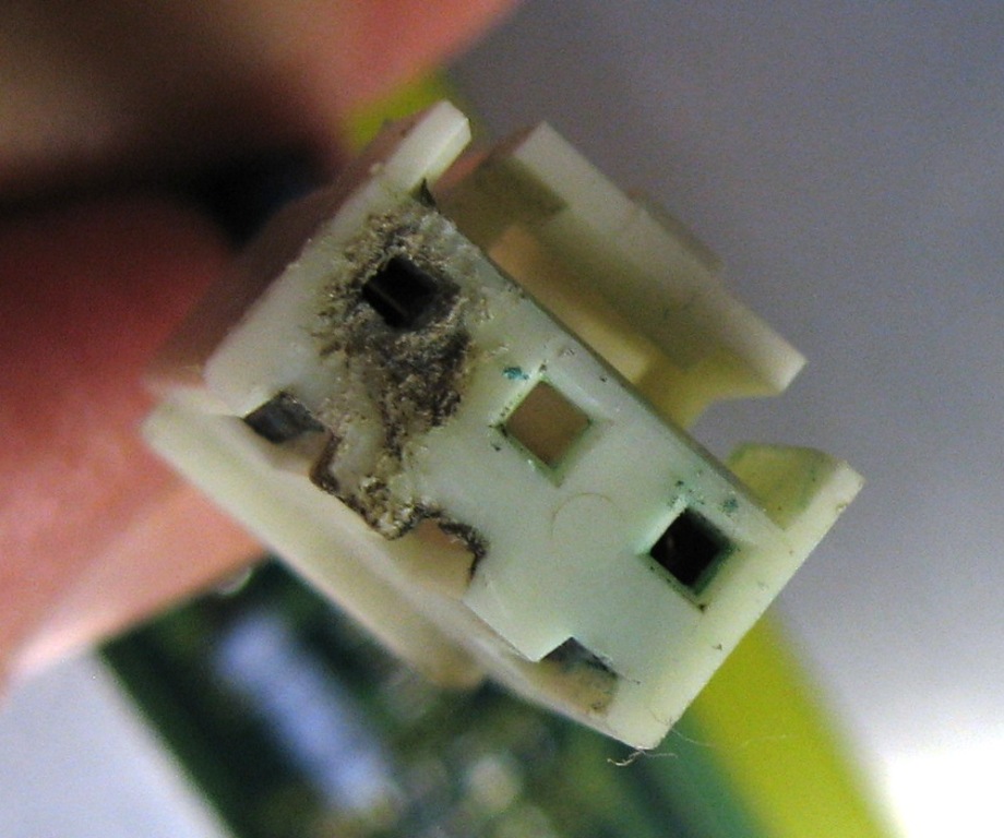

    At first inspection and I'm rushing , i find a lot of surface corrosion on parts and the SC2 terminal is not healthy or it is a healthy green if it were a plant.
    The board has scorch marks from arcing under the connector and with the SC2 lead removed , more tracking and arcing marks.
    Cool, I'm thinking clean this up and maybe get lucky - no, still 6 blinks

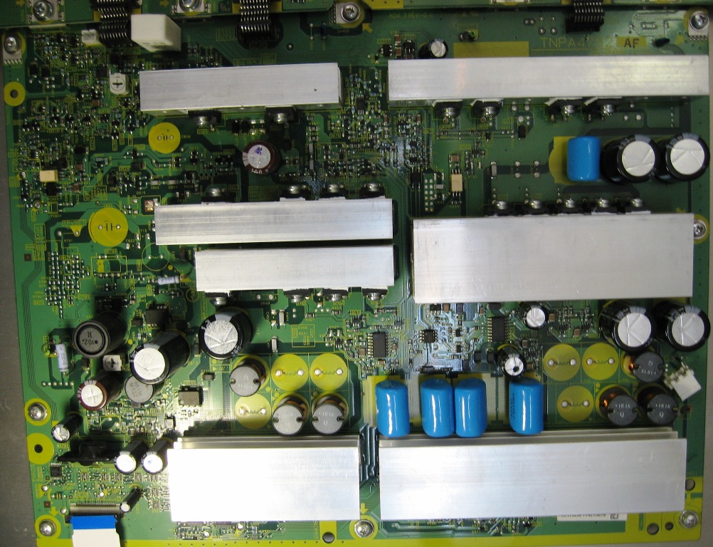

    So go over it more thoroughly and find Q661 shorted C-E, D673,674 shorted. I went with the diodes which are a pain to desolder and was wrong . Ended up being Q661 C-E short.
    Q661 RJP6065, I've used a RJP63F3A which is the newer version . replaced Q818 2SK3018, Q702 2PD601 was short, IC773 TC7SH14F was shorted Vcc-gnd(41ohms),
    Fired it up, still shuts down 6 blink but nothing blows. panel very briefly energises.
    replaced Q701 MMBTA92, Q876 2PD601, IC724,725 78L05
    No change, still 6 blink. Tried SC50 bypass, - same
    So far voltages are spot on
    TPVsus 198.5V
    TPVscn -41.1 (- 40V ± 6V)
    TPVAD -186.2 (- 185V ± 2V)
    TPVe 135.2

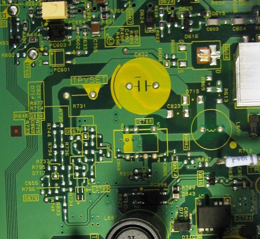

    There is no Vset cct on this

    What's MID voltage? (across the bank of blue poly caps on the SC.)

        Registers 145.7 V at shutdown

            not making much progress but discovered FET driver IC521 is bad. M81707FP
            Don't have one, anyone tried M81737FP in it's place?
            I have and now 7 blinks, not a glimmer in the panel now
              Re: TH-P50G15A - 6 Blinks- Bad TNPA4782
              Way too high, should be near exact 1/2 Vsus.
              Looks like energy's getting into the ER caps but not being extracted; Check IGBTs and FET drivers for lower ERC path.

                  Finally got some action. blew it up. Q661,660,601, D618 failed. getting a little frustrated I back tracked and started putting a couple of old parts I had swapped out back in. neither did any damage previous but then IC521 was shorted when they were in. I'm lookig at IC691, and IC561,562
                  Anyway after puttung IC691 (NAND) back it went off like a fire cracker, I think that was D618. Before this MID was back to about 50v from being 145V. Still not right.
                  What is also interesting is at TPSOS7, if I earth that out it still tripped and I tried putting a meter on it to see and whatever is happening it's too quick for the meter to read but I did see 1.3V . Probing TPSOS6 however is normal 4.4V initial then drops off to 0.
                  I've run this up and managed to get it to stay on with just the A, P although this does have a D board and D20,31,32 were removed so I'm pretty sure that proves it's not a misdetect oor another board(D board)
                  Not sure what to make of it all unless D618 was bad and I just missed it.

                      basic theory is, MID is charged by panel capacitance on HIGH-LOW sus, and discharged by panel on LOW-HIGH sus.
                      If you just charged the panel using the SUS IGBTs (high and low) you'd waste tons of energy because you'd draw a helluva lot of current to charge up the capacitor which is basically a short circuit. Then you'd go and dump that all in the SUS DN transistor. Not good. Lots of heat, lots of power...
                      So, high ER IGBTs turn on before the controller wants to swap sus from high to low. This discharges panel (~100nF capacitance) thru inductors into the blue poly caps. Charges would equalise if there was no inductance so youd have 100V both sides. Problem is you'd still have to dump that 100V somewhere. 1/4 the energy (1/2 volt 1/2 time) but still a lot. Why not make use of it? Inductor creates resonant tank ckt, which is critically damped by the sustain timing, so 90%+ of energy is extracted. On the other cycle, lower ER IGBTs turn on when the controller wants to take sus from low to high. Same deal with resonance. Even though mid is only ~100V, resonance boosts it to 200V.
                      Hence why the capacitance in ERC (3~4uF) is much larger than panel capaciance (50~200nF). Haven't done the math but the inductor values are cca 1-2uH air wound coil, which sets resonant frequency 500kHz, half the sustain frequency (150~250kHz). Its a little more complicated because the panel capacitance goes up with screen size and changes depending on the image displayed and panel temperature also why the SCs are different between models.

                            interesting update. I've made what appears a real cluster of this but I now have a running SC, no blinks, no picture.. SD/SU are shot.. both shorted and I'd like to think I checked them properly as not but only gave them a quick continuity check between vfg and the outputs.
                            anyway, I'm not going to be exact on what exactly was faulty but have a fair idea.
                            Originally
                            Q661 RJP6065, shorted_..I've used a RJP63F3A which is the newer version .
                            replaced Q818 2SK3018, used 2N7002
                            Replaced Q701 MMBTA92
                            Replaced all 78L05 regs( they appeared ok) IC724,725,771
                            Replaced all TC7SH14F _ IC773 bad , others looked ok, IC464,465,564
                            Replaced TC7SH00FU - IC691 NAND
                            Replaced IC521 M81707FP, used M81737FP which is same pinout higher current output
                            Replaced Q551 ( looked ok)
                            Replaced Q660,601, RJK6026 ... I had none and used STP10NK60ZFP 600V 10A N FET.
                            Replaced D618,652 .. RF101L4S 400V 1A super fast rectifer.
                            SC50 buffer bypass(buffers now shorted), Powers on, Sc is a bit noisy and yet to see how the picture is.
                            voltages are now:
                            TPVsus 198.7V
                            TPVAD -186.1 (- 185V ± 2V)
                            TPVe 135.2
                            MID is now 99.7V as predicted by Tom about 50% Vsus.

                                I'd say since MID is good the sustain portion is ok. Check voltage between FGND and Vscn, if it's ~140V (positive, FGND < Vscan or buffers fry!) you should be good to put in new buffers.

                                  Hard to say if I missed a diode or what happened. definitely missed IC521. I even tried without buffers and still had 7 blink. I did try bypassing the SOS7, maybe that's when I killed the buffers( I think I did)
                                  Basically doing a whole lot of stuff wrong, rushing as I have to leave this TV on Friday to head home.
                                  I don't normally test SCs with live buffers. I only just clicked that maybe the state of the buffers had changed and that's when I did the resistance at Vfo and both dead short.
                                  SC50 bypass and pleasantly surprised.
                                  No I had to replace the newly shorted stuff Q660,601 , 661 as well. Nothing had blown so maybe I damaged the buffers and the next cycle that's when those IGBTs popped and D618 went bang and the track also vaporised.

                                    Vfg - TPSC1 = 143.1V
                                      I'm thinking it would be a useful experiment if you ever get a set you don't care too much about breaking (older set maybe) try a largeish diode reverse biased across the FGND-VSCAN portion. If all goes tits up this diode SHOULD conduct before the buffers get a chance to blow. Obviously SC will be damaged but failure was going to occur anyway.
                                      I'm convinced that we only see modern sets with failed buffers because they're less tolerant of such a reverse bias event. Older buffer ICs with 48~68ch per IC and larger silicon were very tolerant, apparently. KUROs use 68ch per IC (16 for FHD panel). 2007/2008 FHD Panny used the same. 71" FHD LG used 36 buffer ICs (2006 model, 30ch/IC) !
                                      Good, looks like you're good to go there
                                      Actually check the FG5V too (should be 5V above FG, for buffers. can't remember what Panny call it, LG use FG5V) if 5V goes missing, maybe buffers will fry as logic signals invalid? could be a case of turning on both switches inside an IC. Buh-bye when that happens...

                                        On this model F_5v_A, & _B
                                        pins 3 & 5 on SD42. Both produce 5V with respect to Vfg
