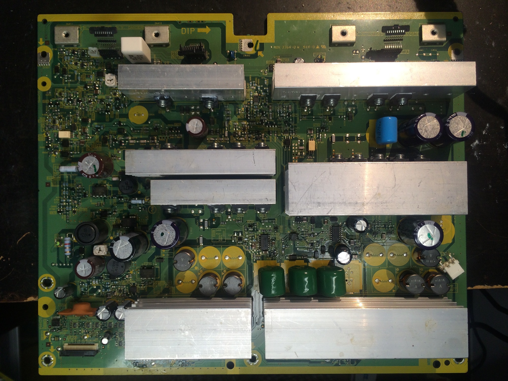

Ok I feel like im going crazy here... I remeasured Q660 and its not shorted now... I could of sworn I went over it twice and my meter beeped on continuity... I need a break =/
Also I haven't replace IC 691 yetComment
Re: TH-P50G15A - 6 Blinks- Bad TNPA4782
yeah, I think so. I'm tired. IC691 may not be essential but I was thinking if q660 was short maybe. I have but only out of paranoia
So this is 6 blinking but nothing is blowing?Comment
I'm getting something like 169K on both those ICs pins 10-20. The thing is I plugged on the SC board with Sc50 shorted. It'll sound like the SC turns on for a second (starts buzzing) and then goes off and then it'll start blinking 6 times.Last edited by Glitcher; 04-11-2015, 03:36 PM.Comment

just looking over the first board info I posted again.
D652 is that ok. Maybe throw a new IC691
My resistance is nothing like yours across 10-20 for those buffer ICs,ic561,562.
mine starts in the meg ohms decreasing slowly as it charges.
So I tried diode red on 10(gnd) = 0.484, Blk on 10(gnd) 0.968Comment

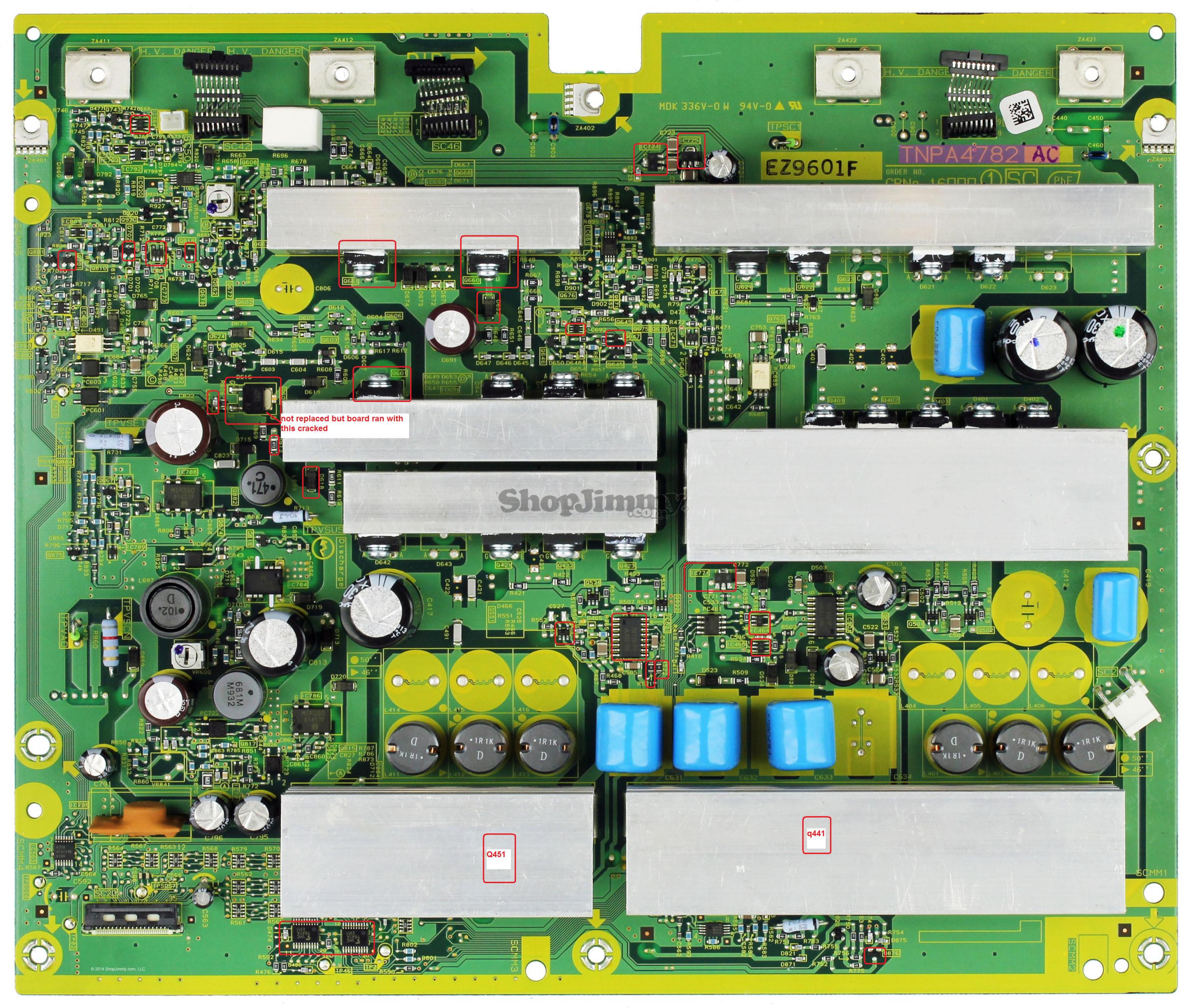

I don't where to steer you but this image I've done my best from memory what I replaced(believe) between the 2 boards I did. Not all of these were necessarily bad but most wereAttached Filesif you find these attachements useful please consider making a small donation to the site

Yep I'm stumped... The only thing I noticed is the MID voltage is too low, peaking at around 45V. So I guess there has to be a problem with the FET and drivers? (IC521 I guess) Replaced some extra parts, and even some from your image but still no process... ugh I hate these boards -.-Comment
