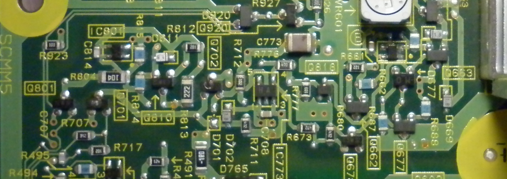

          Originally posted by Glitcher

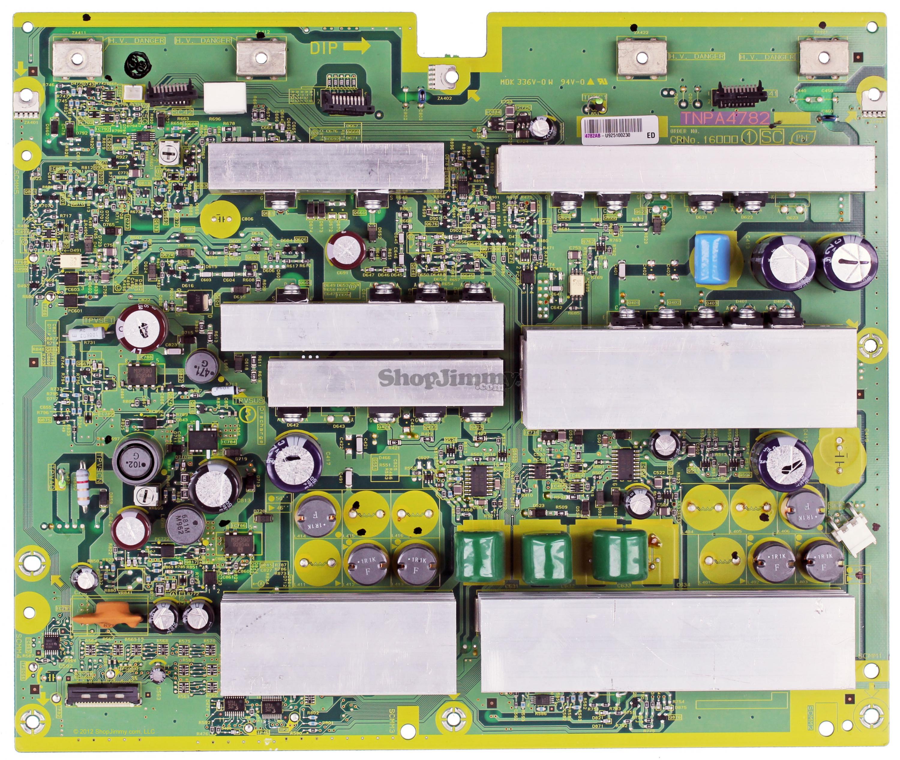

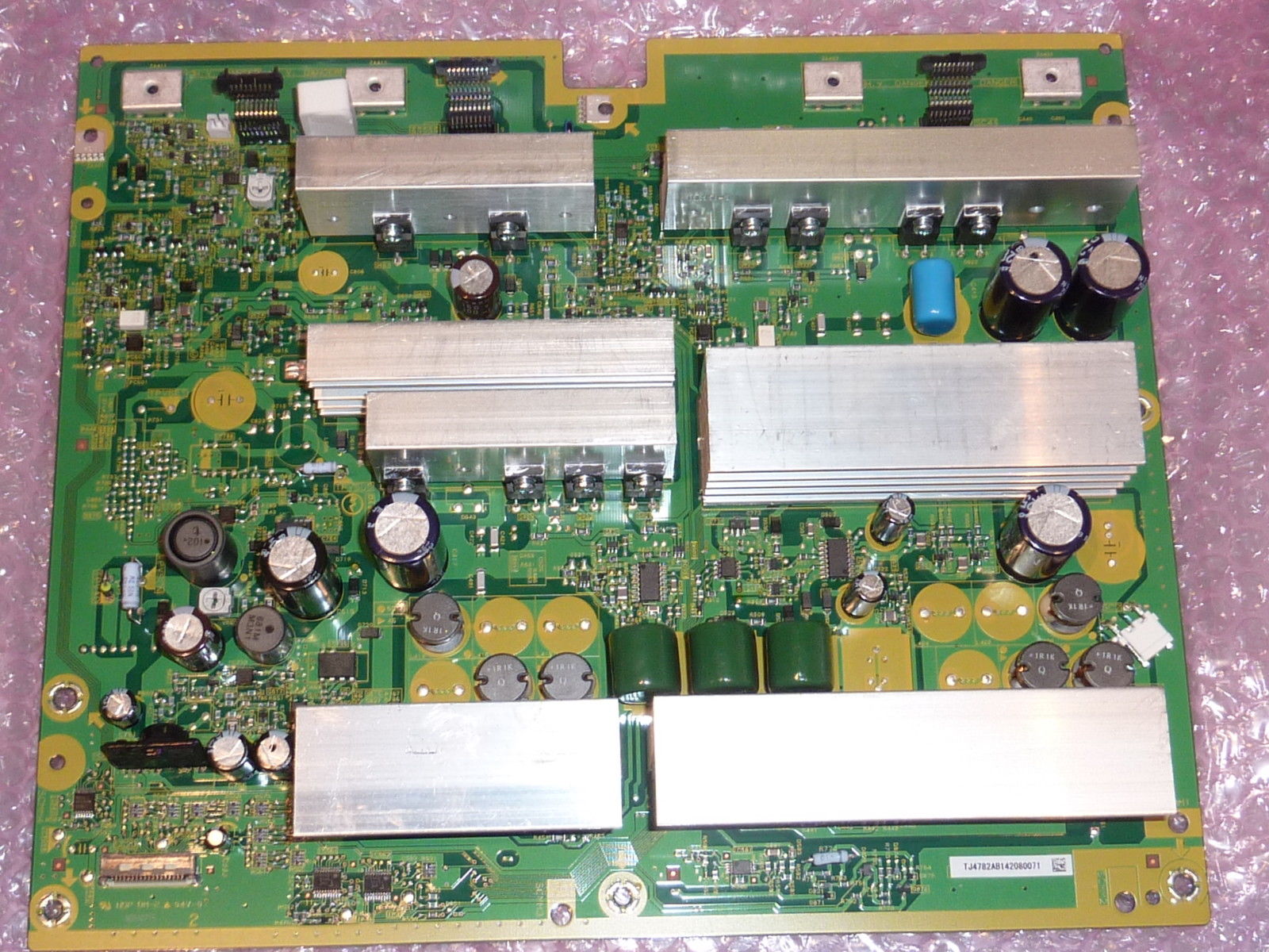

          Progress!!! I decided to put back the original IC563 and finally it stays on! So it seems it does run without the Q604 FET.
          Now I just need to make sure there are no problems with the buffers before I put them back on.
          this is a new 4782AB on Ebay. the box has a date of march 2014, not sure if that's manufacture date or picking date but note the Vset cct removed.
          second picture is from SJ

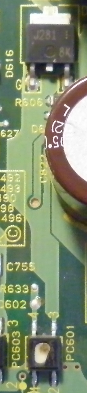

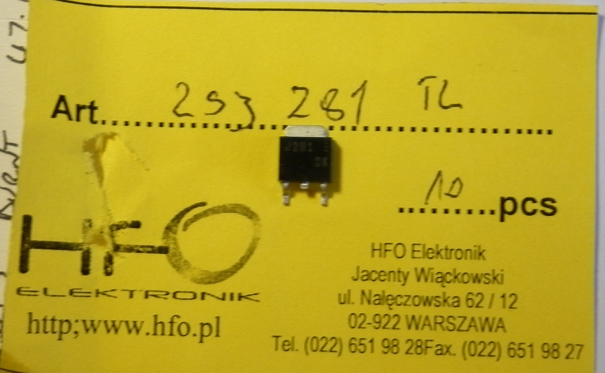

            My 2SJ281 P-FETs (10) just arrived from Poland. 2.49GBP + ship. took 3 weeks from order date to Australia. Works out at $1.30 ea for me.
            HFO Elektronik

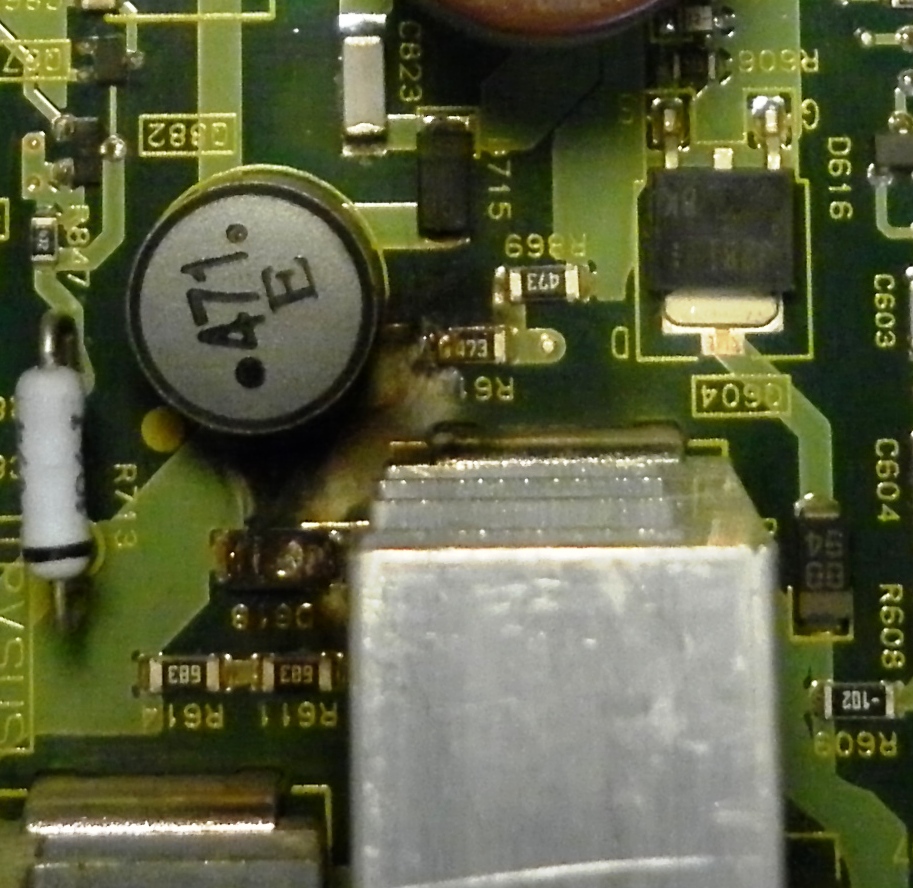

              Picked up a broken Rev AC 46" board. virtually no diiference between this and an AB 50" (G10) except placement of the inductors and a couple of caps.
              Q601, RJK6026 shorted
              Q661, RJP6065, shorted
              Q441, 45G127 shorted
              Q451, 45G127 _ shorted but not the same as 441, I suspect that when 441 is out this may be ok
              Q701, MMBTA92 blown out
              Q702, 2PD601 blown out
              Q818, 2SK3018 could be ok
              Q604 2SJ281 no short but i'm unsure still what they should do in cct. Not cracked apart like the last one
              Q551 CPH5524_ shorted
              D608, MA8120M, MAZ81200ML 12V 150mW zener(DIODE ZENER 12V 150MW SMINI2) _ open cct
              D618 RF101L4S 400V 1A blown apart
              R613 47K reads ok but burnt.
              IC771 showing short O/P , 724,725 78L05 _ seem ok

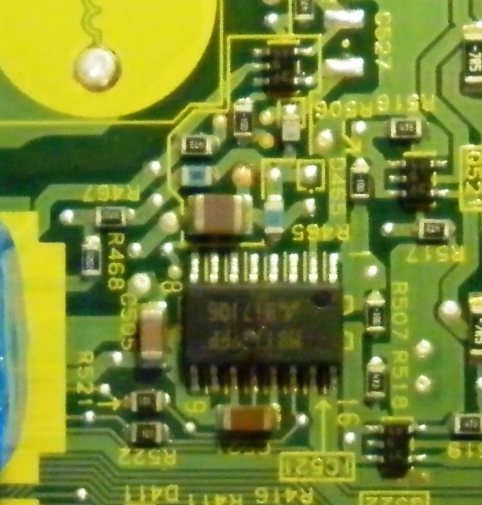

              IC773(bad),564 ok, 464,465 suspect_ TC7SH14F
              IC521 M81707FP blown out
              R521,522 100ohm 5% metal _ visually look ok but R521 is high at 108ohms, R522 appears open at 5.6K so both will need replacing.
              IC561,562 appear to have not been shorted this time
              New for me , opto PC601 has exploded
              Usual scorched tracks

                tracks blown off at D618, R613
                Of the 3 inverter ICs 773,464,465. 464 on this occasion had 3.3ohms vcc-gnd. normally 773. all 3 are on the same 5v rail IC771

                  I am currently attempting to repair my board, TNPA4782ab and I found that a lot of the components you talked about were also faulty on my board as I followed the same measurements as you showed in previous replies. However, I don't usually do many board repairs unless its basic Diodes caps, and or certain surface mounted components such as EEPROM chips, or fuses.
                  Because of the above statement, I have no idea where to buy these spare surface mounted diodes, IC's and or transistors. A few of the IC's I was able to find on ebay, but some of the transistors when typed in show up with a few different options. For example, RJK6026, I get RJK6026 and RJK6026DPP. What does the DPP at the end mean, and is there a difference? If so, which would I need?
                  Also I have no clue where to buy the surface mounted diodes. I have about 8 of them registering shorts, and the only symbols on them are K696 for 4 of them and the other 4 say 8897.
                  Thanks for the help.

                    DPP is merely the package type in Renesas speak I guess. needs to be TO220 Full Plastic casing.
                    As for the diodes, a little suprised you have not correlated 8897 which is actually marking 88 as the same as D618 mentioned in previous posts.
                    That also means K696 is in fact marking K6 made by Shingenden.
                    before you rush off and start getting bits, I'd remove the suspected shorted IGBTs first. then recheck the diodes, i suspect the K6 you refer to are in front of Q661/660.
                    Watch out for open cct pcb tracks where ever there is evidence of burning.
                    You could try UTSOURCE (will take weeks to arrive)or a kit but not just any kit. get a list together of what you find.
                    8 diodes sounds more than what i found but there's a number of ways these can fail I suspect. I would be more specifc with the info like exact locations.
                    i've only done 2 and only a small amount of info shared on self repair here.

                                  I think you better have a good read of this thread then because if you don't pick up on those parts which are identified and I've given part numbers you have no chance with the list you have now.
                                  2 posts above your first I even have a list of some bits you don't have .
                                  This is in an earlier post as a guide. If you miss the schmitt inverters, any bad voltage reg and smd transistors it will just blow
                                  I'd jot down every part mentioned throughout this thread and any others, I'd also look at Glitchers threads to his work on the same board and also Hombre, search his thread, collate all the info and you'll have a more complete picture. I'd also search on Ebay and see what are the the really large kits, sometimes they give locations of the bits. Optos - opto couplers
                                  Q661 RJP6065, shorted_..I've used a RJP63F3A which is the newer version .
                                  replaced Q818 2SK3018, used 2N7002
                                  Q702 2PD601 was short, IC773 TC7SH14F was shorted Vcc-gnd(41ohms),
                                  Replaced Q701 MMBTA92
                                  Replaced all 78L05 regs( they appeared ok) IC724,725,771
                                  Replaced all TC7SH14F _ IC773 bad , others looked ok, IC464,465,564
                                  Replaced TC7SH00FU - IC691 NAND
                                  Replaced IC521 M81707FP, used M81737FP which is same pinout higher current output
                                  Replaced Q551 ( looked ok)
                                  Replaced Q660,601, RJK6026 ... I had none and used STP10NK60ZFP 600V 10A N FET.
                                  Replaced D618,652 .. RF101L4S 400V 1A super fast rectifer.

                                    I had a chance to re-read every post and have a better understanding of this board now. Some of the info given earlier about certain bad components was wrong due to certain components shorting out others. Here is what I have replaced so far.
                                    D618, and D865 located on the top left near Q622
                                    Q661 Q621 Q622
                                    Q601 Q401 Q402
                                    Q421 Q422 Q423
                                    Q441
                                    Q451 registers a short between G and E. However it registers a short between those points even with the transistor out of circuit. I have checked D451 and get .455v and OL. I have checked R451 and get 5.6 ohms. Not sure what could be causing this one to do this.
                                    I have replaced all the above, and now every component that is screwed into a heat sink is good to go, and every single larger surface mounted diode is also measuring good.
                                    I have checked IC561 and IC562 and am getting 10 Mega homs between pin 10 and 20 and slowly the ohms decrease. So those should be good.
                                    I checked R521 and R522, they measured about 49Kohms so I think they need replacement.
                                    For the following, what measurements should I get:
                                    Q876 Q647 Q701 Q702 Q818
                                    Q551 I don't know how to measure it, all I can tell you is that the side with 3 pins are all shorted to one another.
                                    Q604 has D and G shorted with it in circuit, I have not taken it out yet. I will update on this.
                                    For the following I have no idea how to measure:
                                    IC521 IC771 IC464 IC465 IC691 IC724 IC725 IC773 IC564
                                    R613 and R869 measure at 42Kohms,
                                    Zener diode at D608 measure good .706 and OL
                                    Now to the Opto, I think that PC601 might be bad but I don't know how to test it. PC461 you mentioned how to test it, but I have no idea what pin is pin 5 and which pin is pin 6 and 7 and so on. How do I know which pin is which? I have tried 4 different scenarios with pin 1 being on each end, and none of the times could I get the same numbers as you did, so I think mine might be bad not sure.
                                    I know I am throwing a lot at a time, and also requesting a lot of information, but I have browsed through this post several times, and got as much info as I could without losing my mind.
                                    Thanks in a advance for the help.
                                    -Nick

                                          I usually just bell them out for shorts , but, not everything shorts.
                                          pretty sure I'm repeating myself , but Q701 Q702 Q818 I would replace
                                          Q876 I would leave, at worst it will just cause a blink code but will not damage anything as it's in the detection cct.
                                          Q647, IC461 I'm not sure if they're likely suspects, I know I was clutching at straws and did them but on my second board, never touched them.
                                          sometimes it's more efficient to replace than to try and work out if they're good and make an error.
                                          With IC562, if r521,522 are open cct from high voltage back feeding from IC521 then it's a good chance although Vcc-gnd on ic562 is ok that it could be damaged.
