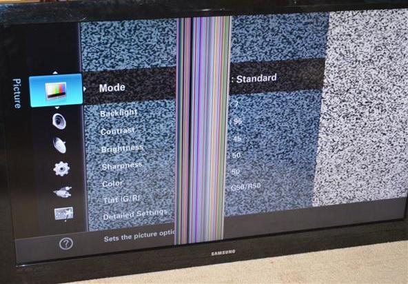

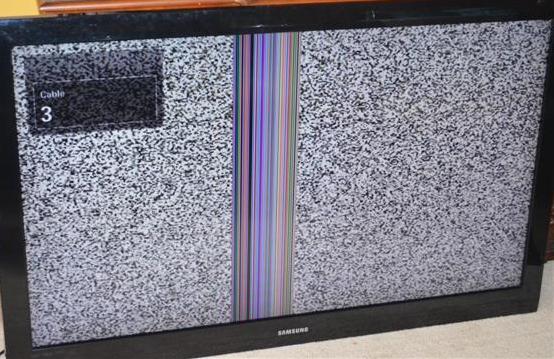

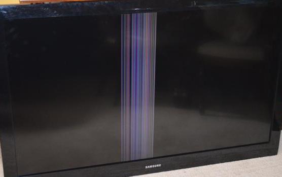

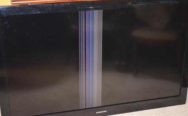

    I obtained a 52" Samsung LN52A550 which did not initially turn on. The culprit being the power supply caps (blue sam-wha XC series 1000uF 10V), which I fixed. Everything was looking good for awhile. After some cleaning and putting it back together, I connected a HDMI source finally to see some images. After a few moments, right down the middle (left half of the screen) a 5" vertical bar of very colorful lines appeared.
    The vertical sets of lines appear in front of anything that is on the screen e.g. menu is behind the lines.
    I noticed when I shut the TV off; the screen goes black except for the vertical lines. They stay on for a moment before they go off too.
    I reseated all the ribbon cables between the panel and TCON, and the TCON and main motherboard, which did not help.
    I'm suspecting panel tab bonding. I touched/pressed all tab bonds and none of them appeared to have any affect.
    So I'm looking for some suggestions before I call it quits.
    Thanks.

        • Hobby 1
          • Mar 2010
          • 86
          Re: Samsung 52" LN52A550 - Bad panel or TCON...
          post a picture of the screen
          • richr69
            • Jul 2010
            • 58
            Here are some pictures.
            1.) Power On
            2.) Few seconds after power on
            3.) Menu selected
            4.) Power Off
