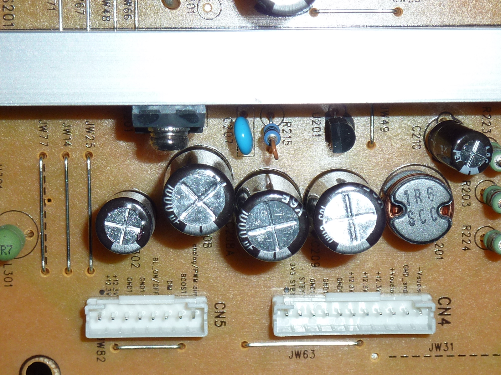

      another picture of the power supply where the CN4 and CN5 connectors are. So we can read the pin outs.

        Re: Philips 47pfl5704d/f7 Added Pictures
        cn4 cn5
        -v audio analog/pwm dim
        gnd snd boost
        + v audio dim
        12.3 bl on/off
        12.3 gnd
        12.3 gnd
        gnd 12.3
        gnd 12.3
        gnd
        stby
        3v3 stby
        • CapLeaker

          First off what voltages are you getting on these pins.Use the pin out description with the voltage you measured beside it. We got to find out if the issue is on the main board itself or on the power supply. See what you get TV on vs TV off.
            soon as tv is plugged in stby light starts flashing (1) long (4) short, No on/off..
            cn4
            -v audio, 0vdc
            gnd
            + v audio, 0vdc
            12.3, 0vdc
            12.3, 0vdc
            12.3, 0vdc
            gnd
            gnd
            gnd
            stby, 3.3vdc
            3v3 stby, 3.3vdc
            cn5
            analog/pwm dim, 0vdc
            boost, 0vdc
            dim, 0vdc
            bl on/off, 0vdc
            gnd
            gnd
            12.3, 0vdc
            12.3, 0vdc
              With the ribbon cables disconnected on CN4 and 5, measure stby and 3.3V stby pins on CN4.
              After that you could "force" the PSU on using a two 1k ohm resistors. One from the standby voltage to PSon and the other from standby voltage to BLon. This should bring up all voltage rails and the backlight.
                cn4 and cn5 cables disconnected, 3v3 stby=3.3.vdc and stby=2.6vdc
                Need clarification on 1k from stby to PSon... stby or 3v3 stby and which pin is PSon.. is this done with cables connected..
                  3.3V Stndby = Standby power from PSU to main board.
                  Standby = PSon is from main board back to the PSU to tell the PSU to turn on. Same as the BLon. That comes from the main board and tells the PSU to turn the back light on.

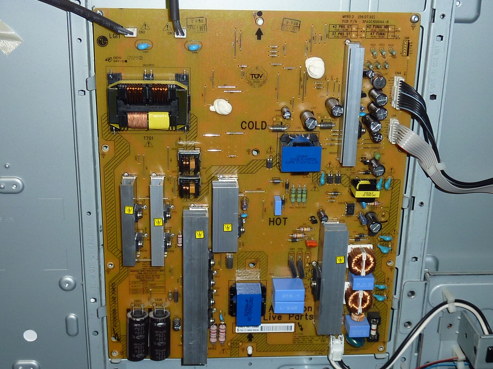

                              O.k. I guess we have trouble with the PSU not firing up. I DLed the service manual on here, but for some reason I can't read it. Schematic is too blurry. I guess we got to find another one.
                              • CapLeaker
                                Leaking Member
                                • Dec 2014
                                • 8155
                                I found another service manual, but it didn't include the schematic for the PSU
                                Shopjimmy has had a repair kit for that board and they replaced following:
                                Transistors 5 Q101, 501, 601, 602, 603
                                Integrated Circuits 4 U101, 401, 501, 601
                                Diodes 3 D301, 601, 602
                                Capacitors 1 C102
                                Fuses 2 F101(37'), F101(47")
                                Gives you something to do.

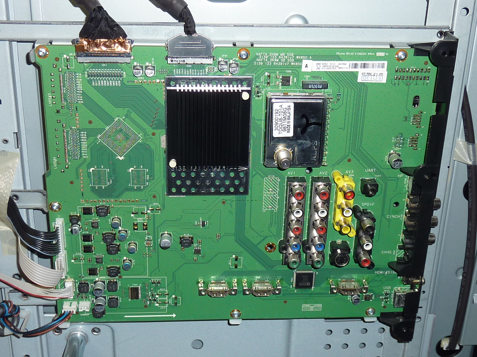

                                  since we thought the ps may be bad did a little more experimenting.
                                  stby to gnd
                                  3.3 stby to bl-on
                                  Back lights ON
                                  12.5vdc where specified
                                  power supply good
                                  question - this would indicate main board bad...
                                  checked on shop jimmy and they state a new board needs configuring..
                                  what does configuring mean ???
                                  thanks
                                      Since the PSon is backwards in the power supply and it does fire up, I guess the problem is on the main board that controls the PSon. Maybe that transistor is bad that pulls the STBY or PSon to GND.
                                      What you could do is maybe to put the TV back together, take the PSon wire off the PSU (in order that it doesn't backfeed to the main board) and short the PSon pin from the PSU to GND. The TV should come alive.
                                      • kmab
                                        • Mar 2015
                                        • 16
                                        • usa
                                        Tried last suggestion: cn4 & cn5 reconnected, PSon (stby) to ground..
                                        led on front panel blinks four times and repeats tv does not power up..
                                        Guess we will look for a new main board, Shop Jimmy is out...
