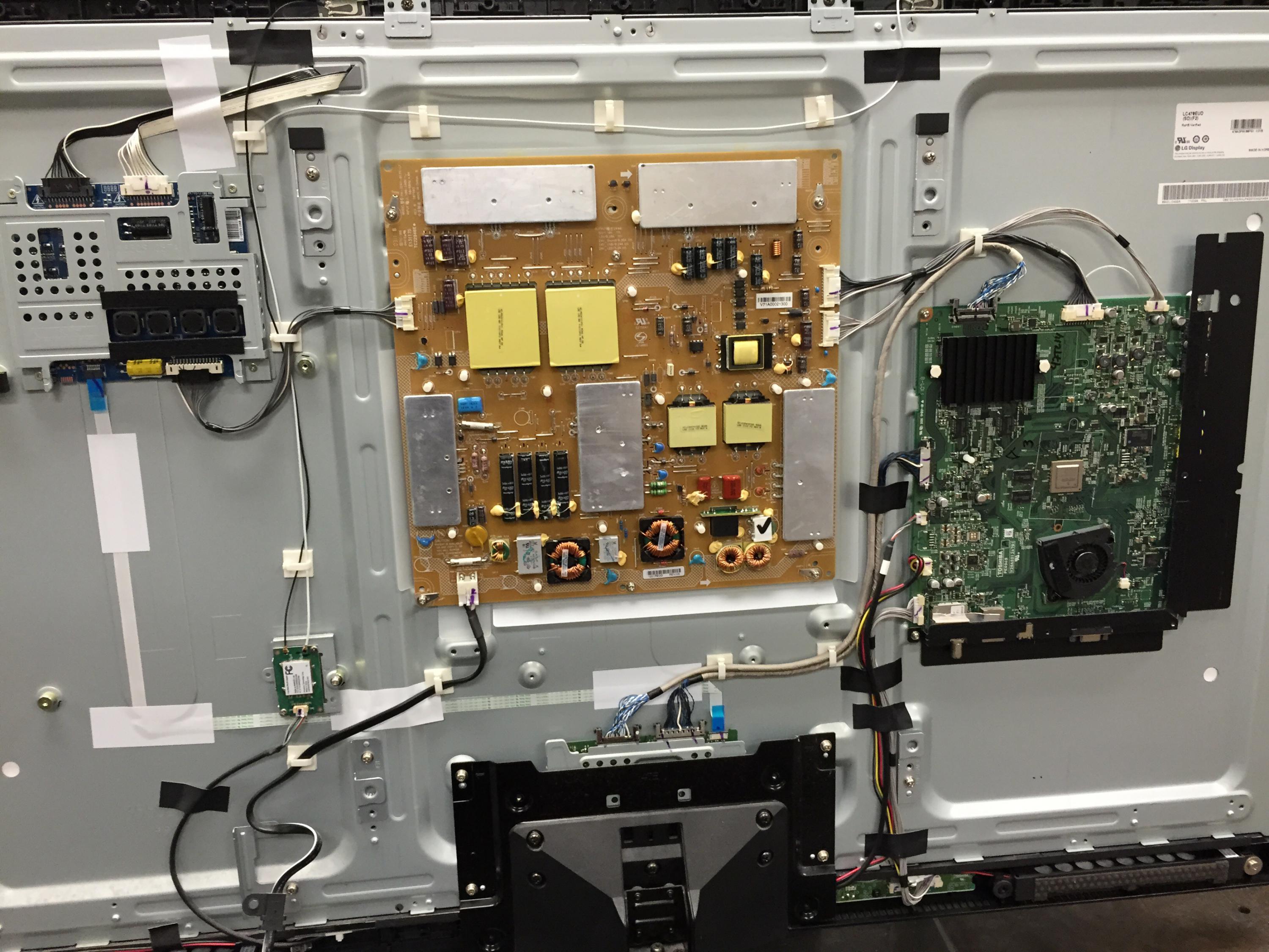

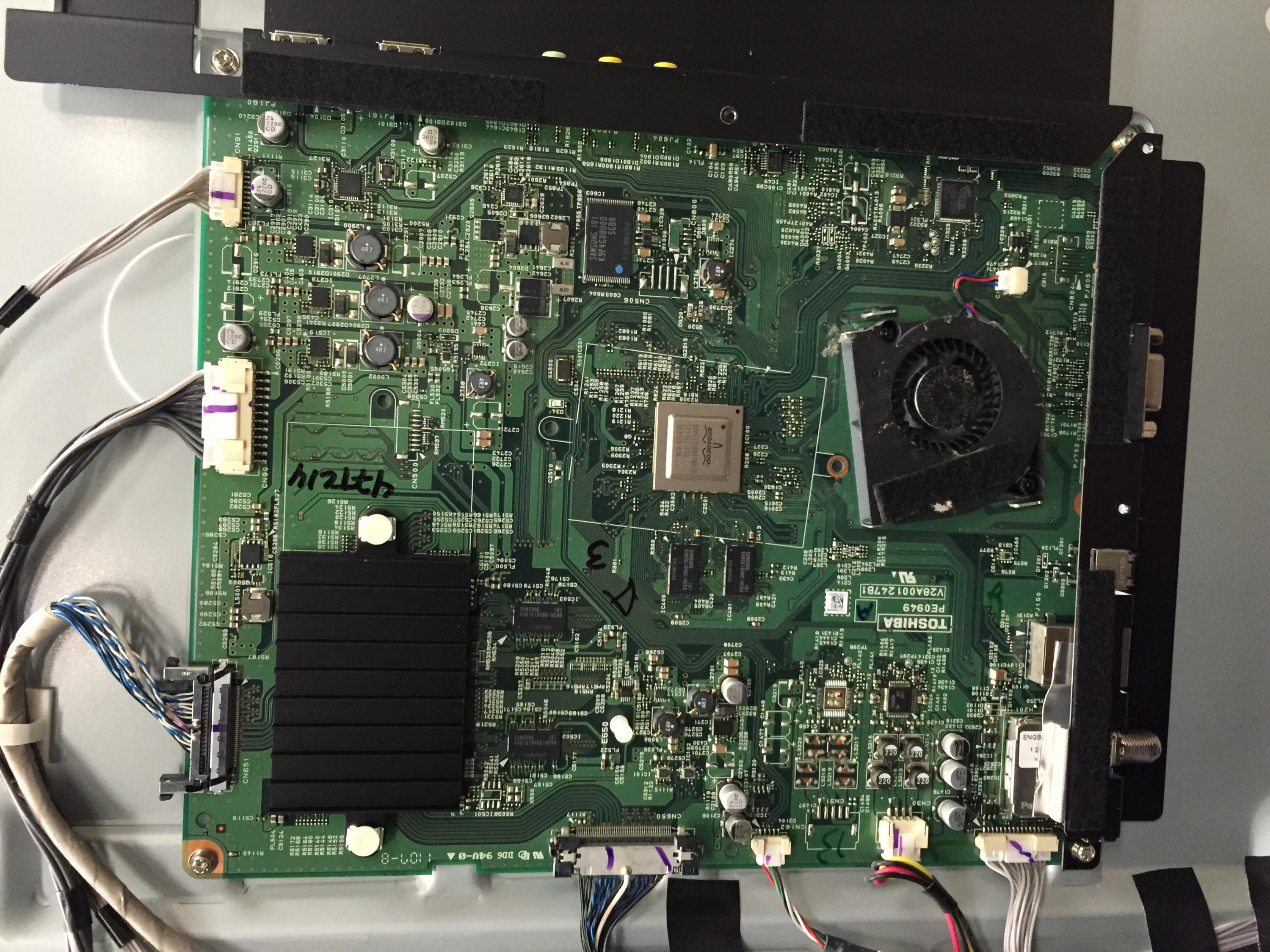

    Re: Toshiba 47tl5154 no image just backlight
    Here pic board

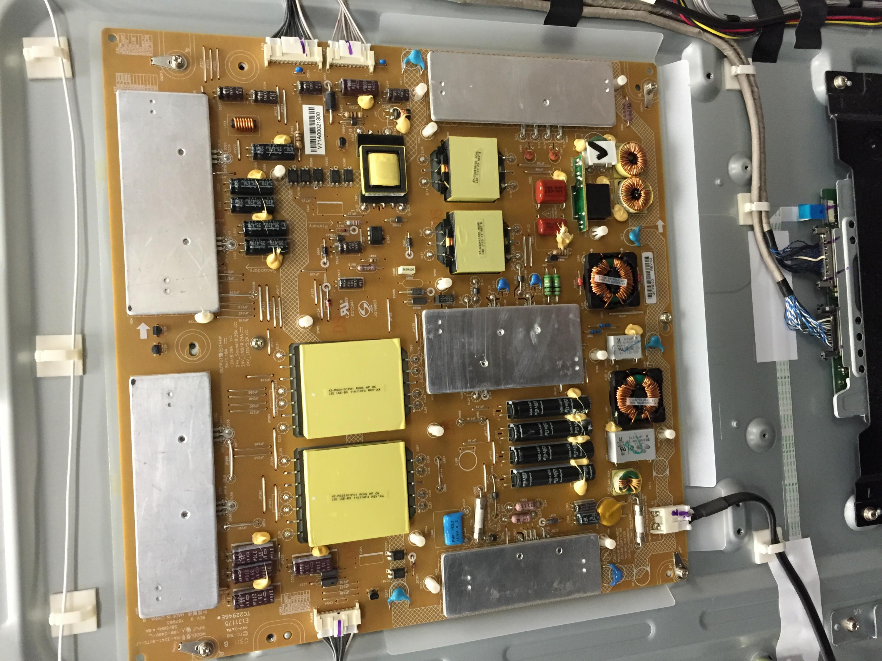

      Here pic power supply

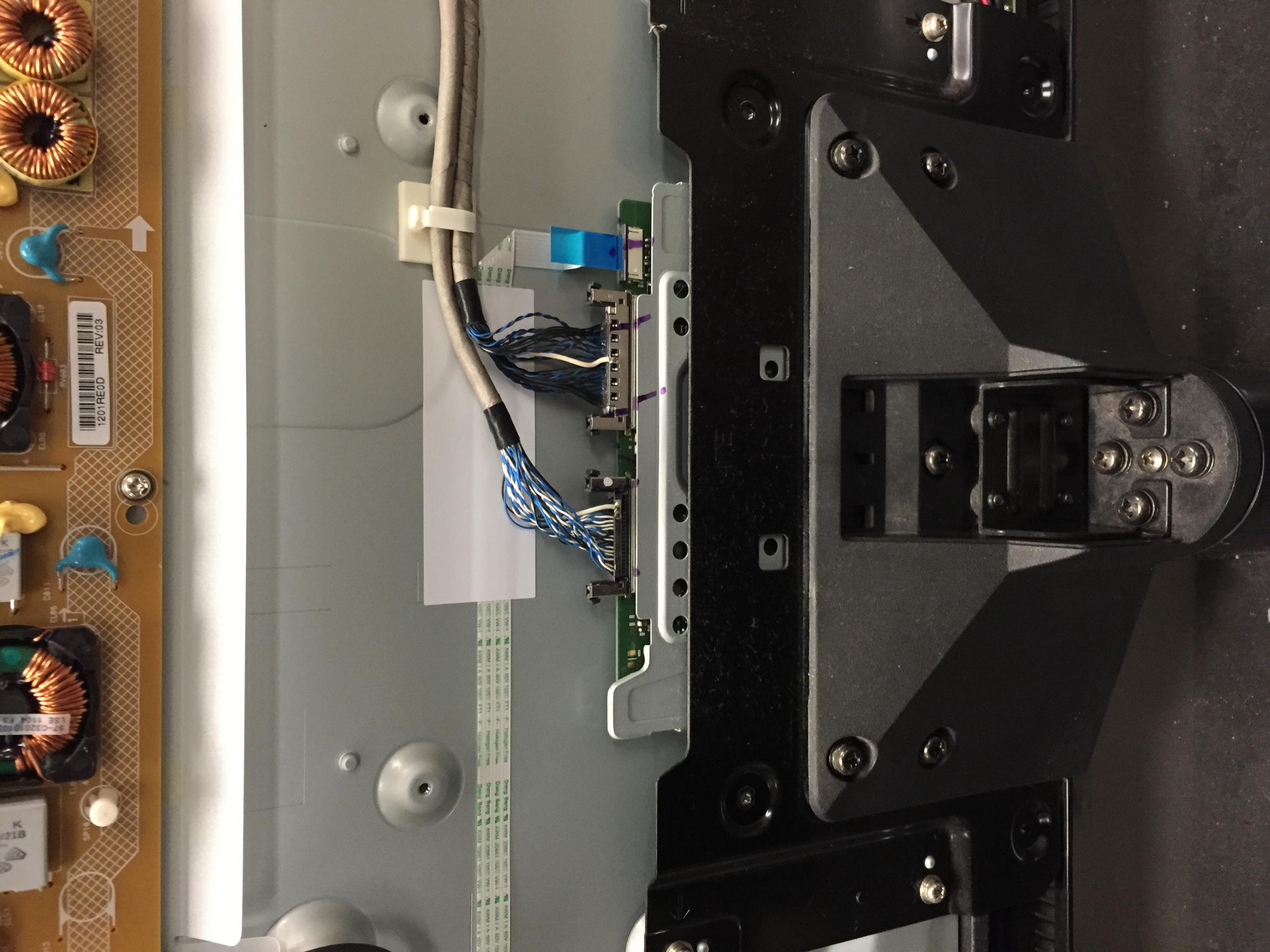

        Tcon board
          Pretty easy to check with an oscilloscope the LVDS, while turning on and off the menu on the TV all the time.
            At least check and see if the main board is supplying the Voltage to run the T-CON.
              I seen 12volts on the tcon fuse(budm)
              I dont have a oscilloscope that is can go to 100mhz just one that can do 20mhz not high enough.In future i will purchase one for now i can only check voltages(capleaker)
                i replaced the tcon board still just getting backlight but no image on tv any ideas what to check
                              I have replaced the main board ,and tcon board still same problem no image just backlight.any ideas
