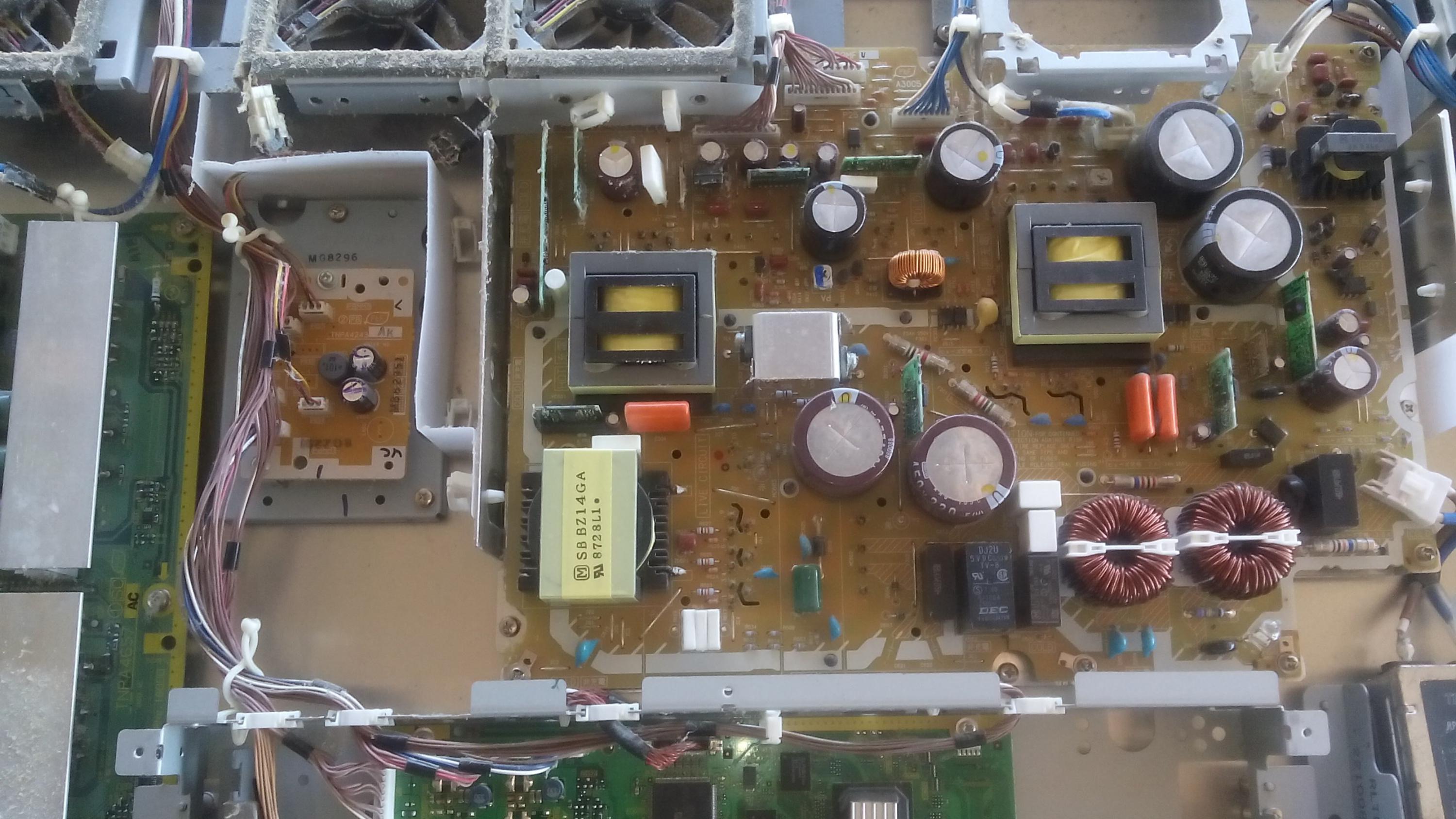

    Panasonic TH-42PZ85U just came in. Dusty as all hell..
    10 Blinks on the power LED at plug-in..
    Got the repair manuals from Tom's site (Thanx Tom!! )...
    ƒ Find out if 15V is output at pin 7,8,or 9 of connector P6 of the P board. If no voltage is output, the P board may be defective.
    ƒ
    If the F_STB_15V voltage is OK, it's likely that the A board is defective.
    ƒ
    Since some of the Sub-voltages generated by the A board are connected to the K, GS, and GH boards, it's also likely that one of these board may cause the unit to shut down and the power LED to blink 10 times.
    ƒ Disconnect connector A1/K1 to isolate the K board.
    ƒ Disconnect connector A/52GS52 to isolate the GS board.
    ƒ Disconnect connector A11/GH11 to isolate the GH board.
    The defective board is found when the connector that provides the Sub-voltages to that board is removed and the TV no longer shuts down.
    P6 of the Power Board. Pins 7 & 8 are dead.. 0v Pin 9 shows 5v
    Bad power board??

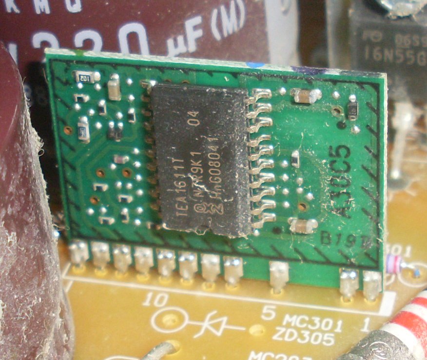

    Ten blinks is usually a PSU issue. I've corrected a few of this era Panasonic: http://youtu.be/LjpGKaBt8hg

          In one of the Panasonics I repaired about four years ago, I got away with only replacing the cap on the small module, and it's been running fine since. Typically, it's best to replace the chip and the adjacent cap.

                  Did you watch the video? The two modules that house the chips and caps are MC201 and MC301.

                    Watch the video that Capkid linked. It's usually the same fault on these for 10 or 2 blinks. I can do one in about 45 minutes now. Getting the plastic insulators back in place is a pain in the arse... and don't lose any of the screws on the back of the heatsink plate...

                          He has the 50", board numbers are the same but the 46" and 50" use bigger PSUs (the same for both) than the 42".

                            usually every time I get one of these TVs with the MC 301 / 201 usually this is the problem but even if there's other problems with the set I always replace these capacitors just for reliability in the future but yes like everybody else is saying most likely always the 10 flash flash to flash syndrome is from the faulty caps on these boards

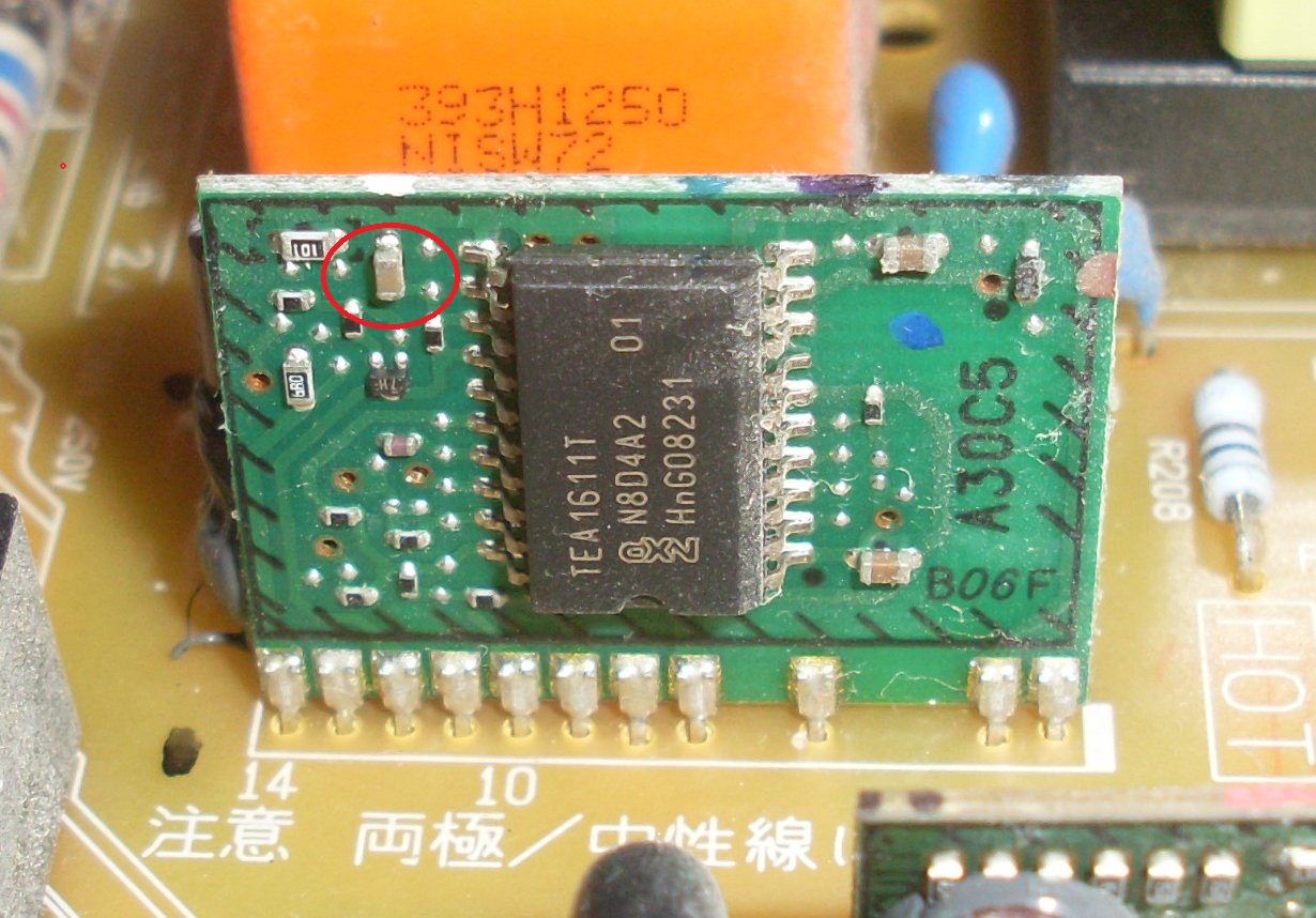

                                Did you make sure to spray on the suspect cap? Also make sure to remove the moisture (that condenses from the freeze spray) on the module.

                                    Call me blind (no, really go ahead, it's OK.. ) but I don't see the cap ya'all are referring to..

                                      watching the video refers to that cap in the picture

                                        Yes thats the ones i changed on my set still works today i didnt change the ics though i wonder if the ics have gone on yours hence why freezing isnt working?
