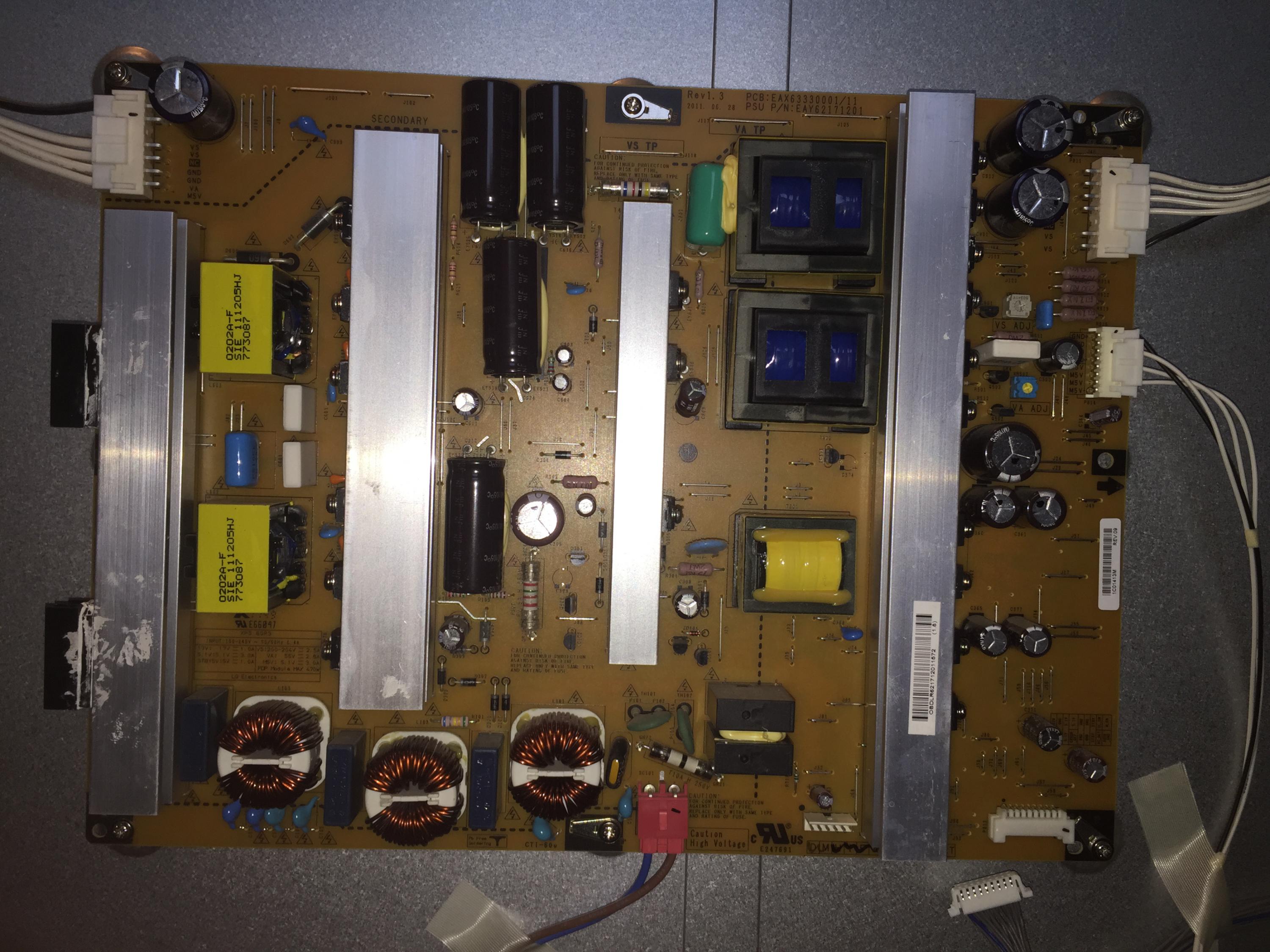

    I have an LG 60PV400 that has a problem. Just started last week. I turned the TV off, then heard it clicking every few minutes, also the standby light would turn off, then on again. I hit the power button when the standby light was on, and it booted up just fine, picture was perfect so I shut it down. I unplugged it for a few hours then tried again, and when I plugged it in I can hear a click from the main power relay, the standby light comes on, then after about 5 seconds I hear another click, and no standby light.
    Here is what I have done so far.
    Disconnect all connectors from the power supply board, and measure all voltages. They all look good. Connect the Y-sus, and Z-sus plug it back in, and all voltages are OK. When I connect the Main board I get good voltages to it for the first five seconds then the error signal voltage goes quite high, and the relay switches off.
    I repair medical electronics for a living, but I have never worked on a TV so I am hoping I can get some guidance as far as what to check next. I would hate to have to toss a 3 year old plasma when I can hopefully fit it.

    Could you take clear focused pictures of all the boards please.

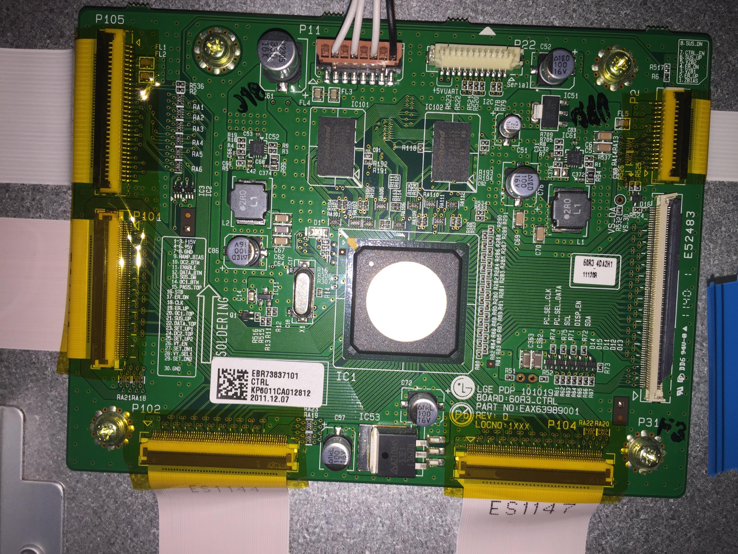

      I'd see if test patterns display:
      (1) Disconnect the LVDS cable that goes from the logic control board to the main board.
      (2) Apply a jumper across the auto gen points on the logic control boards (paper clip is an OK jumper).
      (3) Plug in and turn on the TV.

          Upload pictures first then we can go from there to show you the jumper points

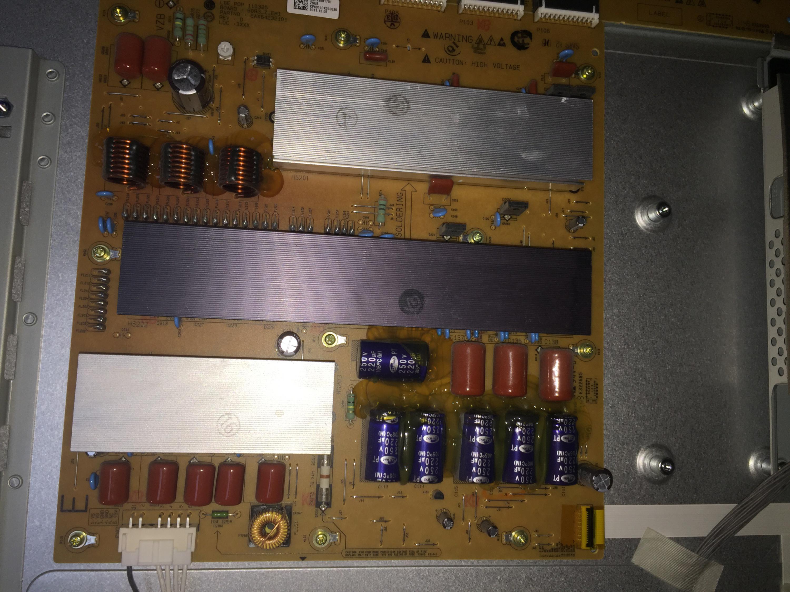

              Hopefully the pics show up. I disconnected the cable, but didn't disconnect the main board from the power supply, and the power relay clicked off before the screen could turn on. I have that power cable disconnected now, and I am going to give it 10 min then try again

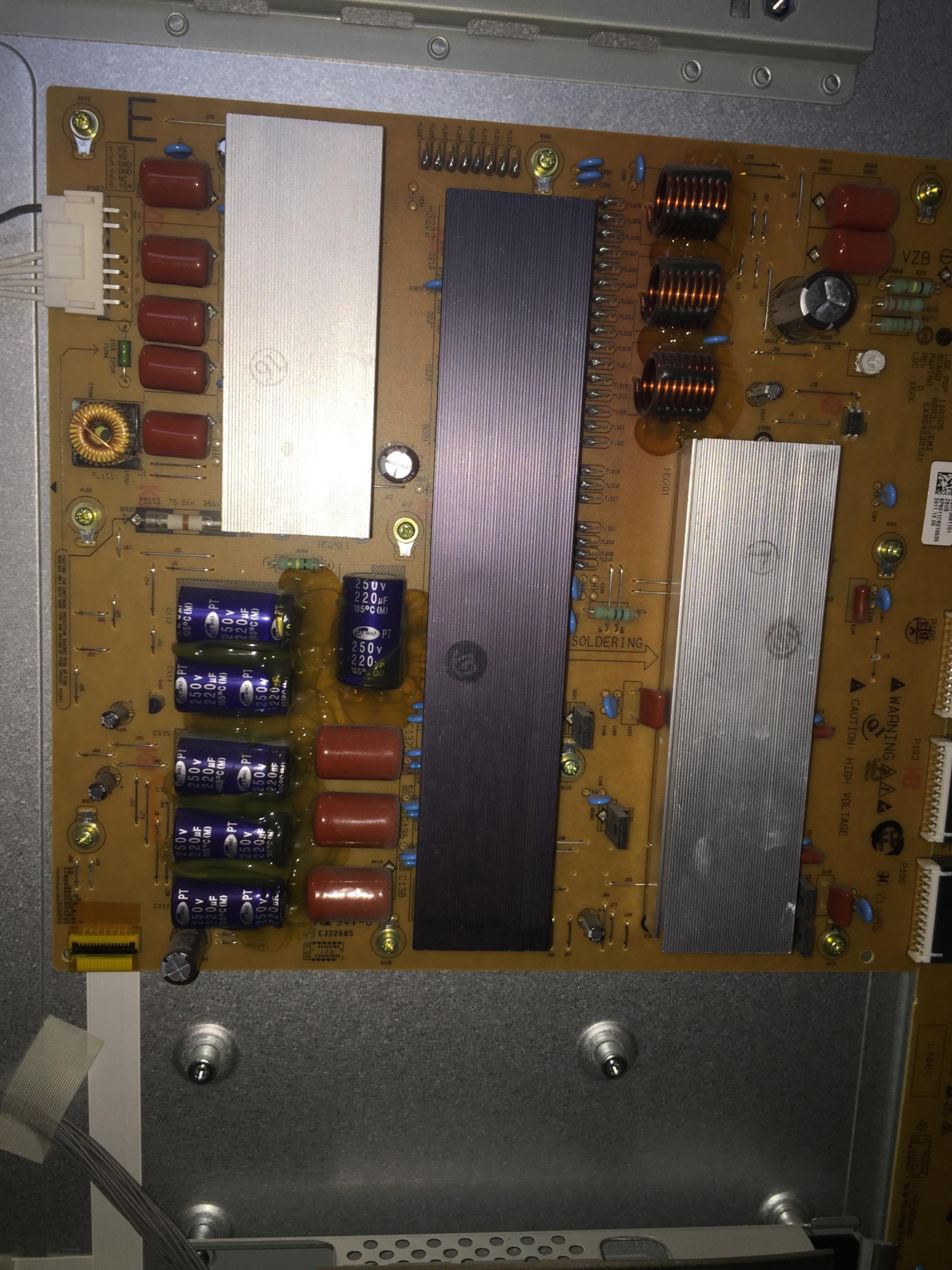

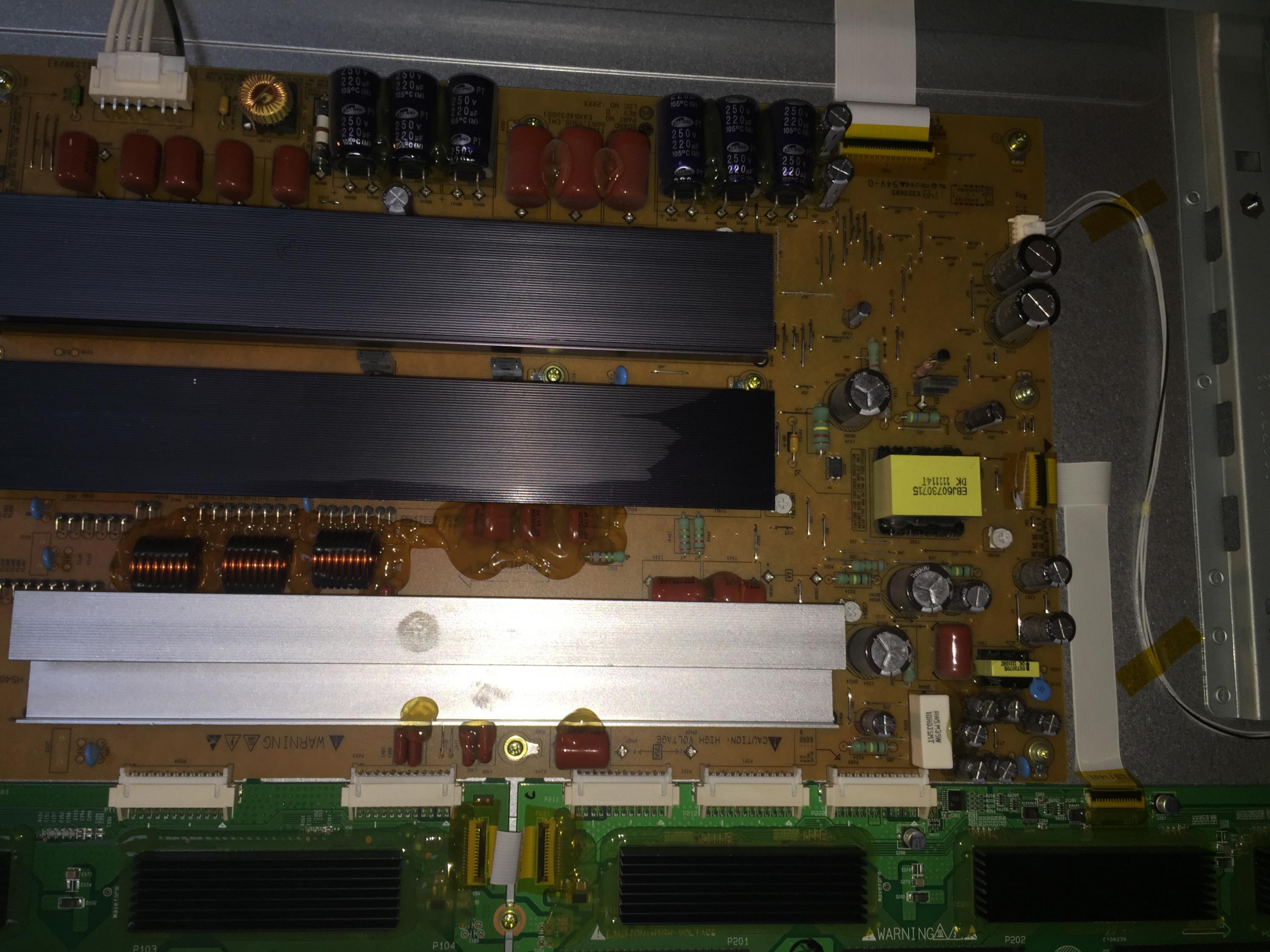

                Lets try these pics again

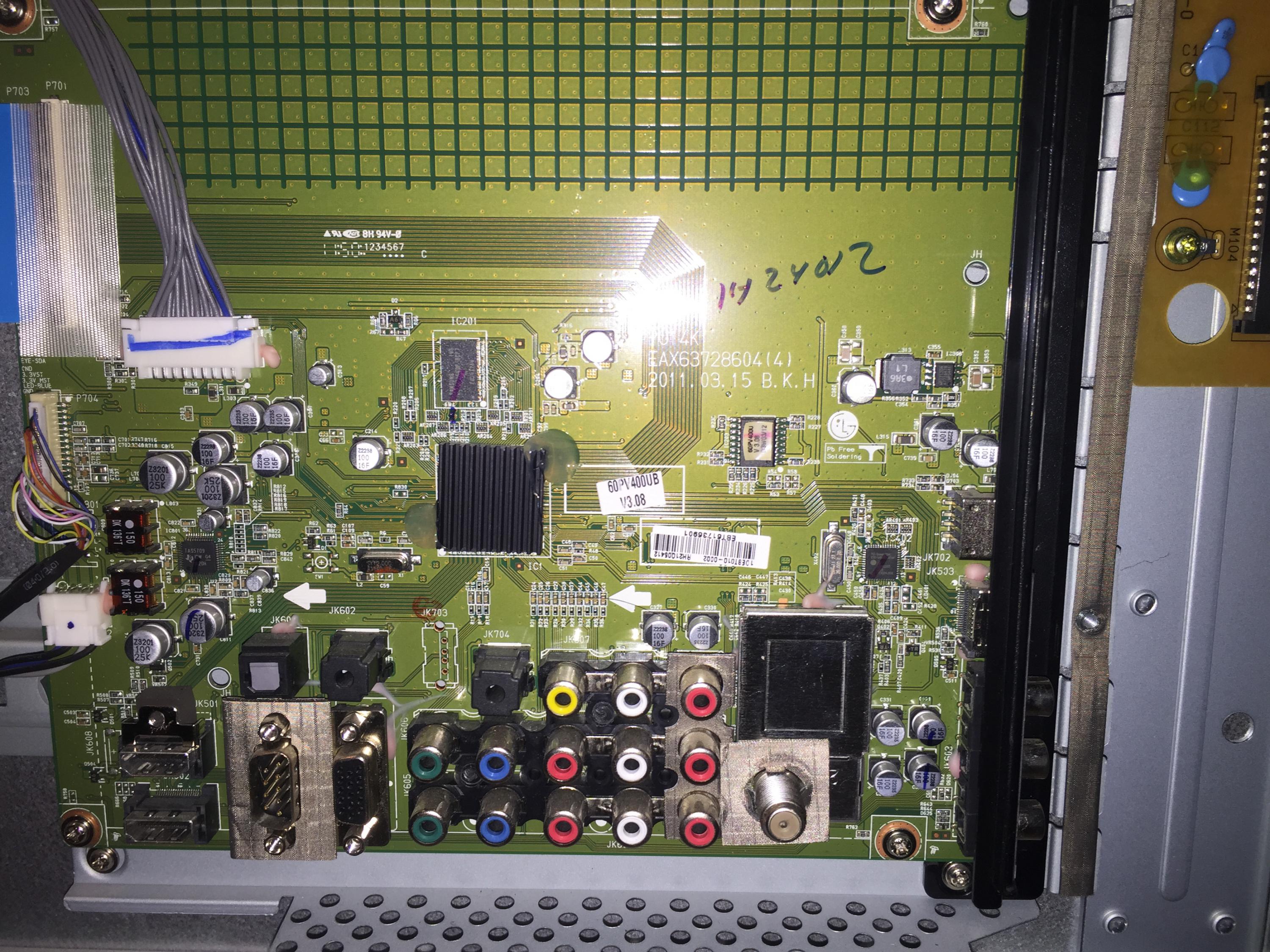

                  Re: LG 60PV400 Circuit check automatic shutdown
                  With no power to the main board the patterns display perfect!! I am going to go out on a limb, and guess I need a new main board
                    Yes, it appears to be a main board problem. I'd make sure all cables are properly seated then verify the issue is reproducible before proceeding with a purchase.
                          I will check all the cables again, and look into a main board.
