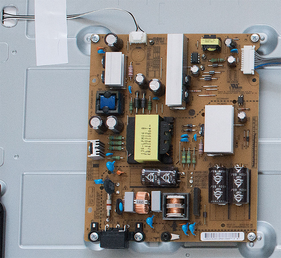

    My neighbour just gave me their LG 42LN578V that with a torch shows the image perfectly clear and crisp but the backlight is not working, I have also not heard any sound from it either. I presume the LED driver is built into the screen itself as it seems the PSU powers the backlight rather than a separate board. Can anyone advise diagnosis steps? I was going to buy a new Power board as it makes a little bit of a whistling sound but don't want to throw money away on a none repairable set.

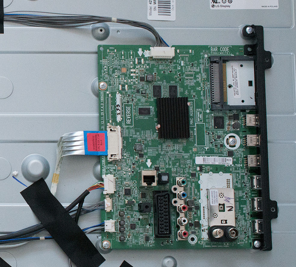

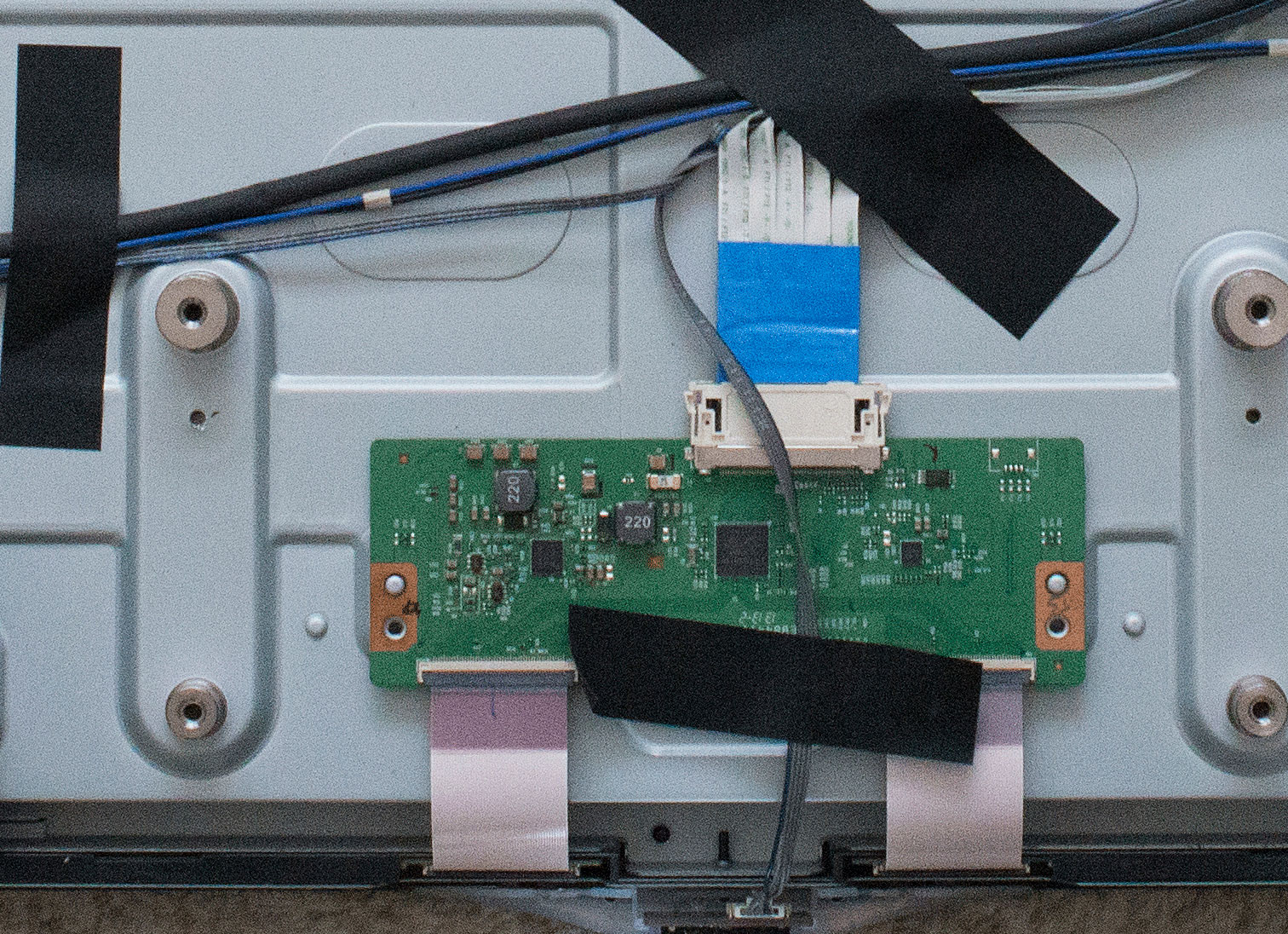

    Always post pics of board and chassis

      maybe check expected voltages on connectors on power supply, might be a label of expected voltages near connectors, as always be careful working with power supply, HIGH VOLTAGE, on primary side can be deadly.

            Re: LG 42LN578V picture but no backlight
            Pictures as requested. Crawley is a great place, not at all "creepy"
            Thanks for any help offered
                    can you see a label by your power supply connectors on the board? might say 3.3v, 5v, 12v etc.
                    • nomoresonys
                      • Jan 2013
                      • 12323
                      • U.S.
                      you may want to try a different power board, sometimes they are pretty reasonable, the whistling could be from a transformer. even if its not the problem, and you get it at a good price, at least you have a spare, and can rule it out, as long as the one you buy is good.
                        I will buy a new board as they are pretty cheap used. It would be a miracle if it fixed it but a lovely surprise Will post back when it arrives. Thanks guys
                            Ok the bad news:
                            PSU didn't fix it, there was a string of led's faulty when I took it apart
                            Good news:
                            I bought the same tv from gumtree (100 mile drive last night) with a cracked screen for £20, swapped my decent lcd panel over (probably some dust behind but oh well) and taddaaaa!
                                  Originally posted by nikonite
                                  Ok the bad news:
                                  Good news:
                                  I'll bet that faulty string is what had your board humming.
                                    Probably due to it current limiting.

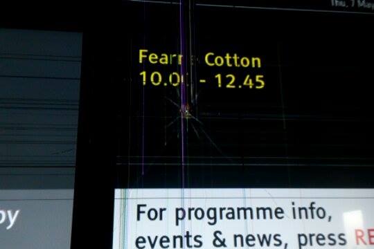

                                      i know this is proberly a no but i have this tv but it seems the crack is inside the screen would it be possible to buy the inside panel as a replacement ?
                                      • nikonite
                                        • Oct 2014
                                        • 10
                                        • United Kingdom
                                        There is no 'inner' panel I'm afraid, just the lcd and then several plastic layers. You would need to replace the lcd panel and getting an undamaged one will be pretty difficult. Probably more than the cost of a second hand set.
