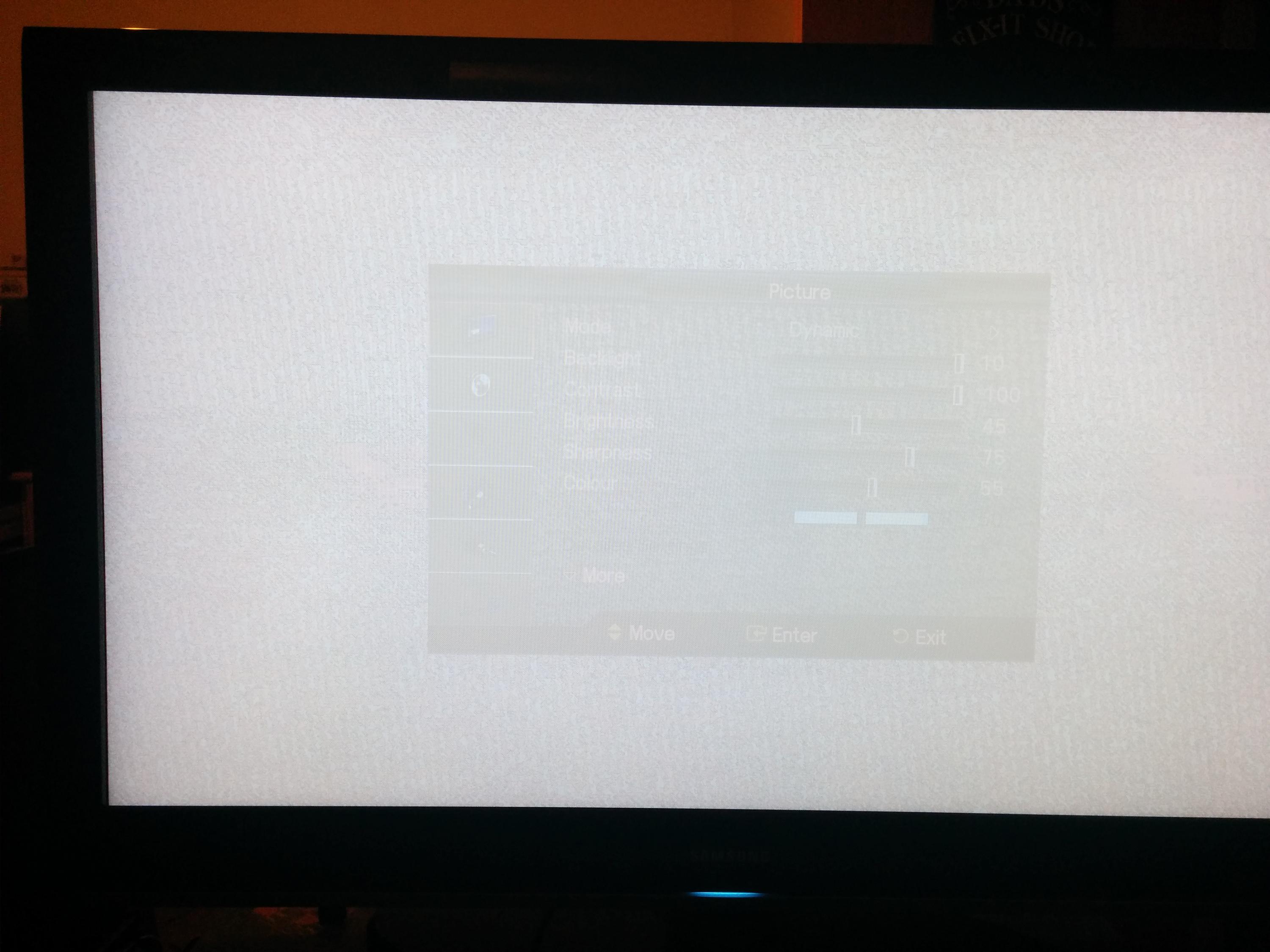

        My immediate problem now as I mentioned is that the screen is washed out. The whole screen is washed out, even from cold.
        If I could rectify this issue first, I wonder whether the original issue would return.
        I have reseated the tcon connection cables several times but this has no effect.
        Here is a screen shot of the washed out screen.
        Regards
        Jason

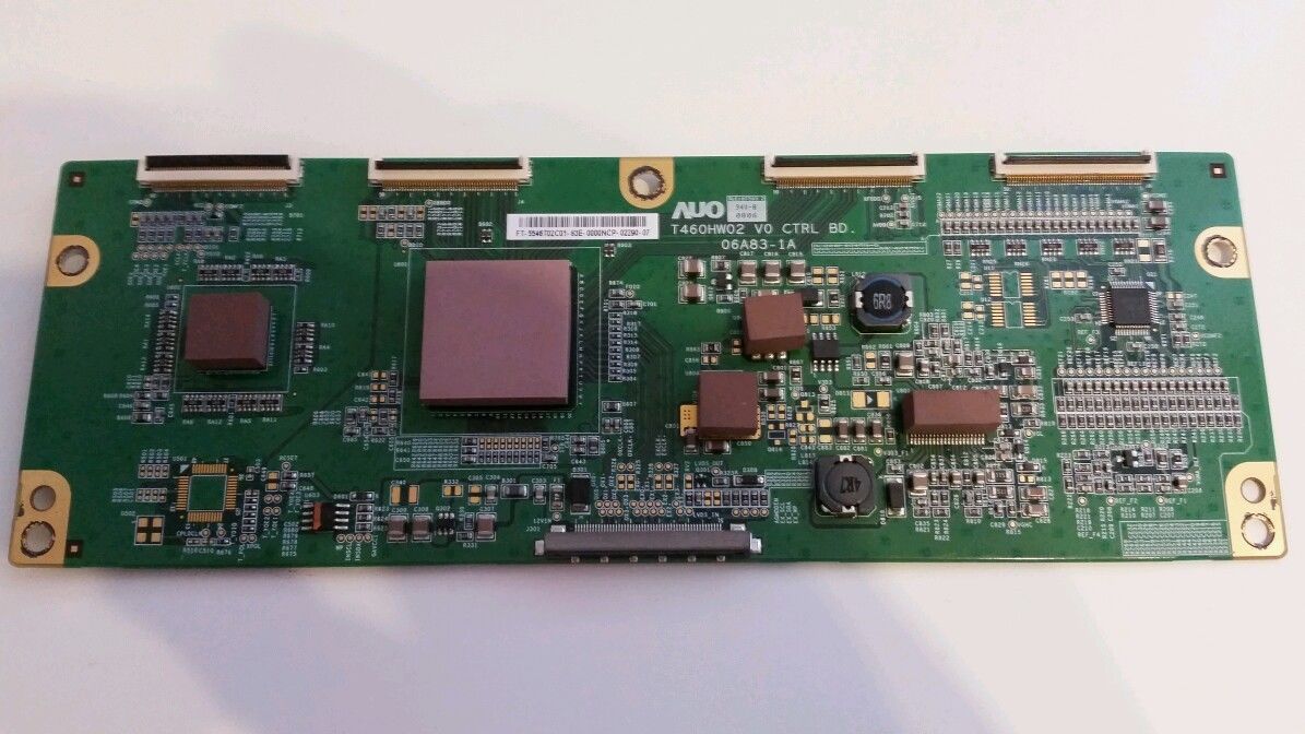

          Re: Samsung LE46A55 bright white screen
          Photo of the T-con? Is it an AUO optronics?
          • bootlegger17
            • Sep 2012
            • 56
            • isle of man
            Erri yes it is. This is the replacement I bought which made no difference.
            Same fault existed when using both. (that is the orginal fault with the faded black left hand side). I have tried exchanging boards since the white screen fault. Why do you ask?
            J
              Very common fault on these, bet you've been sold a bad board. Top right corner there is an array of test points usually labelled VGAMA1..22 (or VG1, VGAM1, VGA1, GAMA1, etc.)
              Please install the board & measure voltage on each test pad with a digital multimter (red probe on the point, black on the chassis.) Tell us the reading on every pad. Some may be missing on some T-cons so just post what you can find.
                I am going to bet its a bad AS-15 gamma chip. I have a 37" Sammy with a Chunghwa 1370WA03C04G AUO optronics T-con with a Bad AS-15 chip that is doing a solid white screen with very very faint picture that can be seen.
                As tom has instructed you, take those gamma voltages.

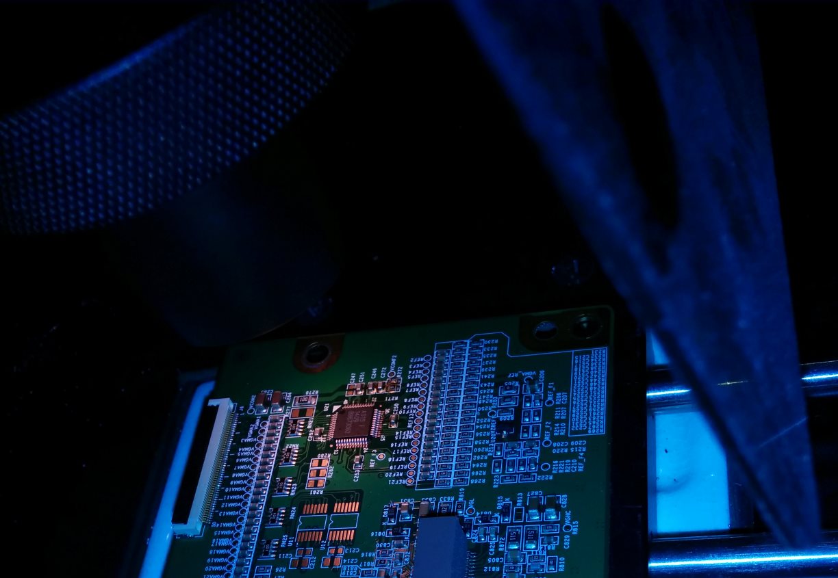

                                I have since tried removing the power cable from the top of power board to the back left inverter - the screen stayed black. I have tried removing the power cable from the bottom of the power board to the back left inverter and the screen came on bright white but with darkening to the left, the went off. I repeated the same last step for the right inverter and same result. Connected all cables back up, and result still the same, over exposed white screen.
                                I have removed the metal frame work from the LCD and touched all tabs whilst screen is on to see if I can make any response(flickering, dimming etc), but nothing happened.
                                Any other ideas on why the screen is so bright?
                                Regards
                                Jason

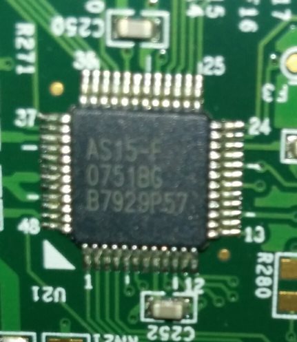

                                  I just found this post on badcaps;
                                  https://www.badcaps.net/forum/showthread.php?t=31725
                                  The pictures show exactly the same fault as mine, and the fix was the gamma chip replacement on the tcon by the looks of it. Guess I will have to investigate this avenue. Cant believe that I have two dead tcon boards though.
                                  So which chip on my tcon board is this mysterious AS-15 Gamma chip? Is it really worth me attempting to replace the chip, or simply take another punt on another tcon board off ebay? Would there likely be any other components along with this chip that have failed - is it something else that is killing this chip, like overvoltage from the power board maybe?
                                  Regards
                                  Jason
                                  • bootlegger17
                                    • Sep 2012
                                    • 56
                                    • isle of man

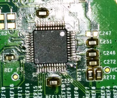

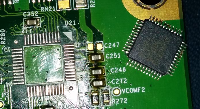

                                    I took a punt and ordered some replacement AS15-F chips to replace on the tcon board.
                                    I have replaced but there is no difference
                                    Here are some pics of the process.
                                    original_1.jpg pic of original chip before removal
                                    original_removed_1.jpg - pic of chip removed
                                    new_infra_1.jpg - pic of chip being resoldered in my infrared station
                                    new_insitu_1.jpg - pic of chip after replacement.
                                    Now I have a fair confidence factor that its not the tcon board at fault, or if so, its not the chip. What else should I be looking for......
                                    help......
                                    Jason
