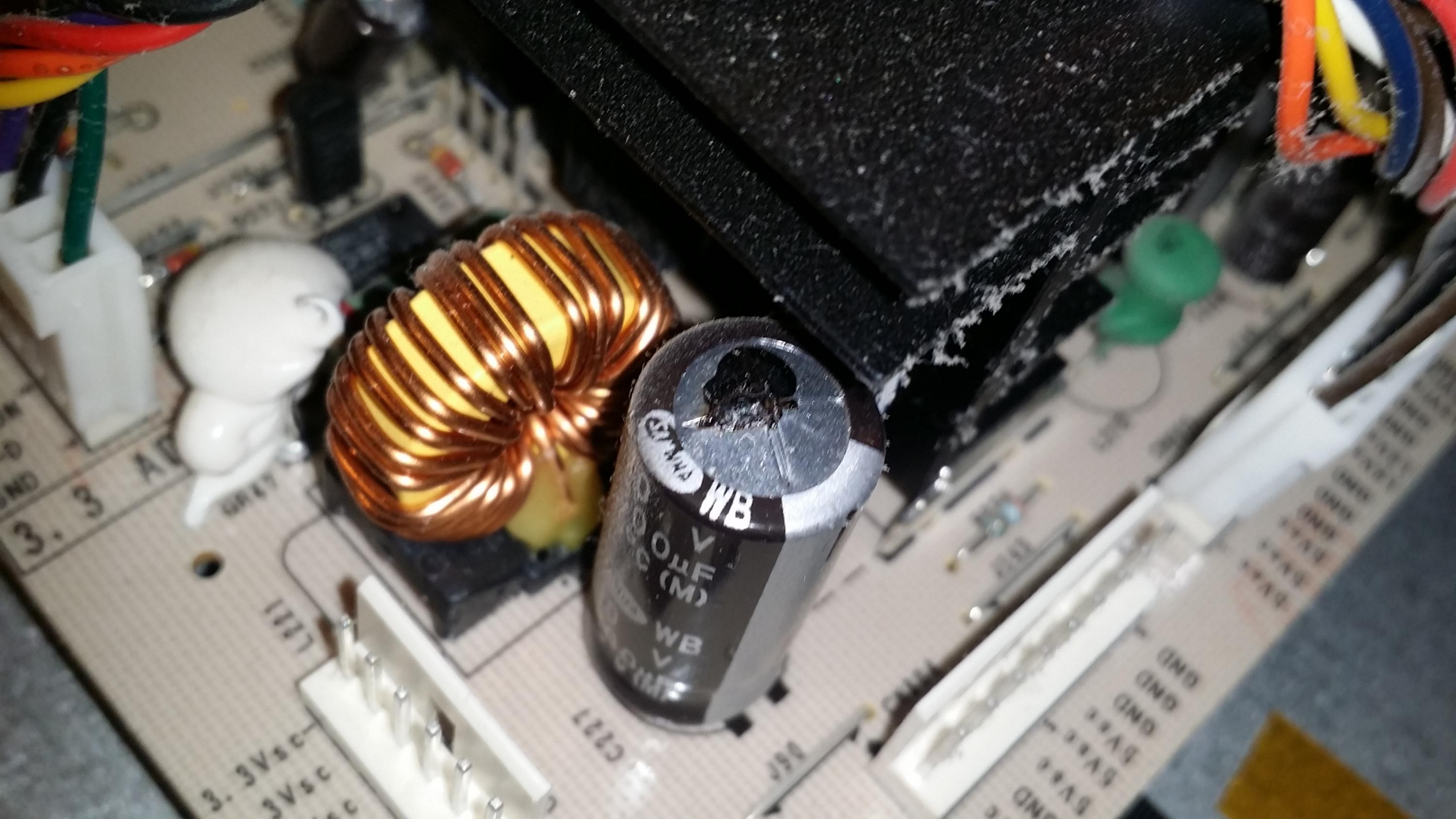

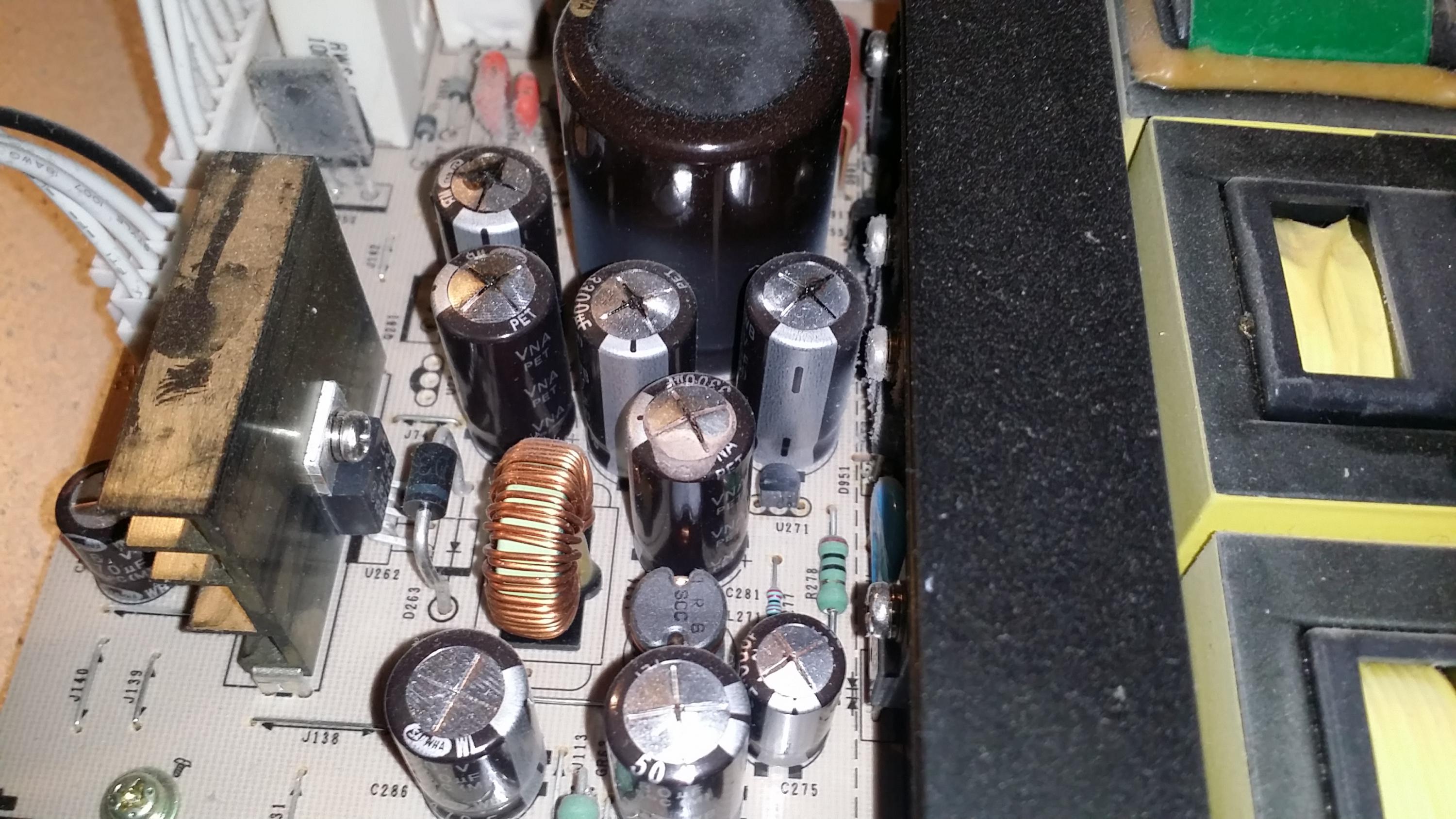

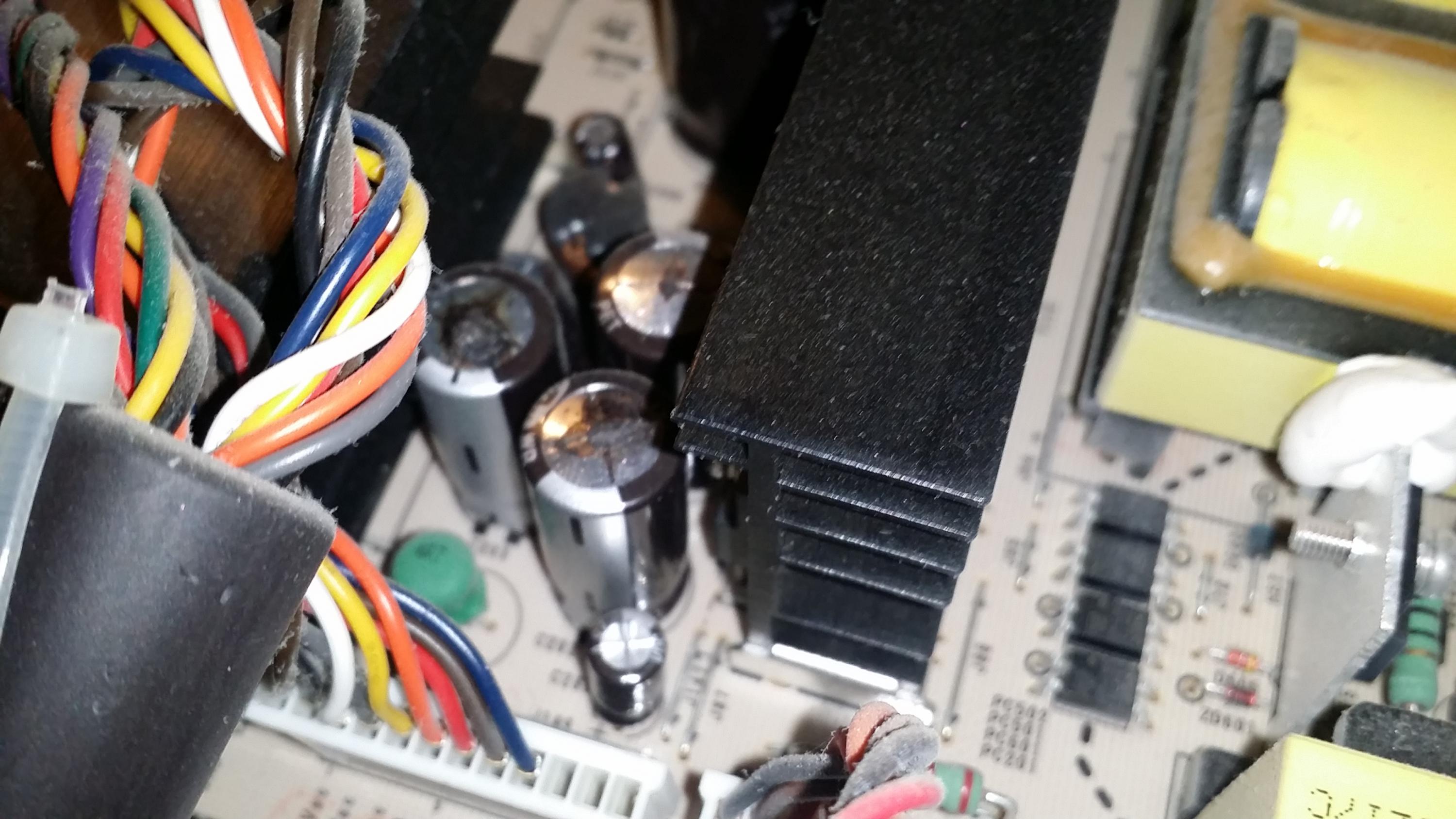

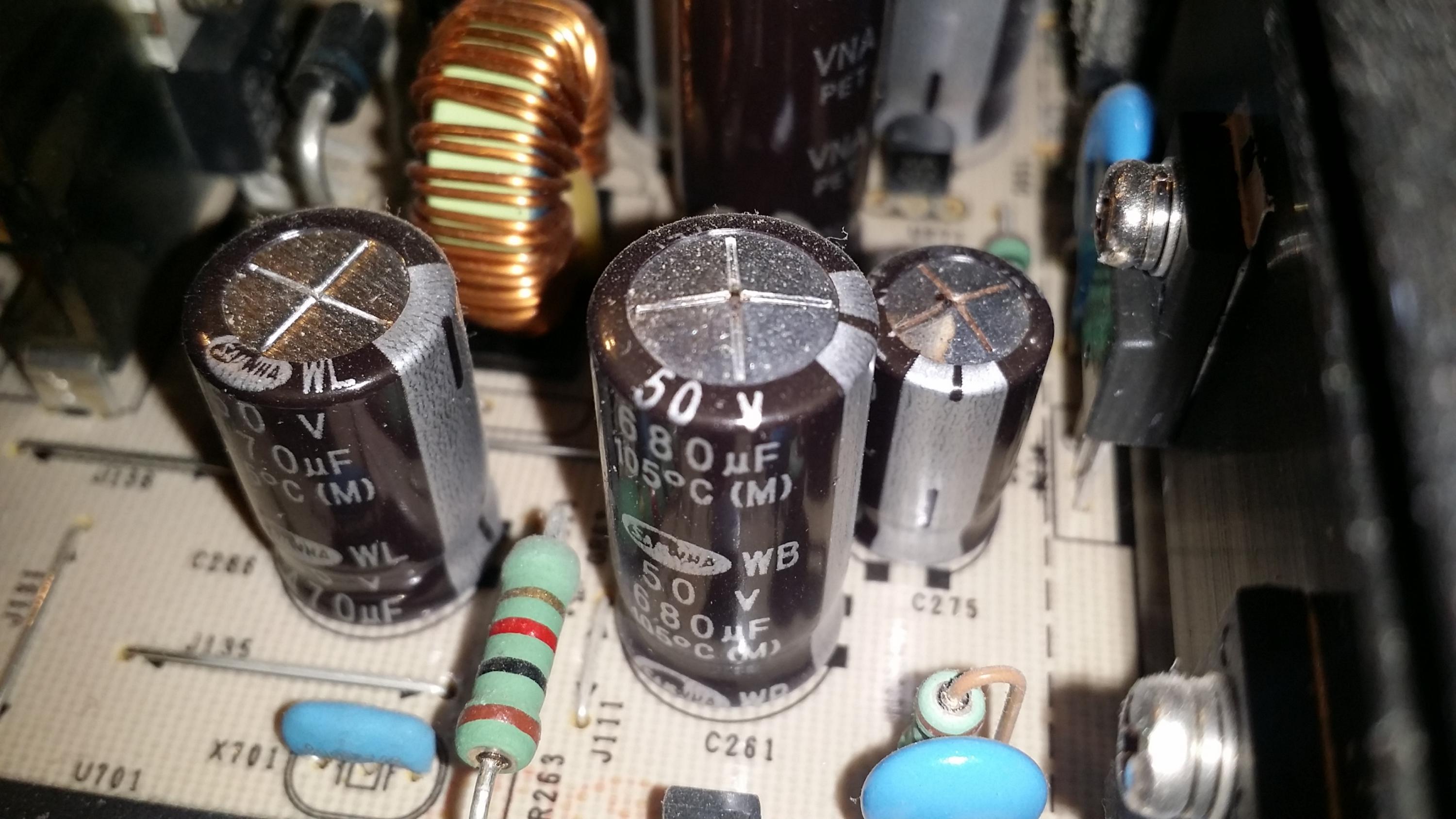

            Re: Vizio JV50P HDTV10A Sometimes sound, sometimes video...
            Finally got to open up the back of this heavy beast. Looks like a bad cap issue. Pictures show the evidence. I have heard of a cap kit for this set. Should I replace all the caps that come in this kit or just replace the bad ones? I would assume all of the caps from the kit. I hope replacing these parts will alleviate the issue!
              Replace all the caps in the kit for reliability reasons. the ones that aren't Looking bad will go eventually from heat and stress
                Replace all but the 4 large caps. I think there are 25 or so.
                The 2 large 450v 330uf,1 450v 68uf and 1 250v 820uf probably wont need changed.
                All of the caps have the same hours on them, some have more stress than others. I like to change all of them to prevent having to open it up and replace others at a later time.
                        Local stores are unlikely to have the correct capacitors. You will need to order them from Digikey or other electronics supplier.
                        Radio shack caps are not for use in a PSU.
                        Write down the values of each cap Uf and Volts then look for the series code. Usually 2 sometimes 3 letters on electrolytic caps. For instance RH, SK SG, and PT are what I have handy to reference.
                        Then search for manufacturers datasheet for each to find impedance and ripple current.
                        If they are somewhat common post the list and we can help determine what would be the correct replacements.
