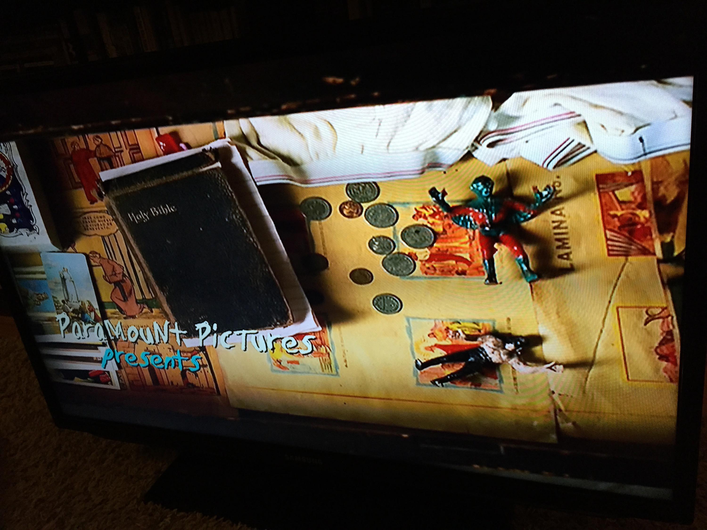

                                      Looks like I'm on my own with this one. I'll report back once I get it working.
                                        #39
                                        Re: Samsung UN32EH5000FXZA, No Backlight
                                        Power supply and LED strips. I bought a set with a broken screen off ebay for 15 bucks.
                                          #40
                                          so did you try the old power supply? Just for shits and giggles...
