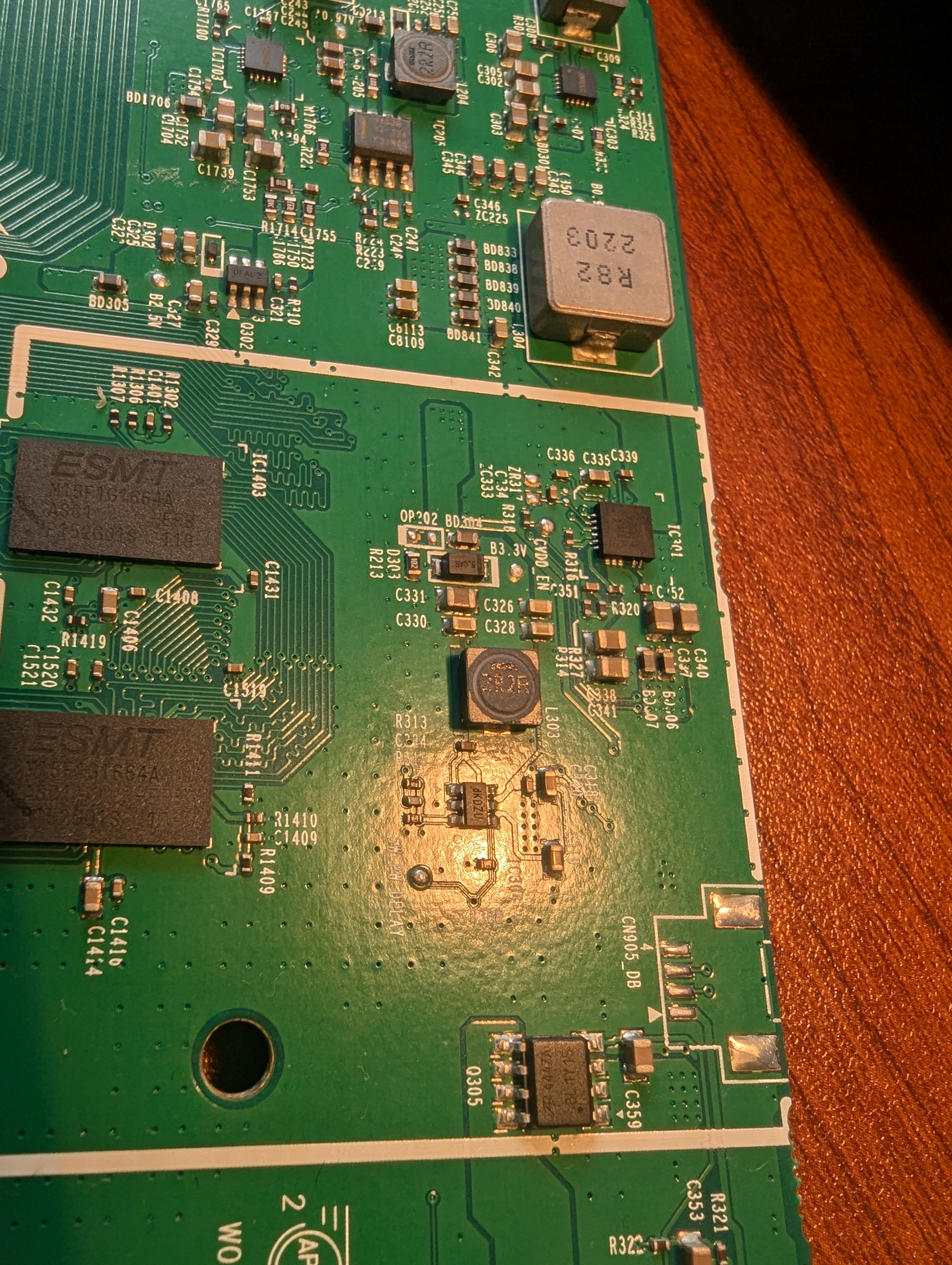

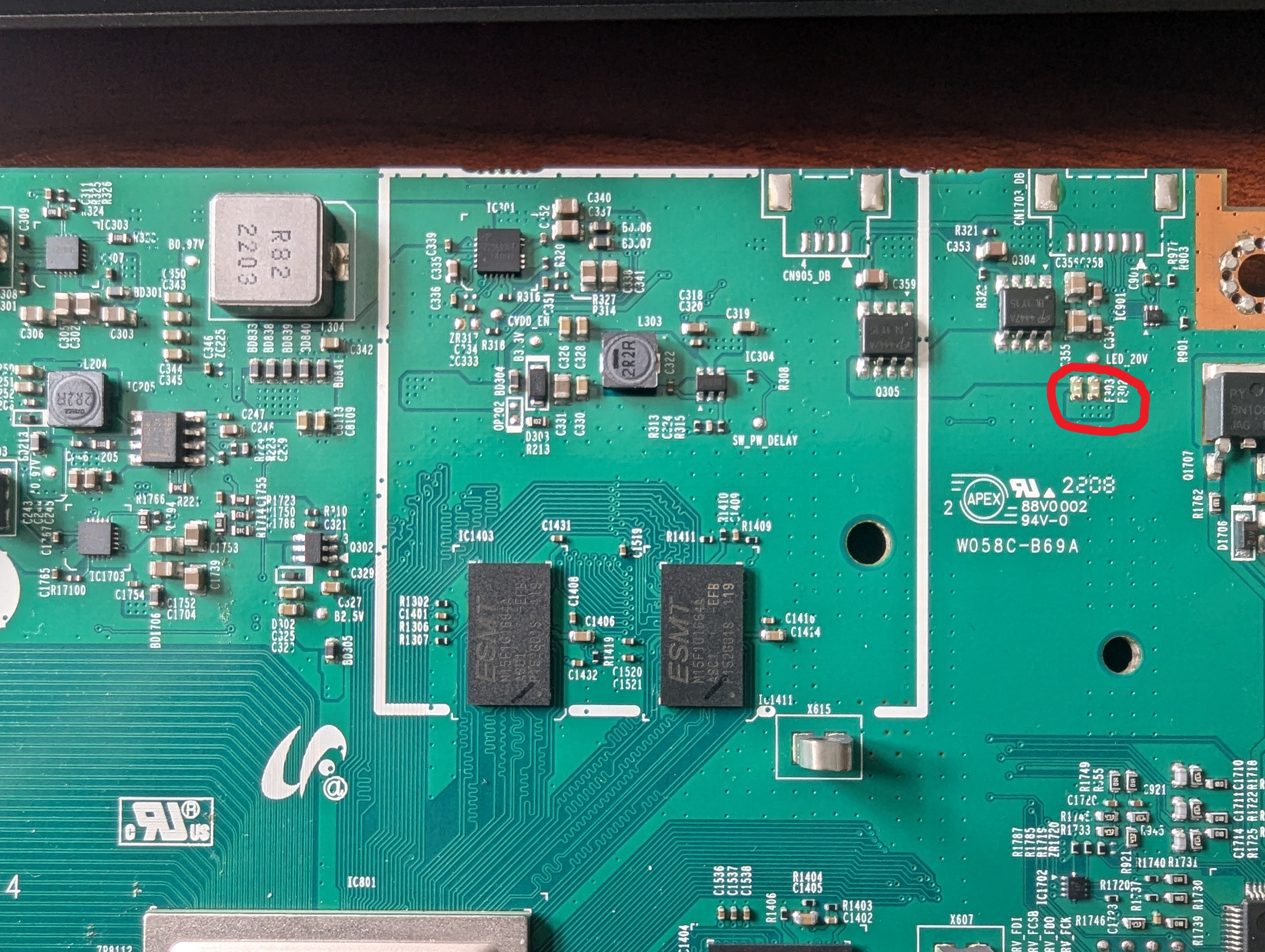

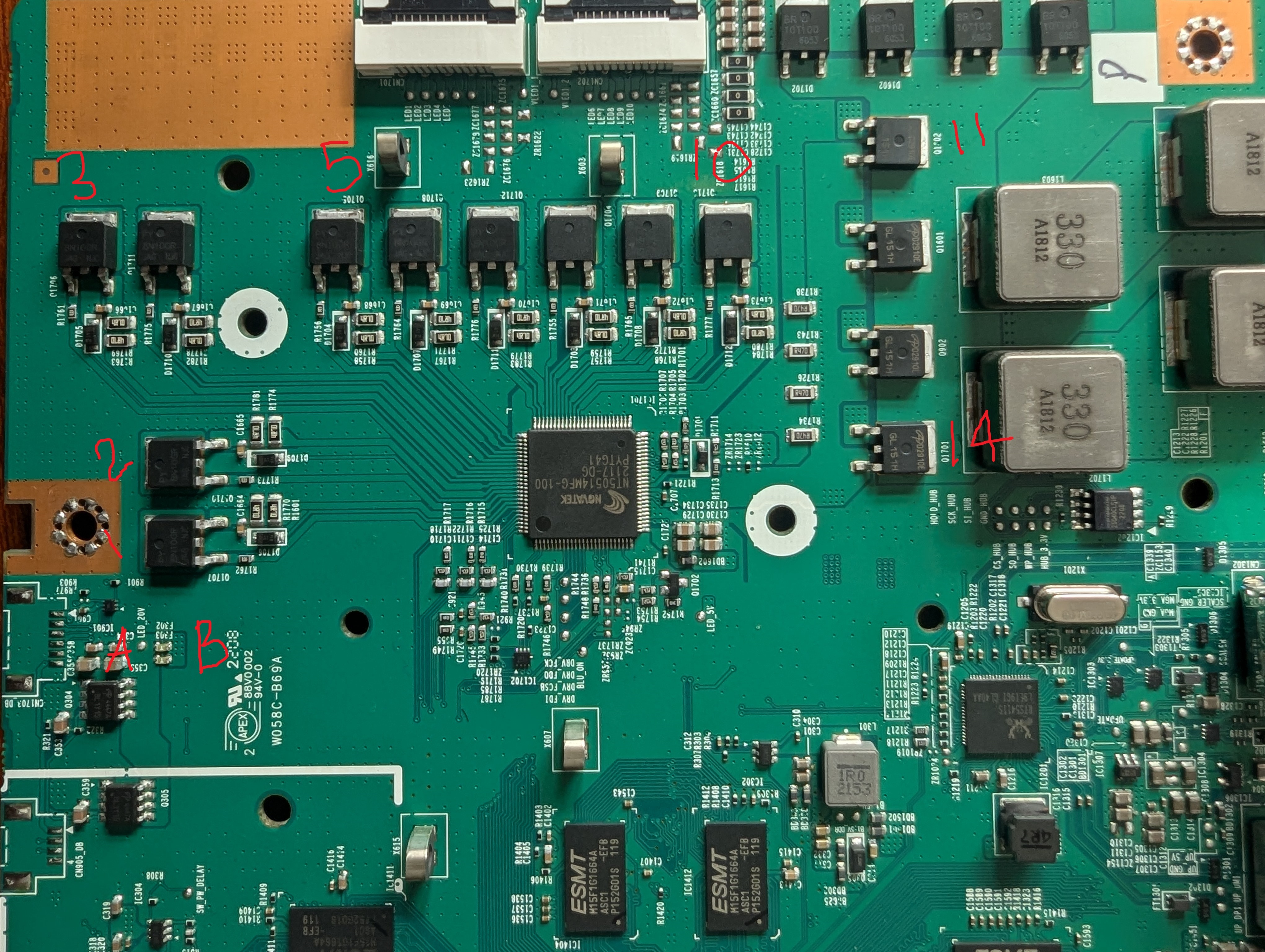

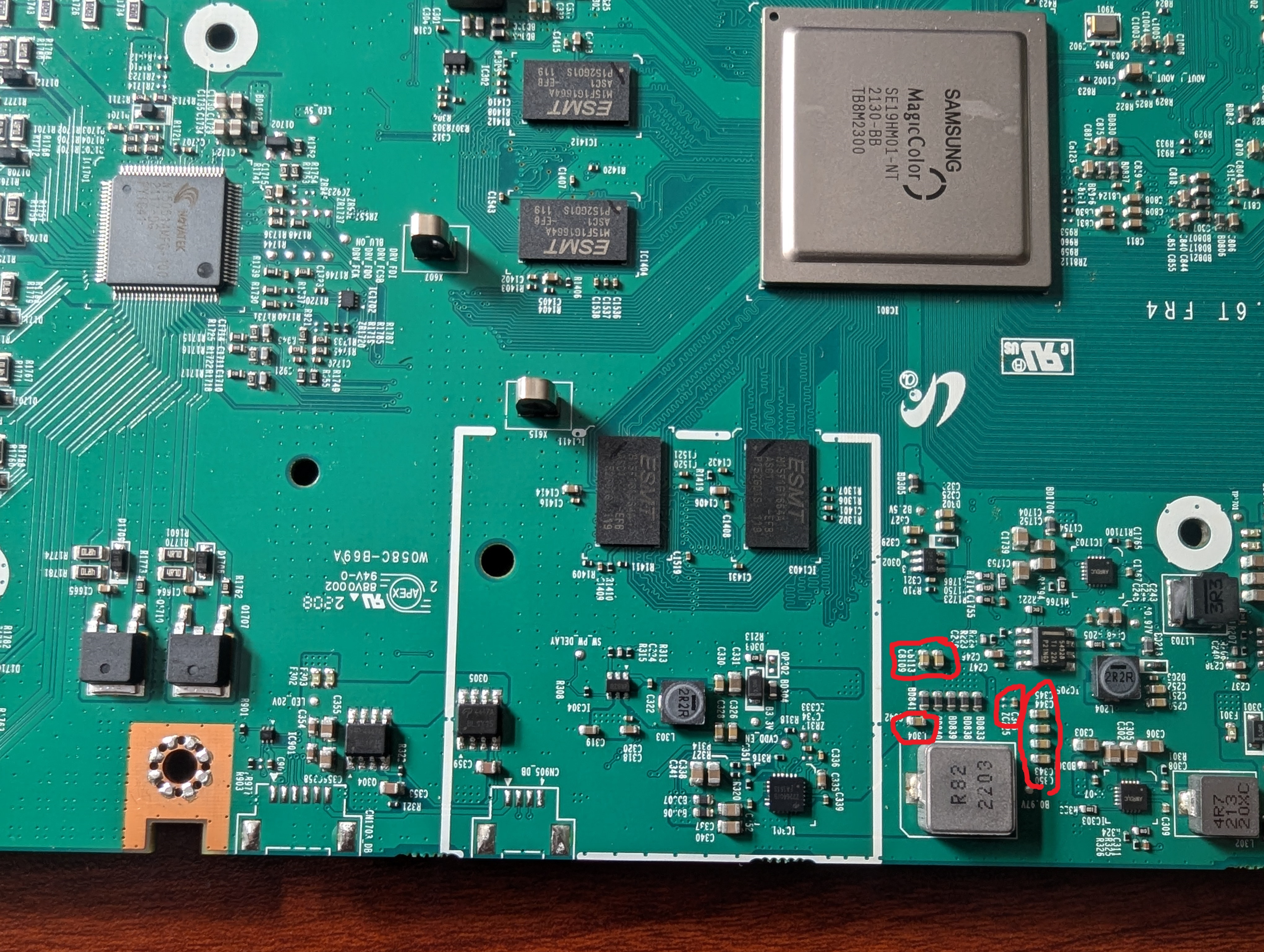

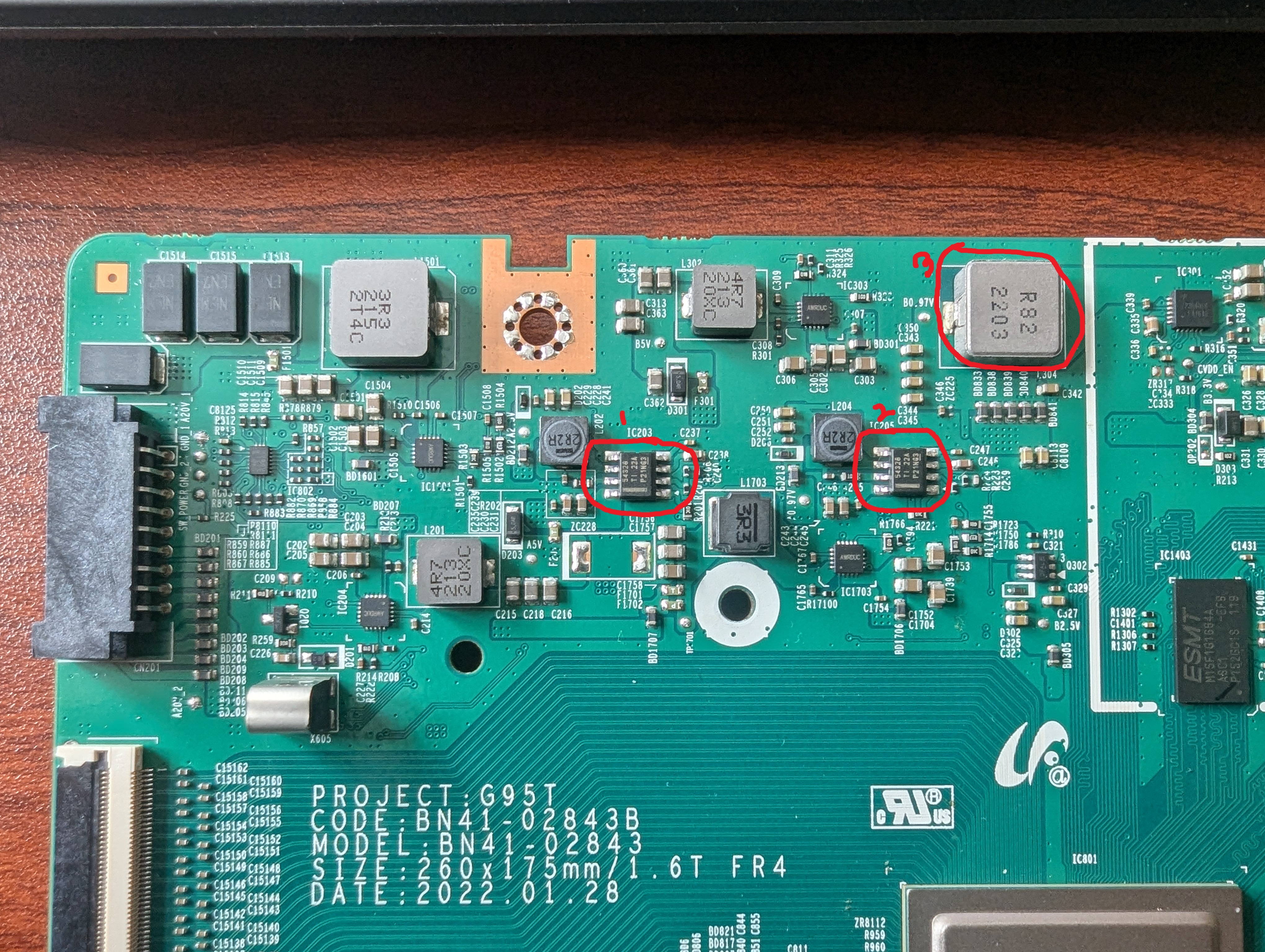

Samsung Odyssey G9 (c49g95tssr) no picture or backlight. Power LED shows
  • grimreaper420
    • Sep 2024
    • 41
    Samsung Odyssey G9 (c49g95tssr) no picture or backlight. Power LED shows
    hey guys,
    i bought 2 samsung odyssey g9's for a decent price. they both have the exact same fault. when plugged into a power source, the blue led powerlight shows, but when turned on there is no picture, no backlight, no menu, nothing. when plugged into a laptop the laptop recognises the monitor, but keeps disconnecting and reconnecting.
    dont have any schematics or diagrams unfortunately. any ideas?
    thanks
  • grimreaper420
    • Sep 2024
    • 41
    bit more information
    The power supply connects to the main board. There is like a checkpoint on the mainboard that says 20v, and i tested that with a multimeter and i can confirm that I'm getting 20v in. There are a few ribbon cables coming off from the mainboard to the T-CON. I tested those voltages, and those are really low. Less than 1v.
    I attached a picture of the main board.
    1 - 20v power cable directly from PSU
    2 - ribbon cable going to TCON - LOOKS LIKE CORRECT VOLTAGE IS OUTPUT
Name:	mainboard2.jpg
Views:	1000
Size:	3.37 MB
ID:	3342855​ going to TCON - DOESNT LOOK LIKE CORRECT VOLTAGE IS OUTPUT (<1V)
    4 - cable leading to power button and LED backlight (BACKLIGHT DOES NOT WORK, BUT POWER LED DOES) (DOESNT LOOK LIKE CORRET VOLTAGE IS OUTPUT (<1V))
    5 & 6 - labelled LED, not exactly sure where this goes
    • lotas
      • Jan 2016
      • 4708
      • Russia
      You won’t find any diagrams, you don’t even have to look, check all the fuses in the area of ​​the dc/dc converters and what voltages are at the control points relative to the ground, measure the resistance on the inductors relative to the ground....
      • harp
        • Jun 2022
        • 615
        • Planet Earth
        When I see many mosfet on boad, first check for short on every of them sd, gs, gd, second check for short on coils... also check what is going on on IC301, one leg is black...
        Also check to not have shorts inside ports, usb ports especialy, I see this before on monitor. Users usualy destroy contact pushing in wrong angle, and force bent and ripup contacts crossing it together, because of weird position.
        5&6 probably LED backlight
        Last edited by harp; 09-03-2024, 07:17 PM.
        • grimreaper420
          • Sep 2024
          • 41
          Originally posted by lotas
          You won’t find any diagrams, you don’t even have to look, check all the fuses in the area of ​​the dc/dc converters and what voltages are at the control points relative to the ground, measure the resistance on the inductors relative to the ground....
          checked the fuses and all were fine, apart from two, circled in red. the inductors all read 0L apart from the one highlighted in 3 which had resistance of about 43ohms. tested the IC chips 1 and 2, and they read 0.755v and 0.760v.
          • grimreaper420
            • Sep 2024
            • 41
            Originally posted by harp
            When I see many mosfet on boad, first check for short on every of them sd, gs, gd, second check for short on coils... also check what is going on on IC301, one leg is black...
            Also check to not have shorts inside ports, usb ports especialy, I see this before on monitor. Users usualy destroy contact pushing in wrong angle, and force bent and ripup contacts crossing it together, because of weird position.
            5&6 probably LED backlight
            checked the ports and they tested fine. also checked the coils and there were no shorts. for IC301, that was just a bad picture, there doesnt even seem to be a leg there. but doesnt look like its missing either (see pic).
            ive checked a few guides on youtube to test mosfets but everyone seems to have a different method, with some more accurate than others. is there an accurate way to test it by using just a multimeter and without having to remove the mosfet?
            • lotas
              • Jan 2016
              • 4708
              • Russia
              Originally posted by grimreaper420
              checked the fuses and all were fine, apart from two, circled in red. the inductors all read 0L apart from the one highlighted in 3 which had resistance of about 43ohms. tested the IC chips 1 and 2, and they read 0.755v and 0.760v.
              These fuses (LED 20v) seem to be responsible for the backlight, you need to check the resistance to ground on each side of the fuses, check the output transistors of the led drivers.
              43 Ohm on the inductor may be normal, since this is power supply to the processor core, and as always it has a low value.
              On IC 1, 2 the low voltage may be due to the fact that they do not receive the command (ENable) from the processor....​
              • grimreaper420
                • Sep 2024
                • 41
                Originally posted by lotas
                These fuses (LED 20v) seem to be responsible for the backlight, you need to check the resistance to ground on each side of the fuses, check the output transistors of the led drivers.
                43 Ohm on the inductor may be normal, since this is power supply to the processor core, and as always it has a low value.
                On IC 1, 2 the low voltage may be due to the fact that they do not receive the command (ENable) from the processor....​
                Tested resistance to the fuses, and i cant get an accurate enough reading, the numbers jump from 0L to 200 on both of them on sides 'B'. On sides 'A' of the fuse, they are around 23 Ohms.
                For testing the transistors, i followed this video (https://www.youtube.com/watch?v=uKyYUHU-wMA). The first value is red lead on source and black lead on drain. second value is opposite, so red lead on drain and black lead on source.
                1 - 8.9 / 0
                2 - 8.6 / 0
                3 - 8.1 / 0
                4 - 8.7 / 0
                5 - 8.3 / 0
                6 - 8.1 / 0
                7 - 8.6 / 0
                8 - 8.2 / 0
                9 - 8.2 / 0
                10 - 8.6 / 0
                11 to 14 - 23 / 23
                Hopefully this makes sense. Let me know if it doesnt.
                • harp
                  • Jun 2022
                  • 615
                  • Planet Earth
                  ive checked a few guides on youtube to test mosfets but everyone seems to have a different method, with some more accurate than others. is there an accurate way to test it by using just a multimeter and without having to remove the mosfet?
                  Yes, in repair is often use these fast onboard check, put your multimeter in diode mode (beeping mode) and check between gate and drain, gate and source and source to drain. It is the same if you check transistors. The power device like mosfet in TO252 package are very much stressed and may create a internal short, about 0.1 ohm. There must no be low reading especialy to gate. That you are looking for.
                  The test isnt 100% acurate, depend of shematic, but in most case work, and save lot of time. If you suspect in one, look in closely of pcb connections, and if you not find nothing reason for low ohm reading, desolder it and test separately, and redo same pcb measurements without them to compare. If you find multiple device shorted with exact reading, they may heave to be on same rail, and only one is shorted... you can pinpiont by measuring heat.
                  Also, if you have not hot air, you can desolderit it with iron, just put a small piece of baking paper (for making cake) between leg and pcb to separate solder while luquid, see video
                  https://m.youtube.com/watch?v=Khs6txY6iW4
                  • lotas
                    • Jan 2016
                    • 4708
                    • Russia
                    If there is low resistance at point A, then check those mosfets and ceramic capacitors for short circuit first...
                    • grimreaper420
                      • Sep 2024
                      • 41
                      Originally posted by lotas
                      If there is low resistance at point A, then check those mosfets and ceramic capacitors for short circuit first...
                      I tested the mosfets by putting my multimeter in continuity mode and there were no beeps from the red probe on source and black probe on drain. so i think that there is no short on the mosfet. i tested the capacitors by doing the same thing, on continuity mode and there were no beeps on the capacitors in that area. BUT quite a few of the capacitors in the red circle were beeping.
                      Not 100% sure if the method i used was the right way to test the mosfet.
                      • lotas
                        • Jan 2016
                        • 4708
                        • Russia
                        There is a low resistance here, as I already wrote 43 Om (0.97v), this is the power supply to the processor core, you need to determine why the fuses on the 20v led are blown, what could be shorting in this circuit... if the mosfet has a breakdown, then it has all three legs calling each other.
                        • grimreaper420
                          • Sep 2024
                          • 41
                          Originally posted by lotas
                          There is a low resistance here, as I already wrote 43 Om (0.97v), this is the power supply to the processor core, you need to determine why the fuses on the 20v led are blown, what could be shorting in this circuit... if the mosfet has a breakdown, then it has all three legs calling each other.
                          I retested the mosfet and did:
                          Drain to Source (D-S): I measured 0.417V in diode mode, which seems within the normal range for an N-channel MOSFET's body diode.
                          Gate to Source (G-S) and Gate to Drain (G-D): I tested for shorts between these pins and got OL for both, so there's no short between these terminals.
                          Based on this, it looks like the MOSFET is working fine.
                          I retested the capacitor and that retested fine. Could the mosfet still be bad, even after testing?​
                          • lotas
                            • Jan 2016
                            • 4708
                            • Russia
                            You could simply charge the mosfet with a multimeter and it would open and begin to conduct, you need to bridge all the legs with something metal and check again.
                            • grimreaper420
                              • Sep 2024
                              • 41
                              Originally posted by lotas
                              You could simply charge the mosfet with a multimeter and it would open and begin to conduct, you need to bridge all the legs with something metal and check again.
                              Retested the mosfet and it showed the same 0.417v on and off. No shorts. I didn't realise, but it is actually a P-Channel mosfet. The code is 4447A and online documentation says "30V P-Channel MOSFET". Would the next step be to remove the mosfet and recheck, or move our attention onto somewhere else?
                              • lotas
                                • Jan 2016
                                • 4708
                                • Russia
                                Originally posted by grimreaper420
                                Retested the mosfet and it showed the same 0.417v on and off. No shorts. I didn't realise, but it is actually a P-Channel mosfet. The code is 4447A and online documentation says "30V P-Channel MOSFET". Would the next step be to remove the mosfet and recheck, or move our attention onto somewhere else?
                                It has a built-in diode, if in doubt, then unsolder it and check it.
                                • grimreaper420
                                  • Sep 2024
                                  • 41
                                  Originally posted by lotas
                                  It has a built-in diode, if in doubt, then unsolder it and check it.
                                  yes sir. will take me a few days to unsolder and check it, but once i have, i will let get back to you
                                  • lotas
                                    • Jan 2016
                                    • 4708
                                    • Russia
                                    Does the second motherboard (second monitor) have exactly the same problem or have you not taken it apart yet?
                                    • grimreaper420
                                      • Sep 2024
                                      • 41
                                      Originally posted by lotas
                                      Does the second motherboard (second monitor) have exactly the same problem or have you not taken it apart yet?
                                      the second one has the exact same problem. i've given that one to a electronic board specialist, who said he will have a look. hes still got that one. he didnt seem confident in repairing it, which is why im trying to learn and repair at the same time
                                      i'm not sure what happened to them, but i think the previous owner must have them both running together. probably explains why they both have the same fault.
                                      • lotas
                                        • Jan 2016
                                        • 4708
                                        • Russia
                                        Then you need to check the signal lines at the HDMI and DP inputs for resistance relative to ground, if you connected it “hot”, that is, the monitor was connected to the network and the source too, and when connecting the connecting cable, a discharge could occur and then the processor would die, or maybe there was lightning ...
                                        • TR103
                                          by TR103
                                          - it keeps rebooting
                                          01-22-2025, 04:12 PM
                                        • Mgiffune
                                          by Mgiffune
                                          06-09-2024, 10:28 AM
                                        • Ierwin
                                          by Ierwin
                                          05-13-2025, 03:31 PM
                                        • gl4709
                                          Samsung un55cu7000d with backlight and sound No Video / Picture
                                          by gl4709
                                          I am working on a Samsung un55cu7000d which has backlights and audio. There is no picture. This model does NOT have a separate TCON board. Before I order a main board I would like to try and confirm that the issue is not in the display. The ribbon cable from the main board goes directly to the display and I can then disconnect the left from the right. When I disconnect the right side the display lights up on one side but has no video being displayed. Can you all give me some guidance on how to confirm the main board is the issue.
                                          01-23-2025, 06:21 PM
                                          09-07-2024, 05:50 AM
