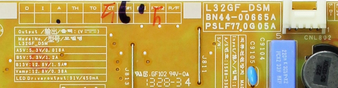

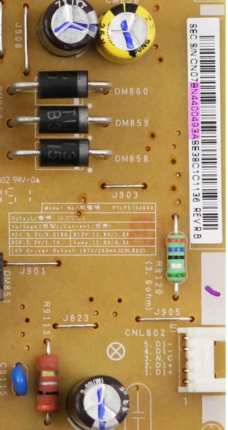

    Would you agree that the 493 power supply is NOT a valid substitute? I think I have justification to go back to ShopJimmy and ask for my money back. What do you think?
    That is correct due to the way the LED strips are connected.
    They can easily check how the pins of the LED connector are connected on each board.

      BTW, these are the LED Voltage charts for the BN44-00493A and BN44-00665A.
      I do not know how accurate they are.

              The good news is that ShopJimmy confirmed that the 493 board is NOT a valid substitute for the 665 board. When I pointed out my troubles, they investigated and profusely apologized for the mix-up. They said they have had that listed as an alternate for a long time and until now, nobody brought it to their attention. Their techs confirmed it would not work, at least, not without modification. Their web site has been adjusted accordingly.
              They have offered to let me return my original and second replacements at no cost and will refund all of my money in full. They were really good about it. Thanks to you for your help in confirming my suspicions and giving me a leg to stand on with SJ. I nearly returned it for a loss.

                                  Thought I'd post a follow up. I FINALLY fixed the TV. ShopJimmy.com investigated and realized that they mistakenly indicated the power supply they sold me as a compatible substitute. It was not. They refunded all my money and even paid the return shipping for me. That's quality customer service.
                                  I waited for 2 months to get the correct LED strips for this model but finally lucked out when they showed up on eBay. My original power supply was fine. The TV works GREAT! I've been careful to turn down the Backlight and Brightness values to as low as I can but still view comfortably. Hopefully I can nurse this replacement set along for many years. If necessary, I've got the old strips to cannibalize, thanks to your excellent repair info Budm. Thanks.
                                  One last problem - It was so long since I disassembled it, I forgot the specific orientation of the white plastic layers under the LCD. The thick heavy white plastic has a pebbled surface on one side, and smoother on the other. Which side should go towards the lights? Then comes a thin layer with a pearlescent side. I think the silvery pearl side goes goes towards the lights, but if anyone knows for sure, let me know.
