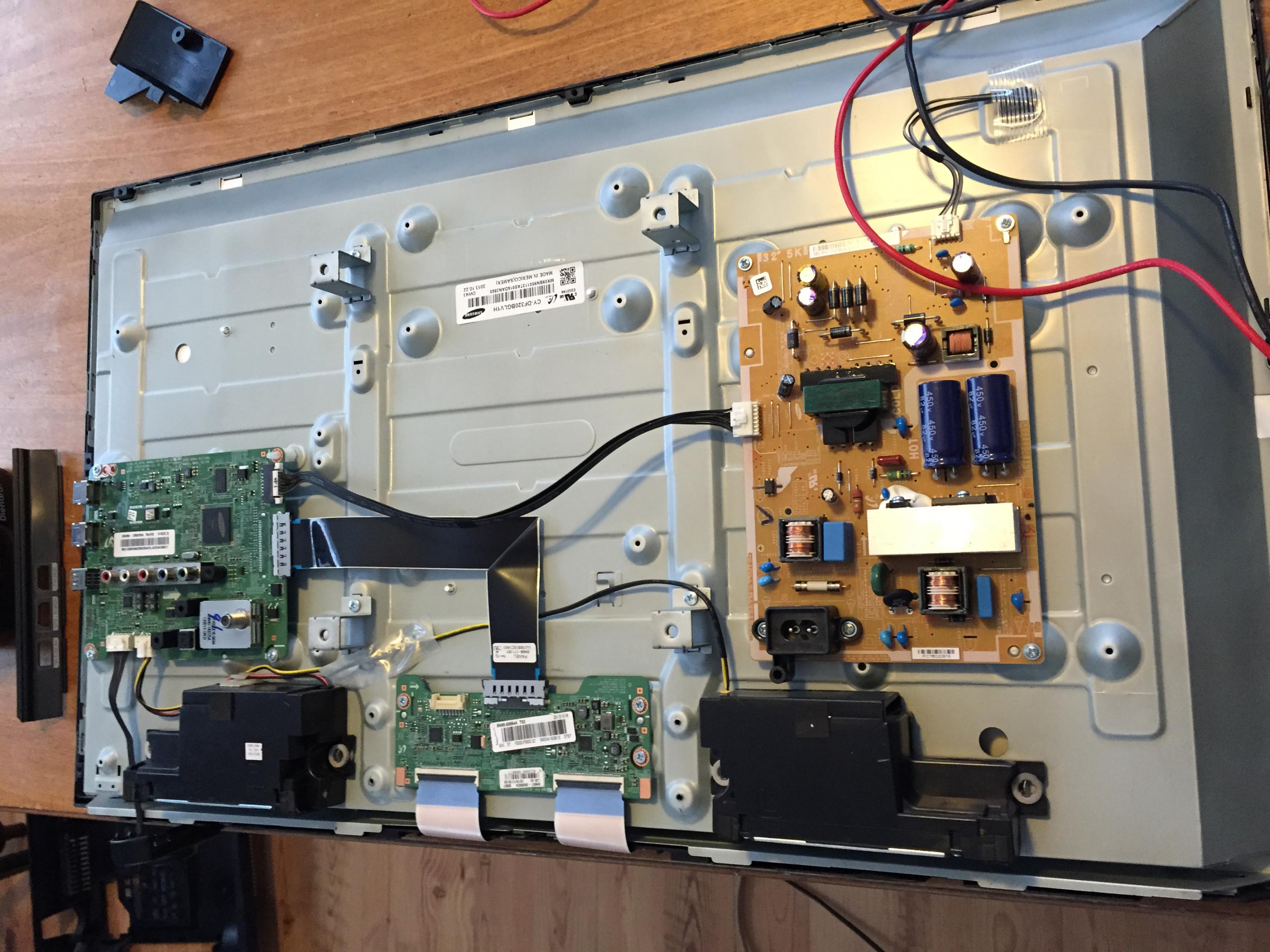

    I picked this one up today. It powers on but has no backlight. A flashlight shows that there is a picture. I believe that I have one or more open LEDs. In standby, the main cap shows 169V across it but when powered up, it only shows 166V. I find this to be confusing. I expected to see ~390V at power up. In standby, CNL802 shows ~95V at pins 1 and 2. When powered on, I see ~180V at those pins and all marked voltages are present at CNM803 as well. With CNL802 unplugged and the meter in diode mode, I get O/L in every possible configuration on the plug. I suspect that this points to at least one open LED for what I suspect to be two LED strings.
    Looks like I need to open the panel.

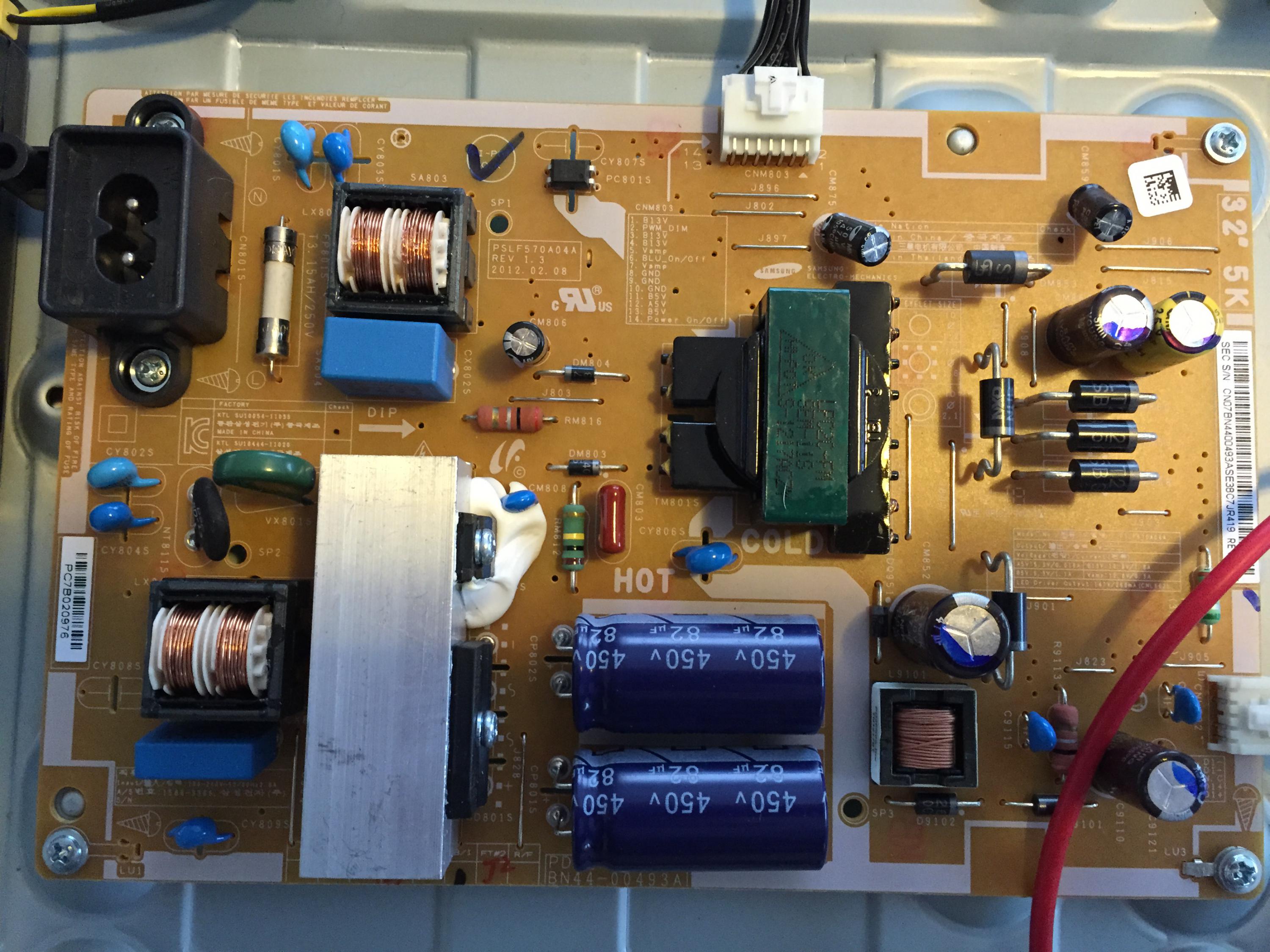

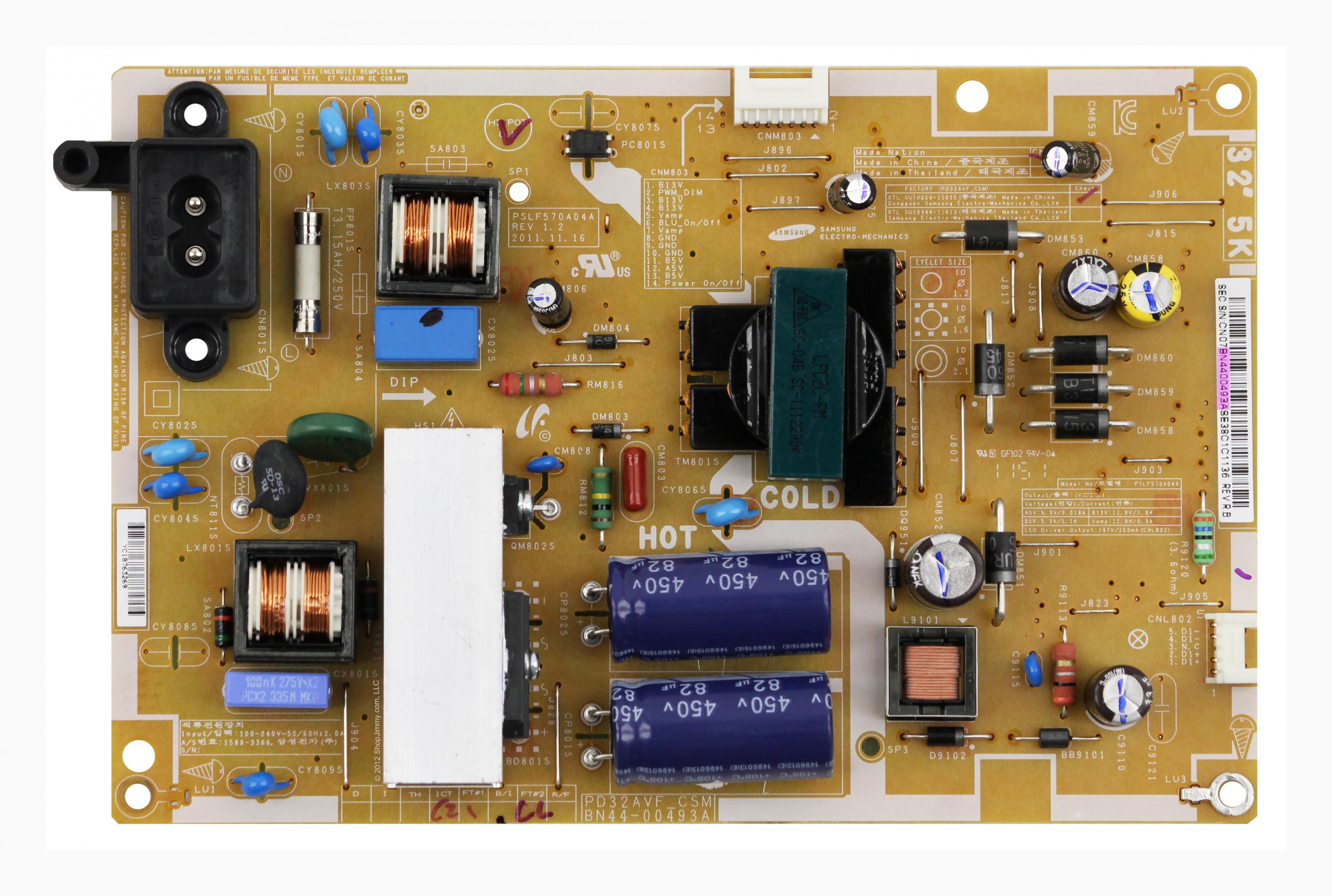

    This TV has no PFC booster, so the cap voltage will always be ~160V. You can tell this because there is no PFC inductor, diode, MOSFET, etc.
    They can get away without PFC because LED TV uses very little power.

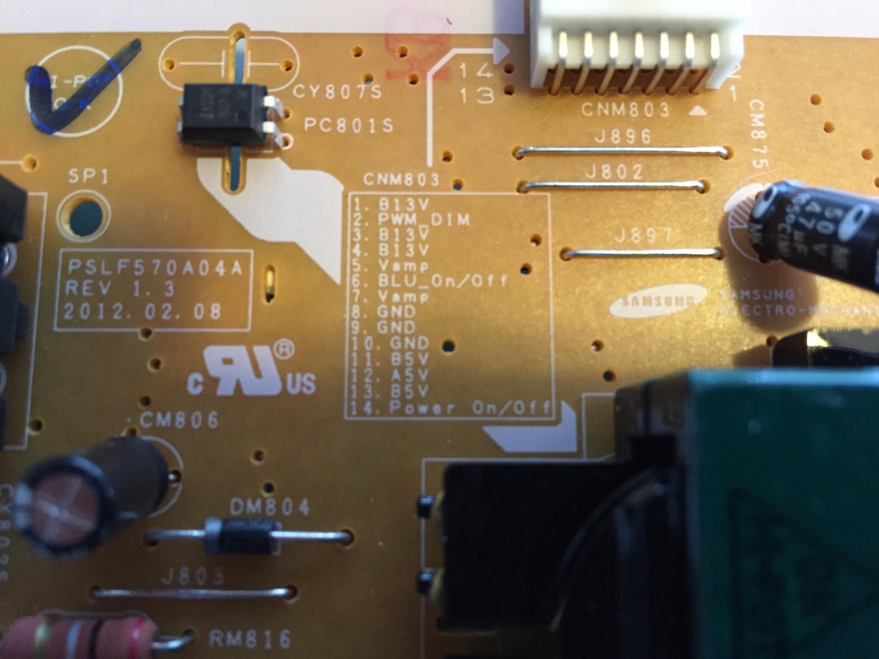

      Re: Samsung UN32EH5000FXZA, No Backlight
      plus you can't test the LED string like that with a multimeter anyway. Only thing you can do with a multimeter there is to check if one of the wires is shorting out to the metal frame and each individual LED.

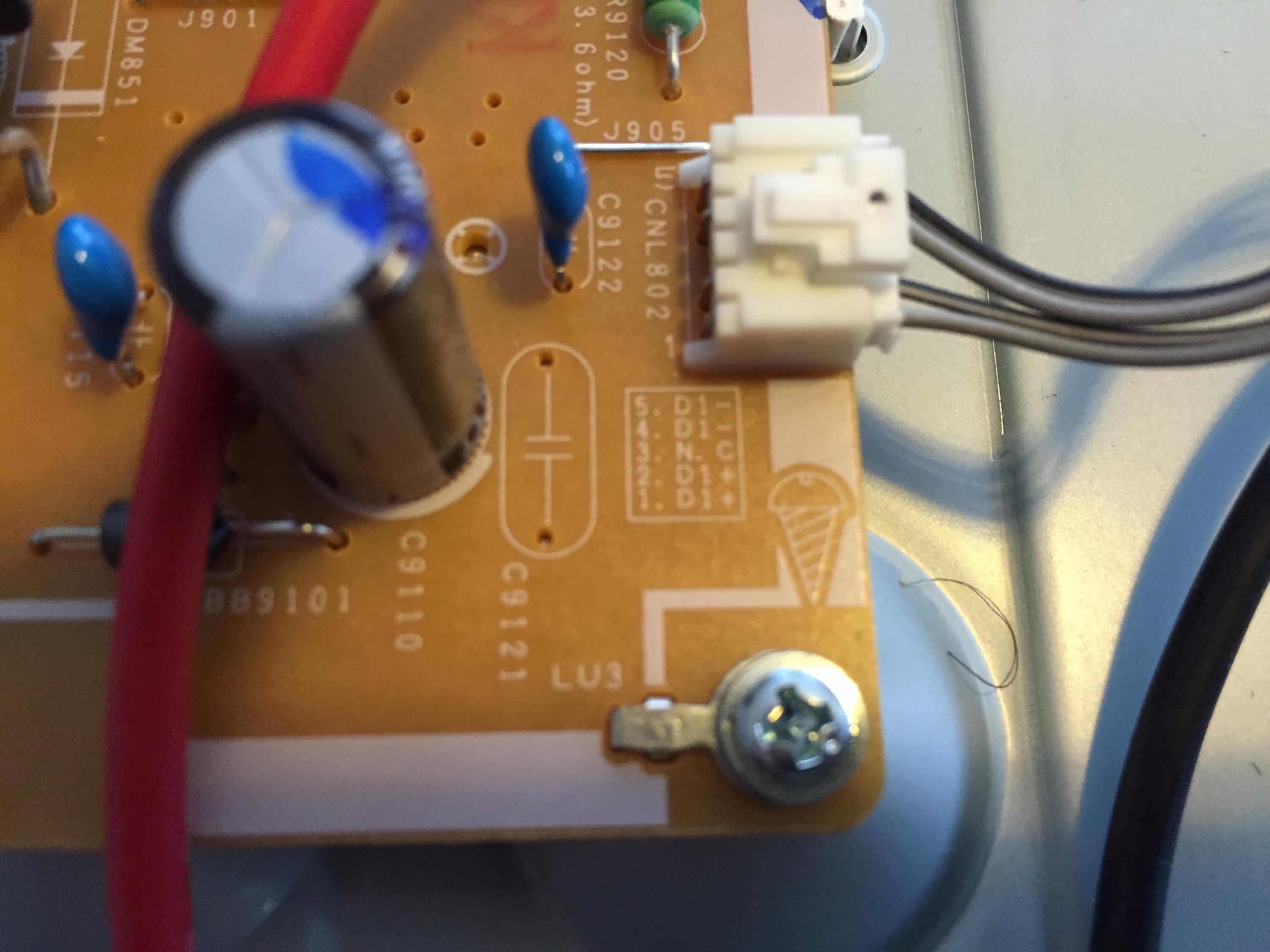

        The LEDS stings looks to be connected in parallel, see bottom side connection.
        Your meter is not going to put out Voltage to forward bias the LEDS to test the whole string.
        What DC Voltage do you get at the LED connector?
        You can put DCA meter in series with the wire to see if it shows any current draw.

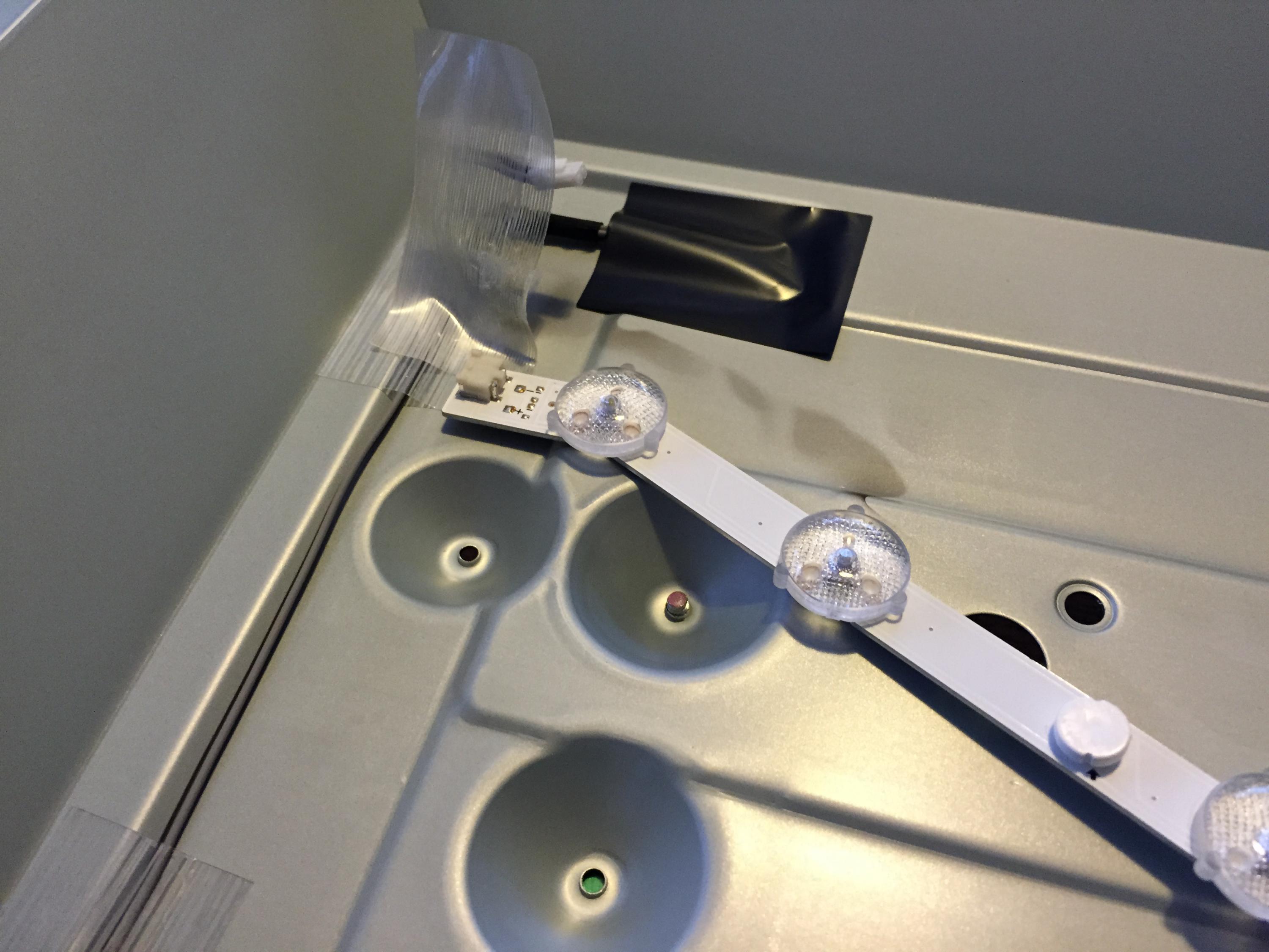

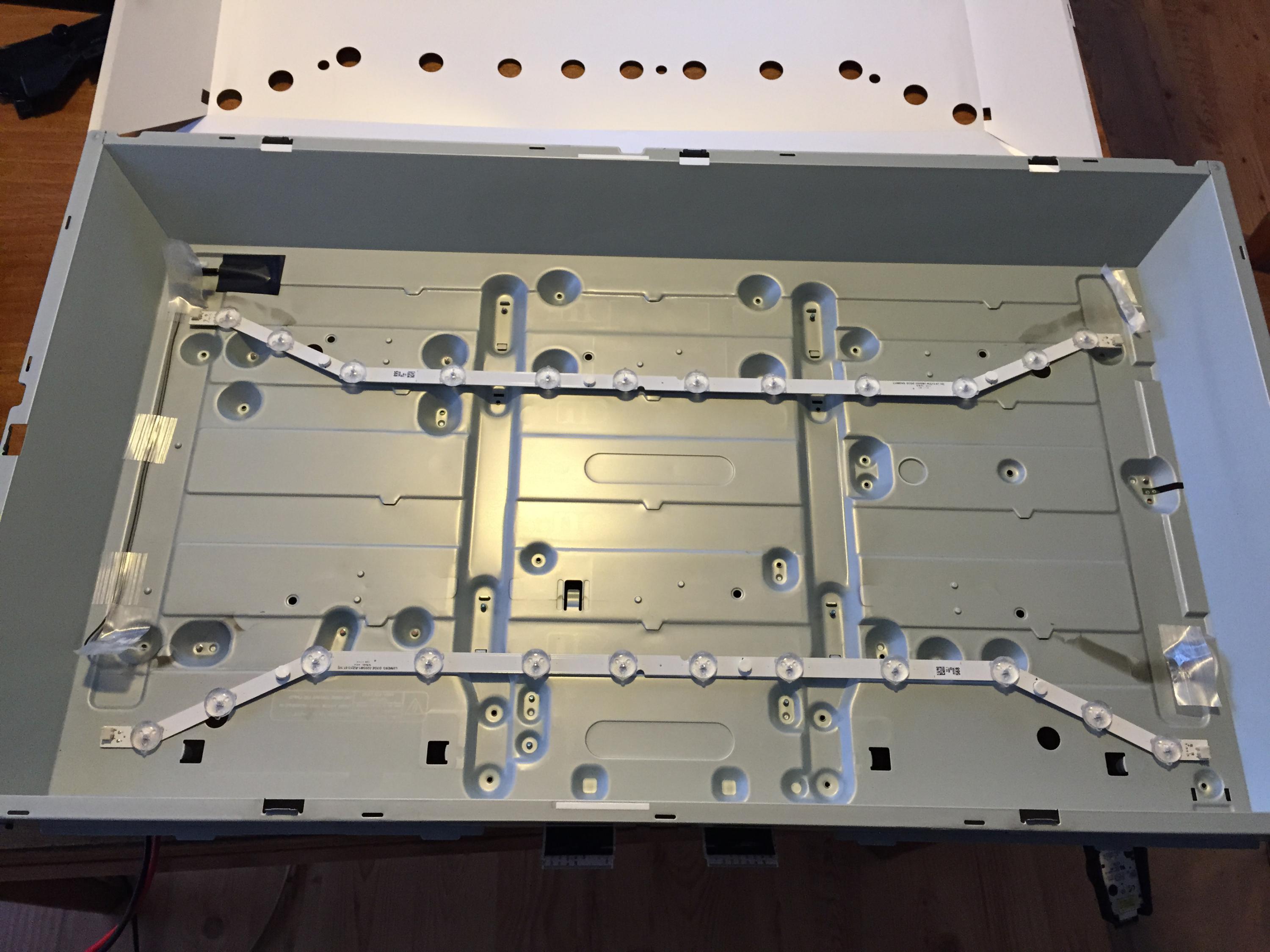

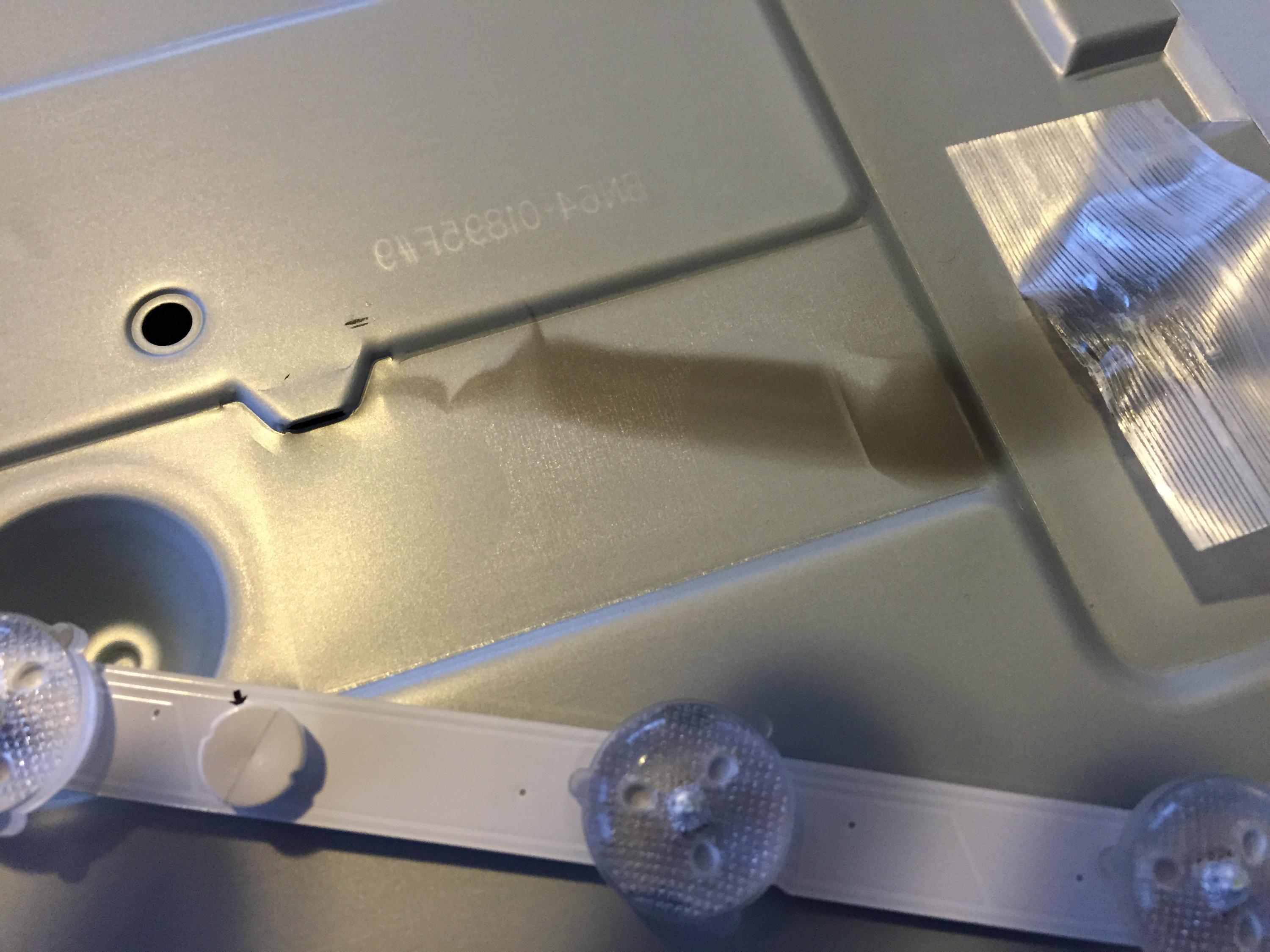

          That makes sense. I got into the panel fairly easily. There is evidence of multiple LEDs being blown. It looks like there is soot at each end of both LED strips but the LEDs themselves don't look burnt like I've become accustomed to seeing. How do I test each LED? Do I need to pry the cover off each one and glue it back on when I've tested it?
            I believe those LENS are snap-on.

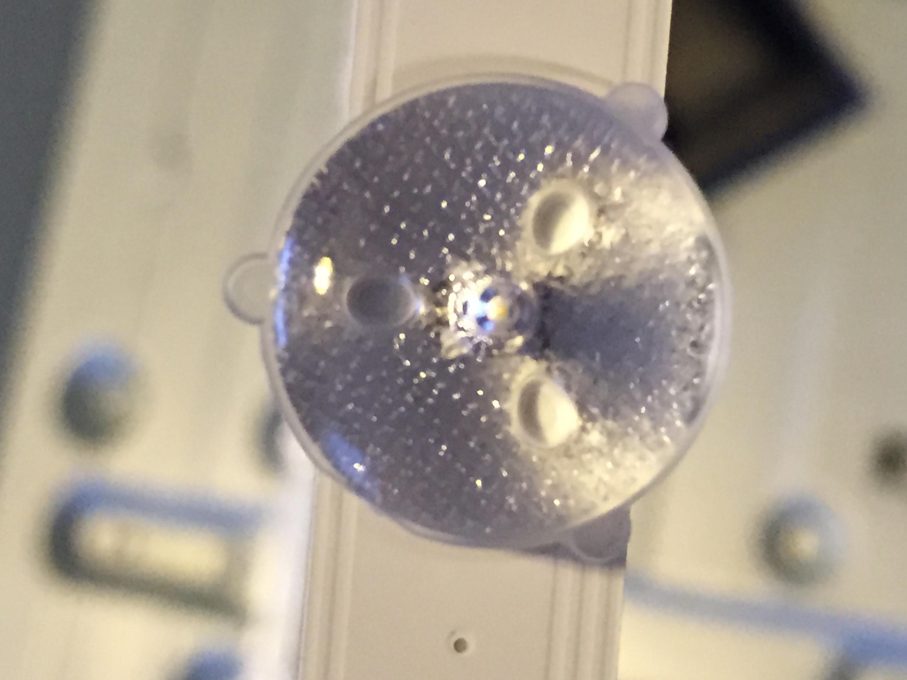

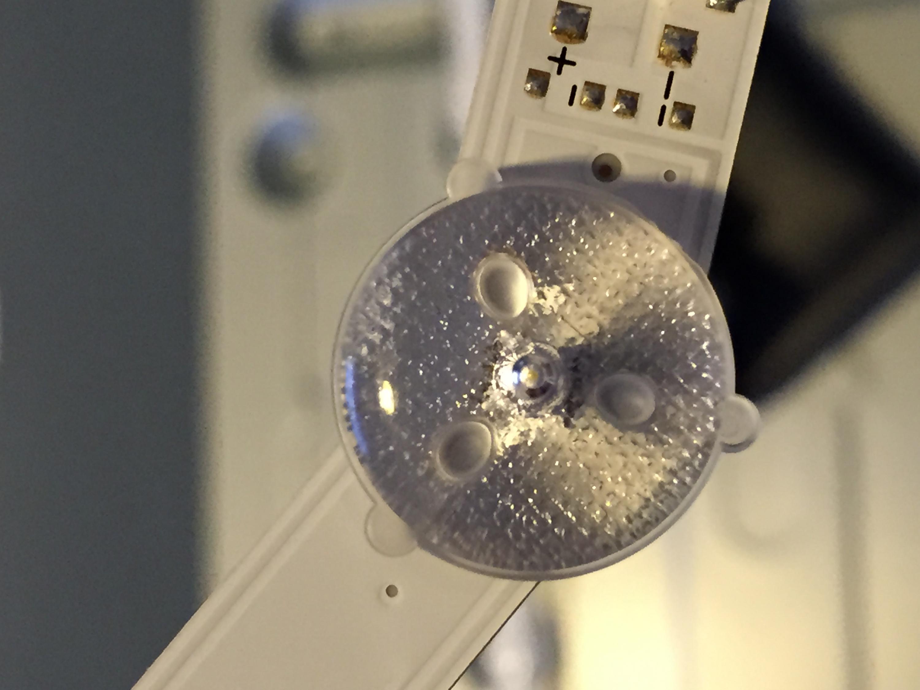

                It looks like these are glued on somehow. I broke the first one off and will have to super glue it back on. At any rate, the first LED shows .741V in diode mode and O/L the other way. I guess this means it is good???
                If there are 12 LEDs on a strip and each strip is being fed ~180V, that means each LED needs 15V to light. Does that seem right?
                  .741V is very low for an LED. When tested on a meter a good LED should glow slightly, if a reading is available.
                  How do multiple LEDs fail simultaneously? Design flaw?

                      It looks like I should be able to slip a sewing needle under each side of the lens to get to the LED mounting pads. This should give me something to probe without breaking each lens off. I have some known good LED strips from a different set here to see if they light when tested. They are 3.3V LEDs for certain though. Six LEDs on a strip, 20V from my bench top power supply will light the strip.

                            180V from the PSU at connector CNL802 / 12 LEDs on a string = 15V each, or am I missing something?

                              3V doesn't light any LEDs. 4V only makes a handful of them barely glow. It's hard to tell they're even glowing.

                                    There's 24 LEDs total. 180V/24 LEDs is still 7.5V each. Maybe thats why the LEDs are blown.

                                      I tested a good, known working LED on a different strip. I can light the strip of six LEDs with 20V at the connector. It shows .741 on my meter as well and does not light up when being tested with the meter.

                                        What is the DC rating of the LED DRIVE boosted Voltage filter cap C9110?
