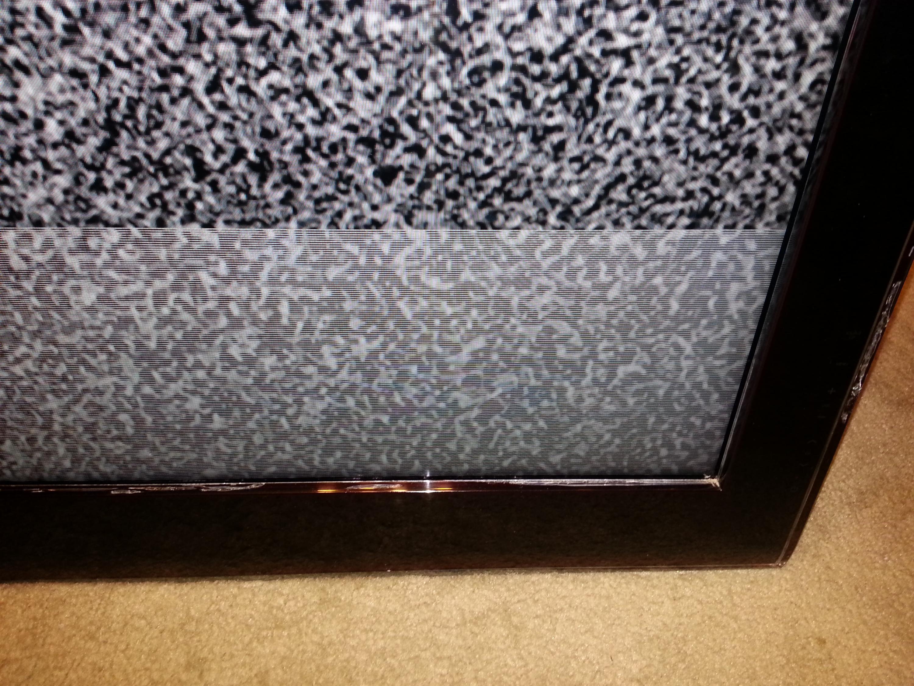

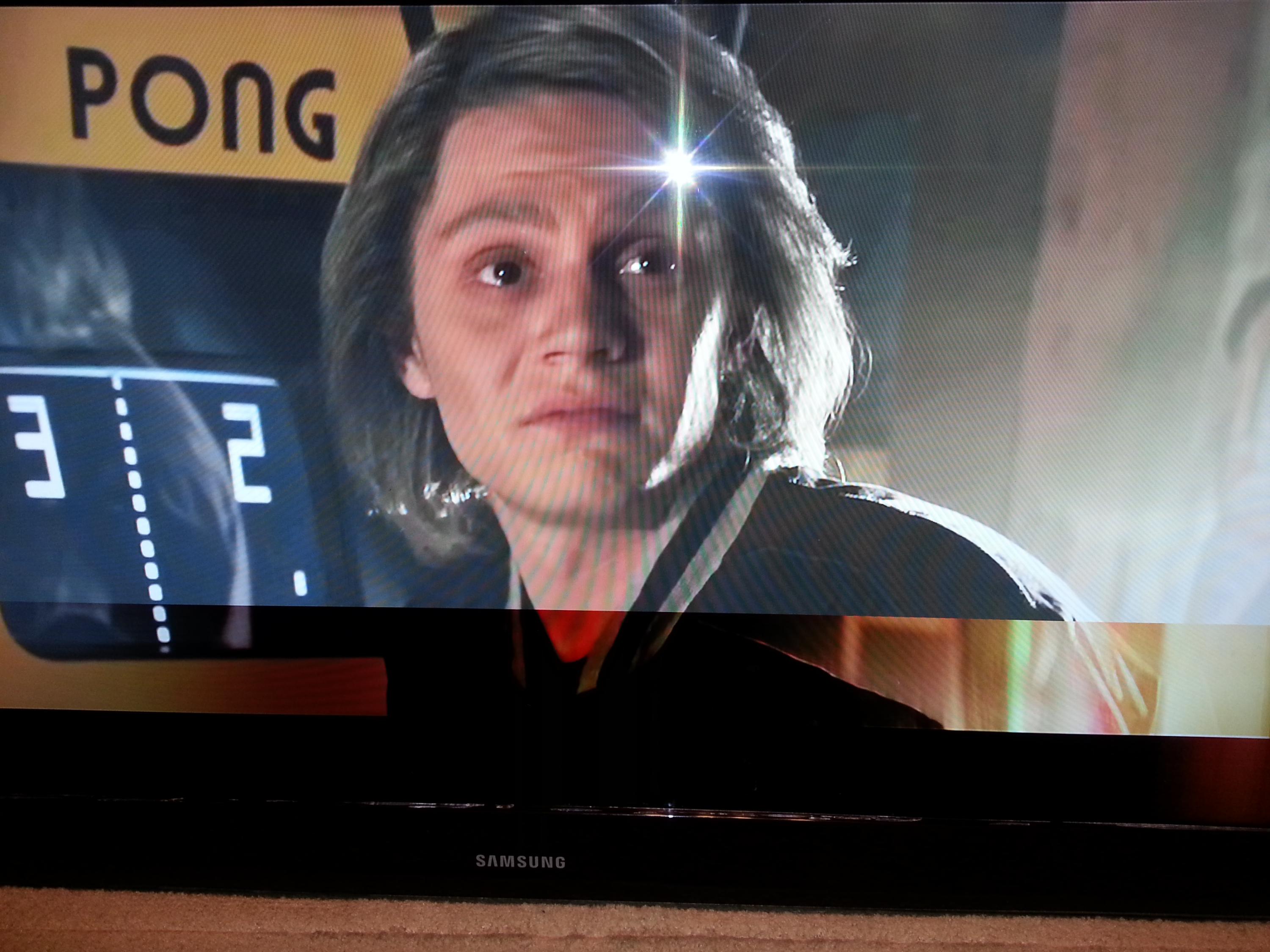

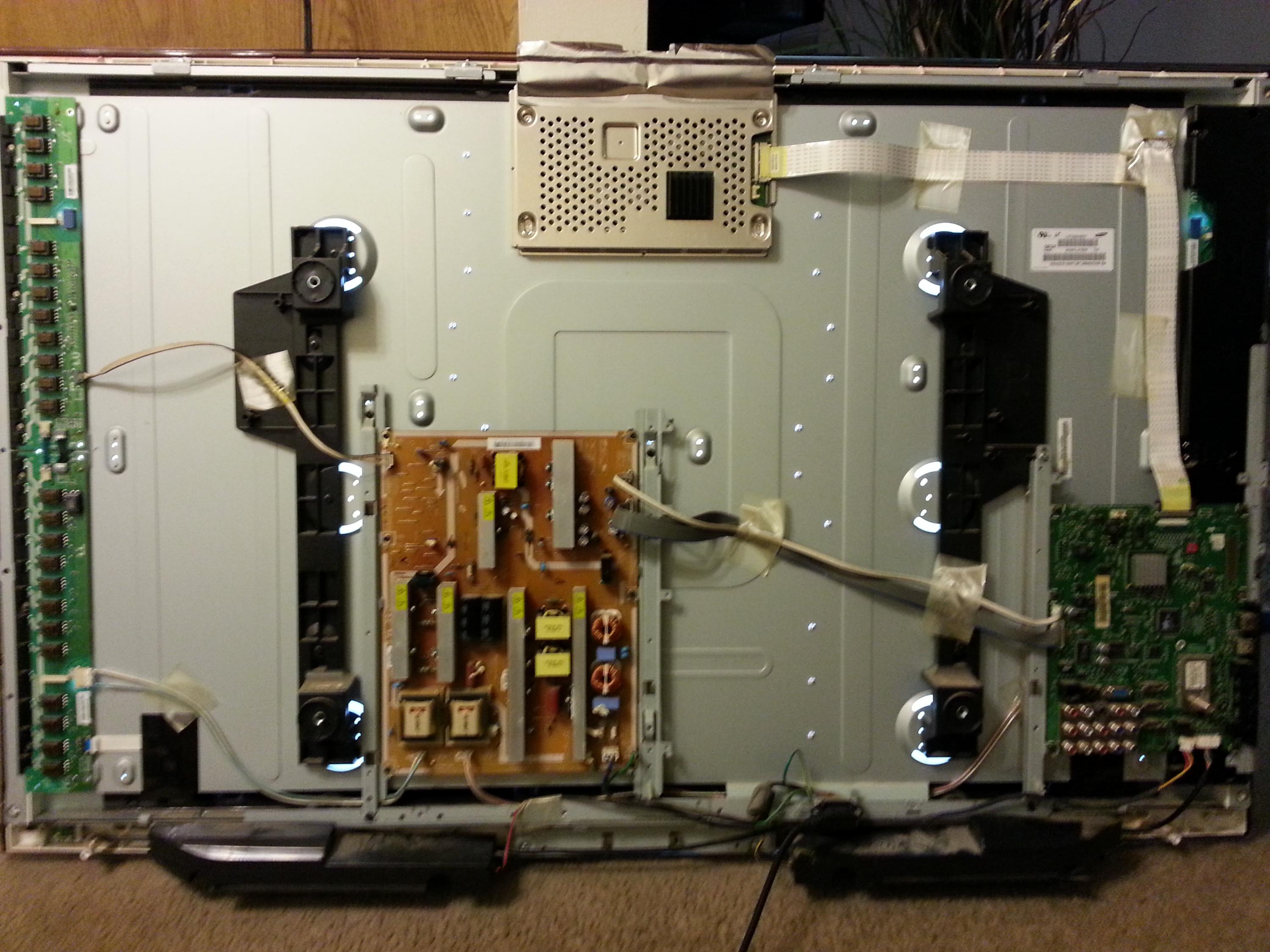

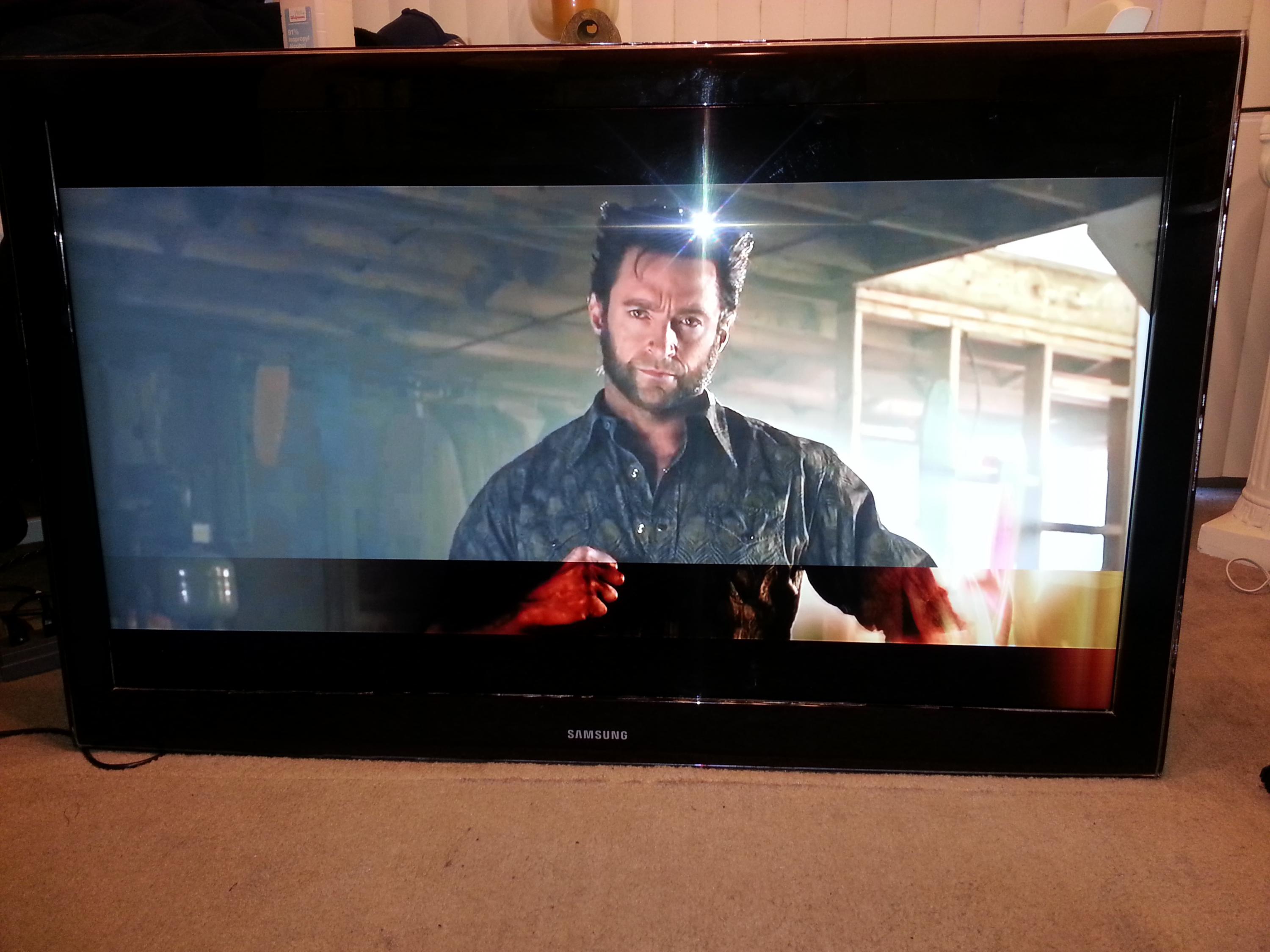

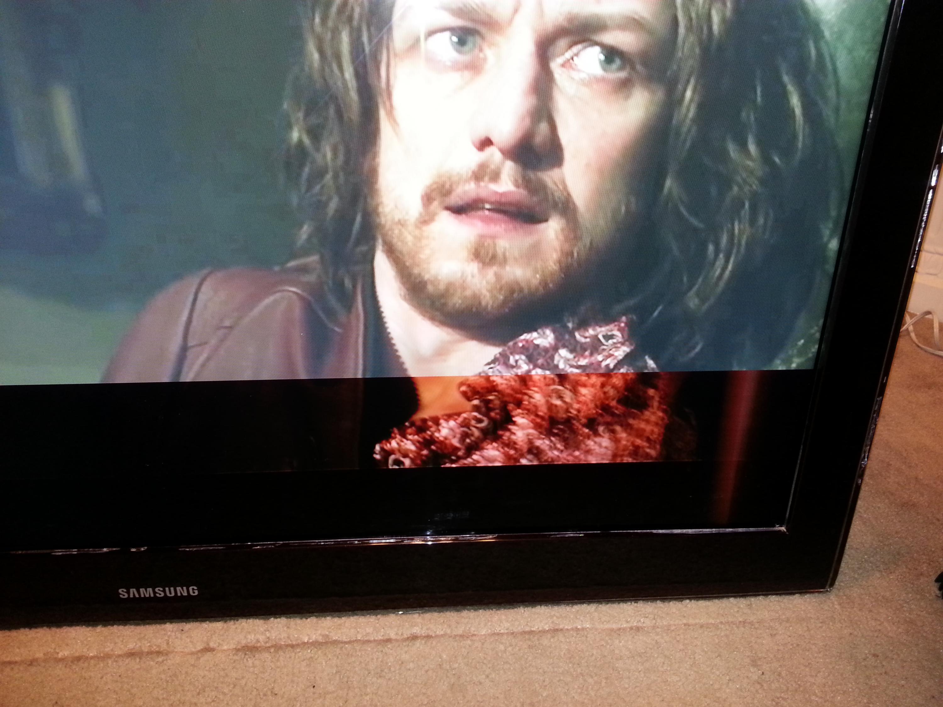

    Hello, I have a Samsung Ln52A650A1F and I'm not sure what could be the issue with this, The picture is only bad at bottom of screen but stretches across the whole screen but seems really bad on lower right side seems blurry red. I have tried resetting all cables from the Tcon still no luck. Any ideas or is this just a non fix TV/panel ?
    Re: Samsung Ln52A650A1Fxza bad picture botton of screen
    Does it change if you try flexing the LCD panel?
      No, but the screen seems to clear up slightly for a moment when 1st turned after being off for a long period of time
        Could be water liquid damage even someone cleaning with cleaning fluid - it runs down and
        corrodes/shorts the wiring at the bottom of the panel.
          Tab bond issue. Just fixed the 46 inch version of this model a couple of weeks ago.
                I would tear it down and confirm tab bonding first. You can even use electrical tape to fix it temporarily.

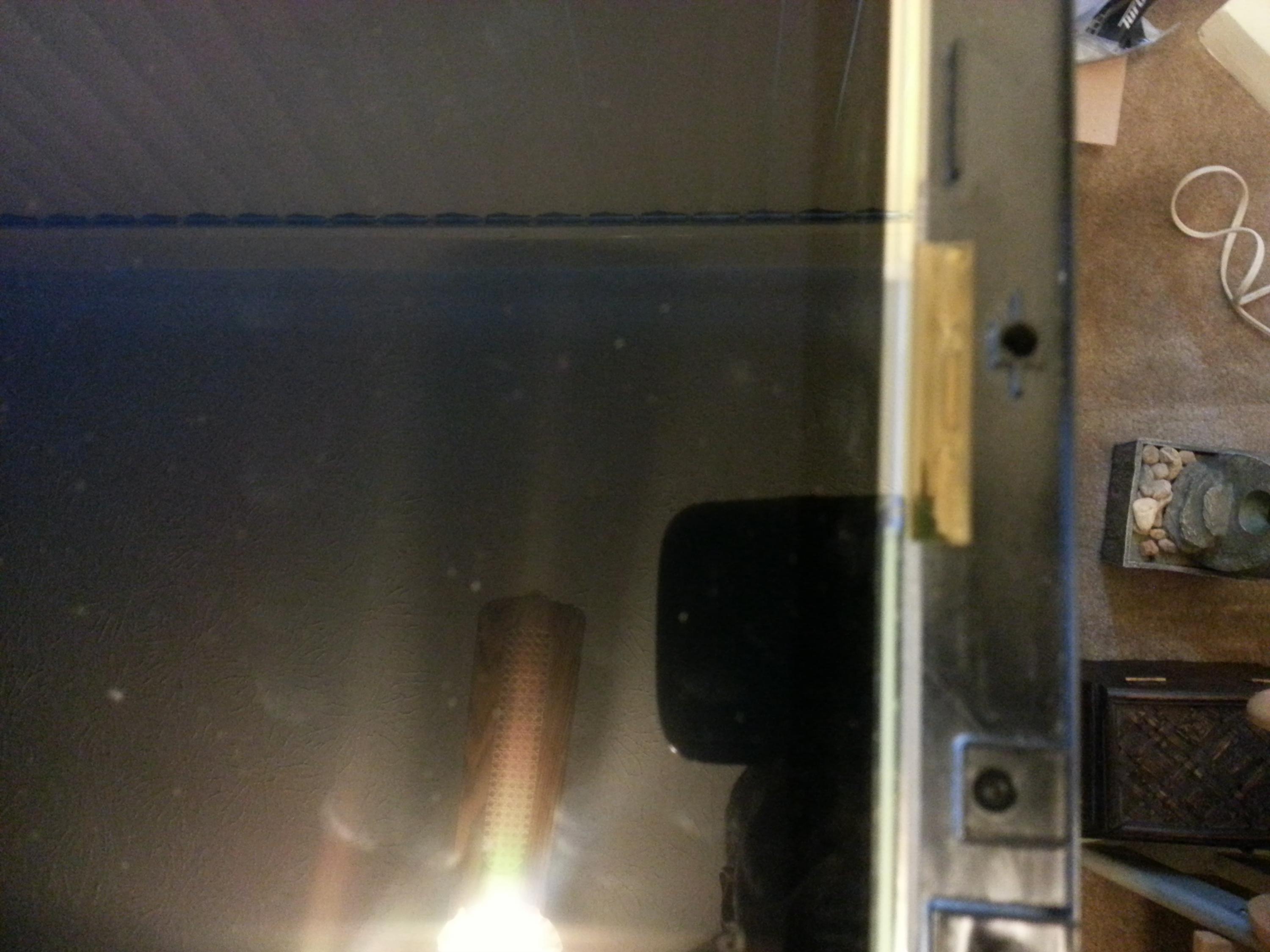

                  No luck on the top tabs, rubbed my finger across them and I didn't notice any change, but when I rubbed my finger across the lower tab or whatever that's called on the bottom right side where the problem is i did see it flicker/change but not enough to correct the problem. so is it safe to safe the TV panel is beyond repair or did I not check the top tabs correctly?
                    That looks just like a tab bonding issue I had on a Sony. It took me some time and a few tries to actually find the problem tab, so don't give up. Sometimes you have to apply pressure to the tab while turning the TV off and back on to fix it, but you should notice some flickering or change when you find the problem tab.
                        I agree with AFajitas. Sometimes you have to turn power off and then on to see if the problem is corrected. Don't rub the tab. Apply pressure carefully. Find the magic spot. I have fixed sets with 4 horizontal bands on the screen doing it this way. If the timing signals get messed up, you have to cycle power to the set. I have had better success with hard vinyl bumpers, about 1/8 inch thick and then use the screws on the screen frame to apply pressure for that tab. Stick them to the frame, not the tab or the screen.
                        I usually leave the set on the base and tilt it backwards by placing a 2 x 4 piece of wood under the front of the base so the screen does not slide onto the floor. This makes it easier than laying the set flat on its back. Fastest time to find the magic spot was under 10 seconds. The longest was several days. And some just don't want to be fixed.
