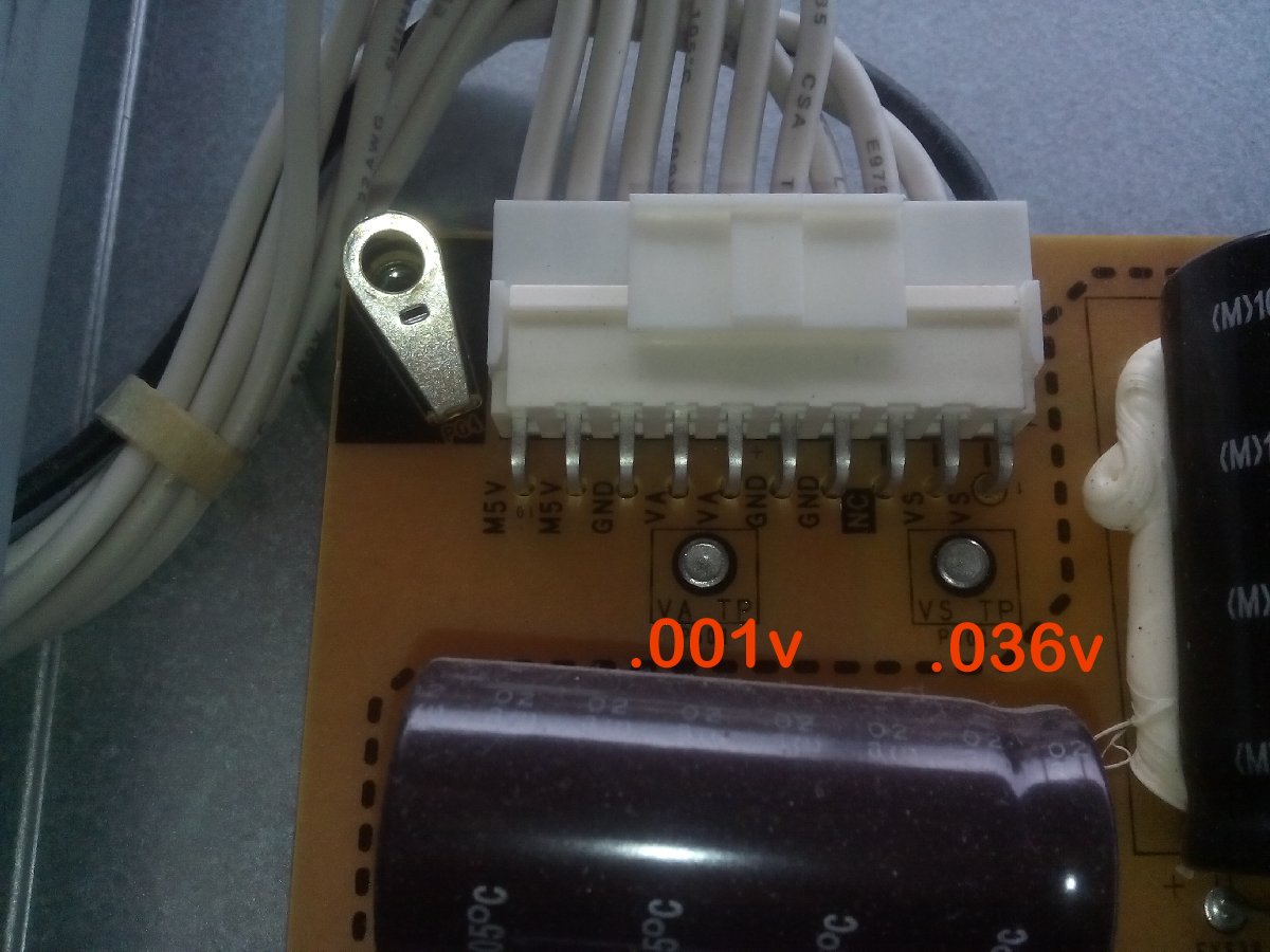

          Re: LG Plasma 50PK540 Lightning Victim LED Light Relay Clicks On Plug In Nothing Else
          AC-DETECT test shows 4.46v at plugin and holds steady...
            #65
            Check the VA and VS points with the NEG clipped to the screw that was screwed into the base...
            VS showed .036v
            VA showed .001v

                #67
                VS showed .036v
                VA showed .001v
                Yes sad isnt it It is never going to light a bulb - we are going to need a schematic ( I half looked the other day then gave up) or a picture of the back of the board - will need to be the best picture you have posted. If you cant get it really clear so we can see the traces dont bother posting it.

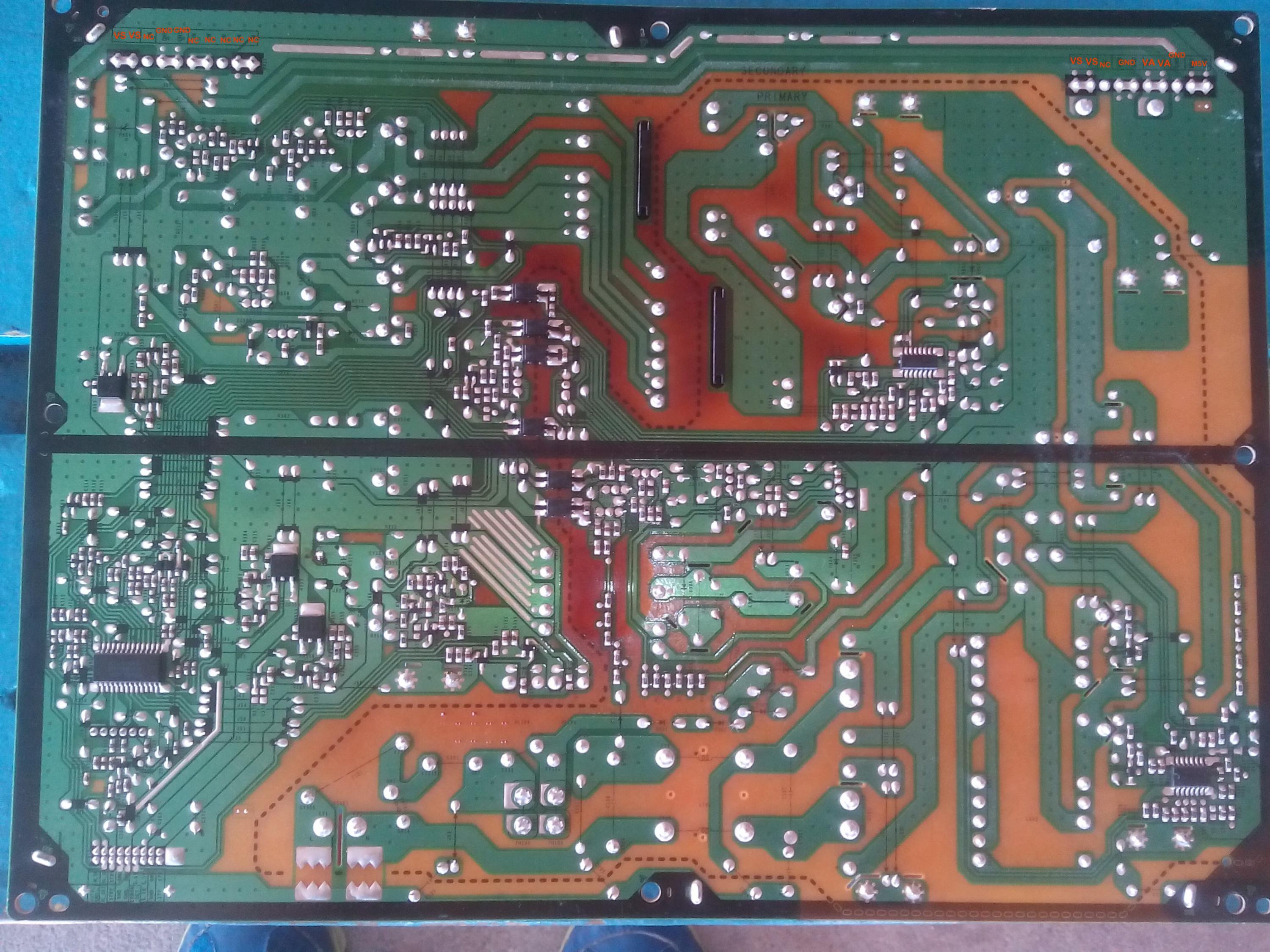

                  #68
                  K Lemme get on that right now.. Do you need the whole board or a specific section??
                  I'll also check the other pins of the AC-DETECT connector..

                            #73

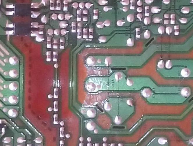

                                        #79
                                        Originally posted by CapLeaker View Post
                                        Look at at the stuff they change out and check yours.
                                        We have done that using another kit???
                                        Michale cant make much of the traces but it does confirm there is nothing else
                                        on the VS VA sockets .
                                        Can you look on the back of the board - this section. Maybe the flash but
                                        one side of that transformer doesnt look good?

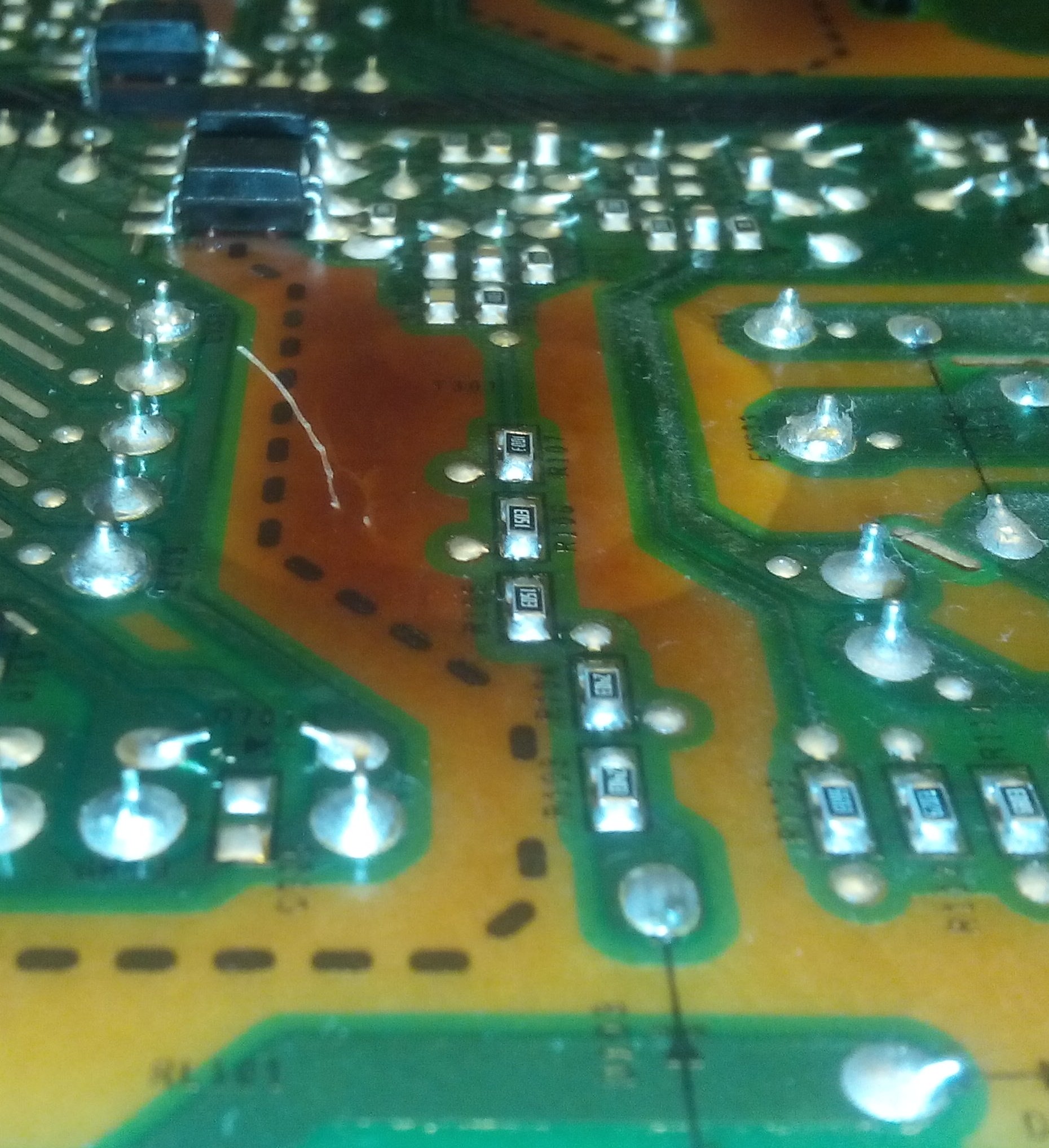

                                          #80
                                          Looks like a bubble...
