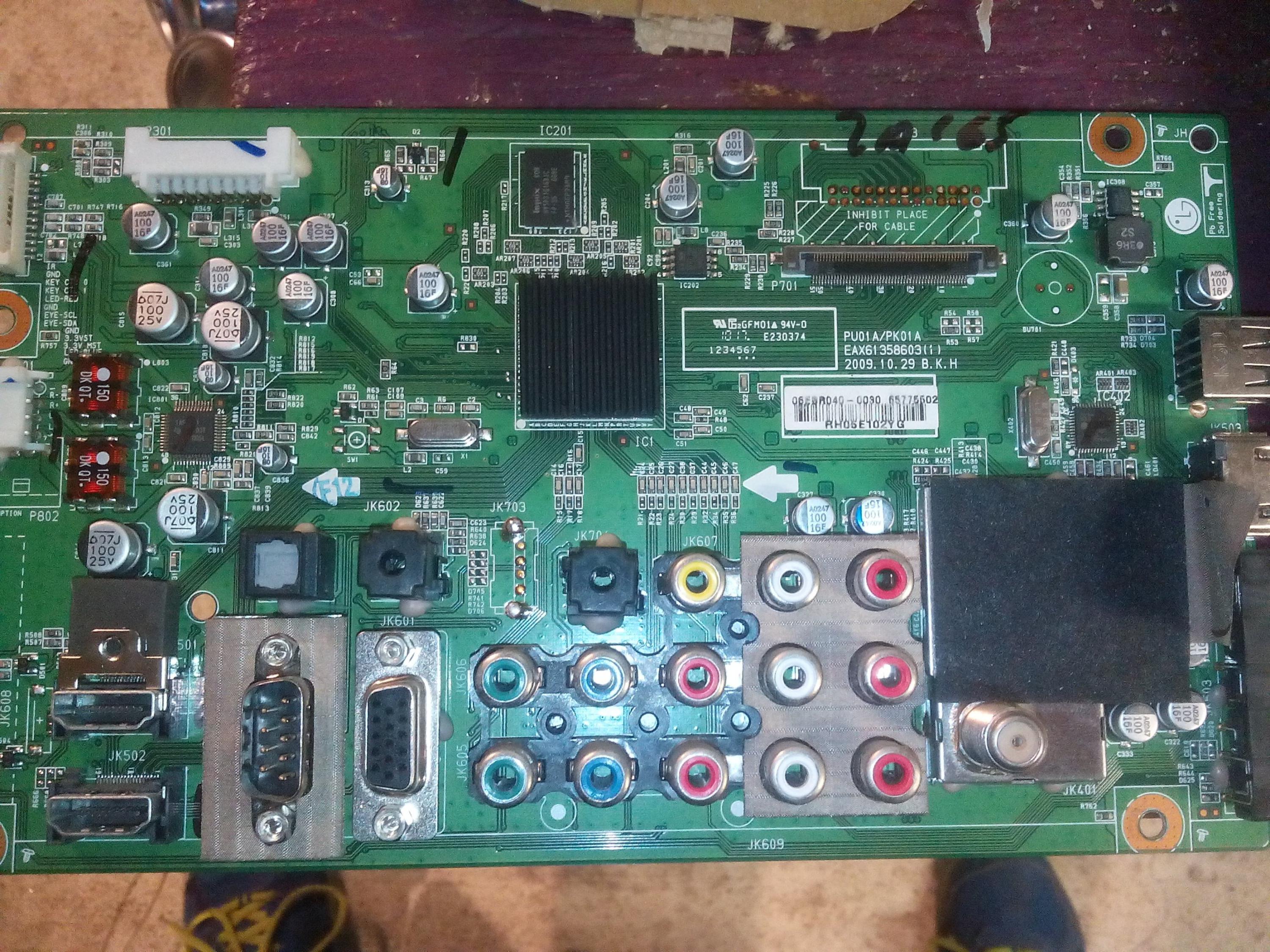

        #103
        Re: LG Plasma 50PK540 Lightning Victim LED Light Relay Clicks On Plug In Nothing Else
        I have been looking at pictures of the board but cant see it -At first I thought it was the main processor but that is IC1 Maybe it is on the back If its the one I think it may be a small 6 leg job smd so may be not to bad to replace and not too expensive (if its the one I think) I will go and see if I can fix anything simple round the house till you get to have look.

            #105
            If I am lucky, I have a replacement board at the shop.. I have a ton of boards my daughter and her friend recently helped me organize, so I might be able to lay my hands on it quickly..
            The boards pictured are just the SMPS boards and buffer boards. I have even more Main/Video boards to the left of that picture..

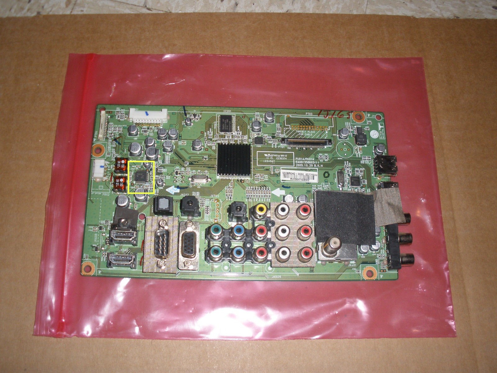

              #106
              By process of elimination, I think IC701 is the one marked in yellow. But, according to the manual I got from RetCap, that may be the audio processor.. The only other similar IC is marked IC402...
              Which MIGHT be the culprit, as the Part # designations are from the afore mentioned manual which is for the 50PK750... So, the designations might be different.
              I'll know more once I get to the shop and get my hands on the board..

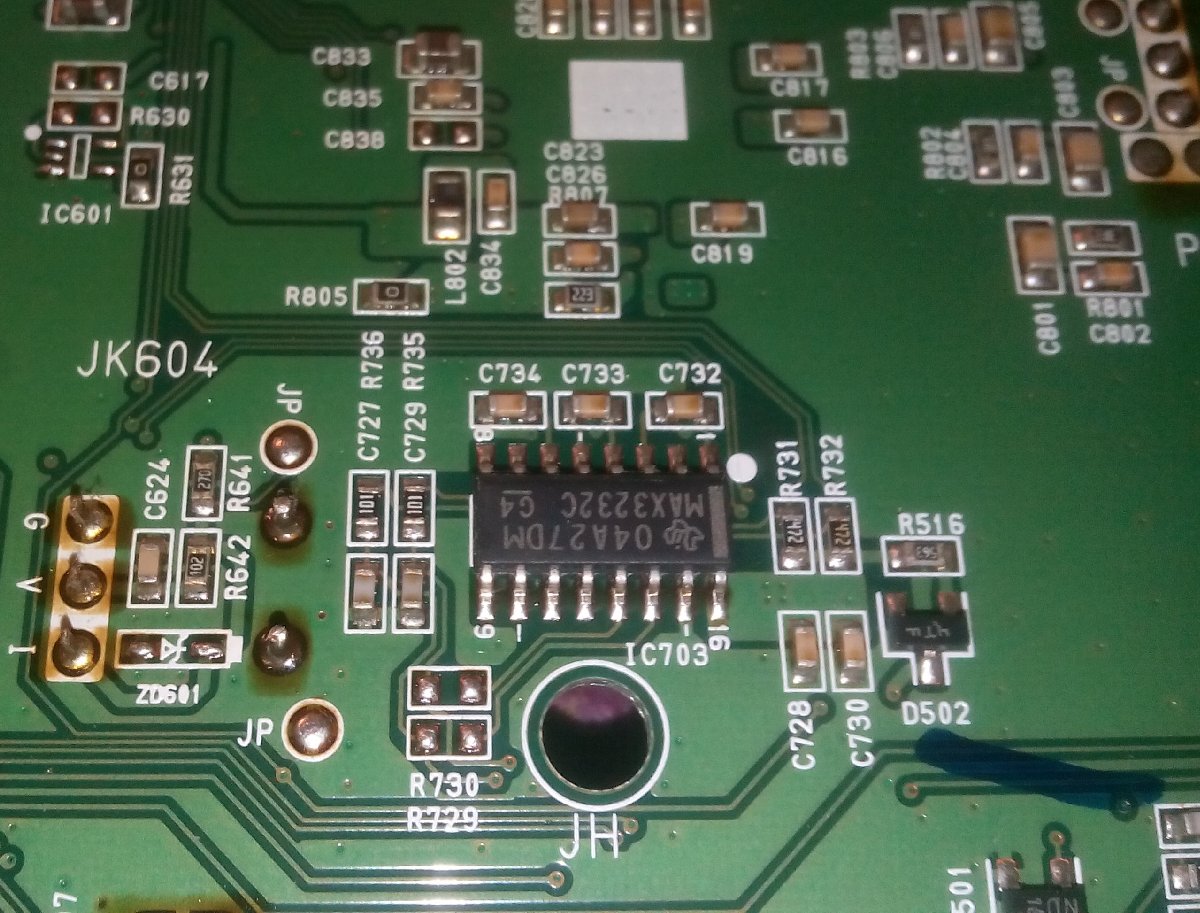

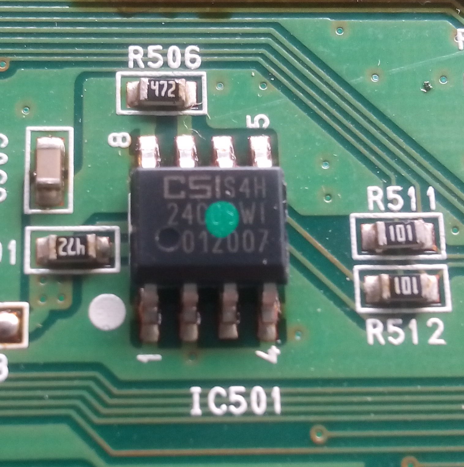

                      #110
                      Top left hand corner back of the main board ?
                      Nope.... I can't get a decent pic, but there are no ICs there at all..
                      There is an IC501 that's a possibility..

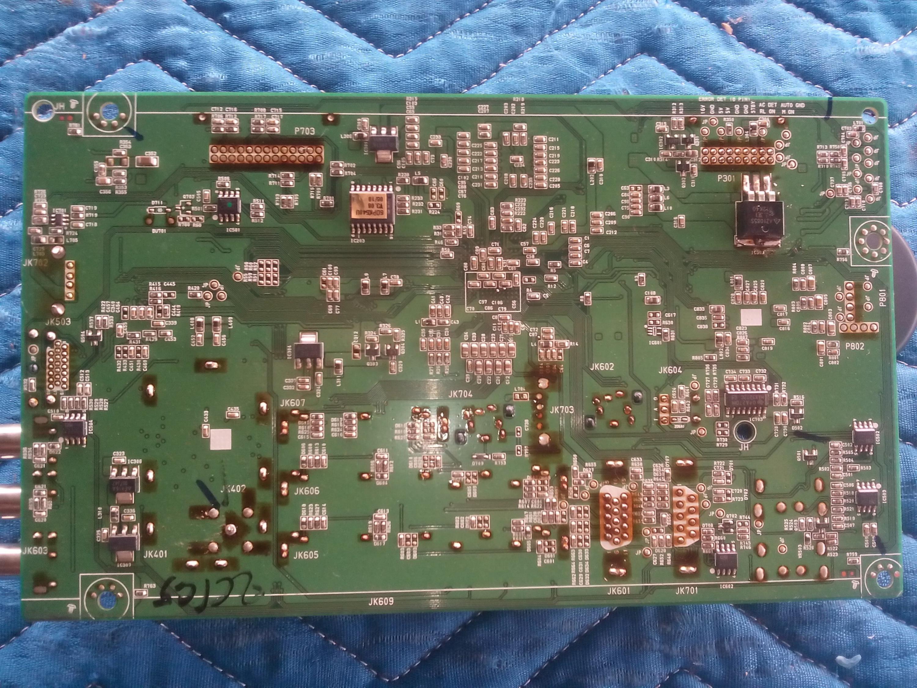

                            #113
                            Originally posted by Michale32086
                            Looks like it.. But it's behind a paywall.. I can get it tomorrow..
