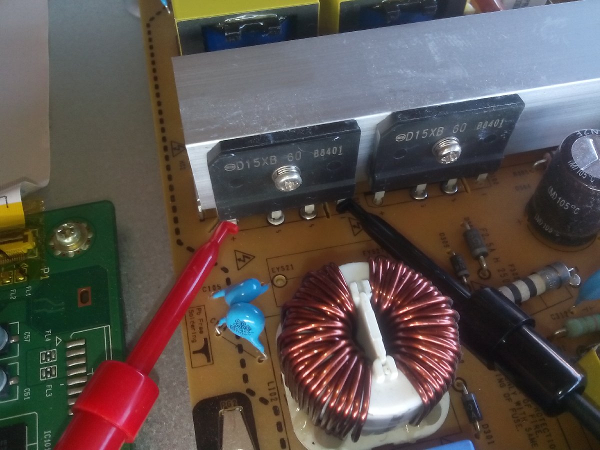

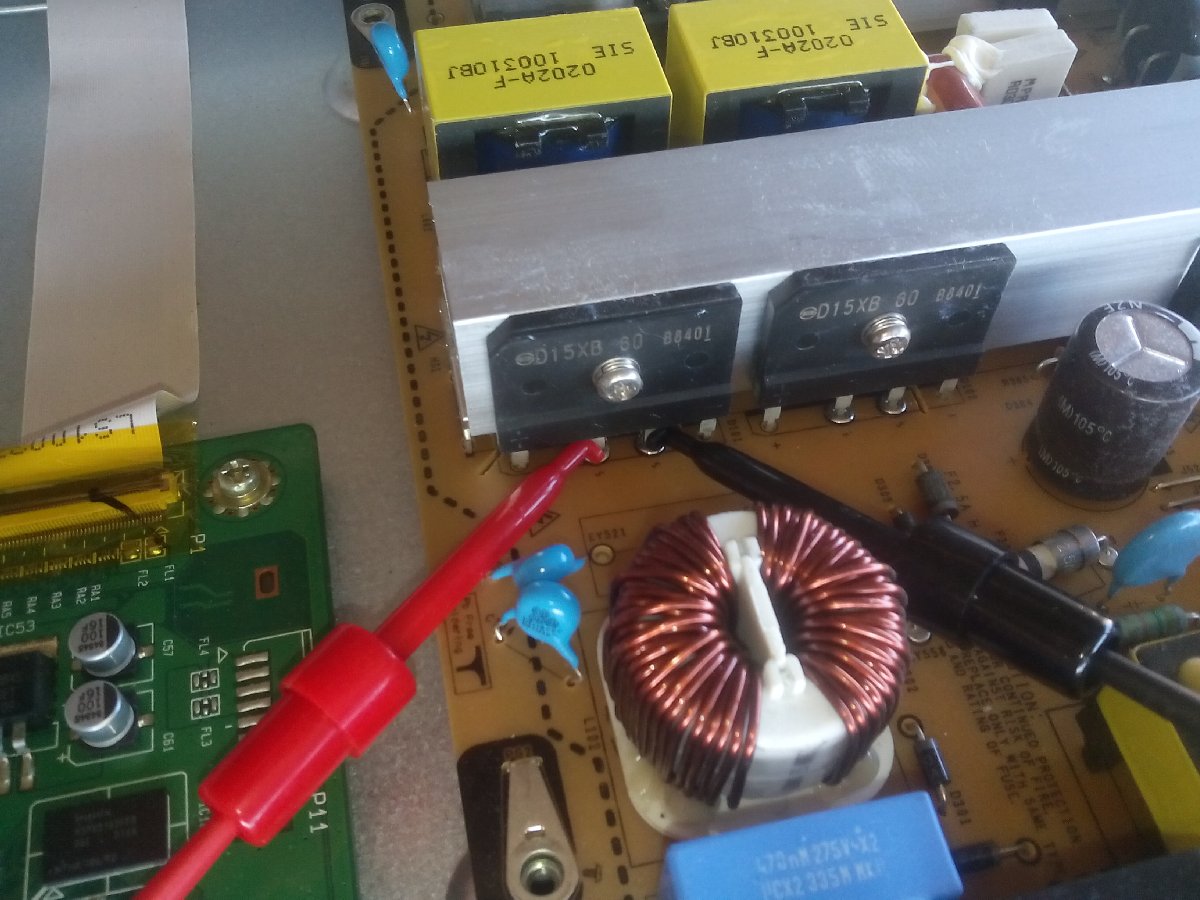

    Re: LG Plasma 50PK540 Lightning Victim LED Light Relay Clicks On Plug In Nothing Else
    Green 10 ohm +/- .2
    Red .1 ohm +/-.2
    • vinceroger69
      • Mar 2012
      • 6714
      • uk
      They all look ok then.

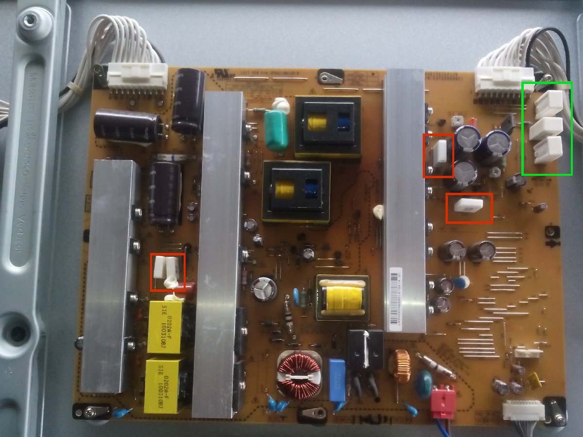

              http://www.ebay.ca/itm/LG-Power-Repa...item1e7a9db08a
              i wonder if this kit will sort it?
              kit contained 1 fuse (F302), 1 diode (D304) , two power resistors (R927, R929) and the IC301 voltage regulator IC.(found on another post)

                      The right Bridge Rectifier is pretty much the same as the left...

                                  Next locate where the parts are in Vinces repair pack - you have tested the two white
                                  resistors are those the two resistors in the pack you also tested the fuse the fuse -
                                  so can you find and test the diode.
                                  Can you read the part number on the IC301
                                  EDITLast para edited
                                  Last edited by selldoor; 01-20-2015, 03:46 PM. Reason: Must learn not to type in gibberish

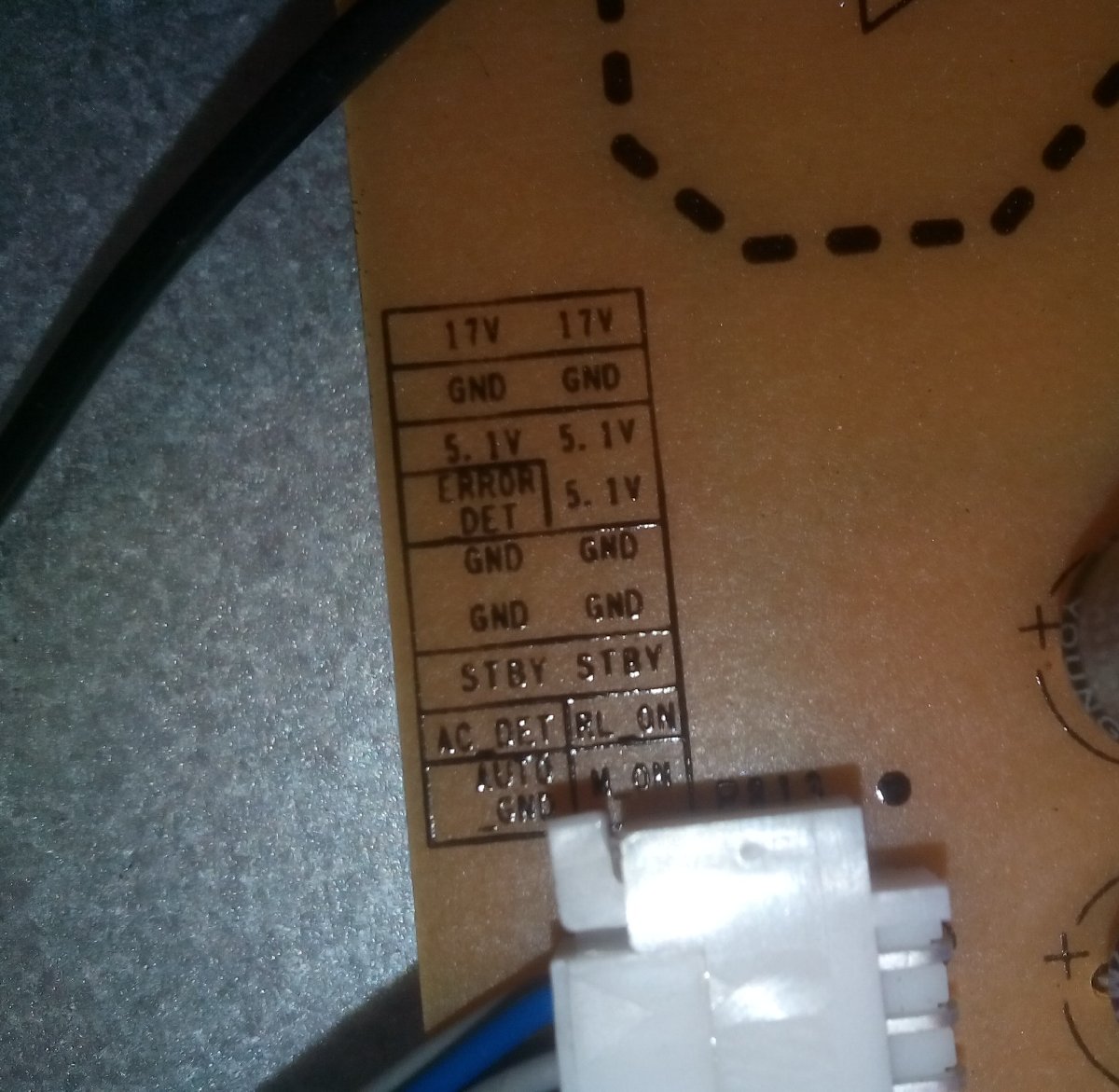

                                    What if I were to pull the connector from the mainboard and short the ON pin to ground to see if the unit is actually being turned on??
