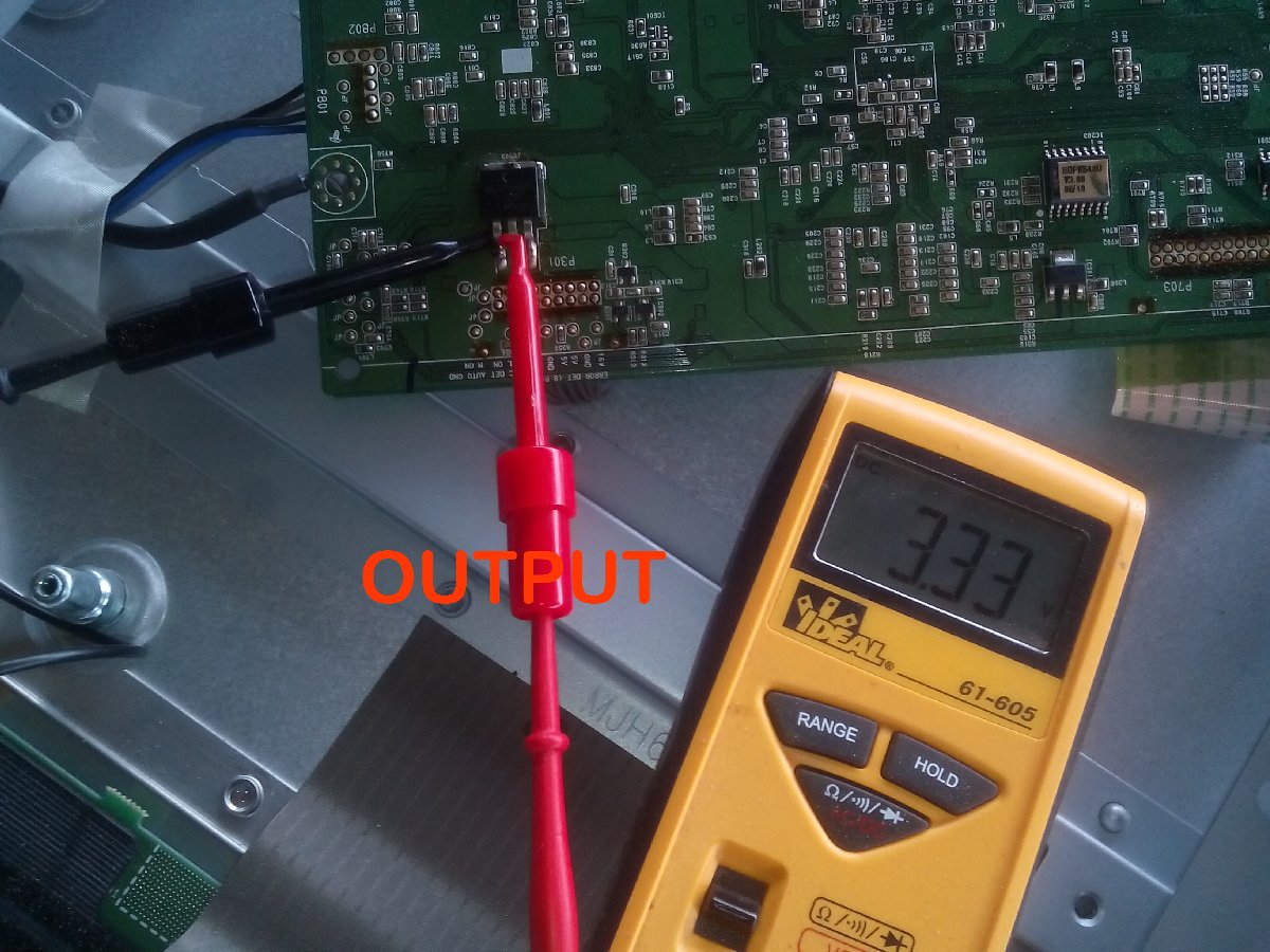

    OK... According to this datasheet...
    http://pdf1.alldatasheet.com/datashe...85S-3.3TR.html
    ... it's, from left to right..
    ADJ/GND OUTPUT INPUT
    Hopefully, I didn't frak it up by measuring it the other way..
    Anyways, it appears to check out..

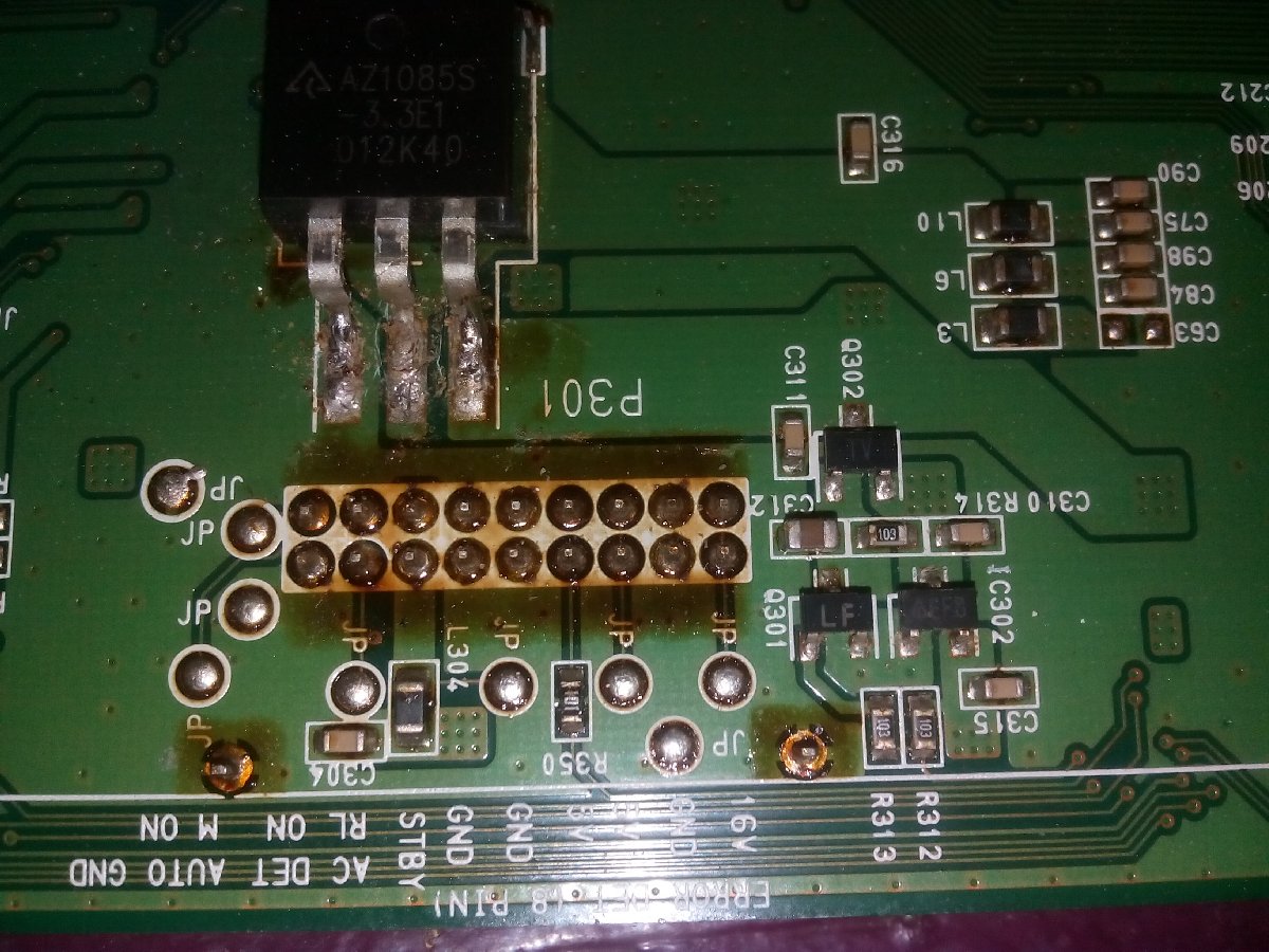

      I do notice solder balls between the traces - try brushing them off with a
      fine wire brush or similar.

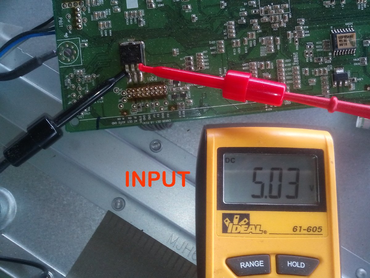

        Re: LG Plasma 50PK540 Lightning Victim LED Light Relay Clicks On Plug In Nothing Else
        Originally posted by Michale32086
        Hmmmmmm Based on the new links you gave me, it's possible that the connections are not INPUT GND OUTPUT but rather GND INPUT OUTPUT
        Here are the pics assuming the former..
        No thats not right either AND you are doing the test wrong
        How to test a voltage regulator
        Testing a voltage regulator requires a digital multimeter. The test is simple and easy to perform. Note: Voltage regulators are typically "low" voltage. Most are 5V DC or less so there is little danger of you getting shocked, but as always, exercise caution when measuring power.
        To test a voltage regulator (circled in red),
        1) Set your multimeter (if manual range) to 20V DC or DCV for autoranging.
        2) Put your black probe on a ground screw (circled in black). Leave it there the entire time. This is your ground.
        3) Put your red probe on each of the pins including any "cut" or "stub" pin, but ignore the "fat" tab. The fat tab is "up" or "north". Number the pins left to right.
        4) Report them like below along with the part number (include all lines on the IC) of the IC. Don't report "they all tested good". About once every 2 weeks, we get someone who reports that only to find out they did the arithmetic wrong or mis-interpreted the results. So report all the readings.
        U100 -> pcb designation
        AS1117-33 -> line 1 of the IC
        0506 -> line 2 of the IC
        pin 1 = 0.000
        pin 2 = 3.301
        pin 3 = 5.001
              Q301 and Q302 have no shorts.. IC302 has no shorts..
              I am going to check all the R3xx resistors, but there is a buttload of them...

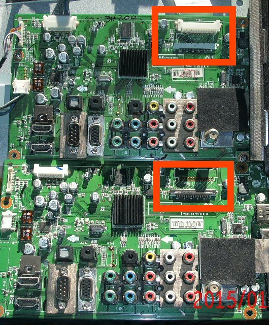

                        Got the replacement board in..
                        As the saying goes, there is good news and bad news...
                        The GOOD news, it appears to fix the problem. The TV now comes on. I hear the static sound of an unconnected analog channel..
                        The BAD news is, I did not heed Selldoor's advice as well as I should have... The boards are NOT 100% identical..
                        The lower board is the old one. It has the tab style connector that goes to the Video...
                        The upper board is the new one. It has the plug in connector.
                        But it does show that the Main Board was the issue.
                        Unless anyone knows of some kind of adapter, I have an AOYUE 968. I am going to use that to pull the proper connector off the old board and place it on the new board..
                        Needless to say, it's going to be delicate...

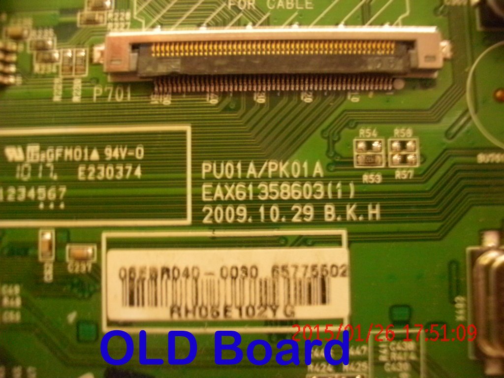

                          #152
                          That may not be the end of the problem- is the board for the same panel make and size ??
                          eeprom and drivers are a bit choosy!

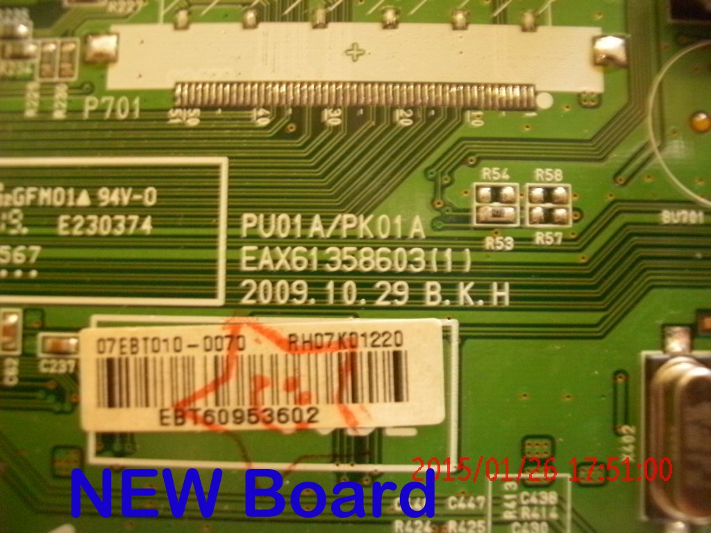

                              #154
                              Nooooooo! I also mentioned bar code label - your new board is off a 42 inch set

                                    #157
                                    Well, a happy ending on this...
                                    The new board came in. Installed it in the unit.. The power button seemed to work, but when I turned it on, nothing on the screen..
                                    Sum beach!!!
                                    Checked the ribbon cable going from the main board to the Control Board.. Some of the teeth were not aligned properly...
                                    Straightened them out, plugged it back in and viola'
                                    Thank to all who contributed... VERY much appreciated..
