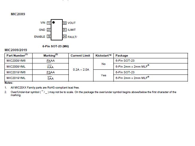

      Hmm well we think we know where the matches are
      Has it got a number on it FK1 or FK2 (how appropriate) or something else then I can
      see what the pins are. There may of course be nothing wrong with it but we can see if
      at least there is voltage into it.
      Got it FSAA

          Re: LG Plasma 50PK540 Lightning Victim LED Light Relay Clicks On Plug In Nothing Else
          Originally posted by selldoor
          This site https://www.buyphilipsparts.com/mode...40?language=FR
          lists all the parts ic701 page6
          from that lg part no is EAN60223701
          This site
          https://www.buyphilipsparts.com/item...,analog_Switch suggests it is not in the 750
          This site
          http://www.electronicmarket.com.au/i...0-p-81393.html
          suggests EAN60223701 is one of these
          IC,Analog Switch (IC900)
          [EAN60223701]
          MIC2019YM6 2.5 to 5.5V 1MSEC 700USEC 0W SOT23-6 R/TP 6P 1 MICREL SEMICONDUCTOR INC.
          which is one of these
          http://www.digikey.com/product-detai...5-1-ND/1821755
          Datasheet here
          Of course it may be all a trick.
          SD, is that part you found the DIGIKEY part??
          If so, I can just order a new one as they are only a buck..
            Yes, but perhaps a few tests? I was starting to extract the info from the datasheet but it takes too long the attached shows the pin out and the marking.
            here is a better link - direct to the datasheet
            Still not real easy to follow - only the sections re 2019 and SOT form apply
            I cant see how it all connects double sided board - perhaps that new schematic will help ( I have not looked at the 750 one may try later) Also that last picture was good!!! can you do a similar one showing 4 inches round the IC and the same from the top side of the board.
            PIN 1 is where the DOT is

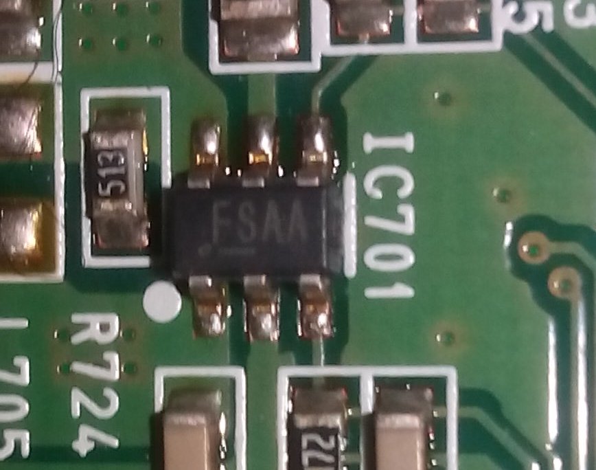

                Here is the full pic of the FSAA chip...
                And the top part of that area...
                The chip is approx tween the 100 cap and the USB port.

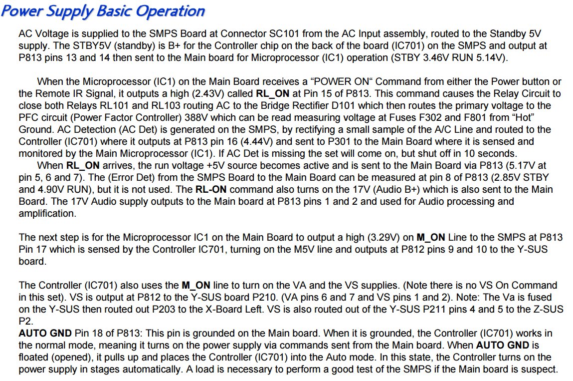

                  So close.
                  It took me over an hour to research and write this...
                  As I mentioned in post #92, I used the term microprocessor and wrote "It may not be exactly the same as the 50PK540, but it should provide valuable clues." Well, I didn't think I would be so correct after reading the progress.
                  Now that we have clear focused pictures of the main board (which should have been part of post#1 regardless what the problem is), it is obvious the 50PK750 and 50PK540 are not the same main board despite both have the 50PK prefix.
                  So, the next obvious candidate for the microcontroller on the 50PK540 is IC1 as selldoor initially guessed. If you stayed on this path and followed the philips part website, you would have found that IC1 is used in multiple LG plasmas including the LG50PJ series. PJ could be the precessor to the PK series?
                  Searching for "LG 50PJ training manual" leads to a training manual that more closely resembles the 50PK540 main board.
                  Looking at this new service manual, M_ON is still generated by IC1 on the main board and needs to be 3.29V. Once M_ON is received by the SMPS, IC 701 on the SMPS (back side) turns on VA and VS.
                  So the PK540 and PK750 do operate similarly, but the location of IC701 has been relocated between the two models for whatever reason.
                  So let's examine why IC1 is presumably not outputting M_ON at 3.29V.
                  As an fun exercise for Michale32086, stop reading right now. Go away in quiet area for 15 minutes and try to think why M_ON is zero. Then go read the next post.
                    1) If M_ON is 0V from IC1, then there isn't much you can do because there is no part number and this is pretty much a complete board swap. BEFORE ordering a replacement, read #4.
                    2) If M_ON is 0V as measured on the SMPS, there is a small chance that there is a break in the cable from the main board to the power board. If M_ON is 3.29V on the main board connector, then you found the problem.
                    3) If M_ON is 0V measured on the main board connector, there is a chance that IC1 is outputting 3.29V, but the circuit path and/or the components between IC1 and the M_ON pin on the main board is bad.
                    You will note that the main board to SMPS connector is labeled P301. This implies that any components in the 300-399 is likely to be part of the same functionality.
                    For example, IC303 is a 3.3V voltage regulator. Hmm, M_ON is supposed to 3.29 and the regulator is supposed to output 3.3V.
                    If it is shorted to ground and in the circuit path as described above, then you will see 0V at the M_ON main board connector. I recall someone writing a well written easy to understand "How to test a voltage regulator" FAQ here.
                    IC302 is also a 3.3V regulator. Q301 and Q302 could also be used somehow in this circuit.
                    It only takes a couple of minutes to see if IC302, IC303, Q301 and Q302 are shorted or not.
                    Resistors in the R3xx range should also be tested to see if they are open circuit as vinceroger69 alluded to in post #123. L3xx are inductors and should measure as a short circuit (less than 1 ohm). Of course, C3xx are capacitors and could be bad as well.
                    Please post your multimeter results and not "it tests good" because the regulars have seen those types of comments before and the person doing the tests was dead wrong.
                    To know what is actually part of the circuit path, you have to use the continuity function on your multimeter and start with the M_ON pin and work towards IC1 since there is no schematic and we have no idea which pin on IC1 is responsible for generating M_ON. For each component in the path, you need to test it (back to chapter 7 of the book). Budm is good at tracing this stuff remotely. For me, I need the board in front of me.
                    edit: There may be another LG PJ model that contains a schematic, but it could take hours to find something identical to the 50PK540 main board?
                    If you are lucky, one of those components is bad and not IC1 meaning the fix is $1 or less.
                    4) If M_ON is 0V as measured on the SMPS connector, there is a chance that IC1 is sending 3.29V, but something on IC7101 on the SMPS is causing it to go to 0V. Obviously, by testing the SMPS with a load separately will help rule out this possibility.
                    So as you can see, you can't assume that the main board is bad because M_ON is 0V.

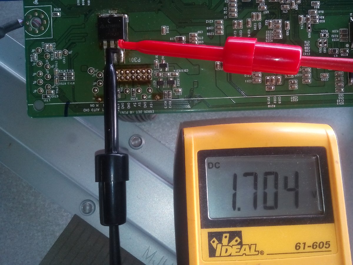

                                  OK, I checked IC301, IC302 and IC303...
                                  On IC303.....
                                  (and based on this link:http://www.learningaboutelectronics....tage-regulator
                                  ...the INPUT is shorted to GND..
                                  IC301 and IC302 don't appear to have that issue..

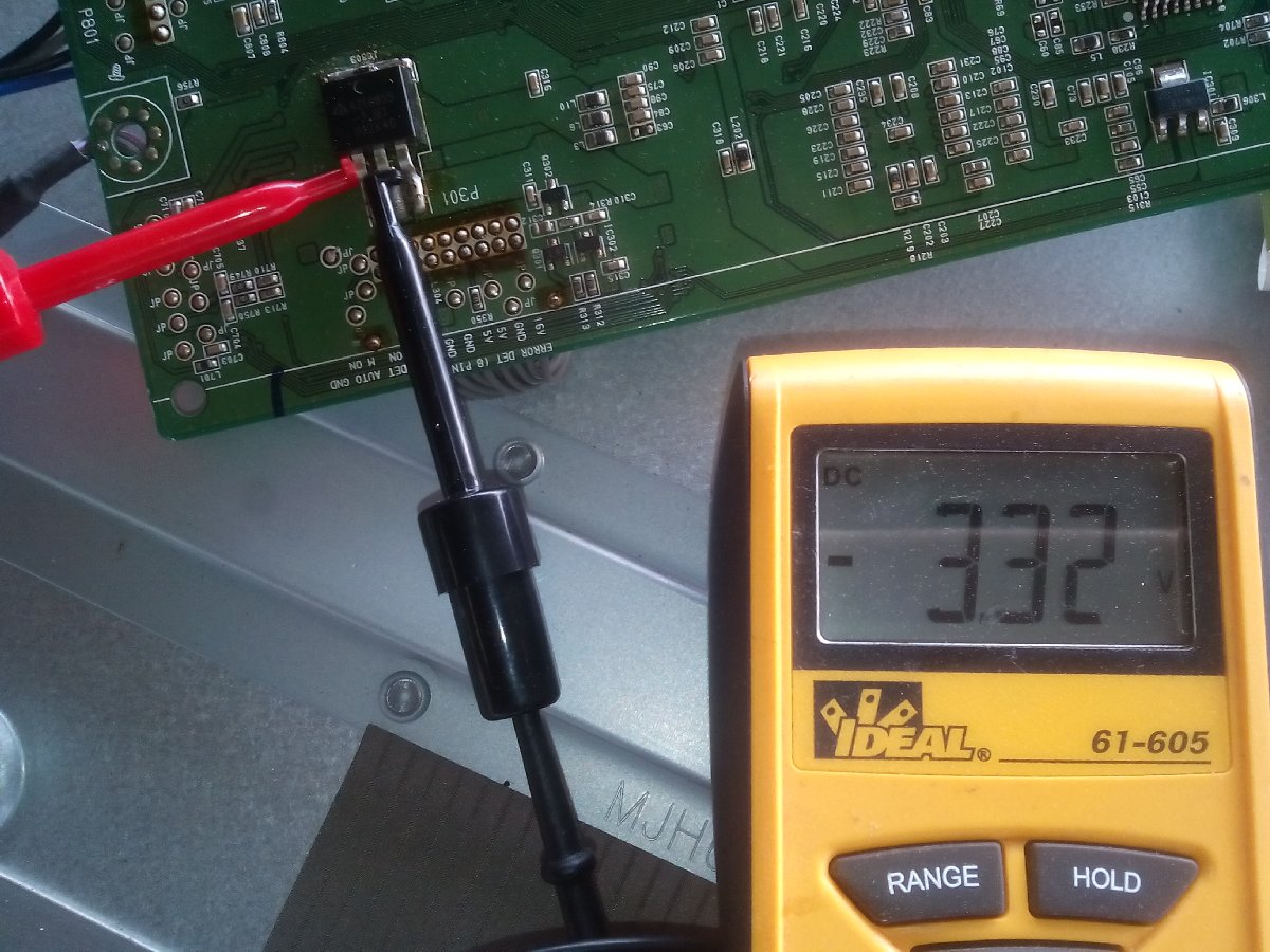

                                      The output voltage of IC303 is 1.7v
                                      The input voltage of IC303 is -3.3v
                                      Lemme get the pics.. That 8.1MP camera I got from my wife takes worse pictures than my phone..

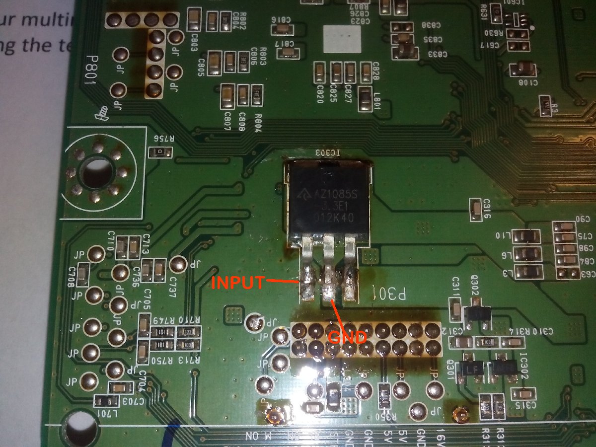

                                        Hmmmmmm Based on the new links you gave me, it's possible that the connections are not INPUT GND OUTPUT but rather GND INPUT OUTPUT
                                        Here are the pics assuming the former..
                                          Here is the datasheet
                                          http://www.datasheetlib.com/datashee...html#datasheet
                                          I do notice solder balls between the traces - try brushing them off with a
                                          fine wire brush or similar.
