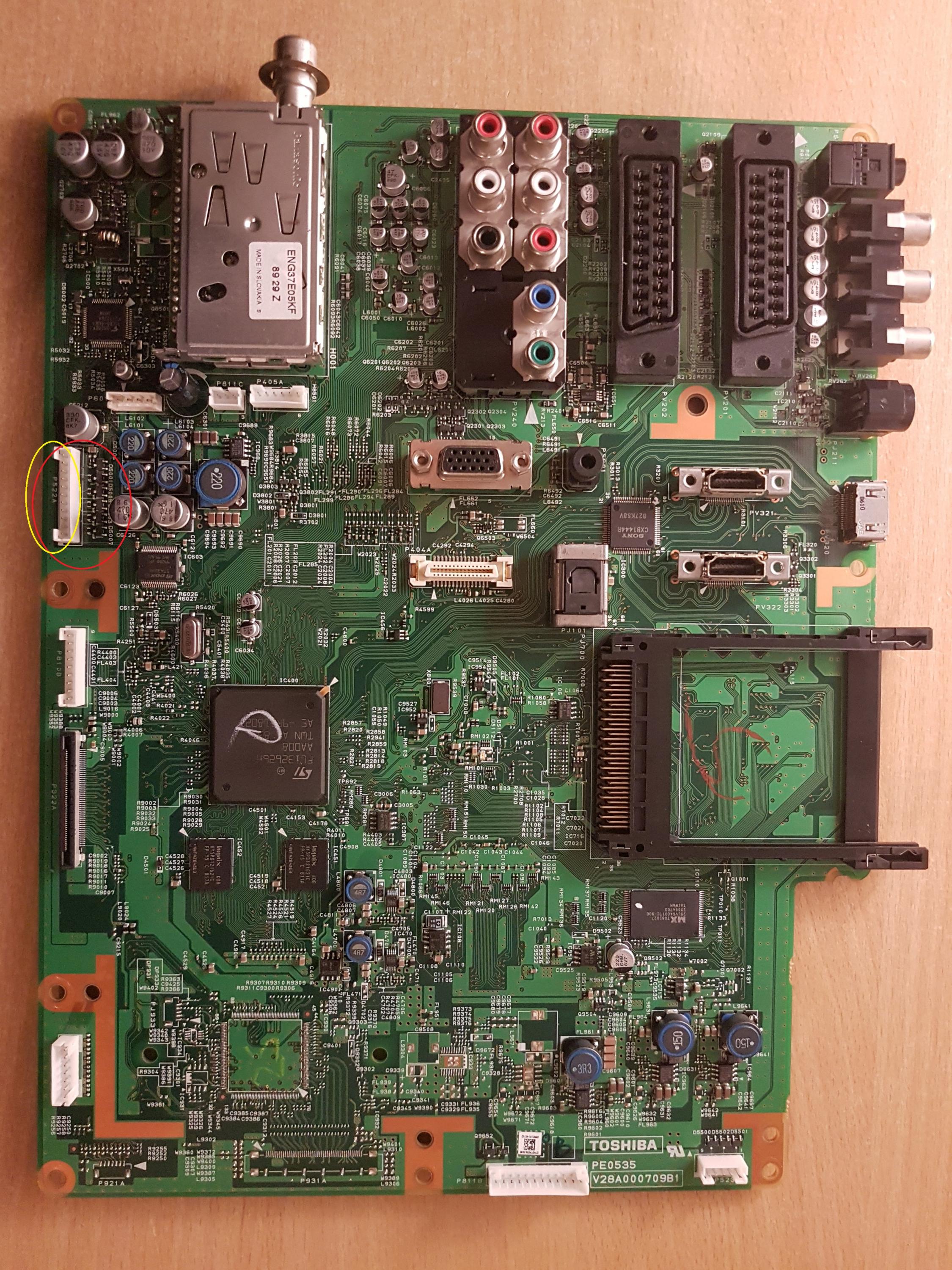

            I think the motherboard has the problem

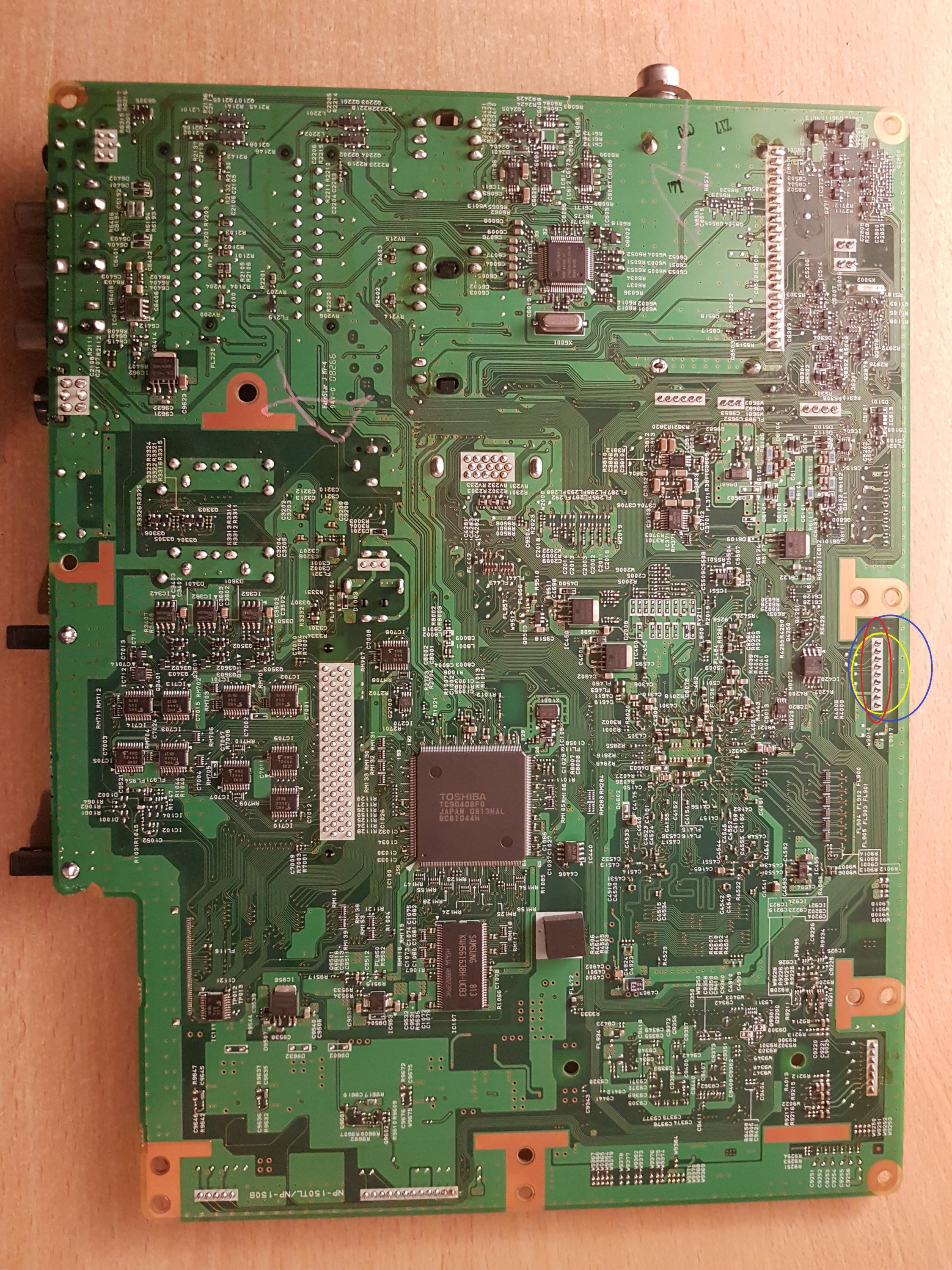

              Re: toshiba 46xv555d relay clicks
              When I remove the power supply cable from the mainboard, the relay no longer clicks
              • samtron786
                • Aug 2016
                • 165
                • germany
                Here is the pictures of mainboard
                I marked the spot

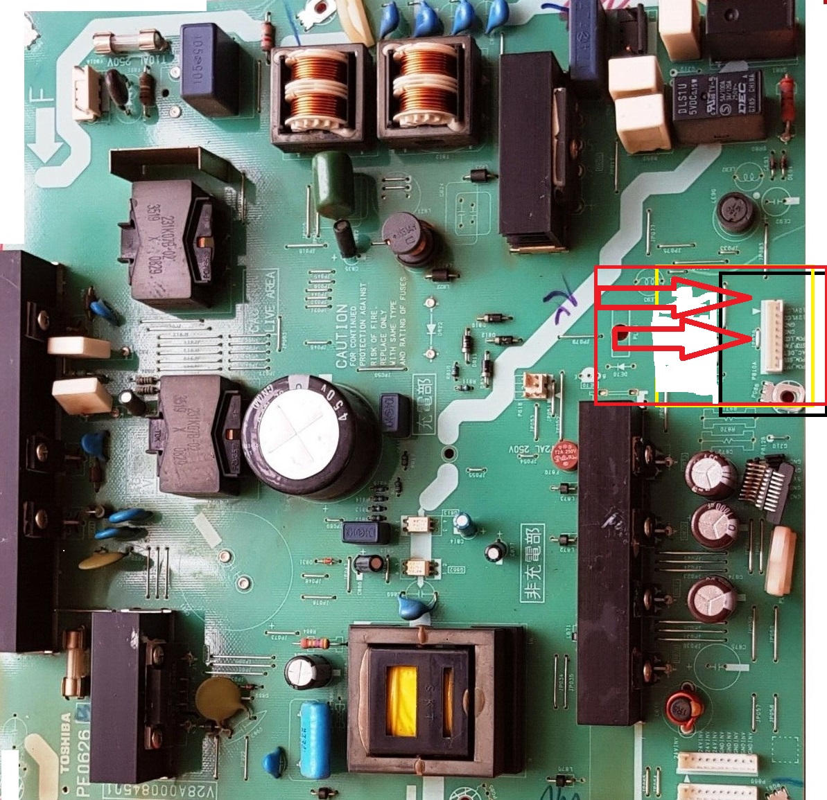

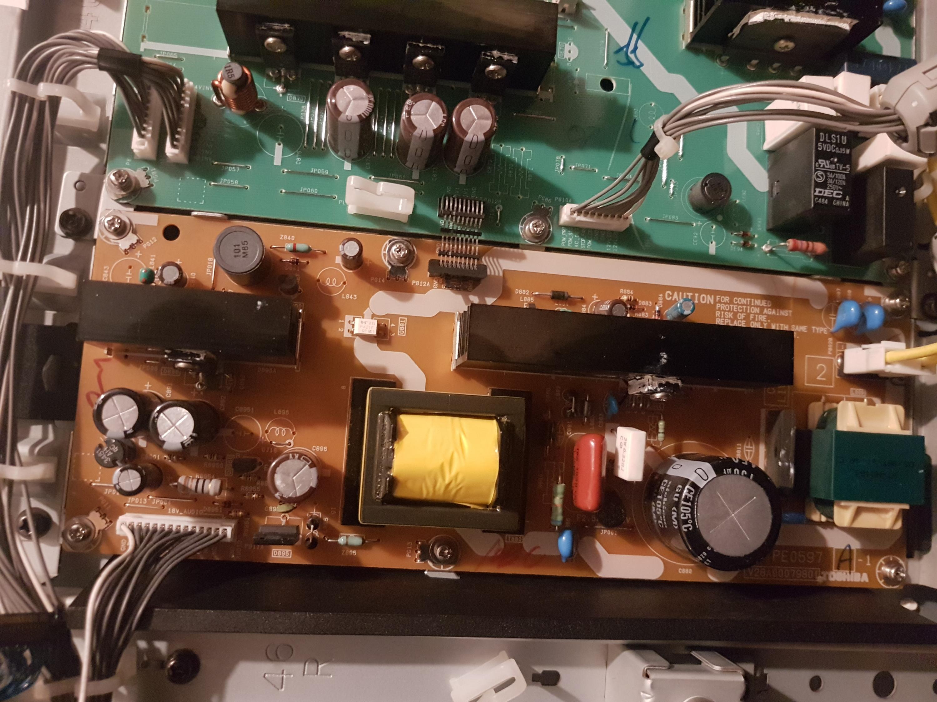

                  here is the power supply
