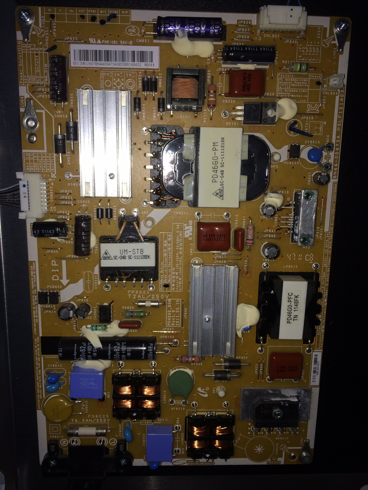

    I have a Samsung UN40D5005BF LED TV. When a power cable is connected, the TV blinks red light and starting sound comes out ( I did not push power button ). Then it repeats this by itself. The red light goes out and comes back with blinking and the starting sounds come out again.
    I have checked the capacitors and they look all very clean and flat. I checked the rectifier and it converts AC to DC well. I'm not sure whether this is a main board issue or power supply issue. Is there a place that I need to check more ?

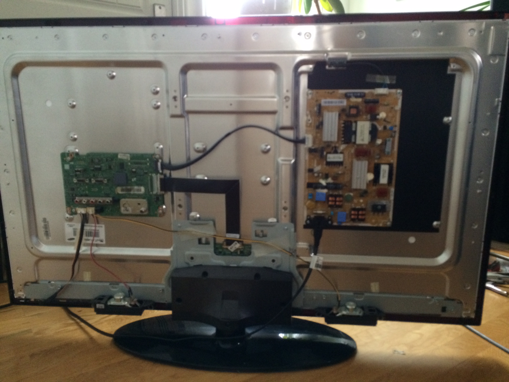

    Please upload the pictures of the whole back side of the TV so we can see how all the boards are connected together.

      Re: Samsung TV keeps restarting by itself
      I'm uploading more pictures. Thanks for looking at this problem.

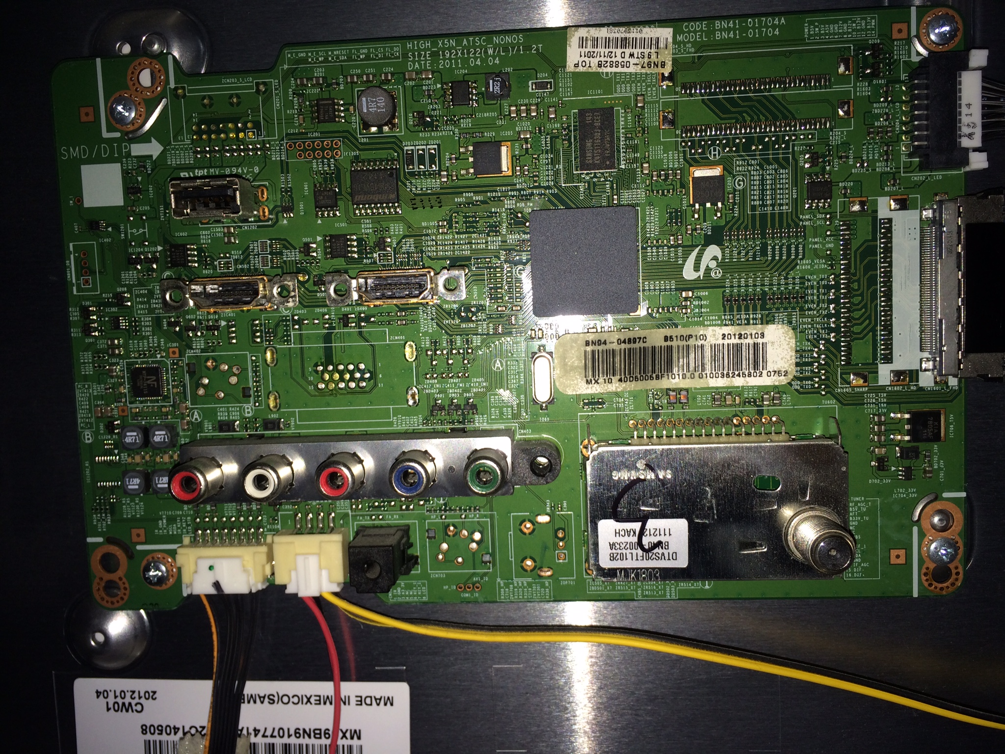

              Disconnected power switch but it still tries to start. There is no red light but I could hear starting sound. I don't know what makes this start. If I'm sure that this is a main board issue, I will buy the cheap part. That's pretty good price.

                I guess I have the same issue that this guy has. It was a main board issue.
                  Main board issue = usually the main BGA processor needs reflow or reballing. But a proper reballing would cost upwards of $60 so in this case replacing the mainboard is the cheaper option.

                      I disconnected the tcon board and TV still automatically keeps starting over and over again. I can tell because a starting sound comes out but there is off sound so I assume that it crashes and restarts. Hope this is a main board issue. I already ordered the part so we will see in a week.
                          I replaced the main board but no luck. Probably the power board has an issue...
                            This test can't be definitive without knowing the nature of this power supply but it looks similar to other basic Samsungs in which this test would apply. Disconnect the cable between the main board and the power supply and then plug it in. Does the backlight come on ?
