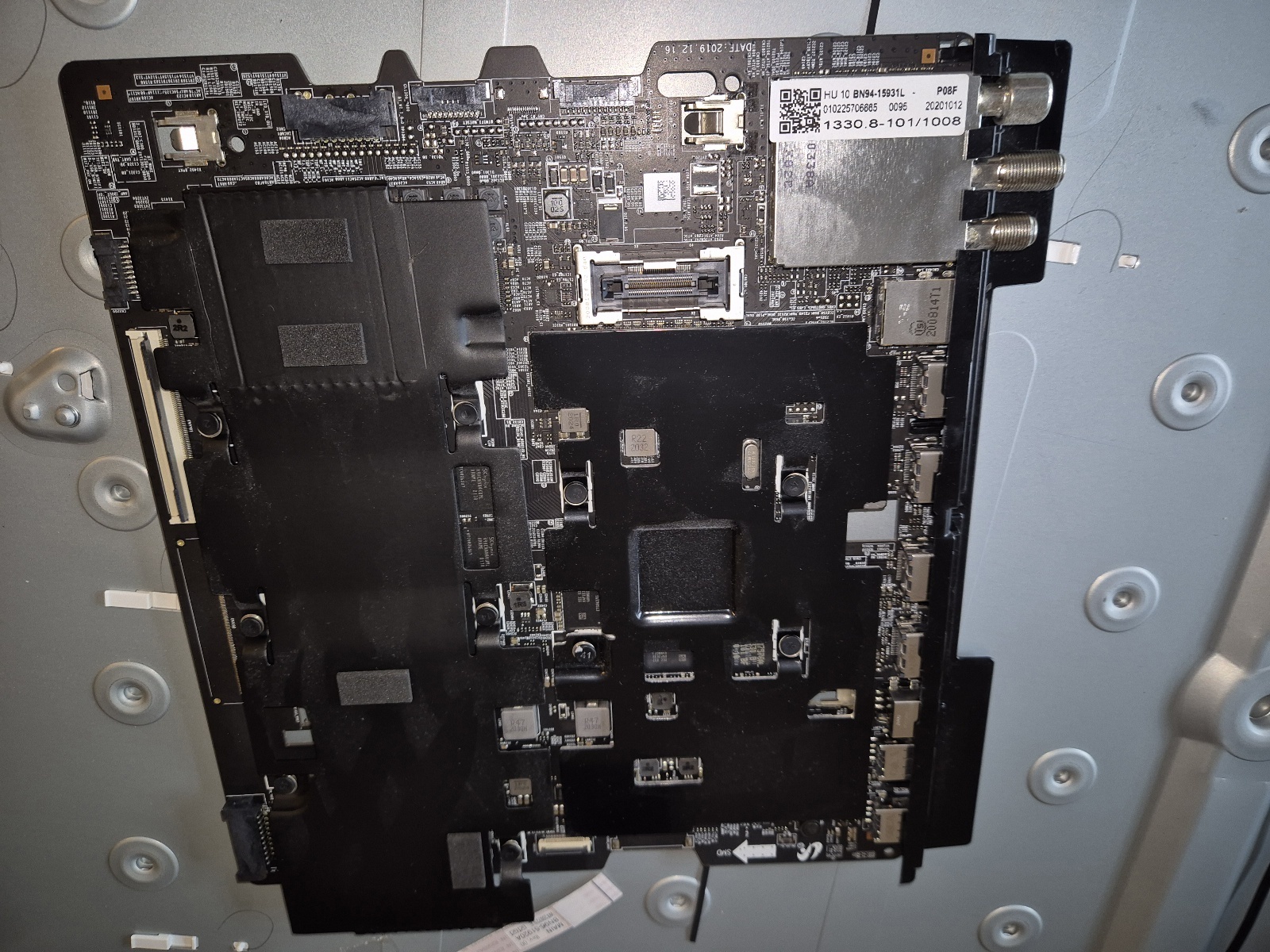

    I managed to remove the mainboard, visual inspection did not reveal anything weird yet. Didnt manage to remove the heat shield which covers the majority of the board (yet) though.
    Main suspect: Possibly bricked mainboard or failed SPI flash / EEPROM (firmware corruption), since the PSU and backlight behave normally once disconnected from mainboard. PSU likely good. T-Con not tested independently yet.
    I cant seem to find any manuals with details on the boards themselves, which would be very helpful...
    I need help with finding the SPI flash chip or EEPROM on BN94-15931L / BN41-02958B board, so that I can try resetting it in case it is bricked.
    or any other ideas...

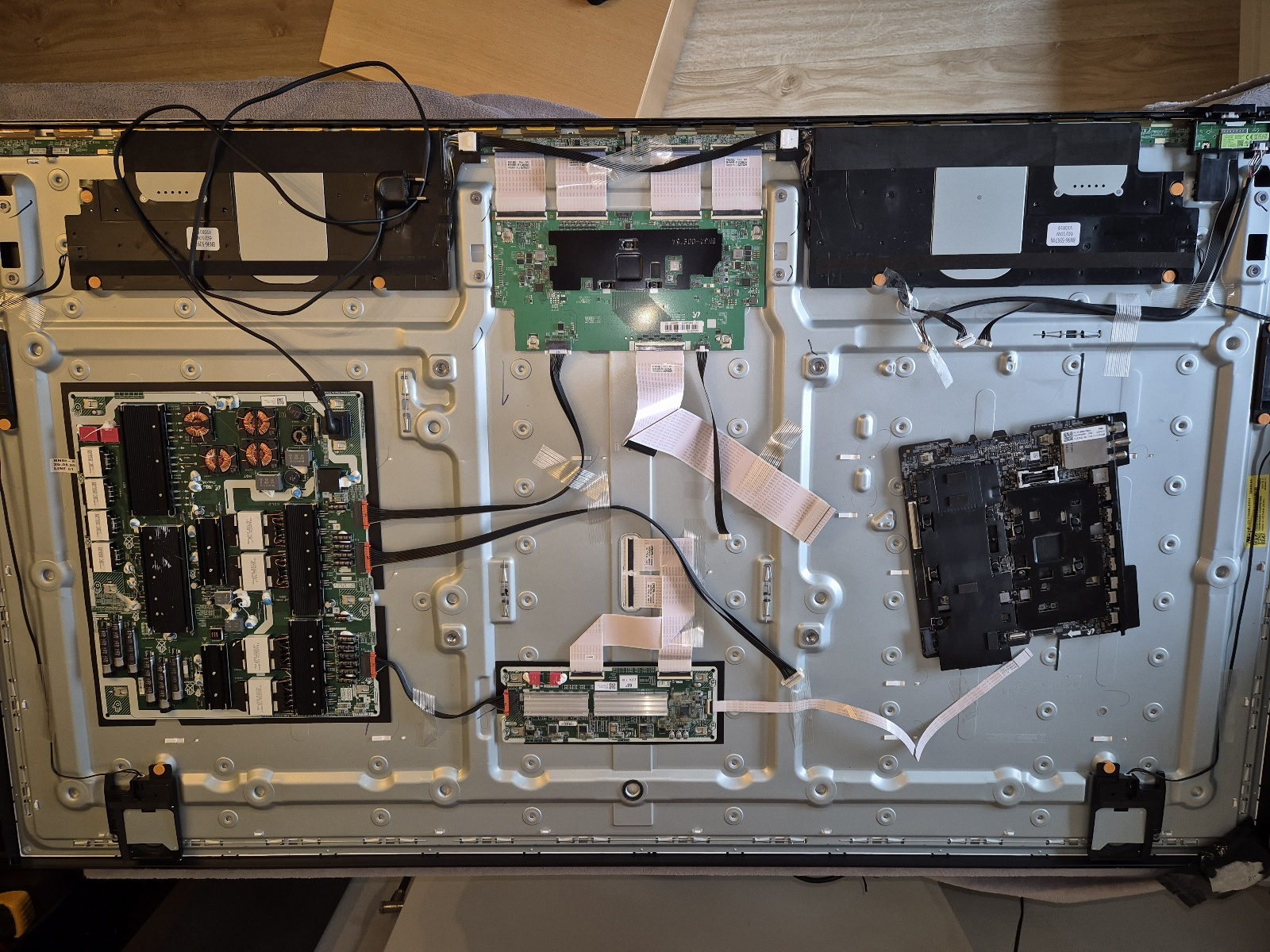

    What happens if you disconnect the cable from the main board to the buffer boards / panel?
    Some pictures would be nice.
    • K212
      • Jul 2025
      • 12
      • Sweden
      Here are some pictures. I will do that test later today if I can.

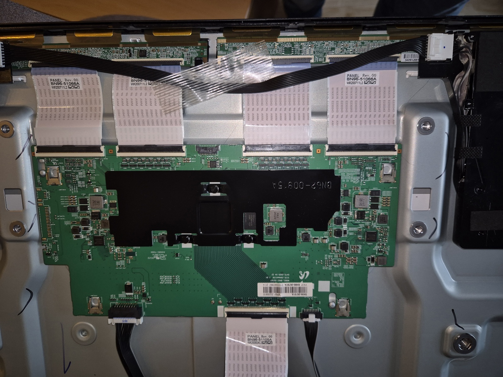

        Alright, so now I’ve tested a few more things. Here are the results:
        1. Everything connected:
        When powered, there’s a slight buzz from the T-Con and a very gentle, quiet whine (or high-pitched beep) from the main board.
        2. Main board disconnected from T-Con:
        No backlight, screen remains completely black/unresponsive. Same sounds as above (T-Con buzz + main board whine).
        3. Main board and T-Con reconnected. Disconnected the left 2 ribbon cables from the T-Con (going to what I believe are the buffer boards for the left side of the panel). Right-side ribbons stayed connected.
        Result: No backlight or audio. T-Con was silent. Main board still made the quiet whine.
        4. Reversed the test (disconnected right-side ribbons instead, left-side connected):
        Same results as above — no image, no backlight, T-Con silent, and main board continued with quiet whine

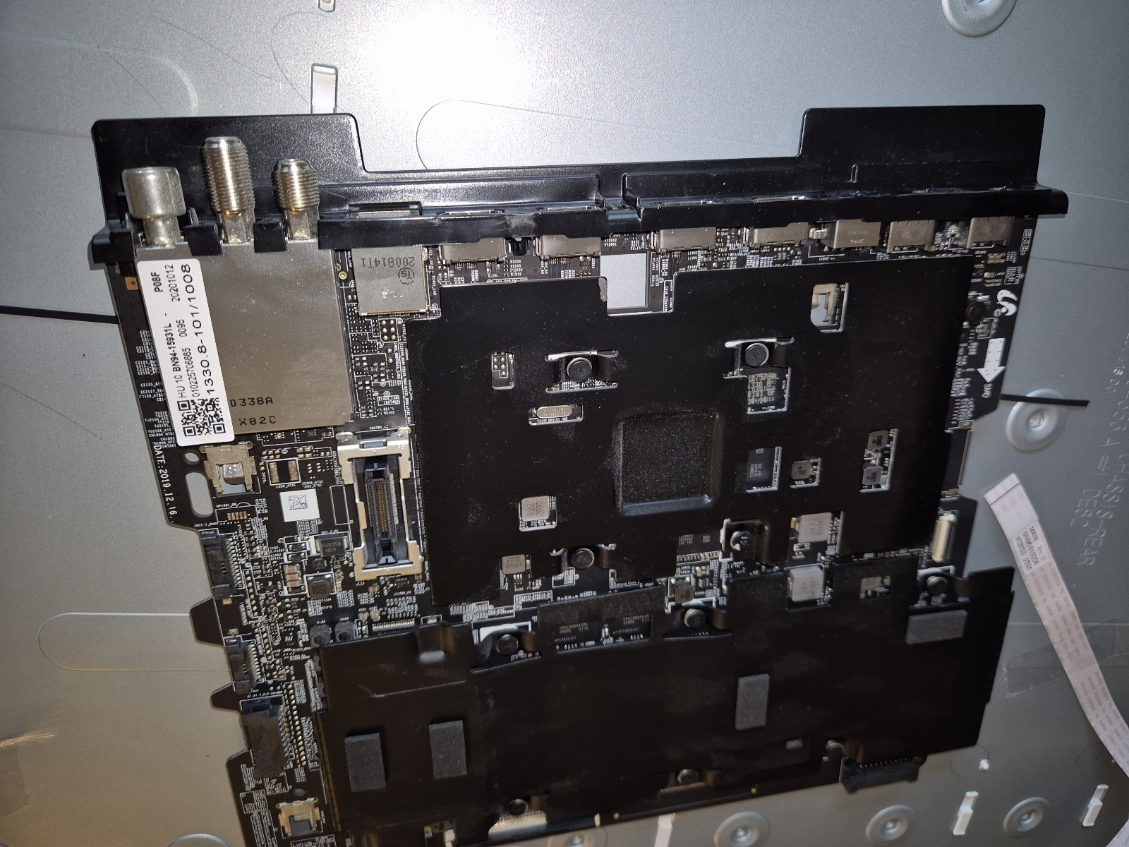

              I could probably inspect further if I can remove those heat shields, but I am uncertain how to do that without possibly damaging the board. Any help there would be appreciated as well.
              • Davi.p
                Hobbist Tech
                • Sep 2009
                • 4597
                • Italy - Milan
                if you have an heat gun or hot air station you can warm it for 1 minute at 200 celsius and the rest said..

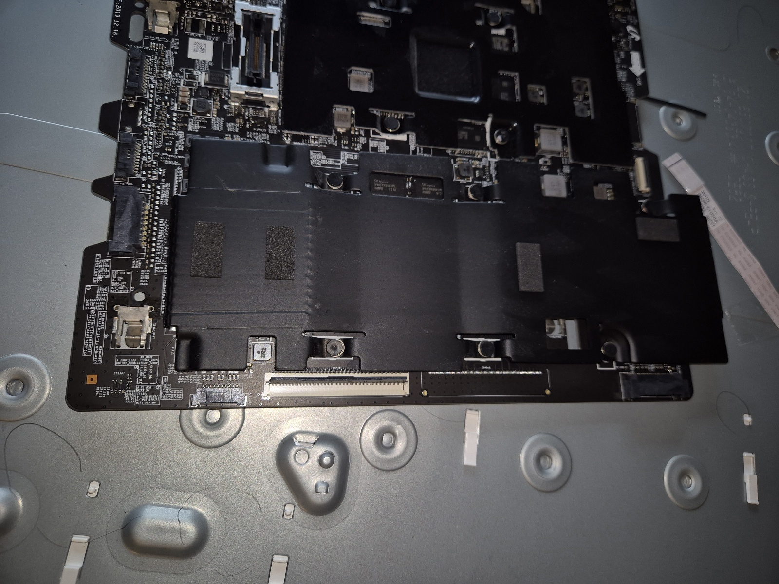

                                Not familiar with this mainboard, maybe look at the bottom side. See if there's little plastic bits poking thru that need to be squeezed together and poked thru to release the heatsink.
                                • K212
                                  • Jul 2025
                                  • 12
                                  • Sweden
                                  Yeah, where those circular markings are (see picture), a tiny bit sticks out from those anchors. So I just squeeze them and pull gently from the other side then? Do I need to be careful with those springs?
                                  also note, I have an arduino board that perhaps could be used to read some data of one of the chips??

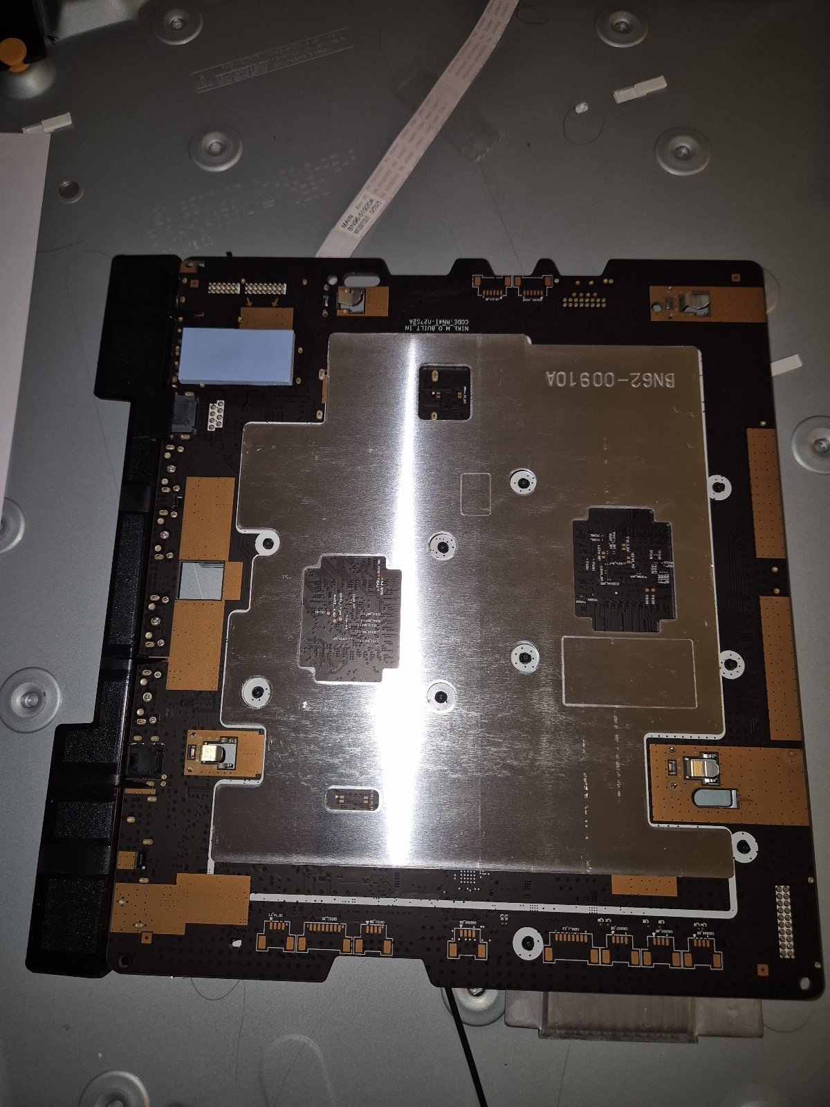

                                    If it's the type I'm thinking of you need to remove the mainboard from the tv, turn it over, spot the plastic bits sticking thru, use tweezers or such to squeeze them to release, use magnifier if needed.
                                    • nomoresonys
                                      • Jan 2013
                                      • 12370
                                      • U.S.
                                      Once those are released then gently twist side to side to loosen the heatsink compound, it may pop right off with no trouble.
                                      • nomoresonys
                                        • Jan 2013
                                        • 12370
                                        • U.S.
                                        You can try a test once you get the heatsink off, heat the chip with a hairdryer for a minute or two, then try the tv, see if you get a display but don't run it for too long this way because the heatsink is off.
