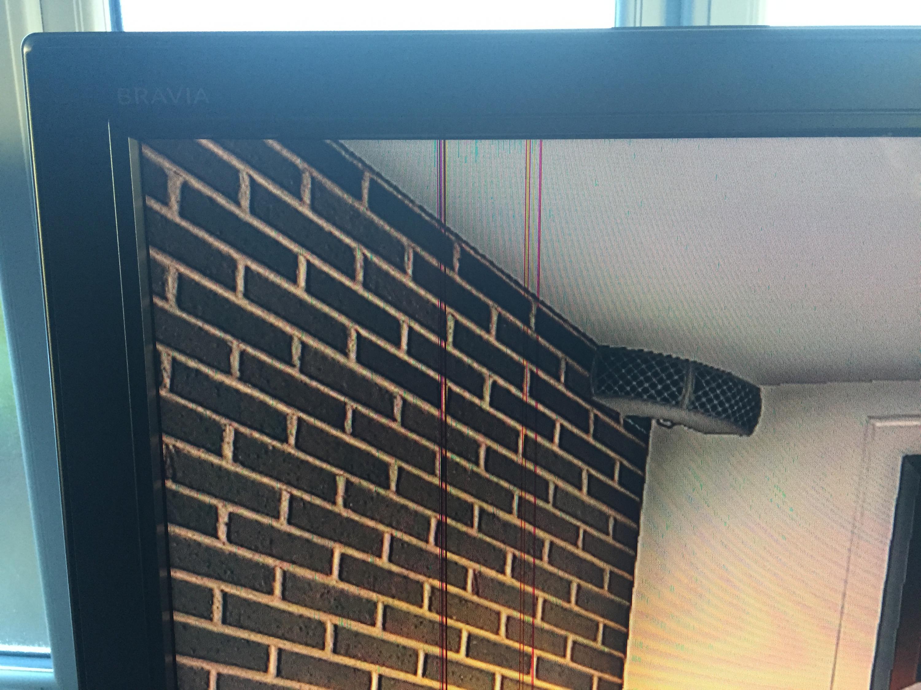

    sony kdl 46d3500 lines
    OK so its not the Tcon as i replaced already, is it bad bonds, tcon cable or Main board ?
  • freakaftr8
    • Oct 2012
    • 3743
    Re: sony kdl 46d3500 lines
    It is bad bonds. Unrepairable Use it while you can. probably going to get worse eventually sadly
    • nomoresonys
      • Jan 2013
      • 12322
      • U.S.
      maybe try, holding front of tv bezel with your palm, right at the lines and tap on the back, if it dont work tap a little harder, try top and bottom, some people tap right on the screen, but if you do tap lightly, the screens are delicate.
        You can read these:
        https://www.badcaps.net/forum/showpo...4&postcount=12
        Tab bond or drive IC failure.
