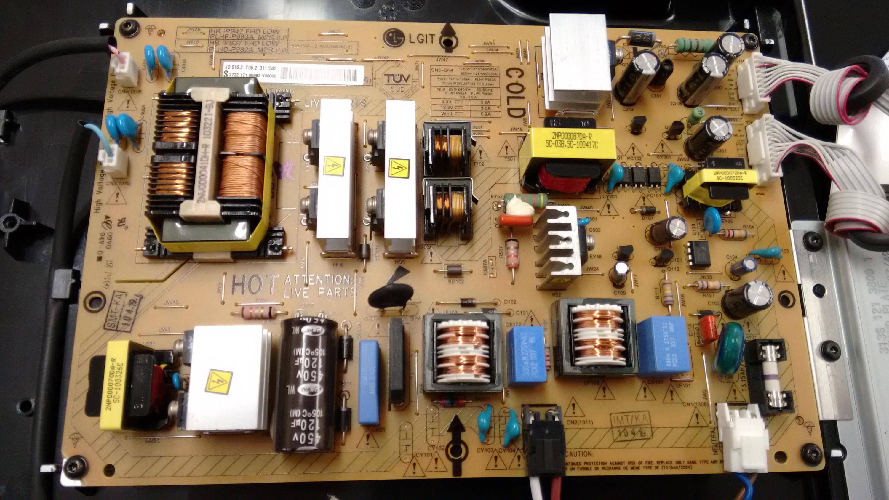

    Hi Guys,

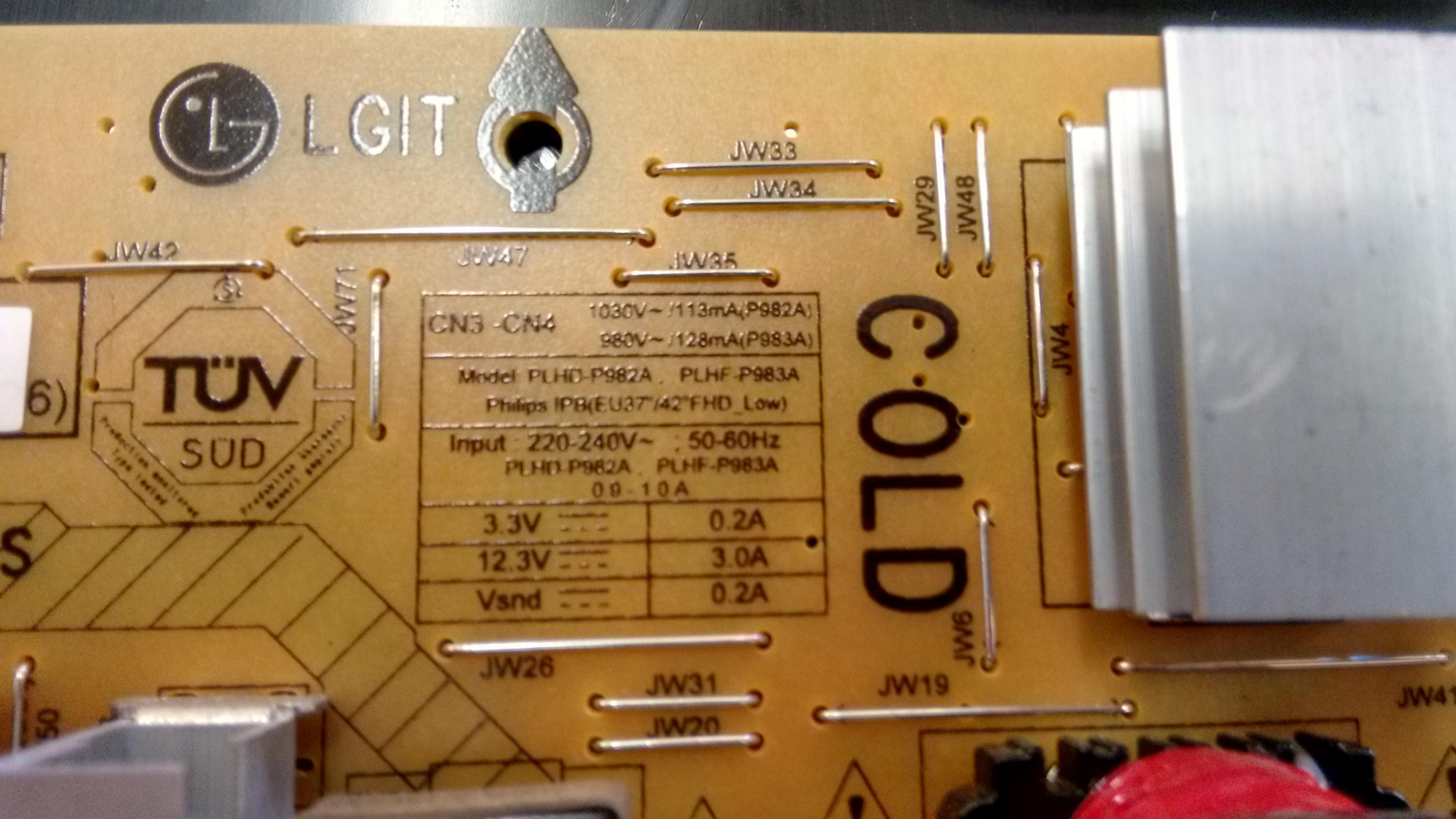

    I have one of these tvs which suffered the 3 red led flashes.I have opened up the tv and it has the PLHD-P982a psu.
    It has now started to blow the fuse on the psu.Resistor at location R517 smokes when I install a new fuse and switch on.
    I cannot find a schematic for this psu.I have the service manual alright.
    I have attached pics of psu,

    this is the closest I see, might be similar to yours, http://www.toms-service-manuals.com/...h=Submit+Query

      Check diodes - especially D210 prone to failure - does the resistor test correct resistance?

        D210 seems to have failed.I will desolder the resistor and test.

          Lift one leg of D210 and test again. If it has failed shorted that may be the problem but it may have taken out other parts. Test the diode pads and see if a short still shows.
          Perhaps google Dim Bulb Tester and make one up to save blowing more or new
          components.

            Diode showing no voltage.Pads are showing .286

                                Ok so I have replaced the diode and made up a dim bulb tester.Still no power on tv and bulb burning brightly so the diode must have taken something else out.
                                No voltages at pins to main board not even standby.
                                Where to next guys????

                                  Checked bridge retifier.
                                  Tested shorted in pcb.
                                  Removed and tested ok.
                                  MMMmmm

                                      Well, just keep following it along and see where the short is. Shorted MOSFET/IGBT is the most likely but could be a shorted filter capacitor or other component... Keep working your way along, testing the next components in the circuit by disconnecting each and testing out of circuit until you find the short or disconnect something and the short disappears.
