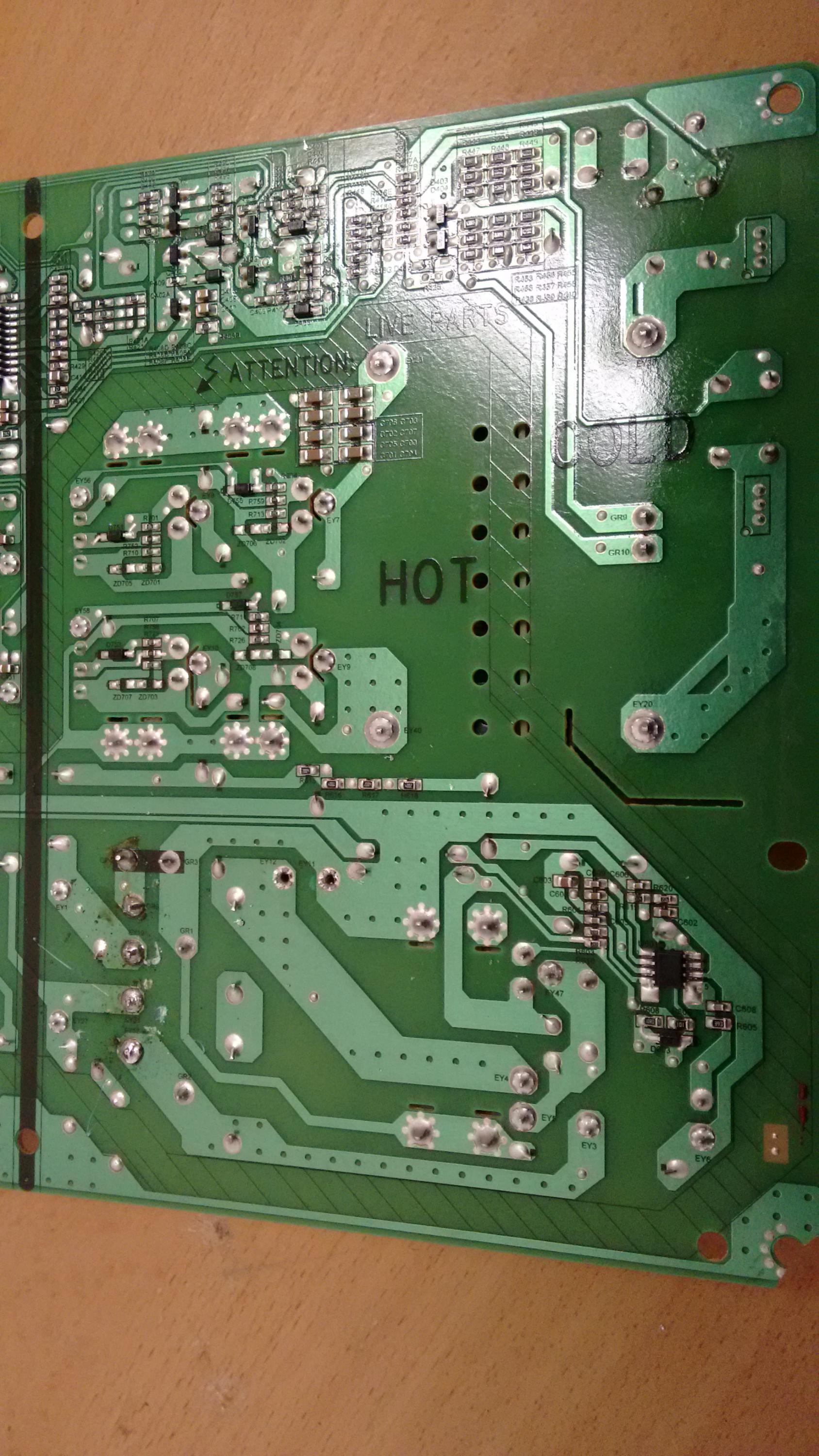

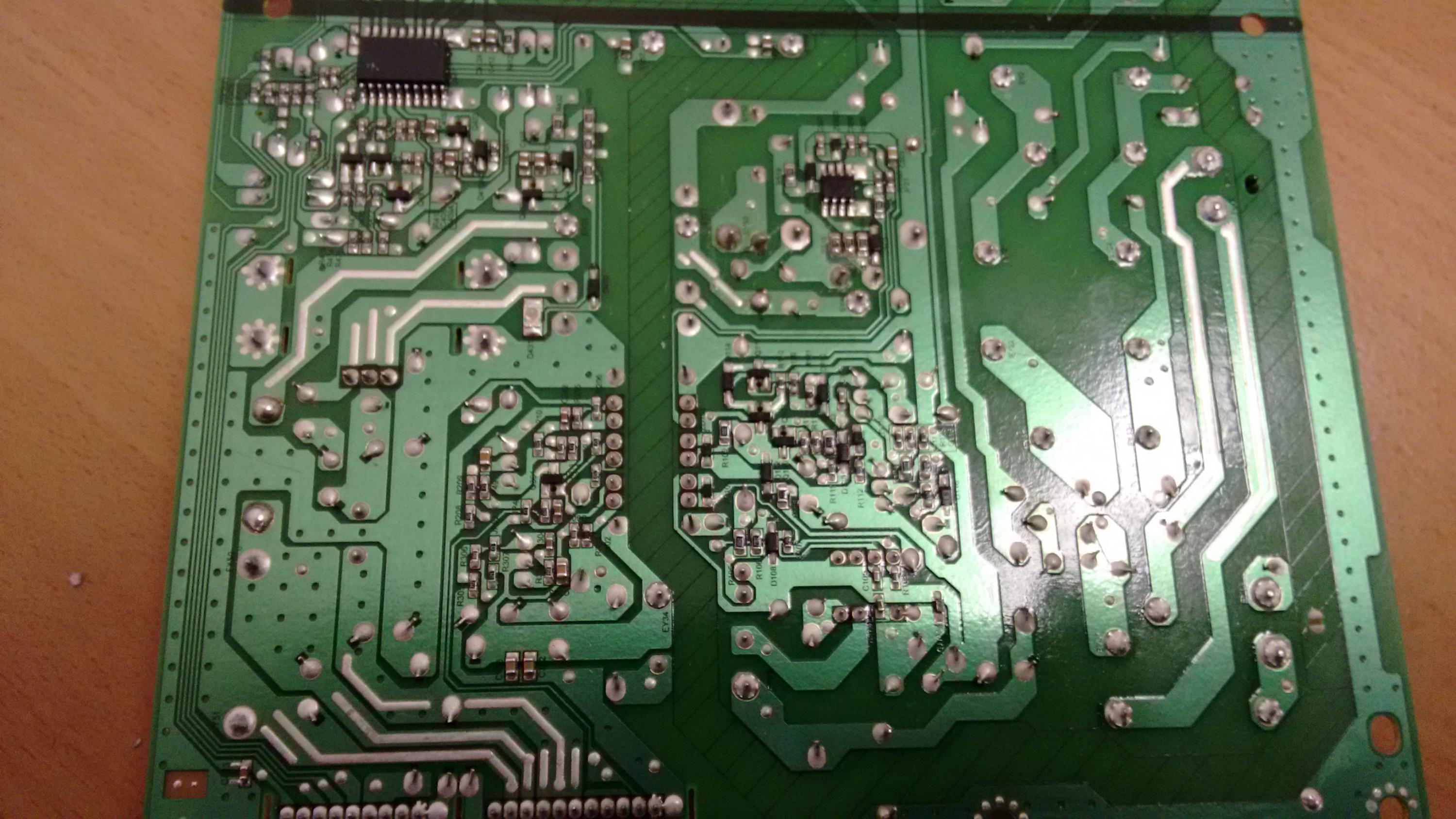

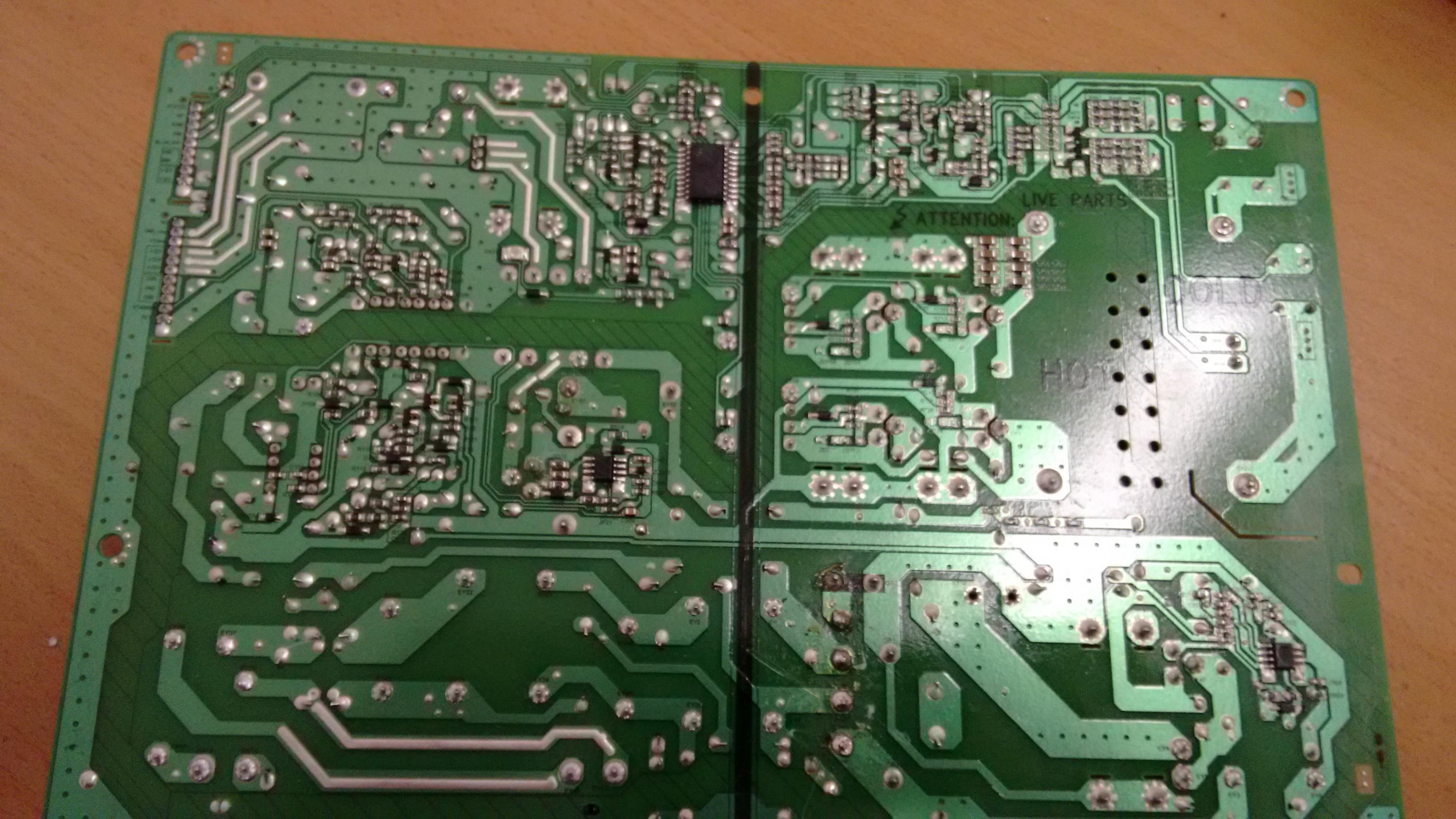

    Can I see good clear pictures of the bottom side of the board?

        Pictures attached of bottom of board.
          Re: Philips 37pfl5405H/05
          I think mosfet 6n80c is gone.
          Can I use a FQPF9N50CF in its place as I have one here or should I try and order one????

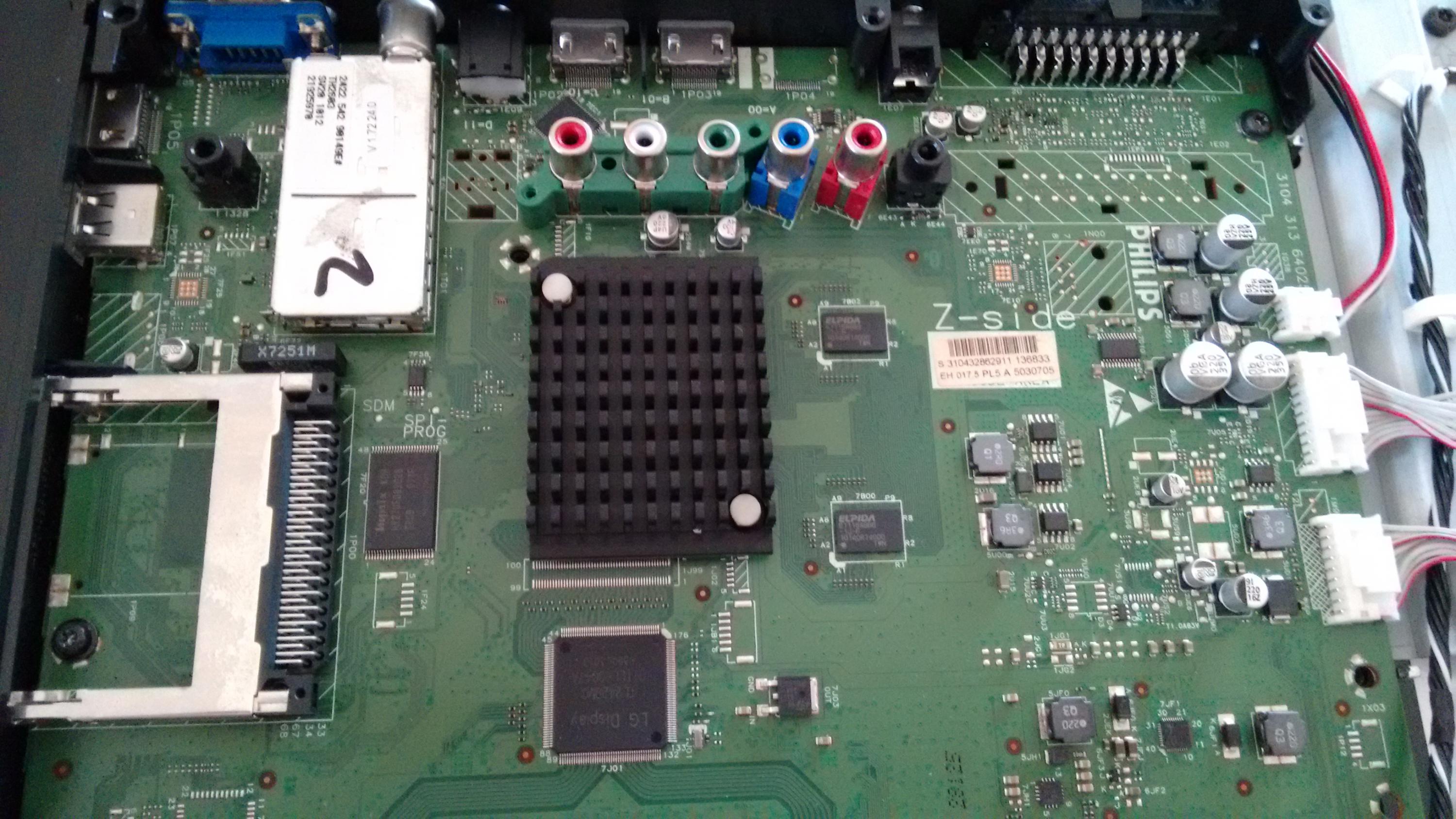

                So all voltages are ok on psu and I have narrowed it down to disconnecting plug cn6 to mainboard.
                When this is not connected no flash from dim bulb and no light on led on underside of psu.
                It must be a mainboard problem????
                How do I go about testing this???

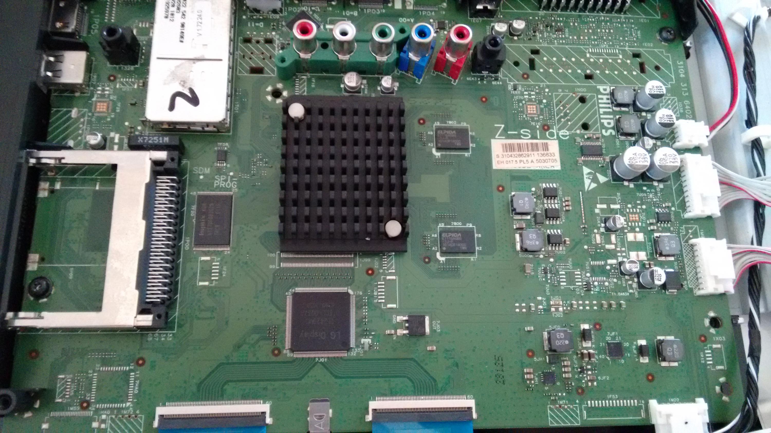

                  Pics of mainboard.

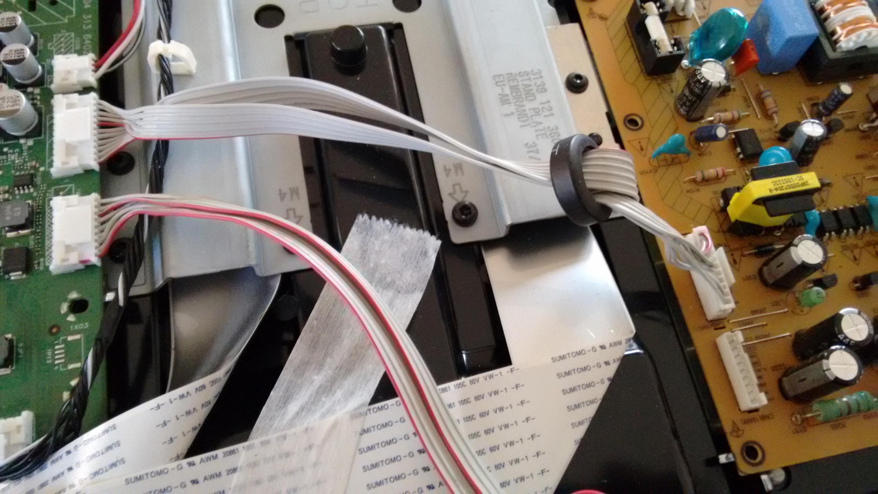

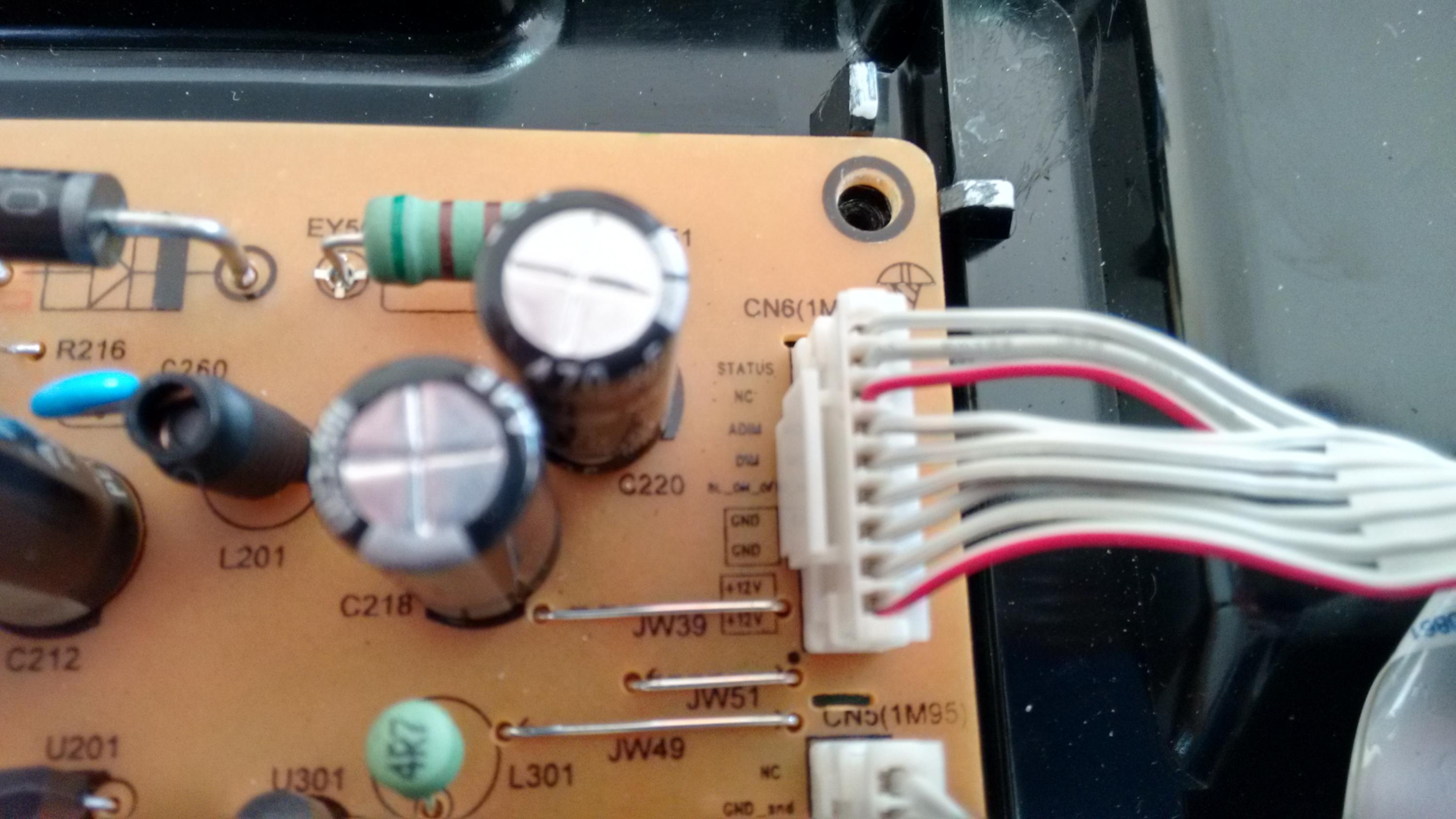

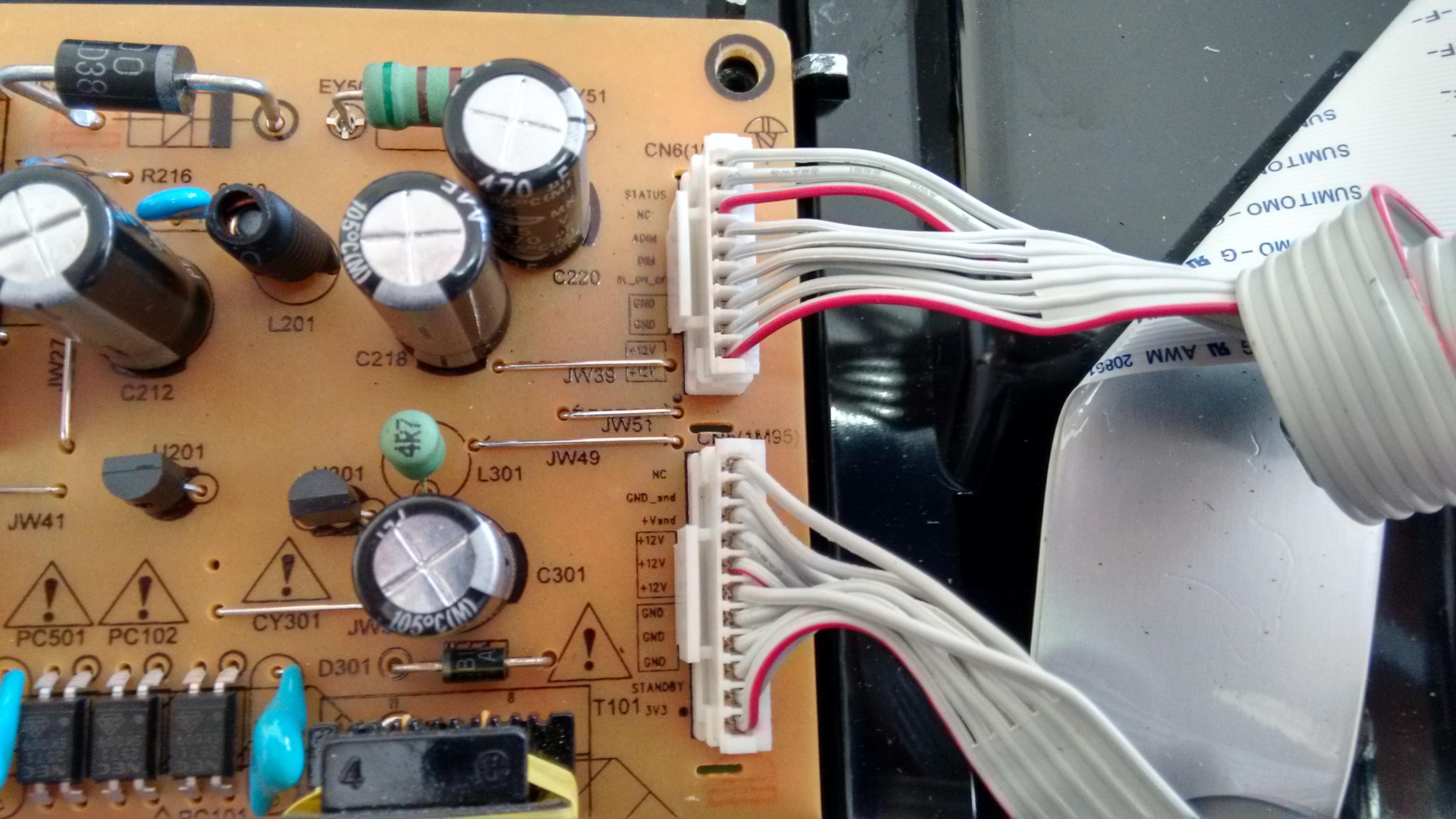

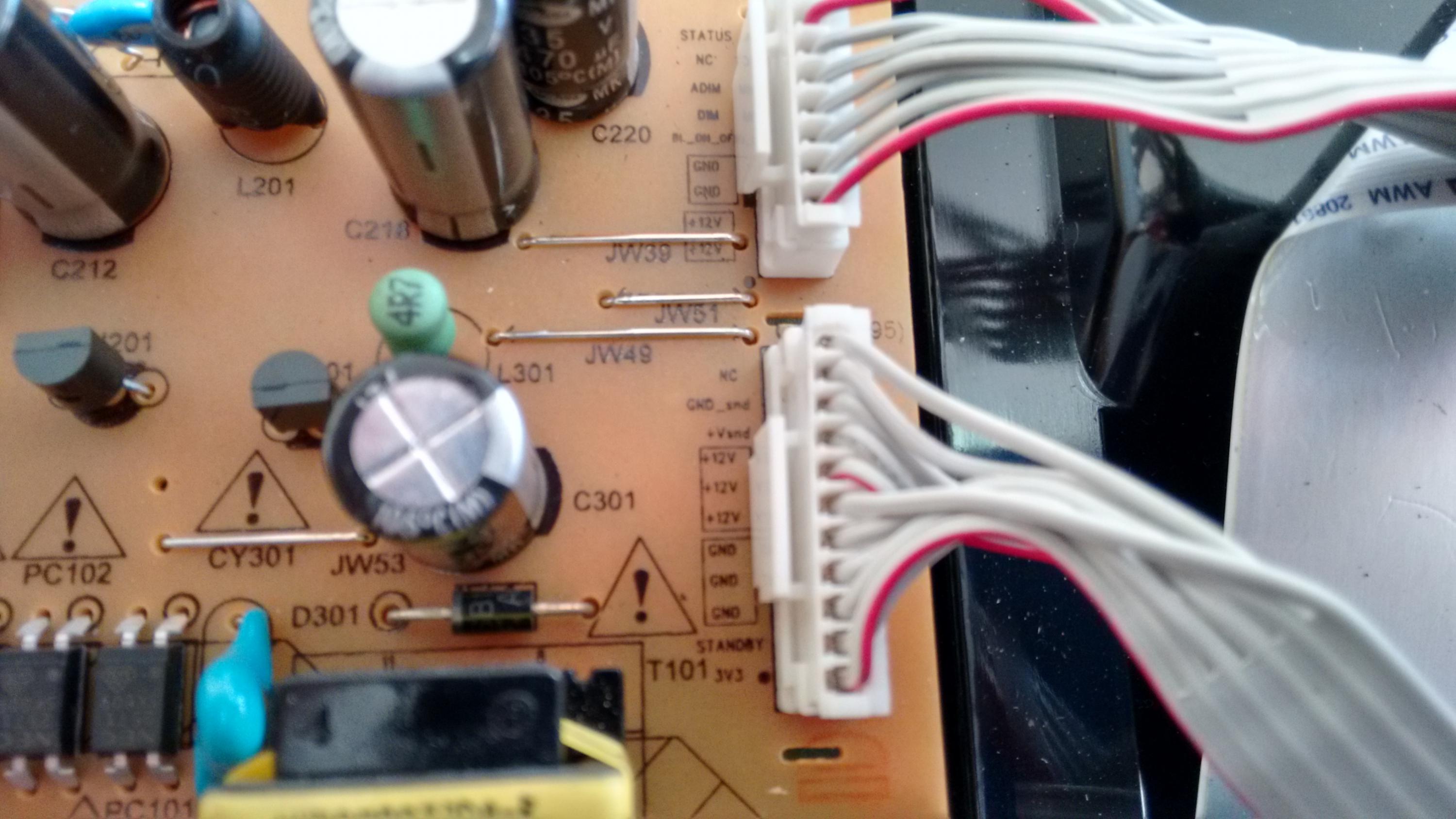

                        You said that you measured all voltages on the PSU. Does that include the voltage at CN3 and CN4? From the print in the 2nd picture you posted, the voltage at CN3 is 1080V AC and at CN4 the voltage is 980V AC. So be carefull there because you can damage your meter if it's not designed to handle voltages like that. The two connectors at the top right corner in the 1st picture, post some close ups of the print next to them so that we can see what each pin of the connectors are for and how unplugging CN6 affects the working of the TV
                          seems like a mainboard issue, not sure, but they're pretty reasonable on ebay, http://www.ebay.co.uk/sch/i.html?_od...&_sacat=163768
                            Thanks a mill guys.Pics of connection attached.
                            When I said I had tested voltages on psu I meant at these connections.
                            Thanks again guys as I thought I was on my own with this!!!!
                                gonna pull the trigger on a new main board and see
                                  #36
                                  Got new board same bloody problem!!!
                                    #37
                                    Ok so I said bugger it I'm goona try it without the tester and low and behold it started right up.
                                    Have the old board in it at the mo and its not finding any channels,I think this set may have been a victim of a lightning strike.
