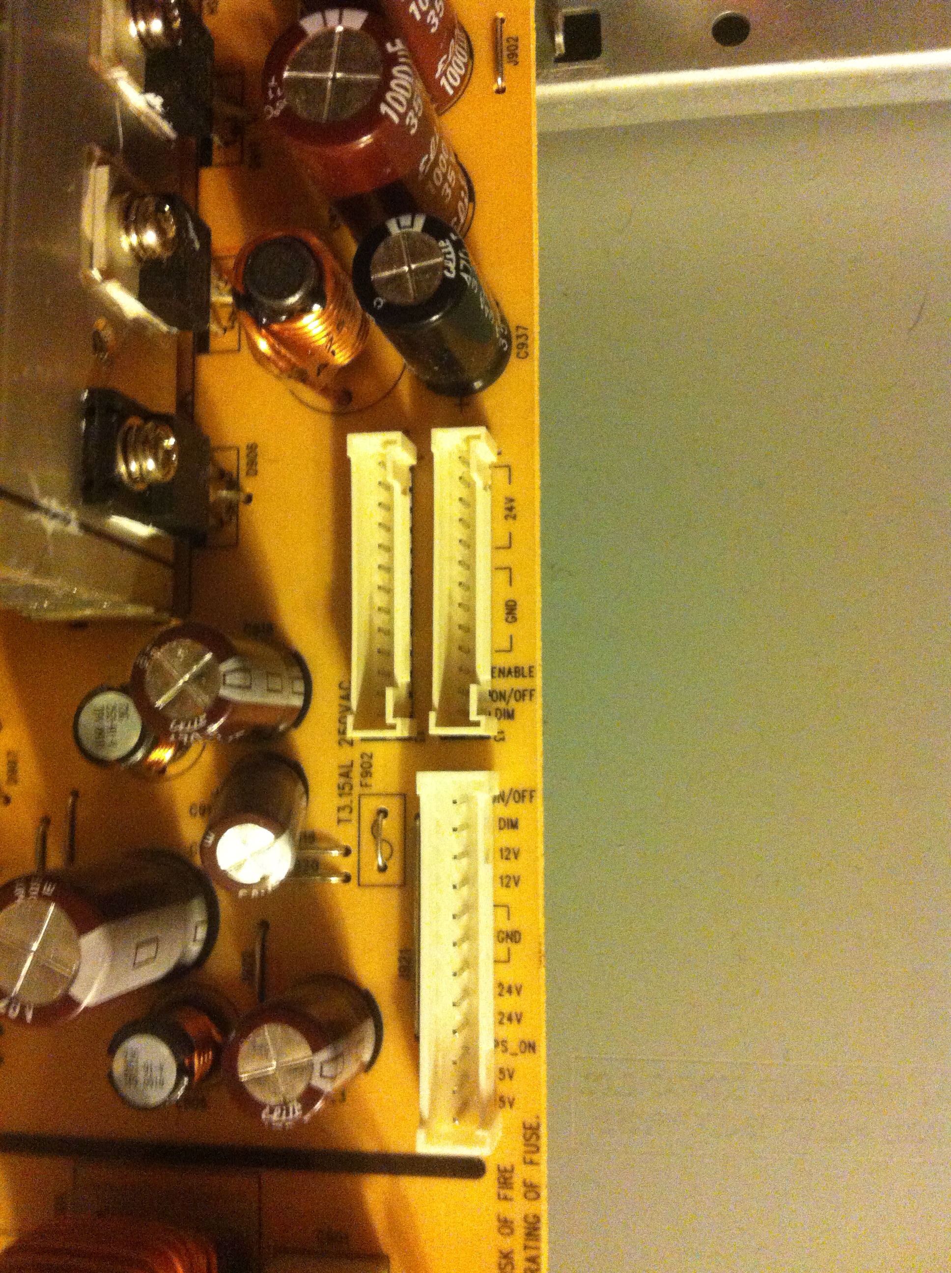

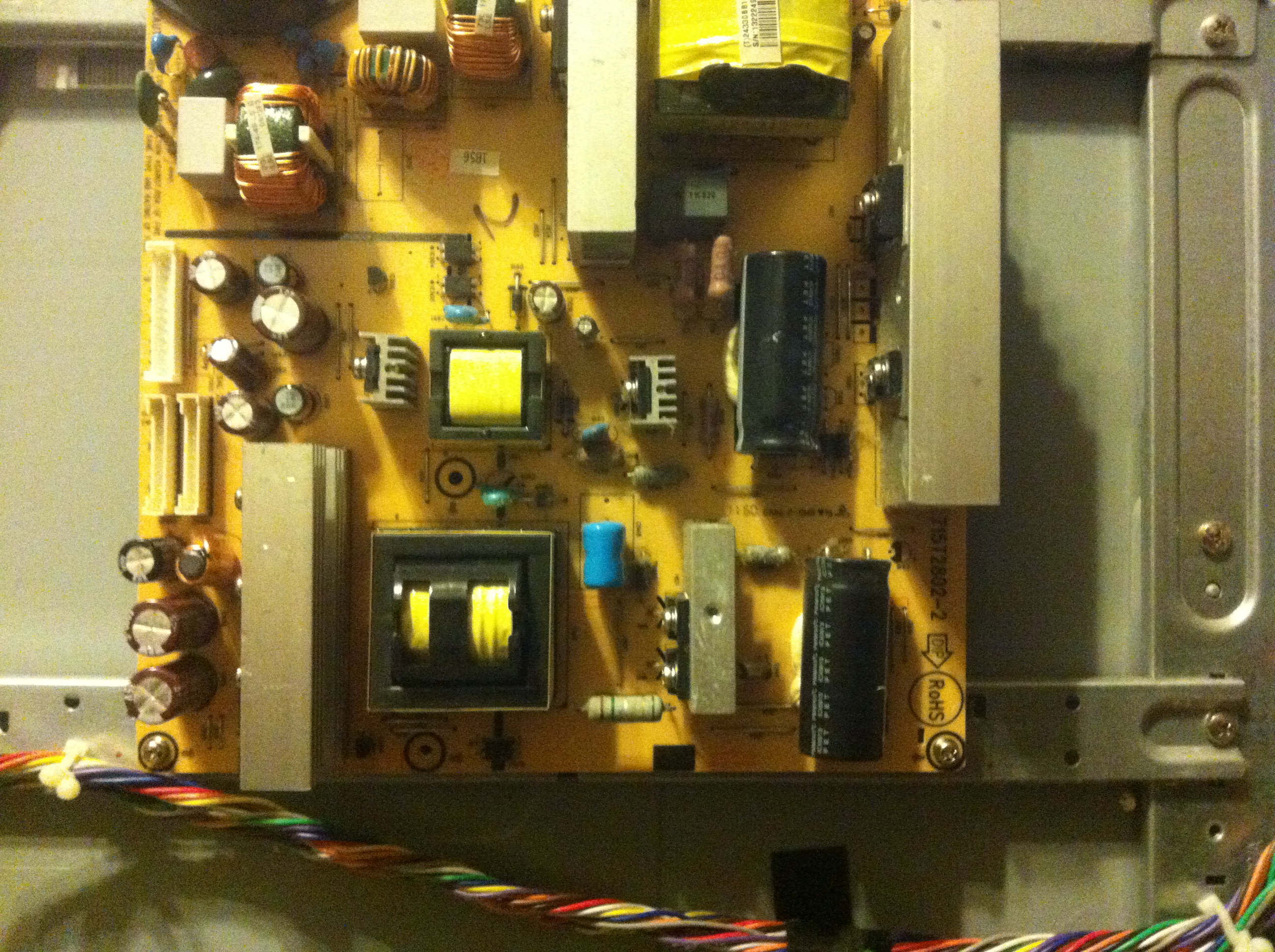

    I need help. I have a INSIGNIA NS-L47Q09-10A with both no sound or picture. I get the light on the front to light up red when plugged in. The light will change to blue when i press the power button. No flash or flicker on screen. No imagine at all when turn off the room lights and check the screen.
    I have already replaced the power supply board. It was not producing 12 or 24 volts. The new power works. But I'm still not getting any picture or sound. The closest manual for this tv I found was one for the NS-LCD47HD-09 tv. I also unplugged the T-connector board to see if the backlight would come on but nothing at all.
    Voltages:
    CN903 plug
    on/off: 3.117v
    DIM:3.055v
    12v:11.95v
    12v:11.95v
    GND:ground
    GND:ground
    GND;ground
    24v:24.66v
    24v:24.66v
    PS_ON:4.010v
    5v:4.965v
    5v:4.965v
    Next plug:
    DIM:3.055v
    On/Off:3.117v
    Enable: No Wire
    GND:ground
    GND:ground
    GND:ground
    GND:ground
    GND:ground
    24v:24.66v
    24v:24.66v
    24v:24.66v
    24v:24.66v
    24v:24.66v
    Next Plug:
    24v:24.66v
    24v:24.66v
    24v:24.66v
    24v:24.66v
    24v:24.66v
    GND:ground
    GND:ground
    GND:ground
    GND:ground
    GND:ground
    GND:ground
    GND:ground
    Fuse on inverter broad F200:24.64v both sides

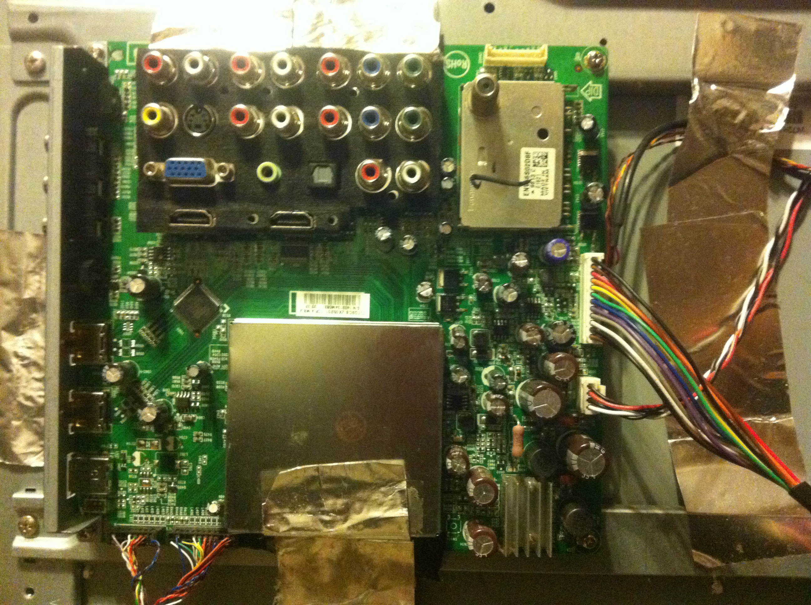

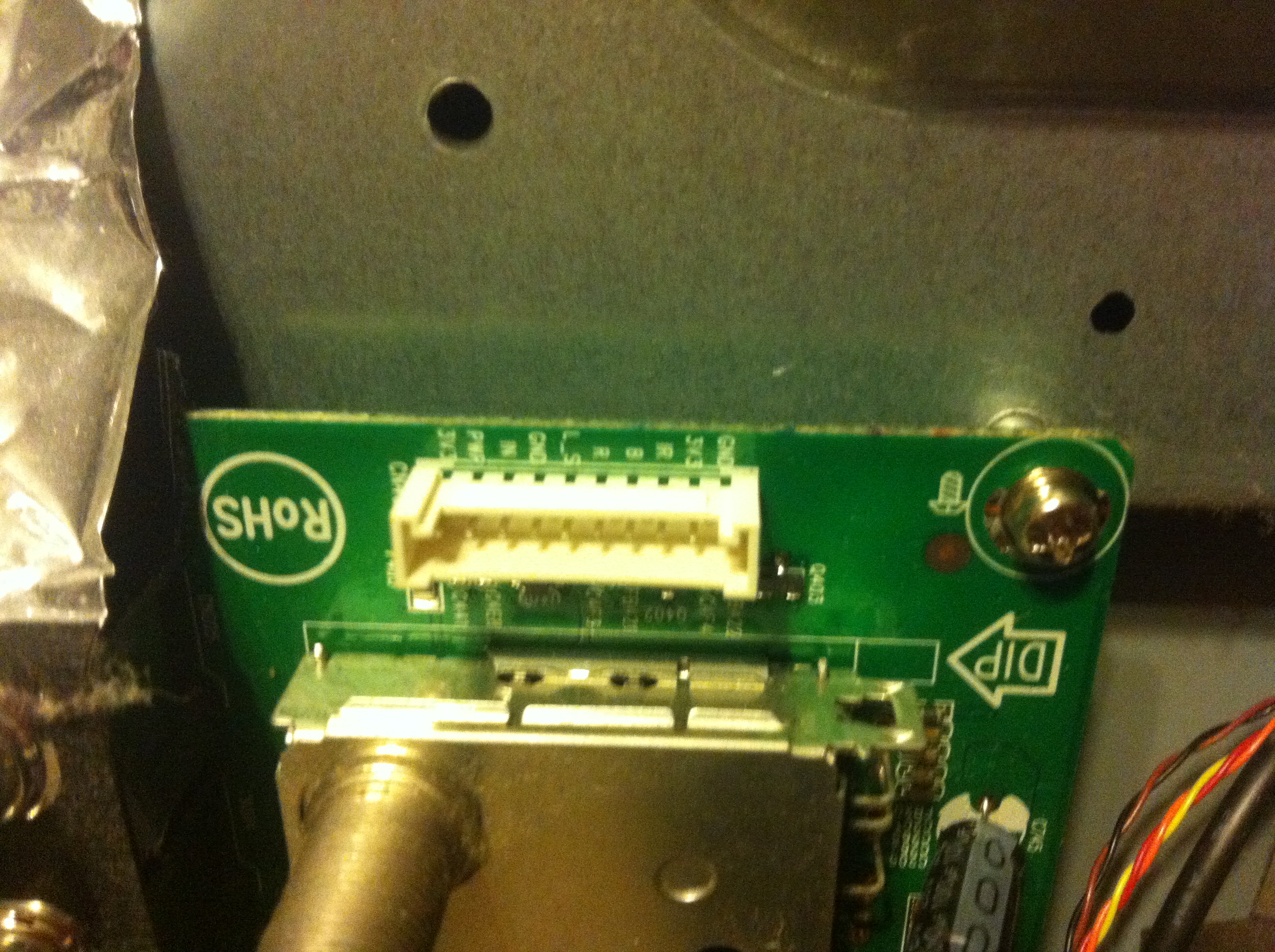

    Plug on main broad near top
    GND:ground
    3v3:3.298
    IR:3.292
    B:590.6mv
    R:2.613v
    L_S:No wire
    GND:ground
    IN:3.297
    PWR:3.295
    3v3:No wire.

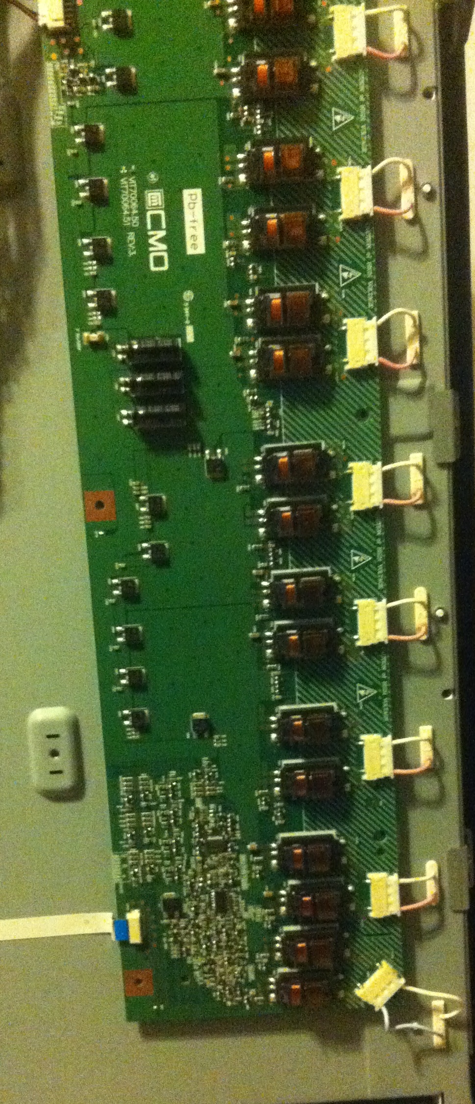

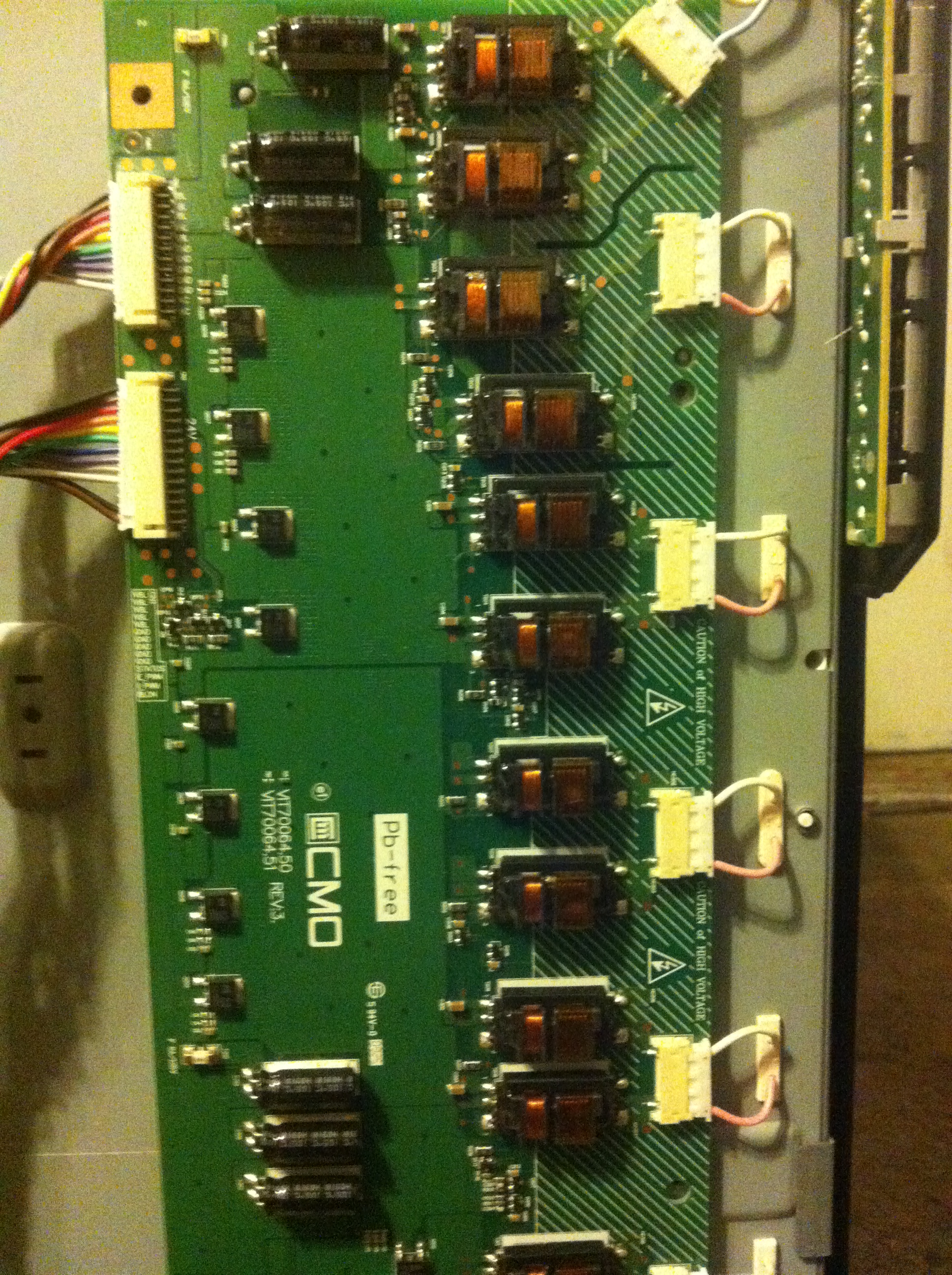

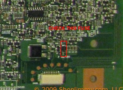

      Inverter boards: Check the small black fuse.
      Also check all the white fuses.
      • empire1138
        • Mar 2014
        • 14
        Re: INSIGNIA NS-L47Q09-10A: No Sound, No Picture

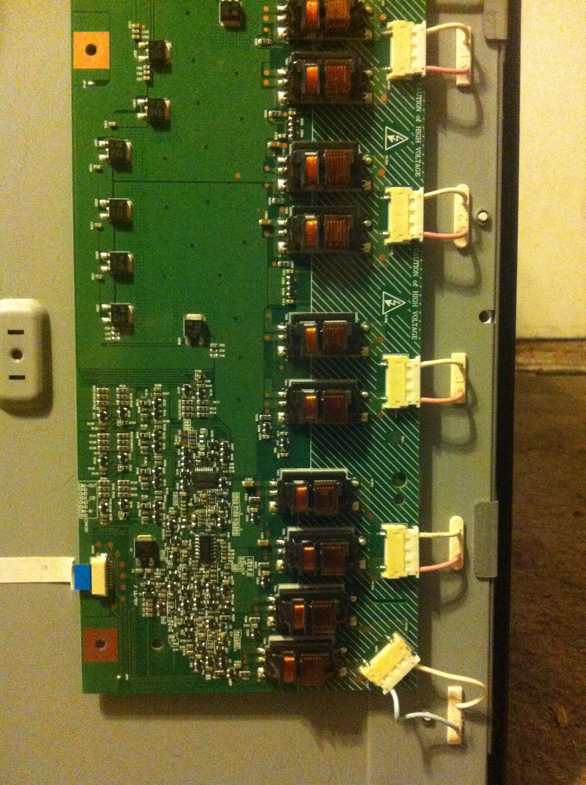

        The two white fuse had both 24.66v on each sized.
        That little black fuse had 24.66v on one sided and on the other sized had 1.391v
          That black fuse is the common failure, I have fixed so many of these CMO boards and they are just bad fuse, I used PICO II fuse (you have to bend the legs to install it) and none of the repairs come back.
          You can jump it for testing (or use 1~4.7 Ohm 1/4W resistor), the circuit draws <0.5A.
            Ok. I will try this and update back later. Thank you.
            • empire1138
              • Mar 2014
              • 14
              Thank you. That was it. I was able to pull another smt fuse from another screen(broken panel) to put on this screen.
                So it works now?
                • empire1138
                  • Mar 2014
                  • 14
                  Yes. Works Fine. I was able to watch Netflix and youtube on it. Thanks again.
