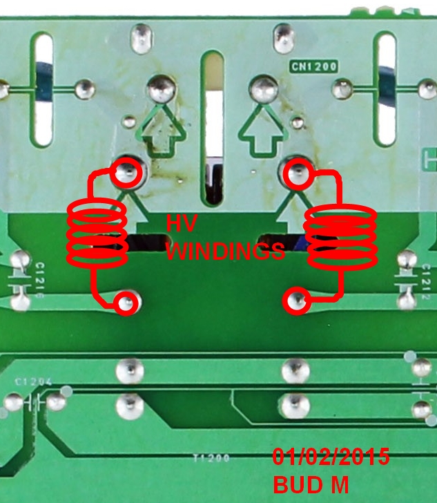

    I have a BA01F4f0103 and the inverter transformers run about 4.75 mohm give or take but there is one that measures 4.55 mohm. Would that be a red flag? What is the percent over the others that would make it unacceptable? Thanks a lot. Blinking green light with voltage ( 65volts ) to the inverter.

    "4.75 mohm" 4.75 milli-Ohms? Please clarify.
    Primary or secondary winding?

      4.75 Megaohms, secondary. Sorry
        Re: Sylvania LC-320SL1 - Inverter question
        That will be way too high, they are usually around 500~2500 Ohms range depends on the transformer, not in Mega range.
        Are you sure you are reading at the correct pins?
        "voltage ( 65volts ) to the inverter." Are you talking about the Voltage on that white power connector?
        That white connector is the DC input for receiving about 160VDC from the main power supply board feeding this board.

          The Lines coming from the filter on the main board. Not directly but in that area. I get no power from the white flat ribbon connector. I suspect the voltage is being terminated for some reason. I am reading the 2 pins on the transformer close to the bulb connector.
            Pictures of the whole back side so I can see how all the boards are connected?
              The inverter transformers have dual HV windings.

                Here is the back side.
                  See post 7.
                  I found that pix on SJ site.
                  I am still trying to understand how you get 65V to the inverter, how do you measure it and what is the Ground ref you were using and at the exact test points?

                      The windings measurements ( secondary ) per your terminals are :
                      T1050
                      • .536k
                      • .534k
                      T1100
                      • .541k
                      • .538k
                      T1150
                      • .541k
                      • .529k
                      T1200
                      • .529k
                      • .530k
                      Looks like the inverters is not my answer. Looking like a bad main I believe.
