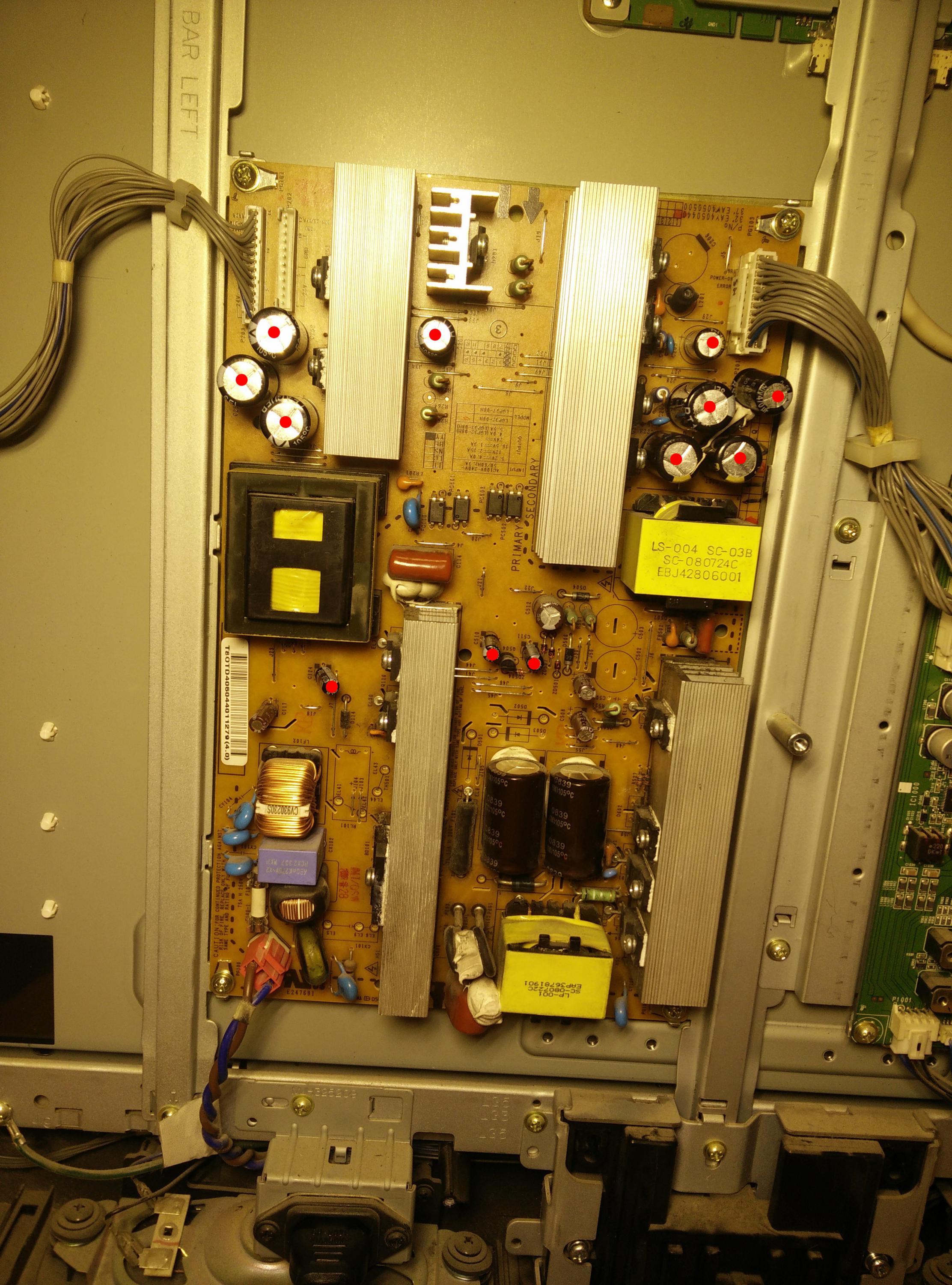

    I have a 32LG2000 that turns on sometimes and sometimes doesn't. It was maybe 1 time out of 10 about a week ago. (tv was warm) Now I turned it on and it has been 5/5 acting nicely. I think it might turn on better when it is cold, but when it gets warm, it has problems.
    I have changed a lot of caps, but the problem is still there. On picture I marked the caps with red dot that are new. I also changed caps inside inverter.
    When the tv did that: Blinked 3 times, then the light turns green and it should be on. I measured then voltages from power supply and there was no 16,5V, but when it was working fine, then there was 16,5V on that line.

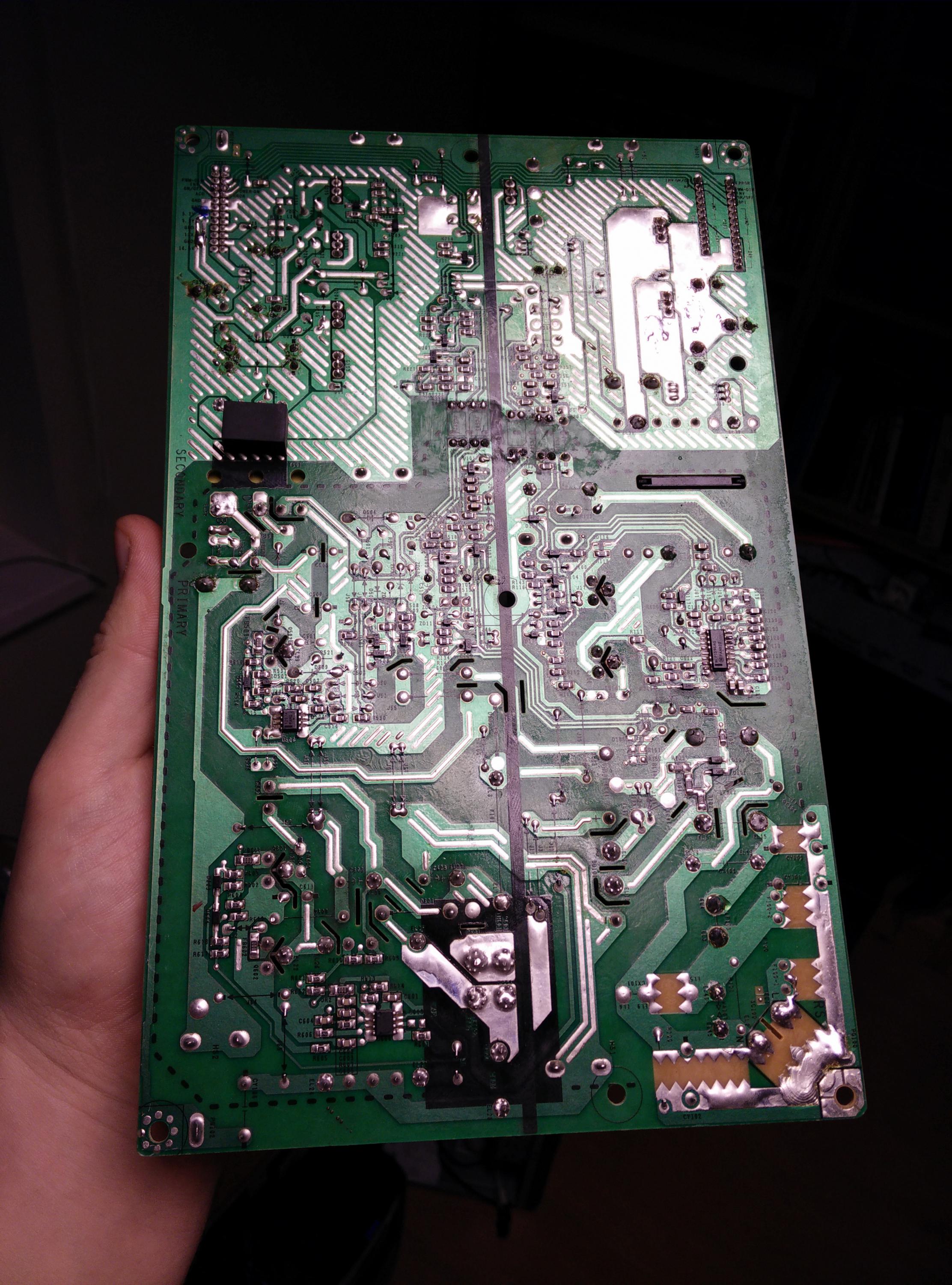

                            Just tested that, only 5V is present. 24V and 16,5V are missing.
                            I did a picture under light, hope it is ok.
                              Re: 32LG2000 wouldn't turn on
                              The picture has to be straight shot, I cannot trace the connection form that picture.
                              We need to look in that 16v/24v SMPS section.
                              You can take straight pictures of the whole board and then in 1/4 sections which will make it much easier for me to trace out the circuits.
                              For example of sectional shots:
                              http://s807.photobucket.com/user/bud...?sort=3&page=1
                                I did bigger pics:
                                http://s254.photobucket.com/user/Kaa...?sort=3&page=1
                                  I changed the NCP1396AG, nothing changed.
