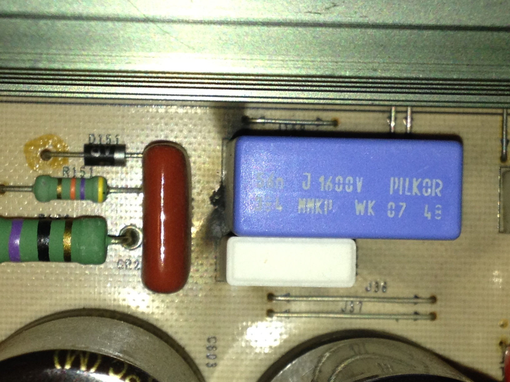

    You were right MAGIC..

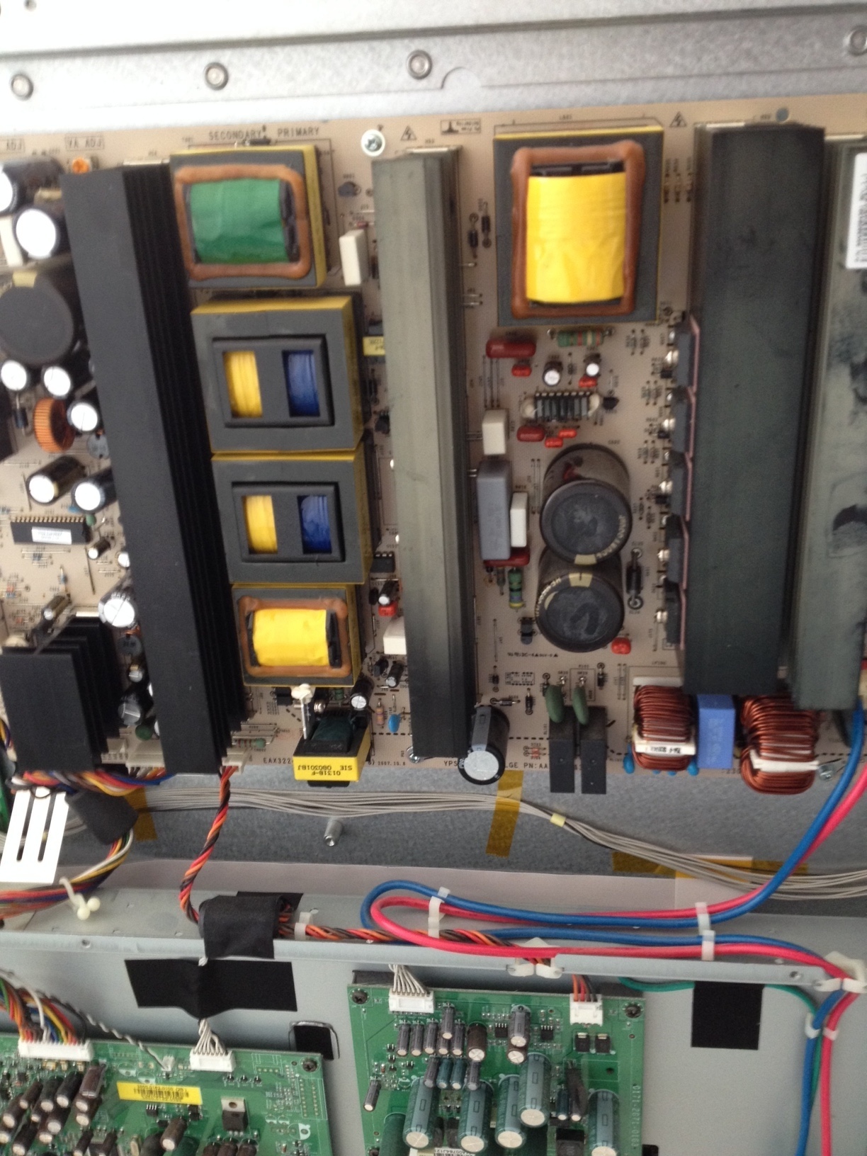

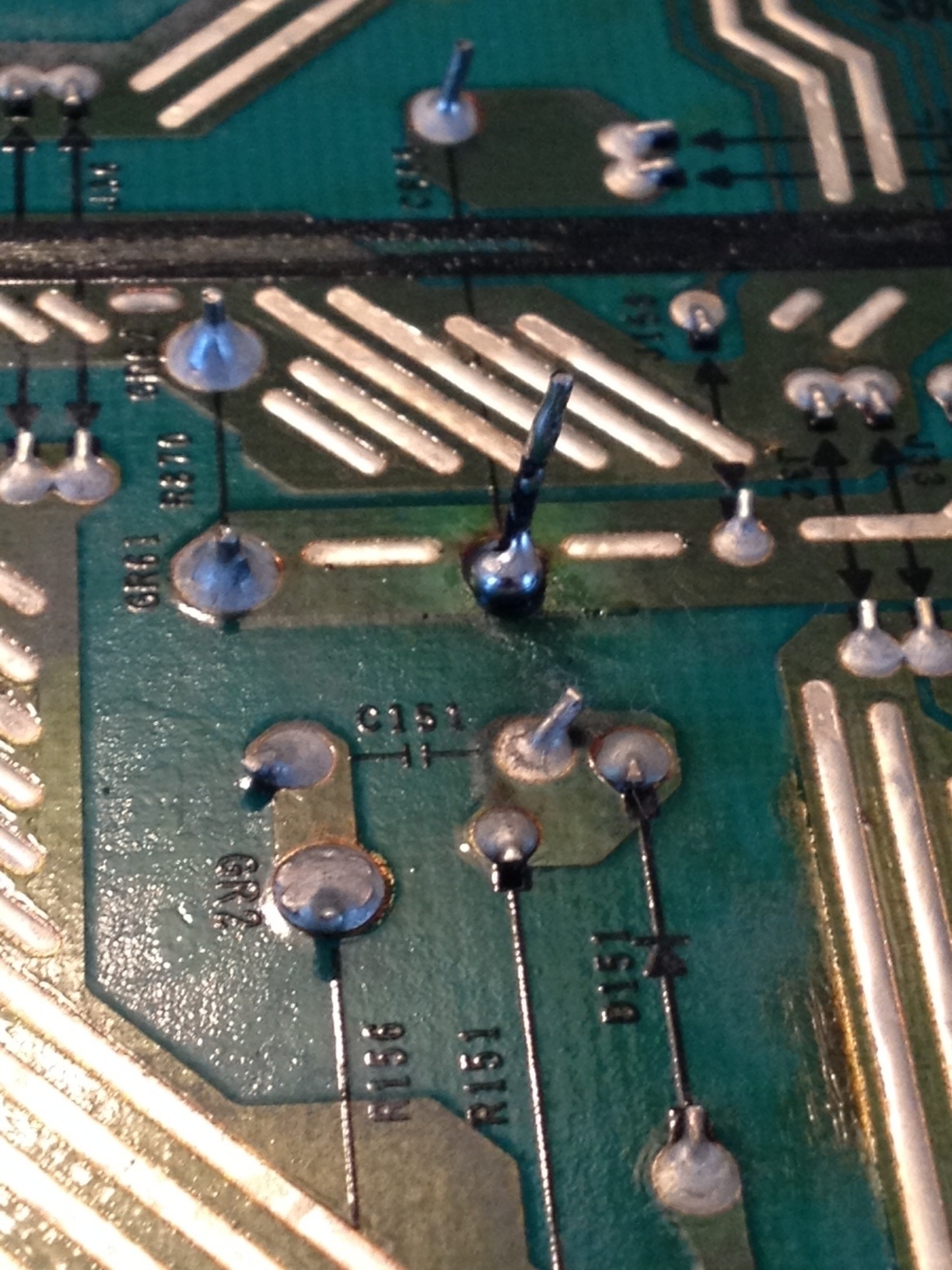

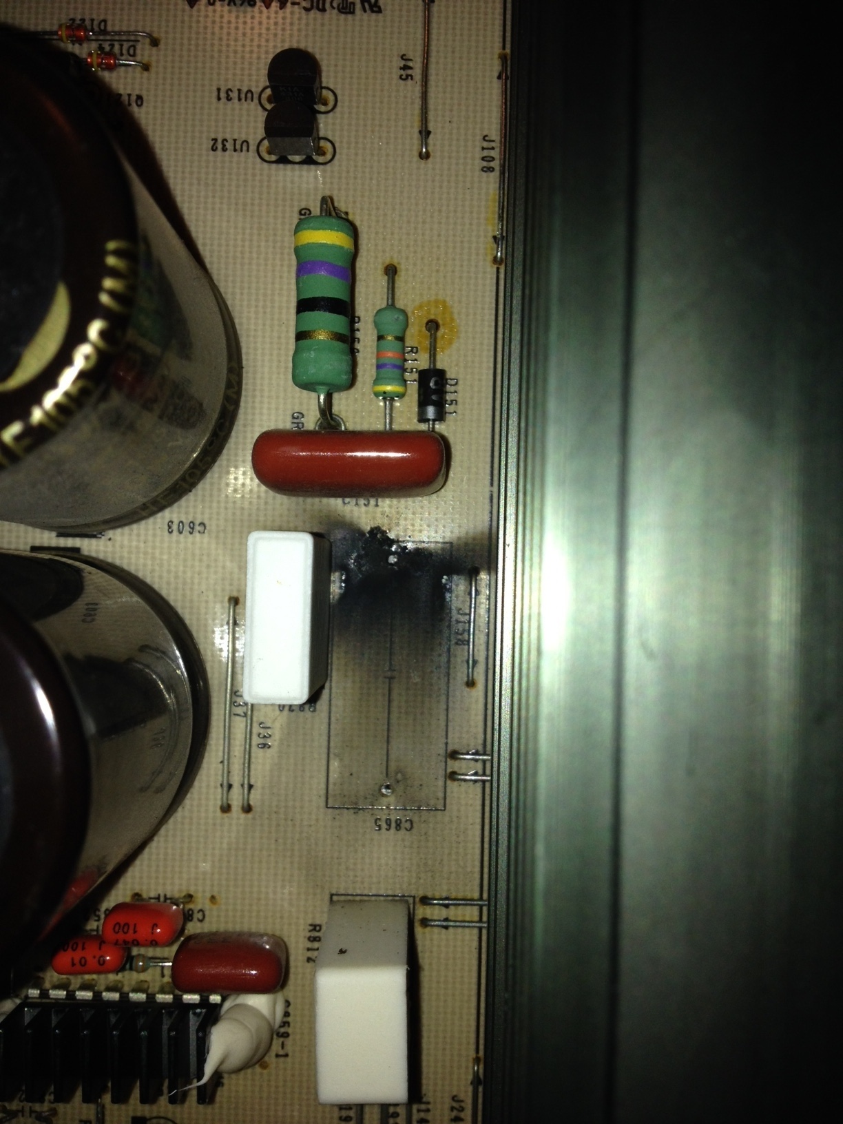

    Not sure why that pin is getting so hot but it melted the new solder and then the pin (lead) pushed itself out of the capacitor.
    I am having trouble finding the replacement on the net. Is one brand better than another or should I look for OEM replacement and use PILKON?
    Attached top view of the burn and the bottom.
    Steps for repair?
    1.) Remove bad capacitor - Find replacement (where to purchase?)
    2.) Clean board in damaged area with alcohol swabs
    3.) Solder new capacitor in place - (Is there a certain grade solder to use that can withstand this residual heat?)

      Re: Vizio JV50p - Turns on then clicks off - No audio or picture
      you got it! use flux too. try Digikey or Mouser for parts. Silver Solder has a higher melting point than the regular stuff, if you wish to use it. make sure all the black stuff is GONE!
        Thanks CapLeaker..

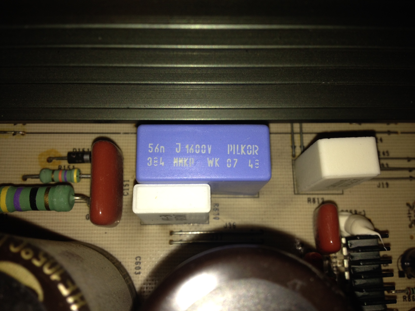

        I see the 1600v but not sure on all the other stuff? Do I search for mmkv 384 or 56n?
          Seems to be a hard cap to find. Both Mouser and Digikey did not have and would be back ordered 7+ weeks.
          ordered - http://www.digikey.com/product-searc...88?k=BC2000-ND
          Just in case someone else out there needs the same part. Only difference is the lead spacing is 22.5mm on Pilkor and these are 27.5mm. I will have to bend each lead in slightly in order to fit. Keep you posted..

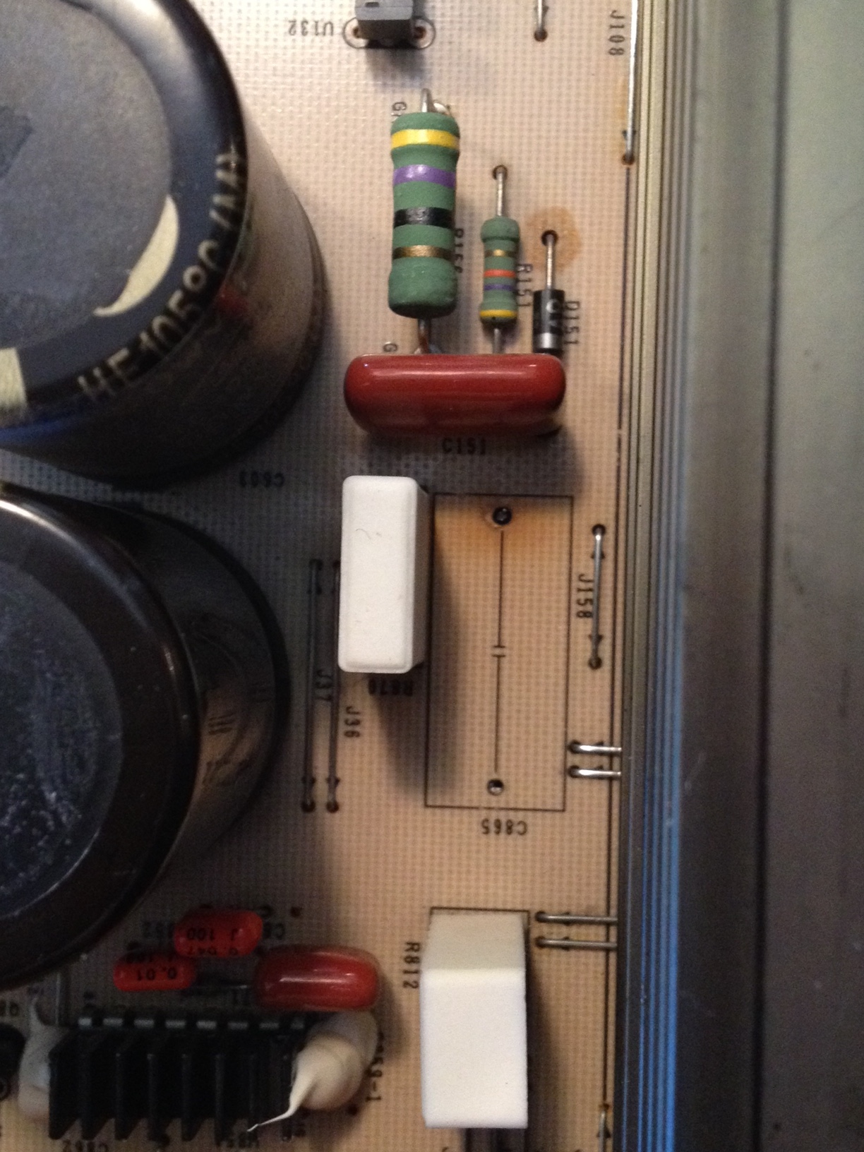

            Got the new part finally. I had to first clean the board and have attached the before and after pictures.

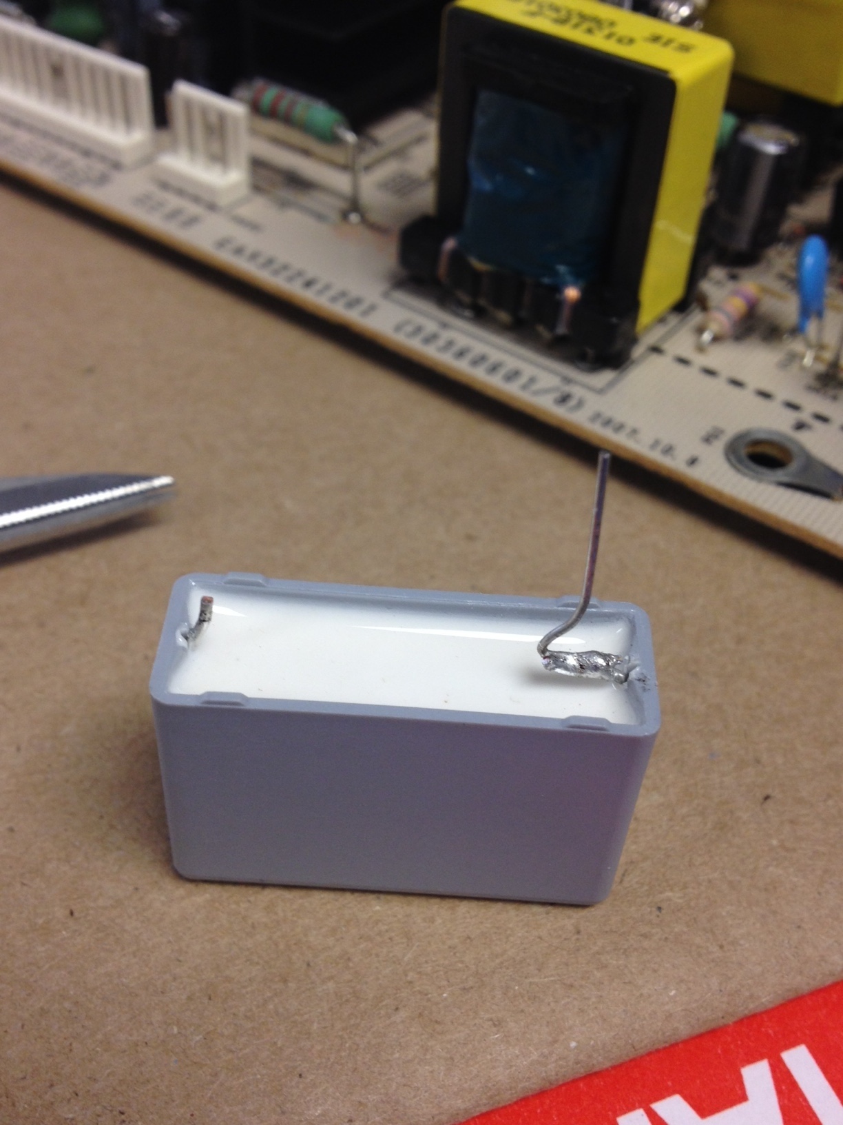

              I was suprised when I opened the new Capacitor from the package. The leads were very small and I knew it would not fit so I had to get a little creative. I am not sure if this is the correct method but was worth a shot sincce the OEM part is 8 weeks back ordered. I took the lead clippings from one of the new caps 3300uf and soldered it to the lead as an extension so I could make the new cap fit into the board. Please give me some advice if this was the wrong method in the event I come across this again in the future.

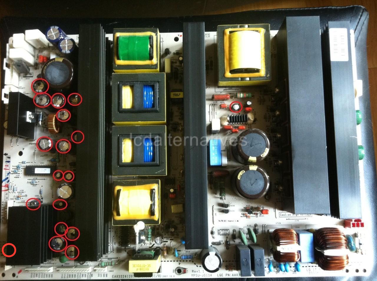

                    I have replaced several caps (annotated in the attachment), when I plug the ac cord in, it seems like both relays are clicking at the same time. All voltages are good except Vs about 2V and Va around 0.7v.
                    Which caps should I look at now - if any? Is there another component I should be looking at? I have pulled both relays, tested them the reinstalled.
                    Thanks for the help!
