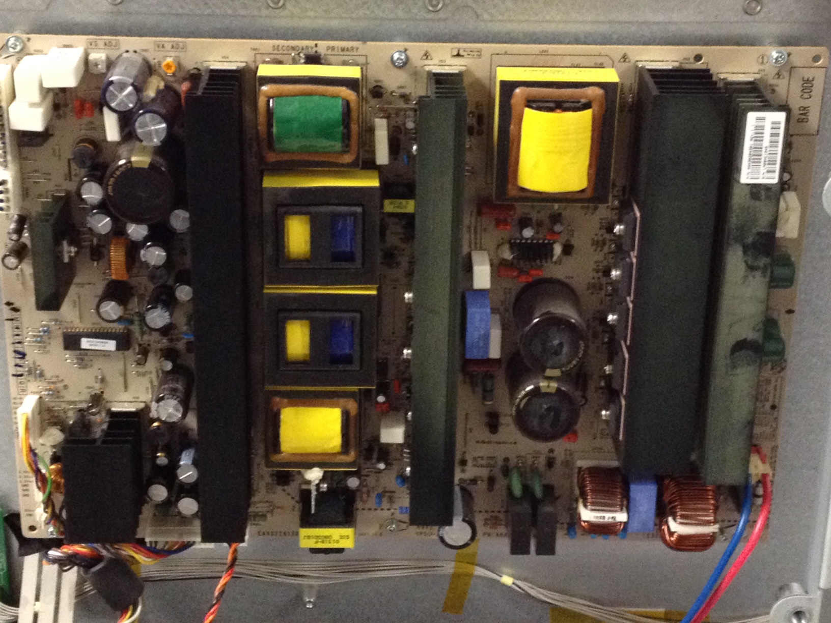

    can you post some good clear pics. of each board and one of how they all connect together?, you know what they say, a pic. is worth a thousand words. careful when working with power supply HIGH VOLTAGE on primary side.

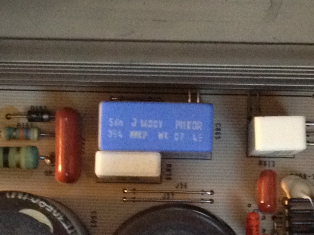

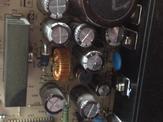

      Re: Vizio JV50p - Turns on then clicks off - No audio or picture

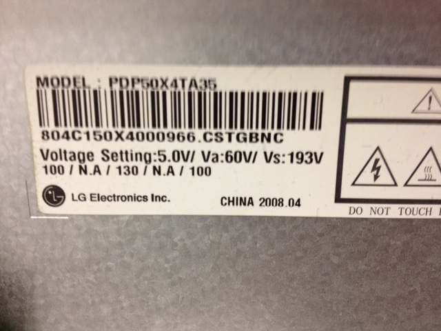

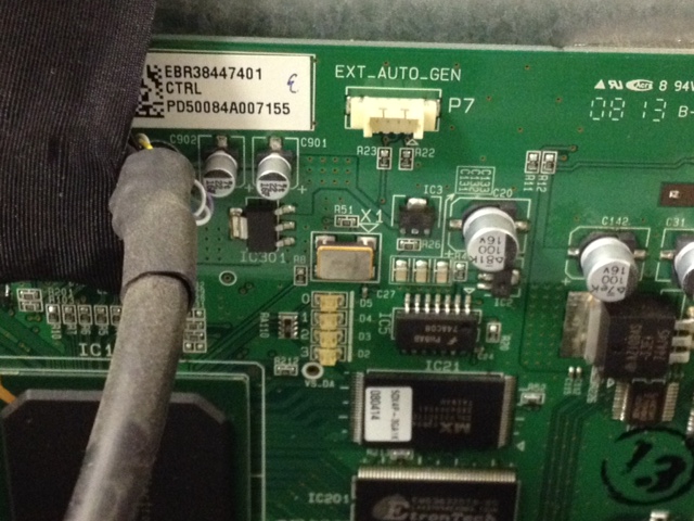

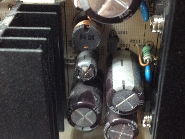

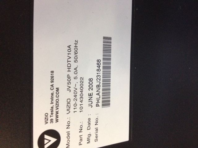

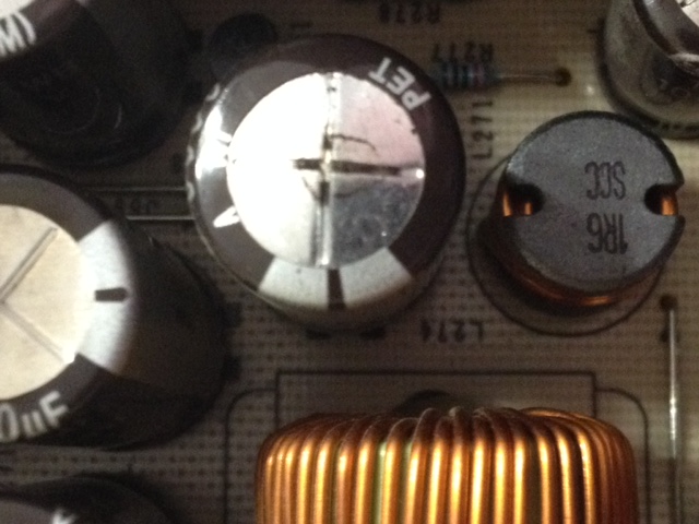

      Here is some pics..
        Let me know if you need more detailed pics. I show the BAD CAPS I replaced and the overall pic from the back view.
        The picture named "LIGHT" - This card has 4 lights on it named D5, D4, D3, D2
        When the system tried to power on they light up for a couple seconds on everything except for D2.
                When you say replaced all caps, how many were in the kit? That PSU looks a lot like mine in a Vizio I have w/ LG panel and boards.
                If the P/N is AAX30284301 Then there are about 25 caps to replace. That's not counting the ones over 100 volts.
                Its the very small ones that can keep it from powering on.
                Edit... If that is the same p/n PSU as mine I can help you test which voltages are supposed to be present when only plugged in and not turned on. And where they are supposed to be tested from.

                            Be VERY careful when probing test points. Some of the voltages on the board can kill. Also don't slip and short something out. (don't ask)
                            Alright, first test... disconnect cables at CN805 & 806, these power the Y board, leave or reconnect the other 4 cables to mainboard and switch assy.
                            Set meter for 20v, plug in AC cord. PSU will make one loud click within 5 seconds, it will then click again within 10-15 seconds. It will now be in STBY mode. LED on frt of tv should be on, (unsure of color, mine turns orange in STBY).
                            If yours does not click twice then there might be other caps to replace.
                            If it clicks twice then check w ground on chassis, red to 5vsb on connector P800 should be a brown wire. Needs to read at least 4.8v to 5.2v.
                            Next go to connector CN805 and check bottom 2 pins for 5vctl.
                            Then check CN 807 towards the bottom left on the top 3 pins for 3.3vsc.
                            Next on bottom of board connectors CN 802 should have 24v.
                            CN 803 should have 5v and 12v and CN 804 should have 9v.
                            ALL of these readings are before trying to turn on the tv, so no VA or VS yet.

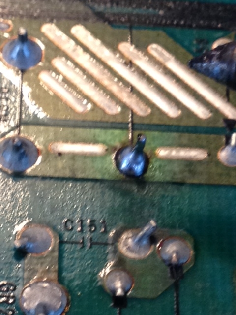

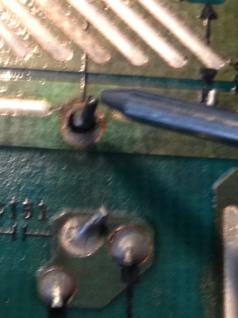

                                    Well, I have fixed my first TV!!
                                    I decided to take a close look at all the connections/solder to see if anything stood out. It didn't take long and right there in front of me was a broken solder for a part that I had not worked on. I was thinking it was the capacitors due to the bad caps and did not check the rest of the components as the bad caps stood out.
                                    It is a learning experience and I am glad I found this forum for the extra guidance.
                                    I have attached a picture of the bad_solder and the fix. I am not sure what the purple component is (maybe a capacitor due C865 label) but that was causing the problem due to open circuit.
                                    Rookie mistake but a great side project to learn a little. Good news is the capacitor kit I used will save me the headache later on as majority of the caps are now new.
                                    Thanks again Magic and Sony for lending a hand.
                                    HAPPY NEW YEAR!

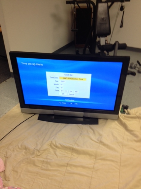

                                      Everything was working fine and I decided to review the menu and make some changes to the picture. There was an option under menu for white reset. I choose this and the screen turned white and could hear a humming sound. It was doing a calibration for white I assumed and it was going on over a minute. I started googling with my phone to see if this was normal time frame when the unit turned off an I can smell burning electrical.
                                      Lol- guess I shouldn't have done that? Will pull apart tomorrow, curious as to what failed now.
                                        Check the area around that cap you re soldered, it looks like that pin was getting hot.
                                        The white screen cleaner pulls the most amps from PSU so weak parts will fail.
