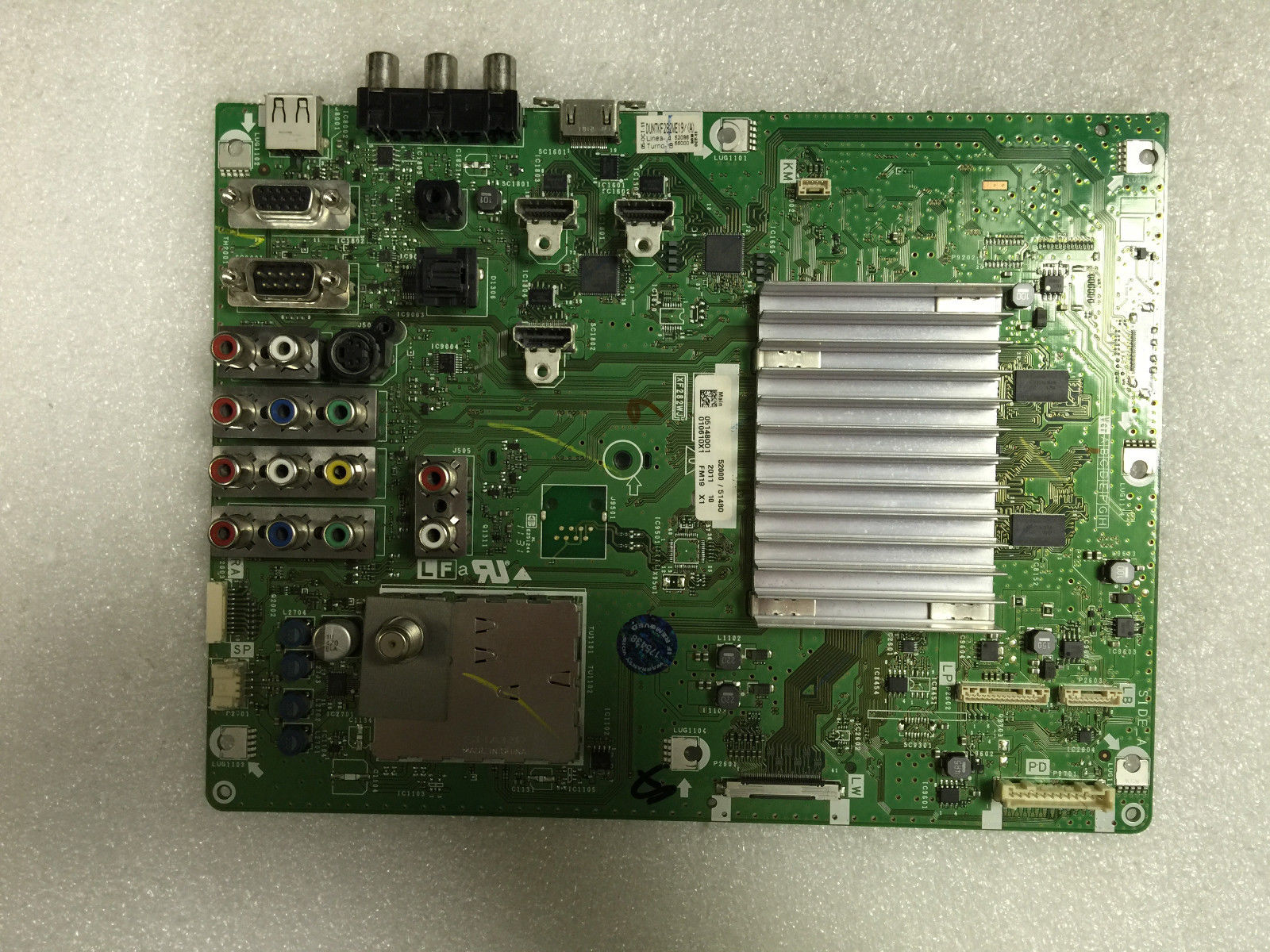

        here is a pic of the main board.....

          Re: SHARP lc60e79u 60 INCH LCD TV NO PICTURE NO SOUND
          correction....i do have sound.....

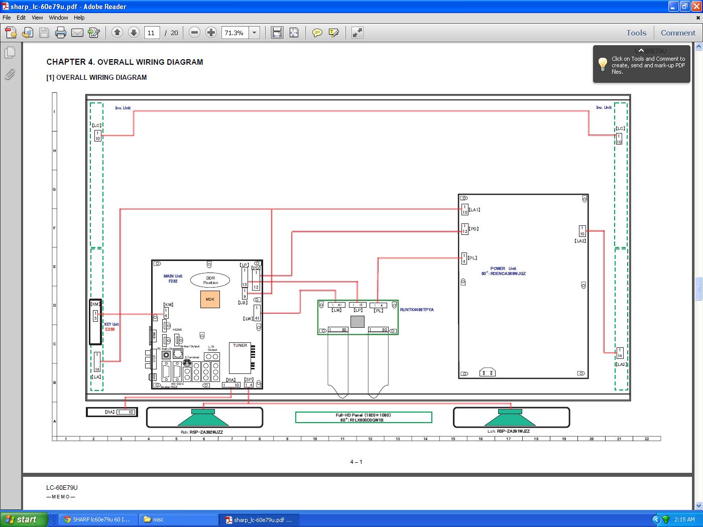

                              here is a pic from serv manual...its a pretty basic serv manual doesnt give much info

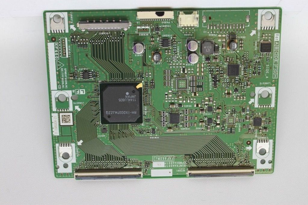

                                and here is a pic of the tcon if you can point out which areas to test for v i can do that
                                  hi budm...i know you are a highly skilled person but im not
                                  im not looking to repair board i would just like to know if this is a tcon issue or main issue so i can buy the correct board...not sure what good it would do by testing test points on the tcon since im only worried about voltages coming in....and not voltages within the tcon right?........can i test for voltage coming from main to tcon? and if there is good v then that means tcon is bad correct?
                                  like i said i do get 12v coming from ps to tcon......

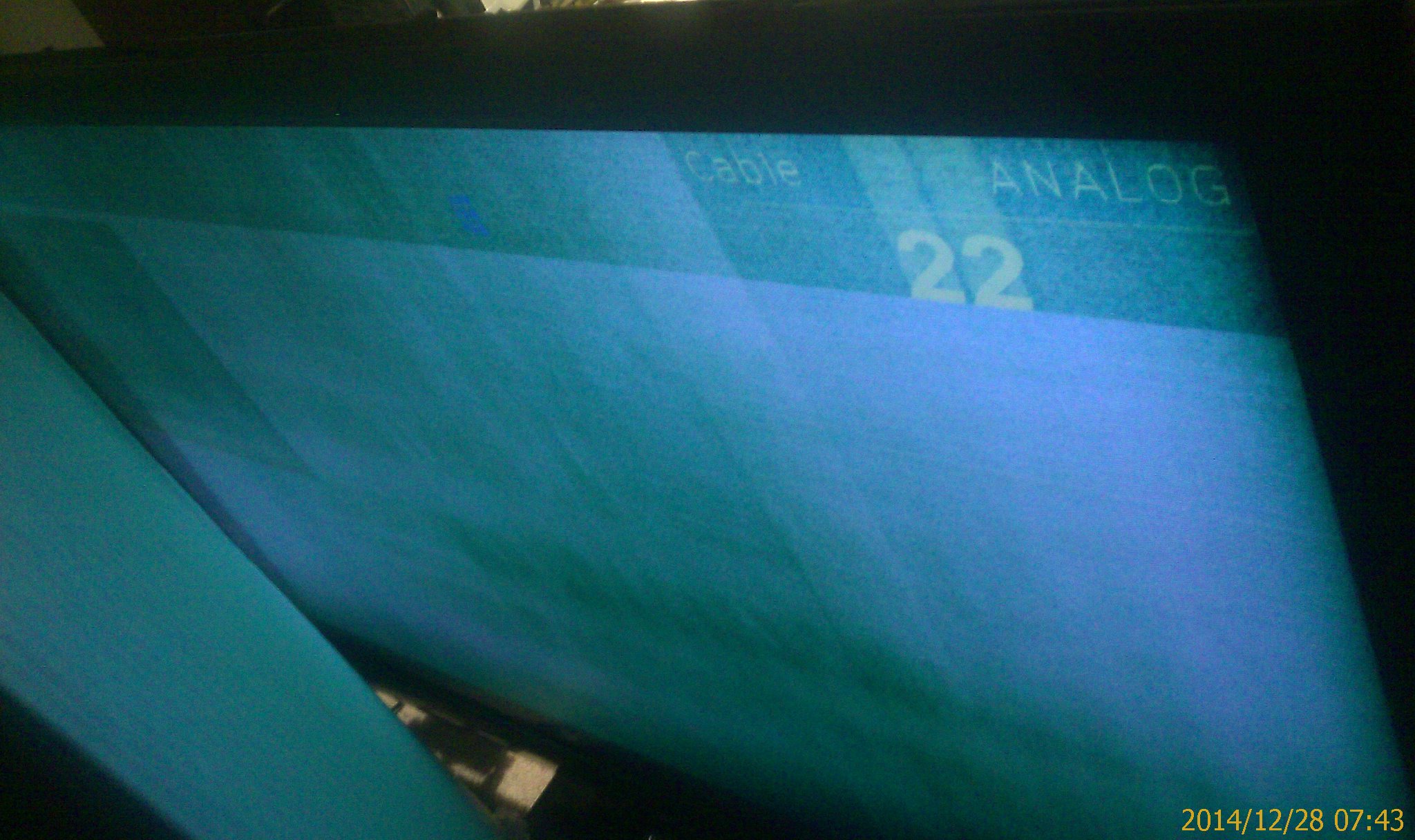

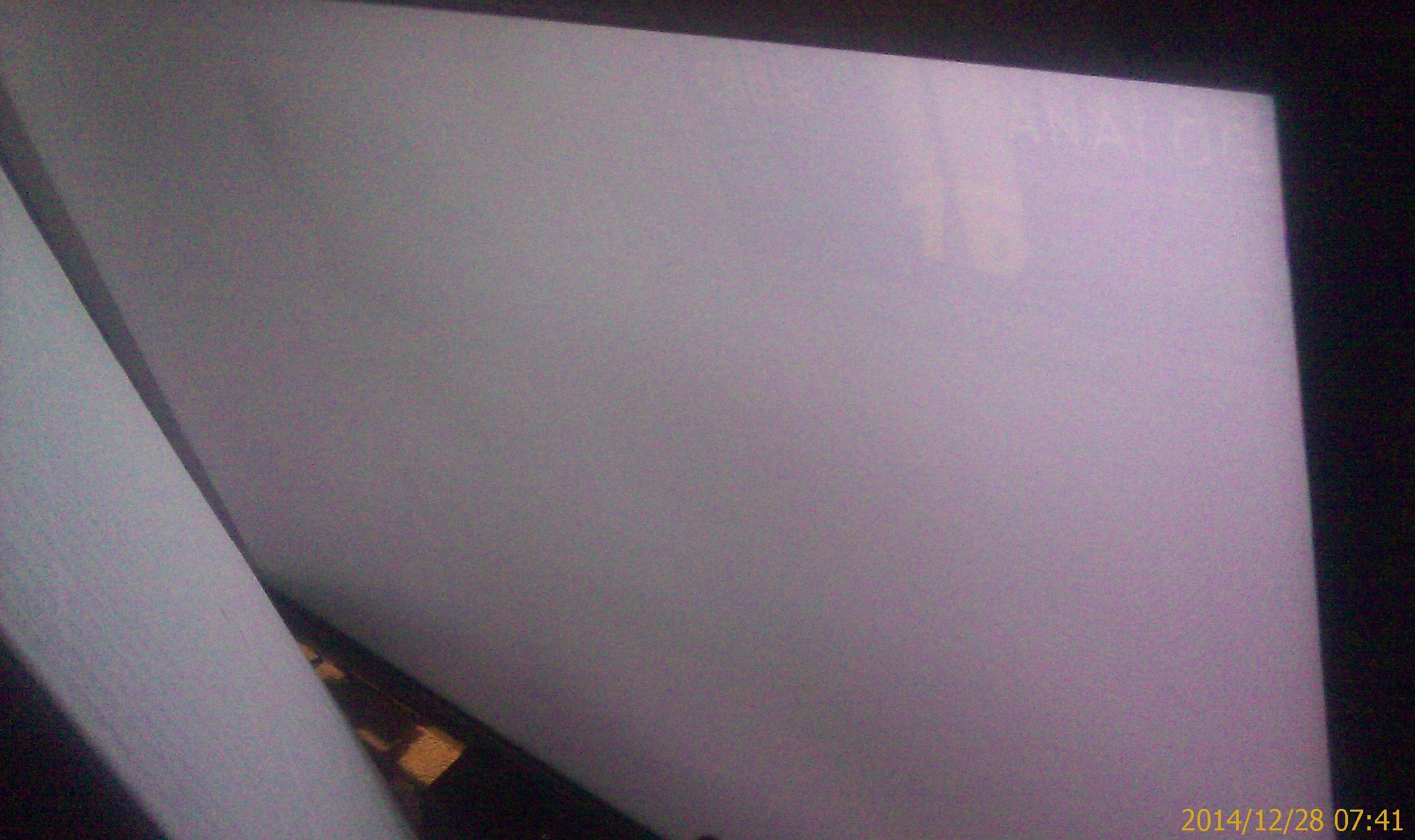

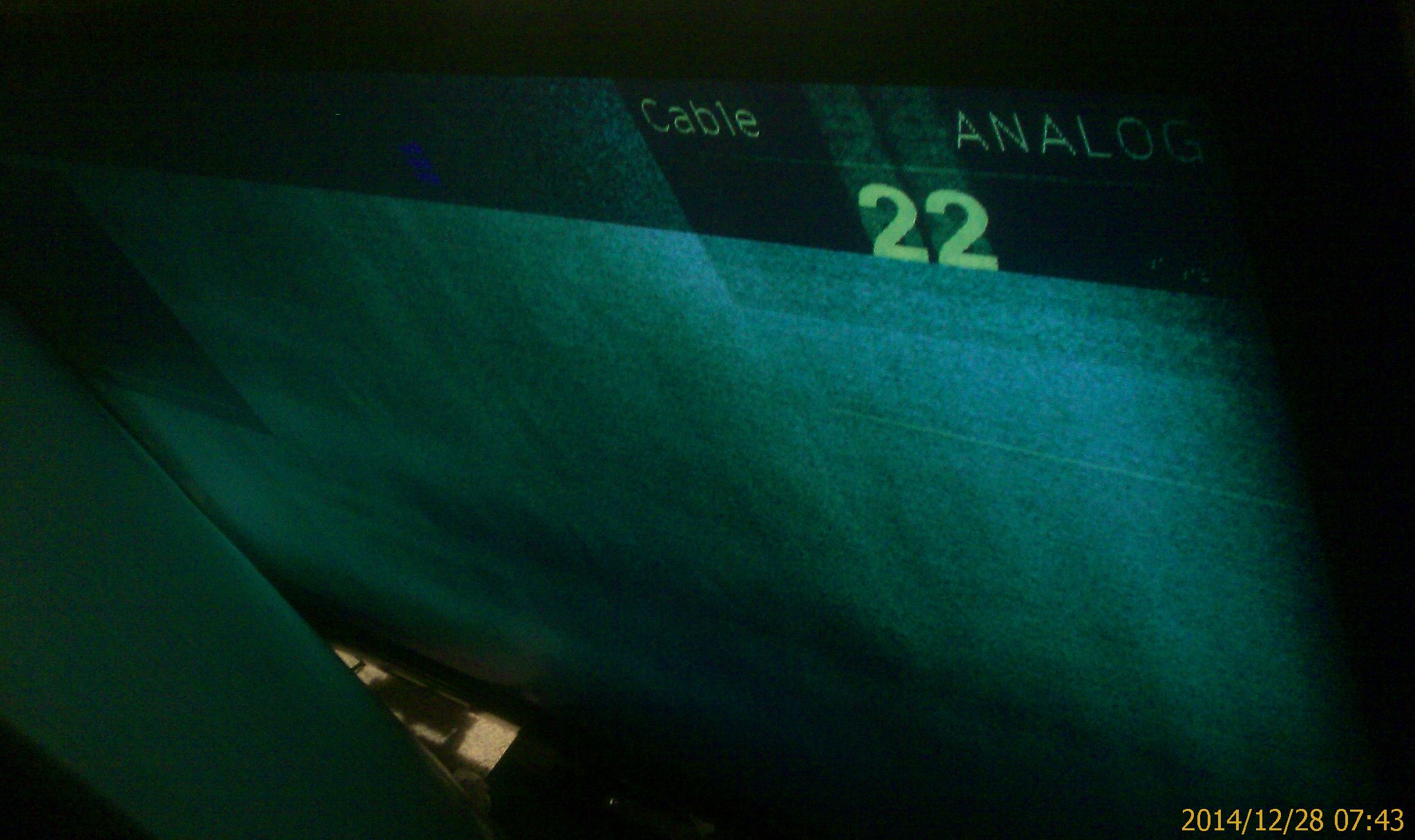

                                      update
                                      not good news i dont think....got the replacement tcon today and installed it and the display does some weird things....it goes from real dark grainy....with very partial display to all white after a couple minutes....it does this with old tcon and new tcon ...i guess i didnt leave tv on long enough to see it do this but it does do this every time....starts out with no display then after about 2-3 minutes it gets a very partial dark grainy washed out pic then slowly goes to all white
                                      i cant imagine this is good at all......
                                      ill try to post some pics
                                      • shelby5041
                                        • Feb 2009
                                        • 1505
                                        • united states of america usa
                                        here are some pics......tvs is crammed in my house hard to get a good angle not much room lol
