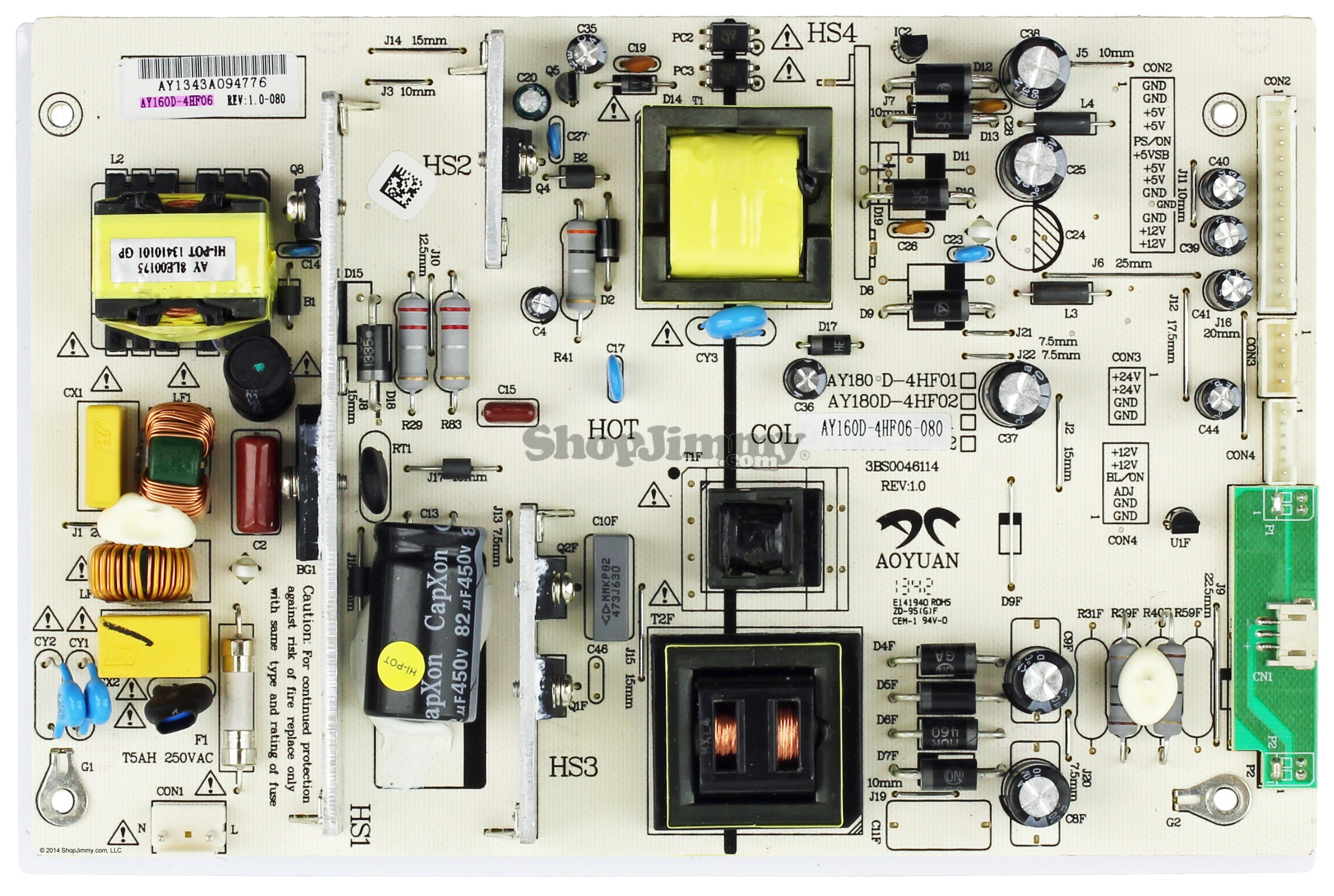

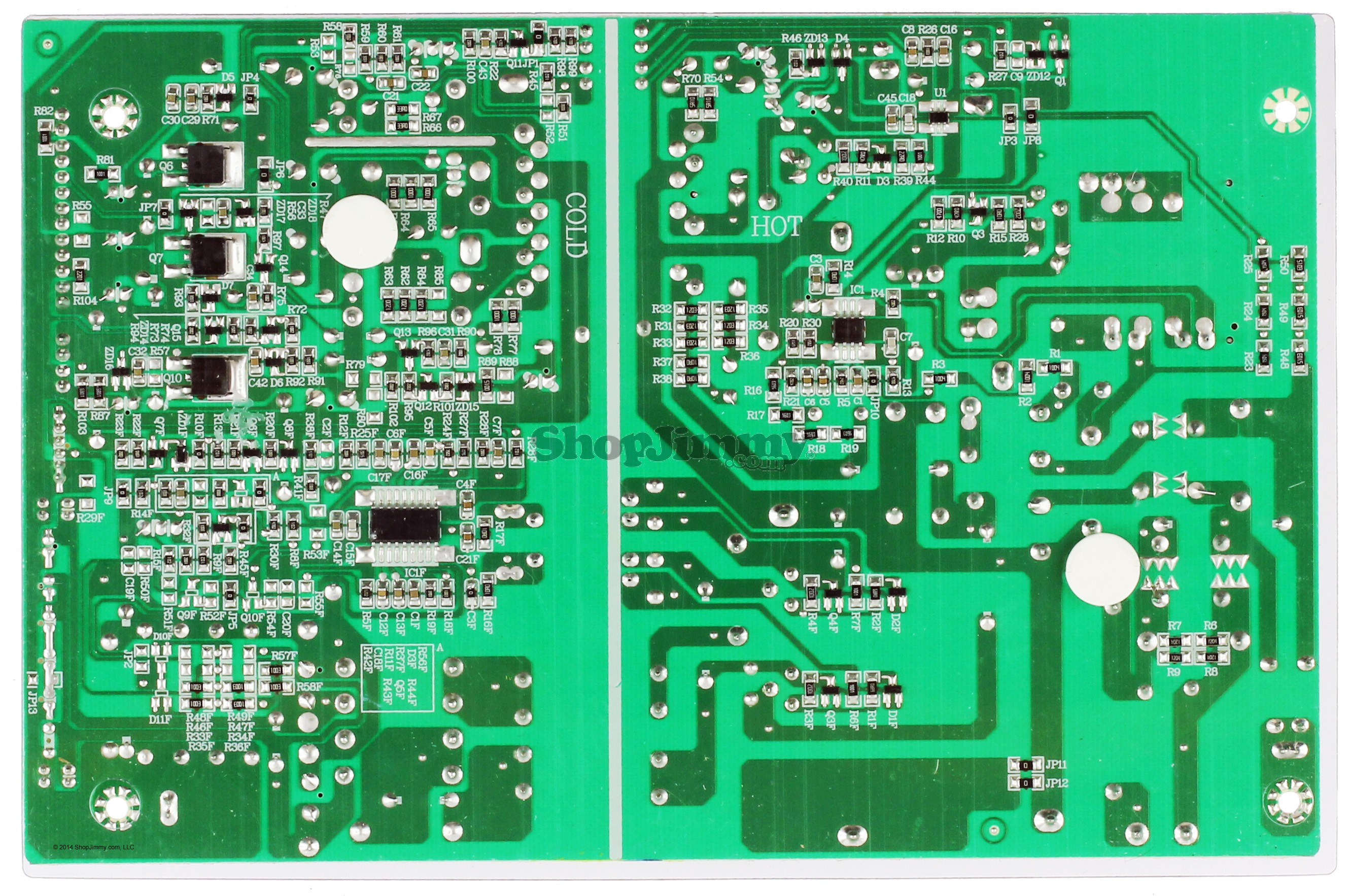

    That is the connector of the LED string.
    What is the DCV rating of C8F, 9F?
    Sceptre AY160D-4HF06 Power Supply for X505BV-FMDR
    http://www.shopjimmy.com/sceptre-ay1...pply-unit.htm#
    Pictures provided by shopjimmy.

      Re: Sceptre X505BV-FMDR
      I have same issue and have no voltage to leds at connector 10. All other voltages are fine. Same issue if I unplug the led connector. I would have to presume bad power supply.

        #63
        Tested the led's and found one open led. Put in 1w 3.3v zener and now up and working. I guess 0v at the led connector does not mean a bad power supply.
