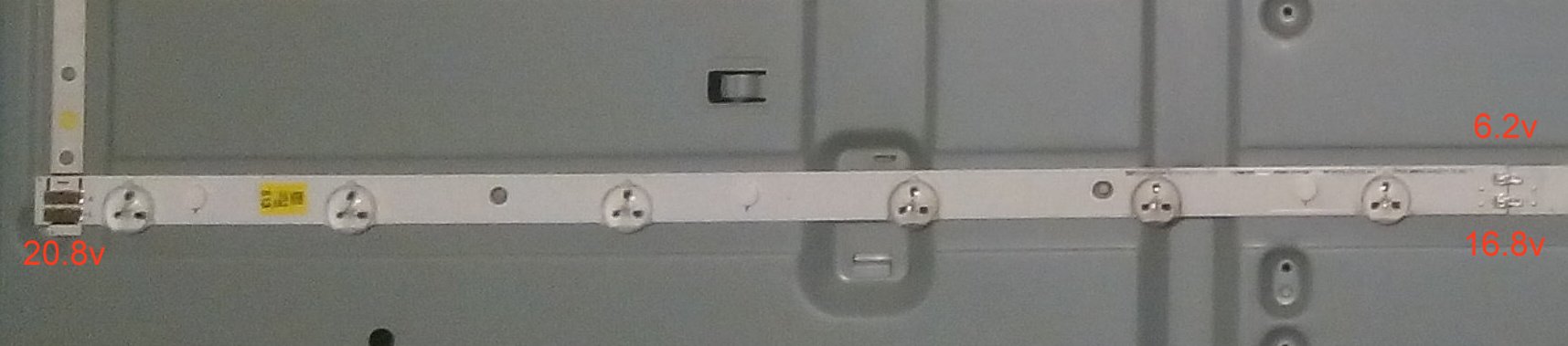

    OK I thought I would try something else...
    When I put 20.8V at the "front" of the LED strip, I get 6.2V at the midpoint of a whole strip..
    When I put 20.8V at the "front" of the LED strip that has been pulled from the array, I get 16.8V at the other end..
    Not sure if that means anything, but.....

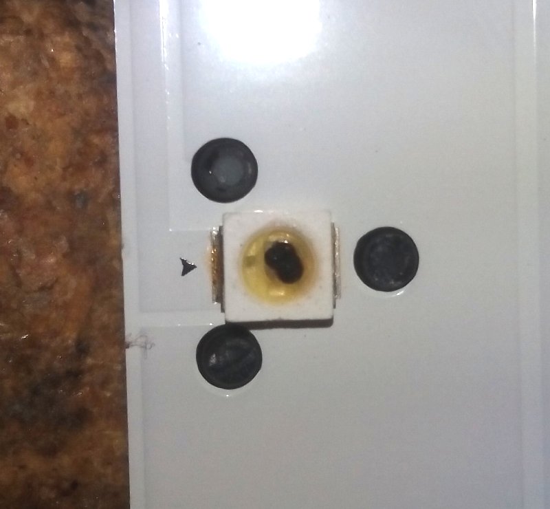

            #45
            Re: Samsung UN46EH6000 LED ERROR Codes
            DING!!! DING!!!! DING!!!!
            I think I found the problem.
            A big black burn in the middle of one of the LEDs on the right side half-strip that didn't function..
            So, we now why THAT one doesn't work..
            Like I said above, I am going to operate under the assumption that the left side strips are good, I am just missing something on powering them up...
            Replacing one half-strip is going to run me about $25.. Worth it if I only have to replace one..
            Not so much if I have to replace 7...
            Anyways, thanx again... I'll follow up when the replacement comes in..
