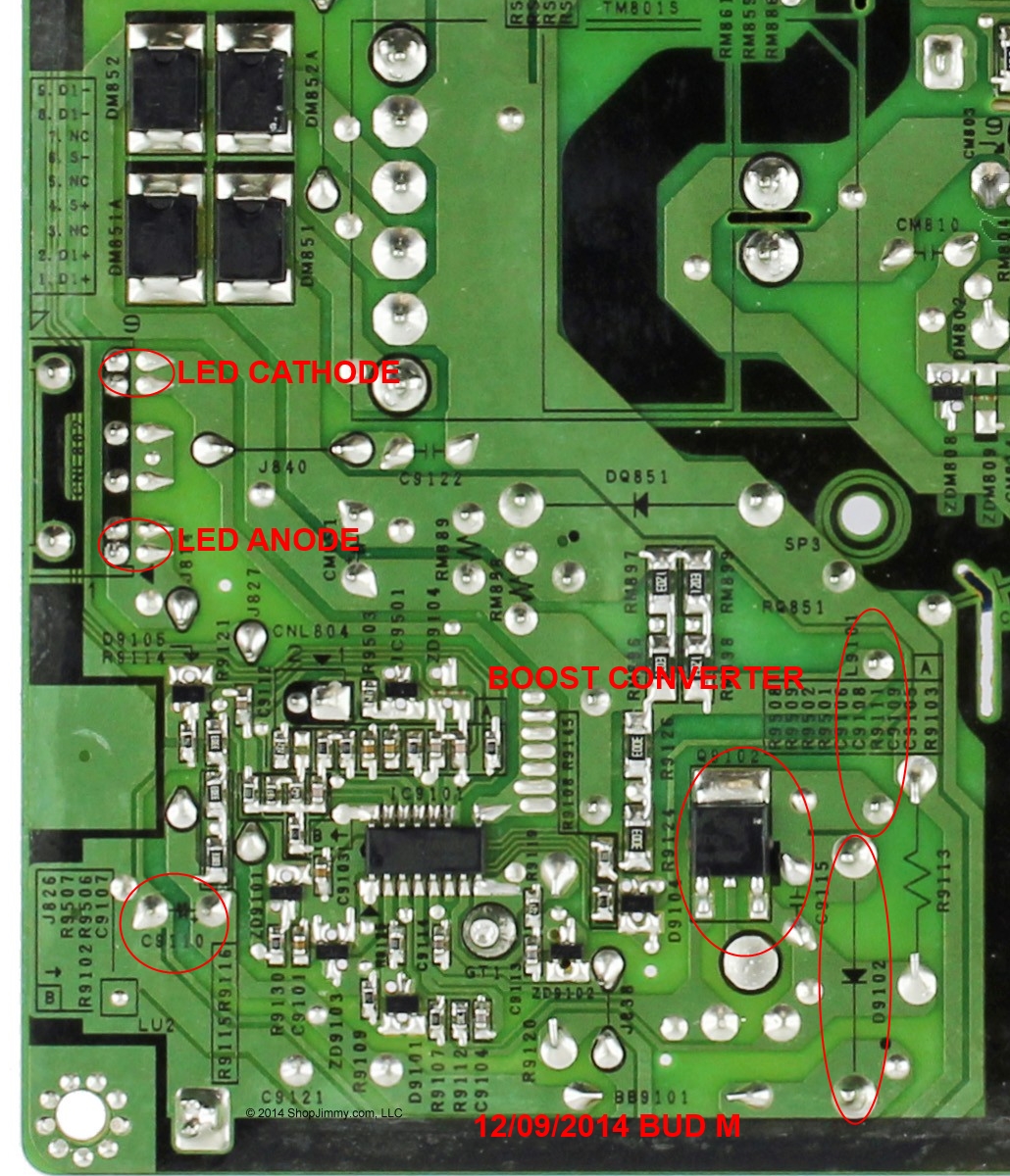

    Looking at the bottom side of the board, I can see that the connector for the LEDs are setup for driving ONE LED string (only has one boost converter circuit, Q9102, D9102, L9101, C9110) so if one LED is open circuit, then you will not see any LED flash on at all.
    You can test each LED using 2 AA batteries connected in series feeding in to 100 Ohm resistor to limit the current to power up each LED.

        See updated post 21 on how to rest each LED. Anode is Positive.

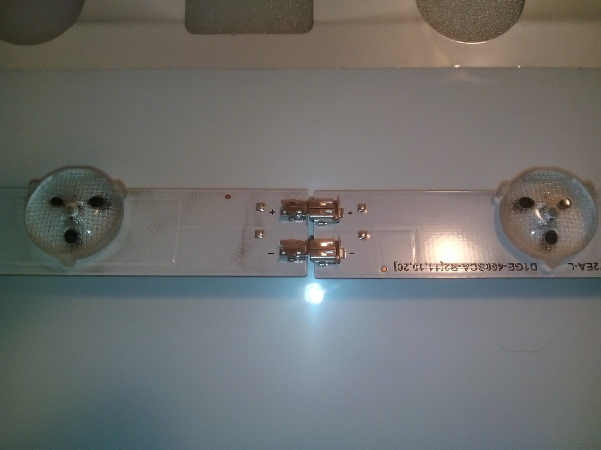

                OK, got the TV disassembled again...
                Got the battery testing device rigged up. It ain't pretty, but it works... 87ohm is the closest resistor I could find here at home..
                Of course, there is a problem..

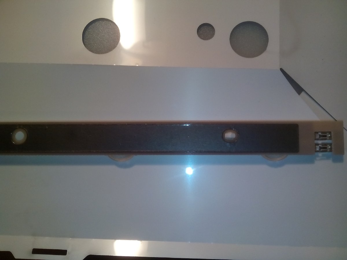

                There doesn't seem to be any way to access the connections of the individual LEDs.. The backing has a cover...
                I see two possibilities...
                Strip the backing off the LEDs and use the connections (if available)....
                Or pump up the juice and test the entire half strip (6 LEDs per) from the half-point connections ...
                I am not knowledgeable enough to know the pros and cons of either course, beyond the obvious....
                Anyone??

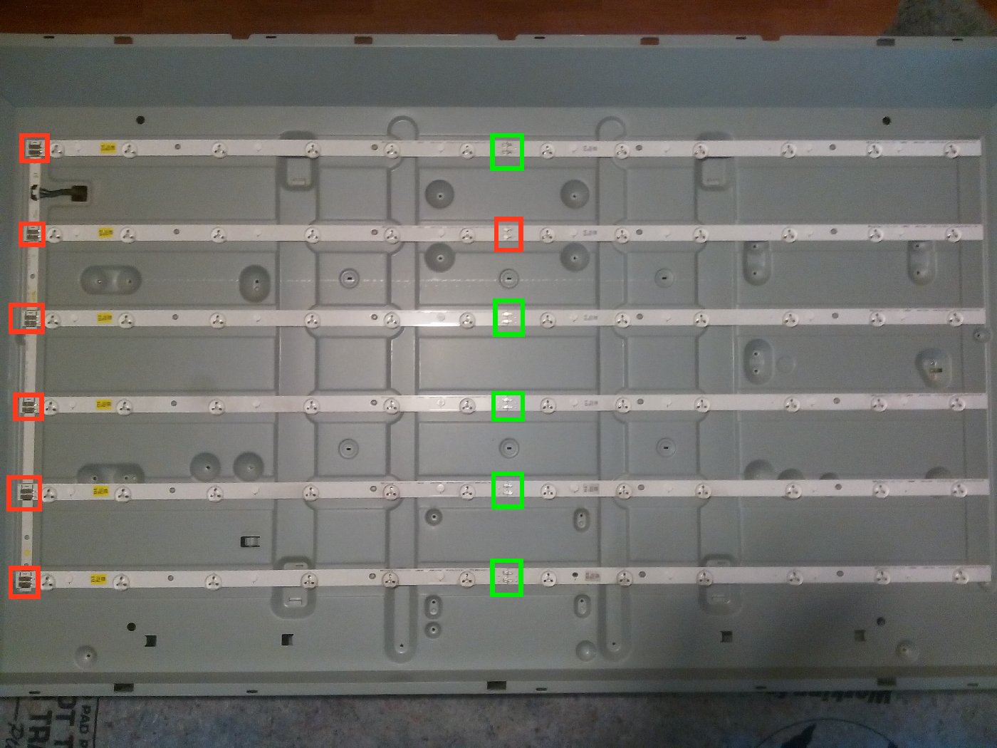

                        OK, found a wall wart that did not blow anything up... It's rated at 12v, but the meter says it was putting out 16v..
                        Referring to the attached pic..
                        I touched the 16v to the points indicated by the boxes...
                        On the Green points, all the LEDs to the RIGHT of the box lit up fine.. The LEDs to the LEFT of the box did not light up...
                        Except for the one red box on the right. No LEDs lit up at all...
                        Touching the 16v on all the boxes on the left.. No LEDs lit up...
                        Apparently, the one strip on the right side is bad.. Just to confirm, I pulled that entire strip off and tested them individually. Still no joy..
                        But I find it hard to believe that all the strips on the left are bad..

                                  Re: Samsung UN46EH6000 LED ERROR Codes
                                  That's good, just need to see them light up, don't want to burn them out.
                                  Is the polarity perhaps reversed for the left strips?
                                  • Michale32086
                                    • Nov 2011
                                    • 1453
                                    #37
                                    According to the labels, there is no inversion. The "upper" track is '-' and the "lower" track is '+' all the way across..
                                    But I just discovered something new...
                                    I get continuity from the left connector to the midpoint connector on the '-' only..
                                    There is no continuity on the '+' connector from the left to the midpoint. No continuity at all...

                                      Since you don't have a current limited power supply you don't want to use a power supply that has more V output than the LED string. You just want to light them up without blowing something up, using something you already have. That 16V power supply is perfect for that. 3.3Vx 6=19.8V
                                      Using the 16V power supply you would still get 2.7V for each LED on the string and it would light up, not full brightness, but who cares... you just want to see them turning on.
                                      Either there is a short or an open on the left side of the LEDs... just where... that's gonna be the fun part to figure out. So far you are doing good, don't worry!

                                          Those plastic LENS for the LEDs are snap in place, you should be able to remove them so you can get to the LED's to test each LED.
