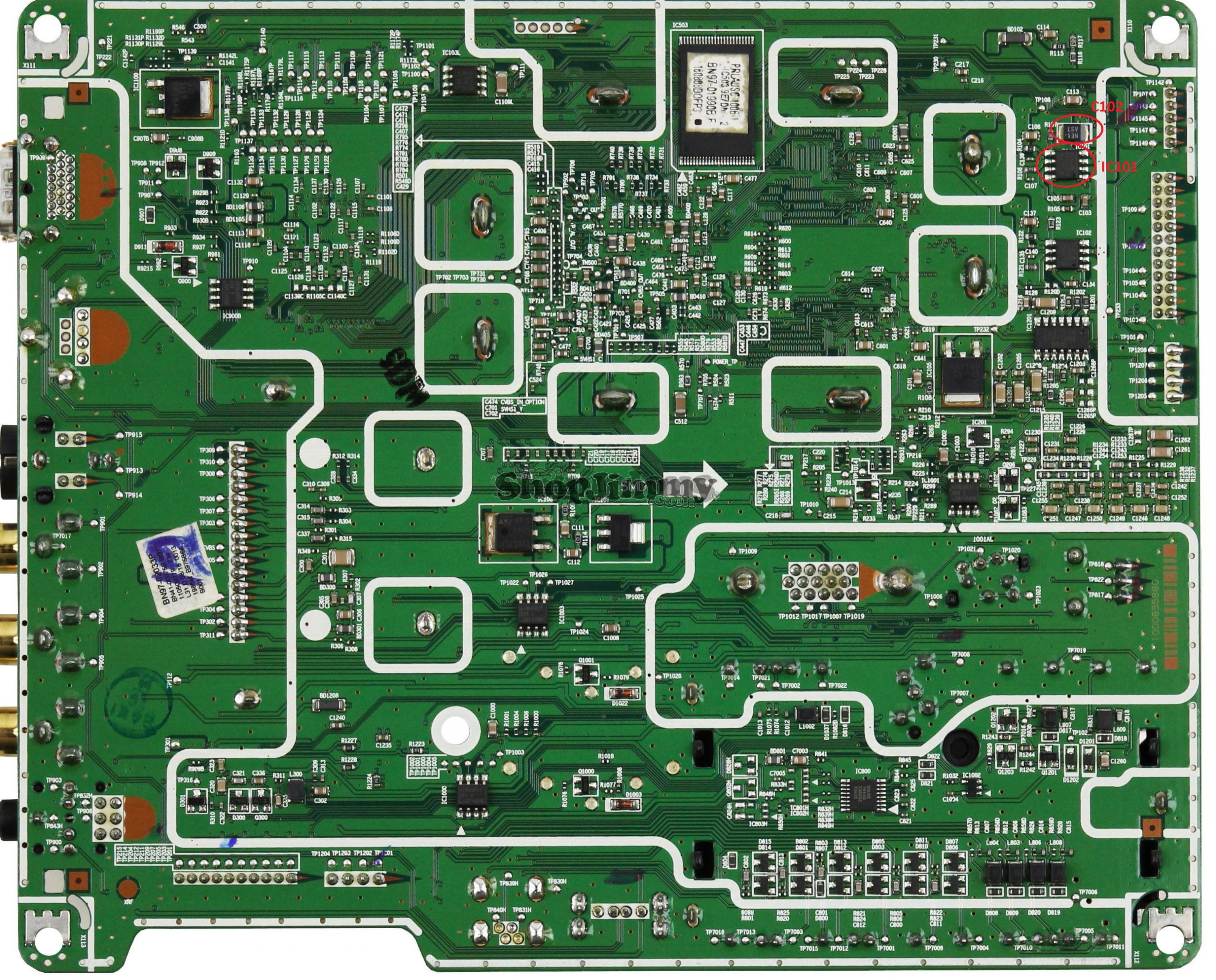

                      Another 'A' series failure.
                      http://www.shopjimmy.com/catalogsear...?q=LN40A530P1F
                        Re: SAMMY LN40A530P1F on the decline

                            The red LED will flash then it should stop nit flashing all the time, it that what it doing?
                            If you go to the link at shopjimmy, you will see this:
                            Symptoms:
                            -TV turns on briefly, has no video on screen then shuts off, comes back on, shuts off, repeat.
                            -Takes 10 – 60 seconds to turn on, stays on for a bit and shuts off, comes back on, shuts off.
                            -Red power LED blinks forever, TV doesn't turn on.
                            Where did you get the main board from? I would not worry about the backlights right now.

                                I just fixed my LN32A550P3FXZA that will not power on with just blinking RED LED or sometime it will make loud squeals through the speakers.
                                I replace the C102 (47uF 10V TONKIN NE AS7 cap) and it is working right now (it has been an hour) and I am burning in to see if that will be it.
                                Pictures provided by SHOPJIMMY.

                                      Sounds like the usual Bordeaux-Plus Mainboard cap issue.....
                                      Green lines crackling/screeching sound...
                                      Two 1000uF 16V SM caps under the tinwork by side of the processor, plus a couple of 100uF by the PSU plug/connector on mainboard--These caps will LOOK Faultless, just change 'em.
