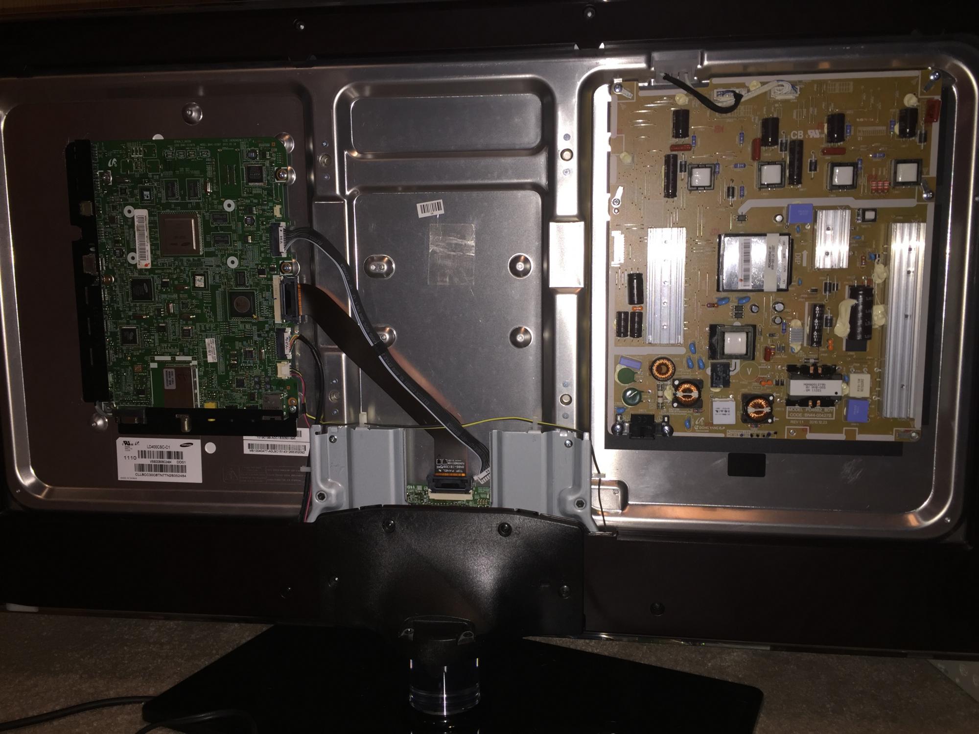

I have worked on one of these before. The A side voltages were good and the B side would cycle. It was P.S cyling due to a bad LED backlighting strip. Opened set and jumpered out 4 LED one on each of the 4 channels on the Right side bank. The P.S. senses the open circuit and shuts down but keeps trying to restart. I jumperd the LEDs and the set had a few dim spots but worked.
