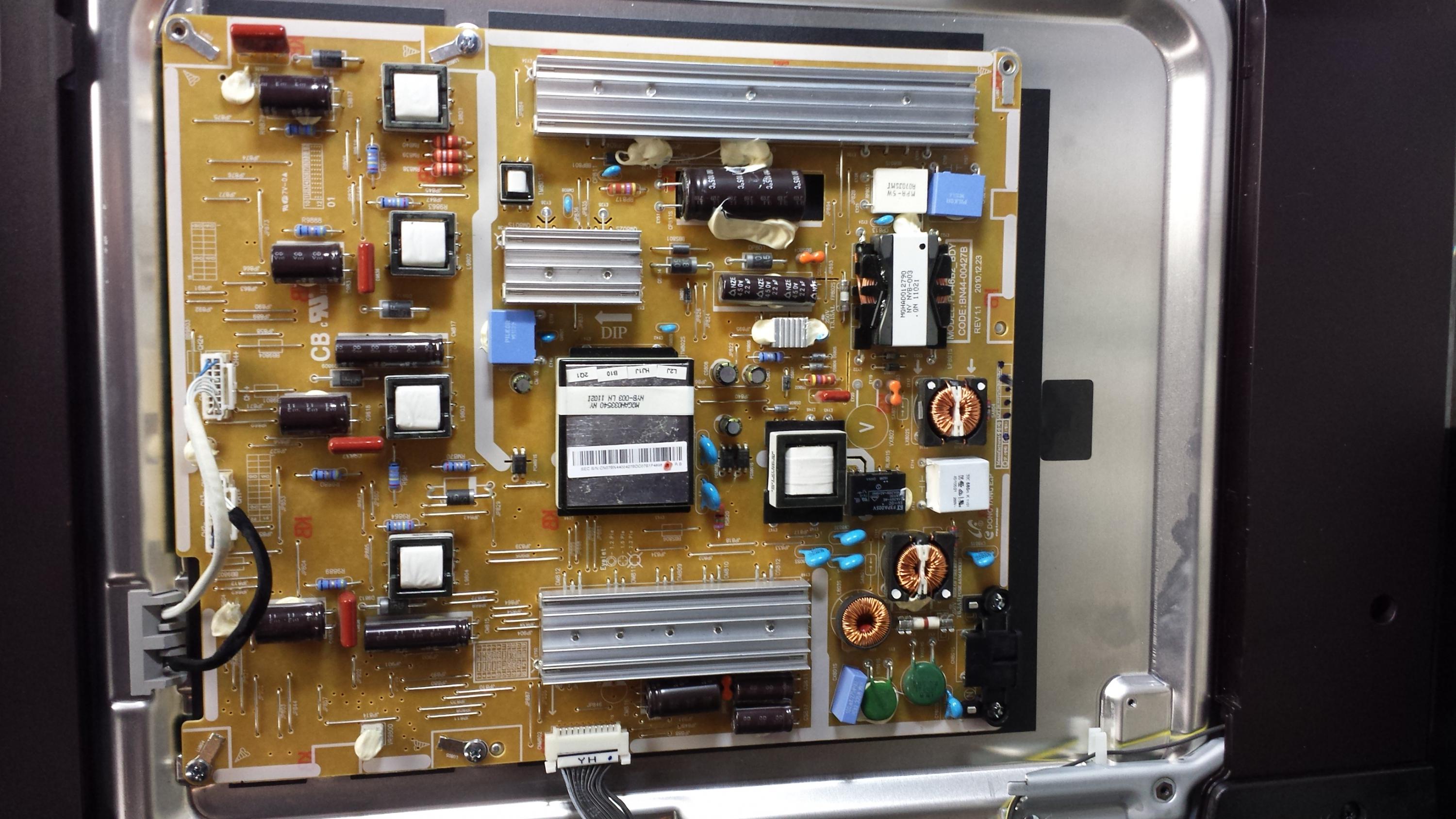

    My Samsung UN40D6400UFXZA Power Cycles (click on and off) you can just see the smart TV logo show then turns off, TV Keeps cycling
    Power Board PD46b2_BDY Code: BN44-00427B
    HELP!!

    No bulging capacitors

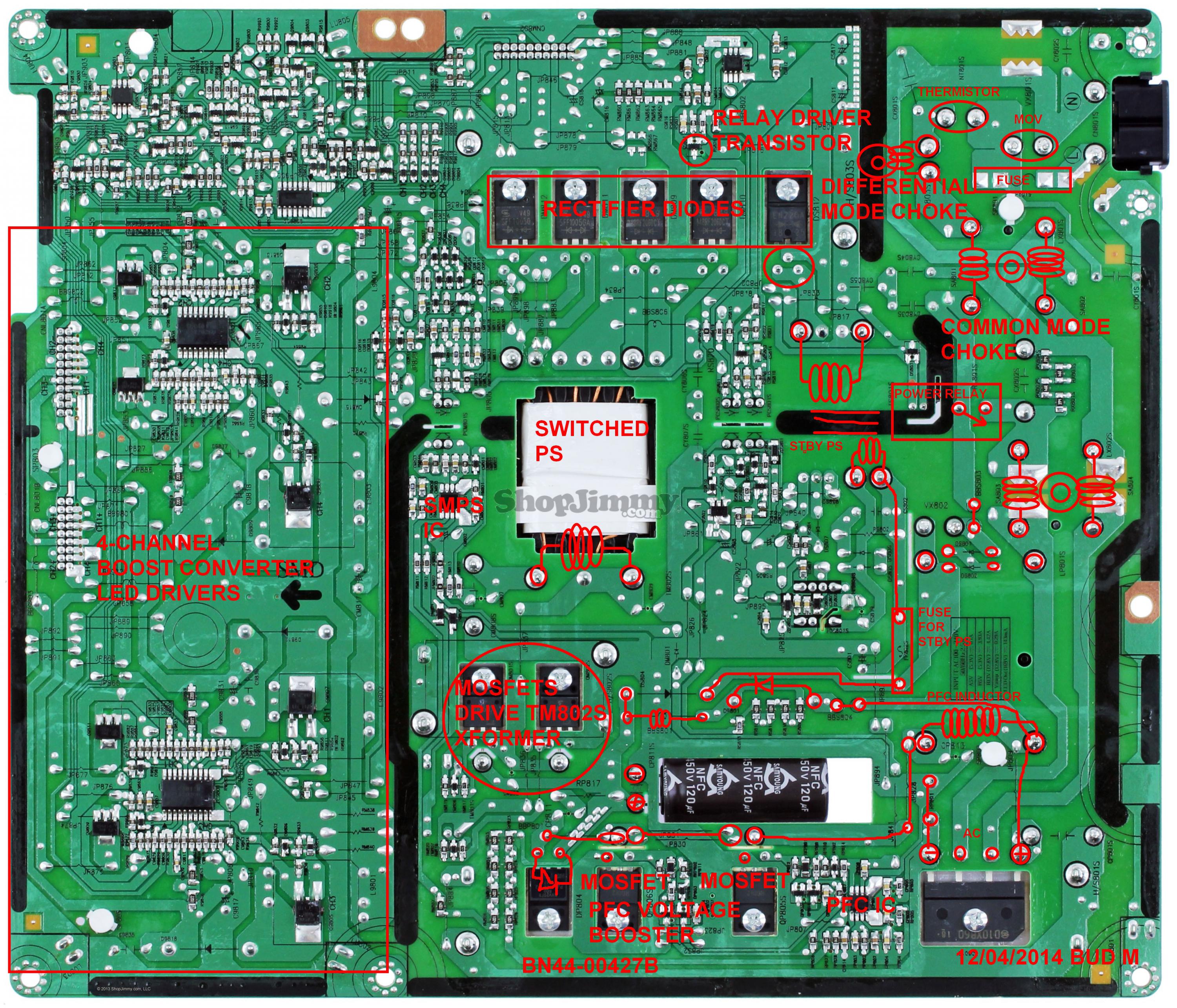

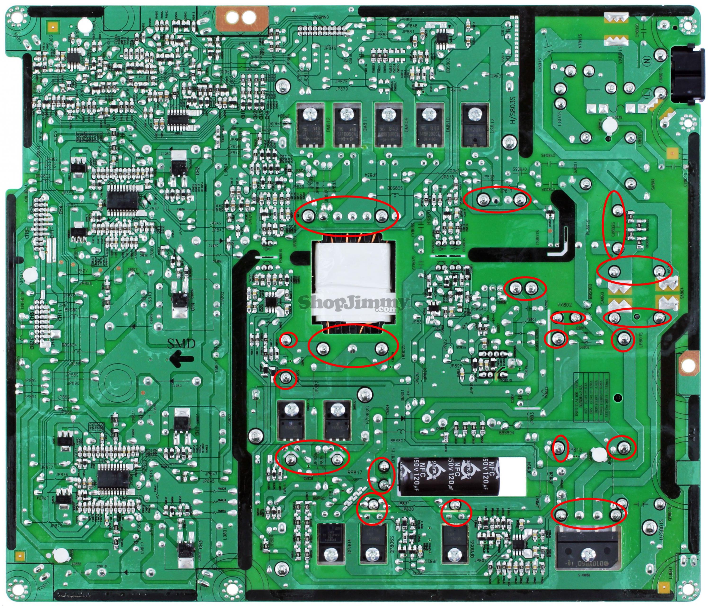

                          Did you check the solder joints on the bottom side of the board? see the red circles in the picture.
                          I also marked the bottom side of the board to show the function of each section of the board based from what I can see from the picture provided by shopjimmy.

                              Did you check the solder joints on the bottom side of the board? see the red circles in the picture.-- Yes Re-Soldered All

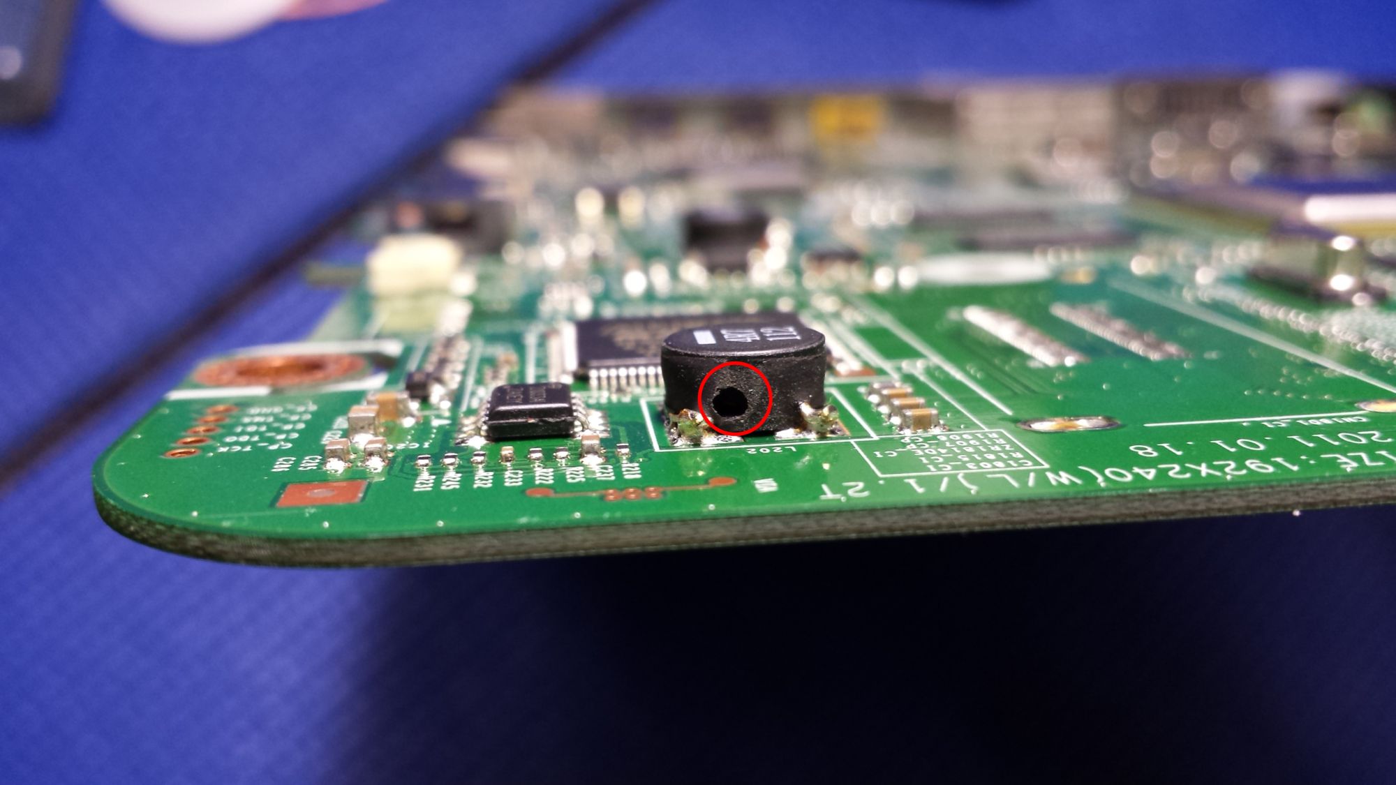

                              I found this on the main board
                              1) what is it
                              2) is it bad (does not look good to me)

                                That is the small inductor with a hole on the shrink tubing, it does not look burnt out.
