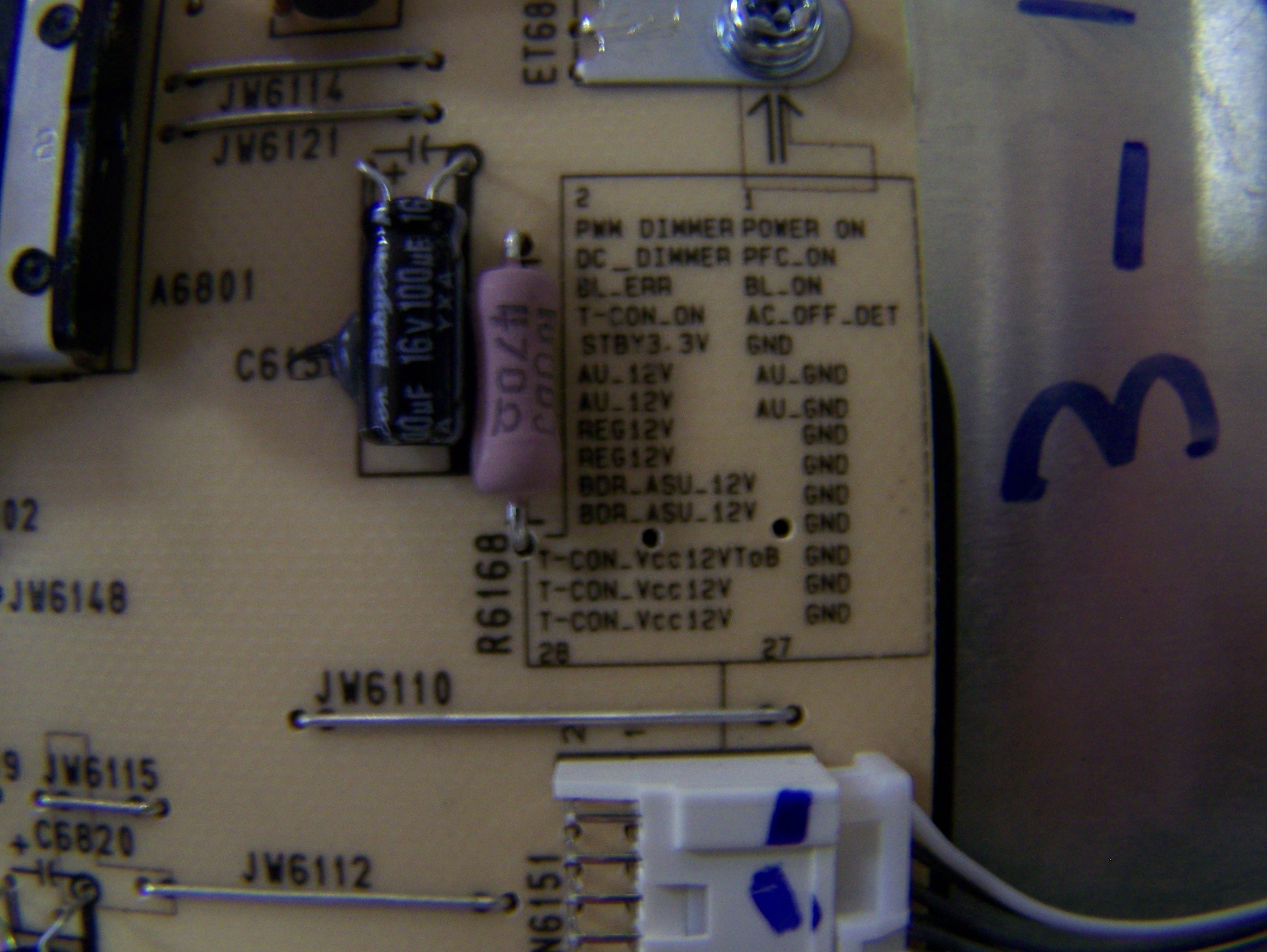

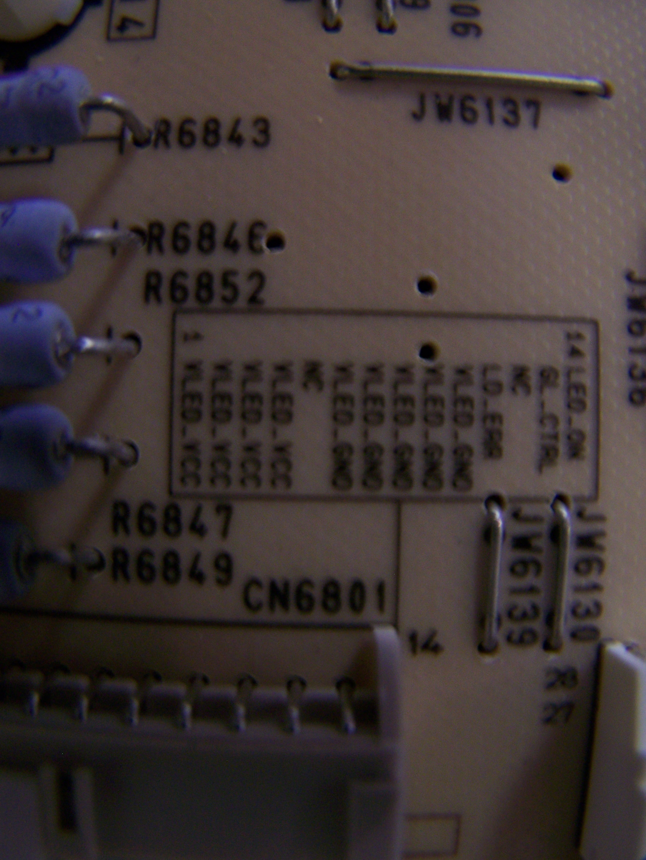

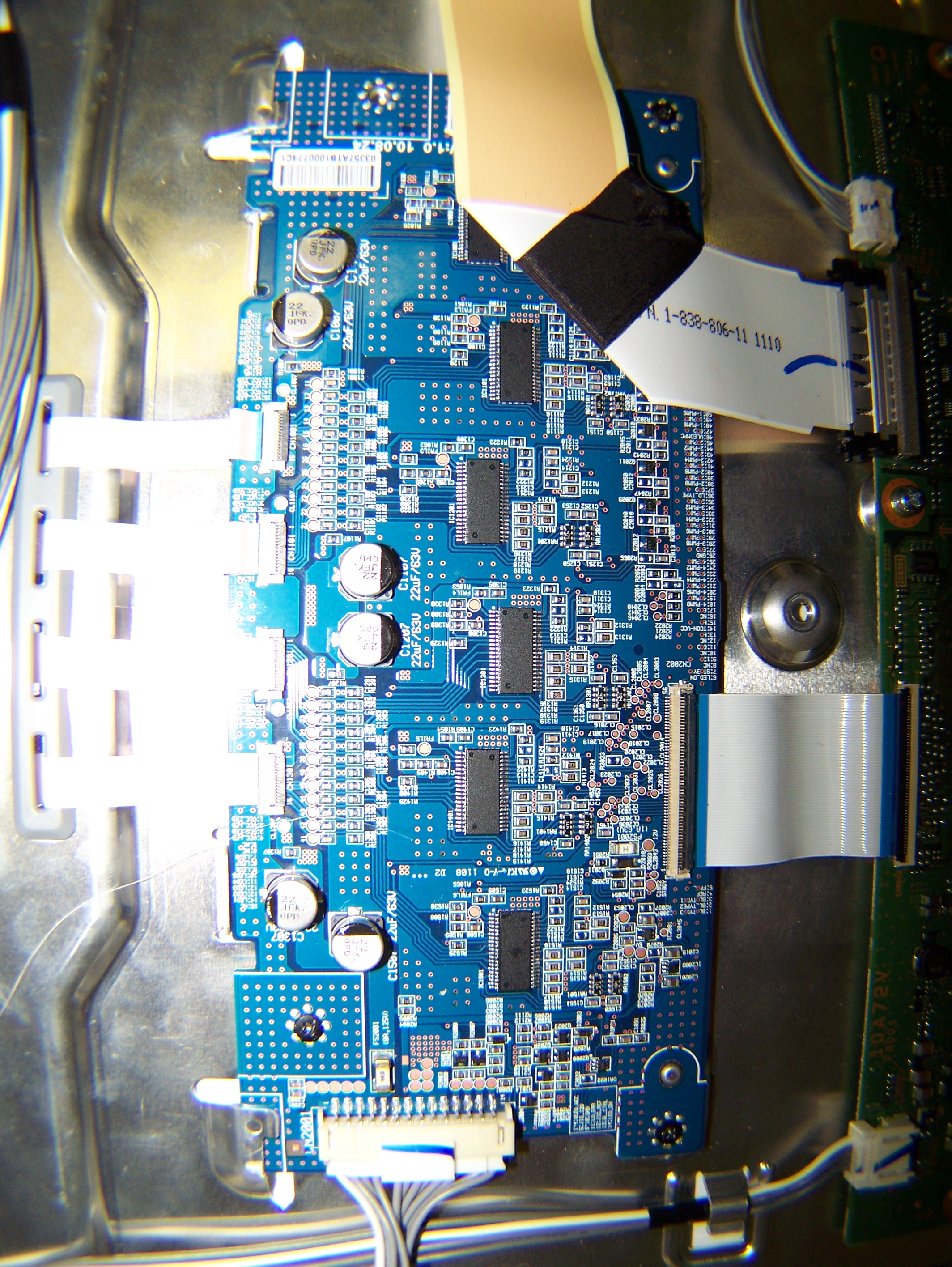

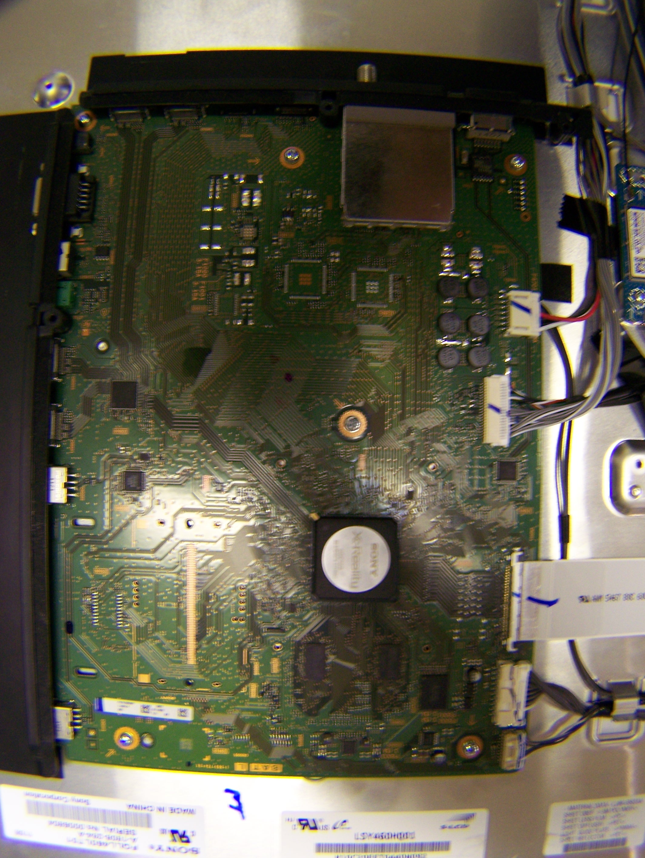

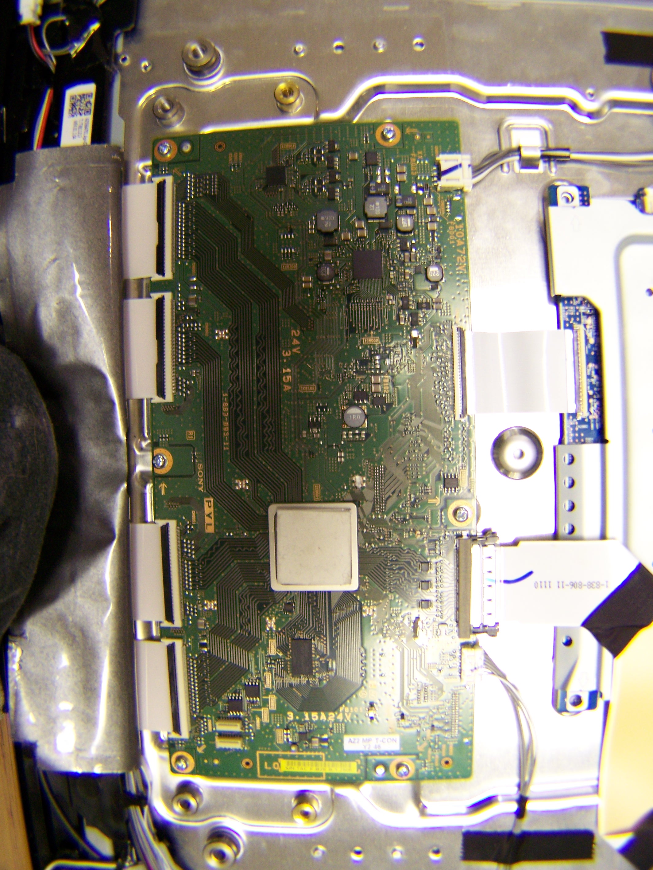

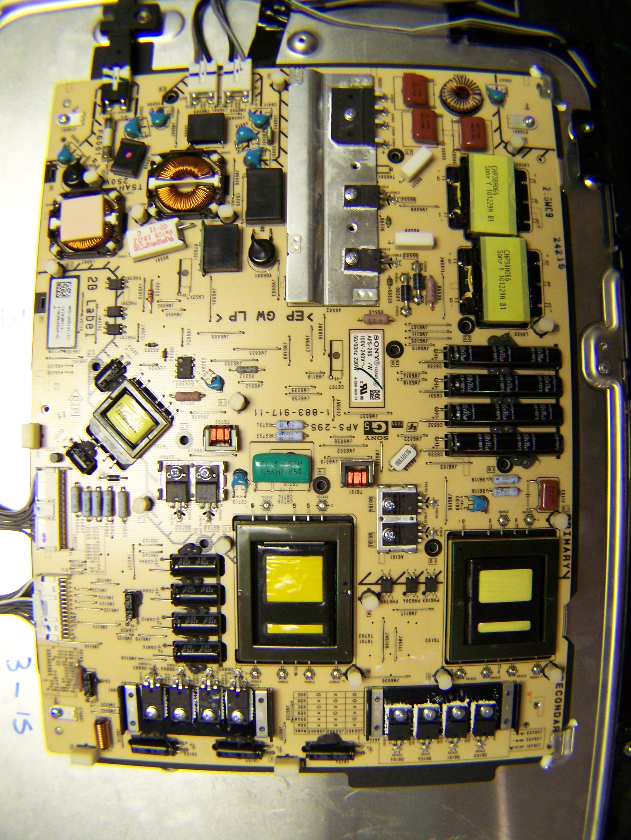

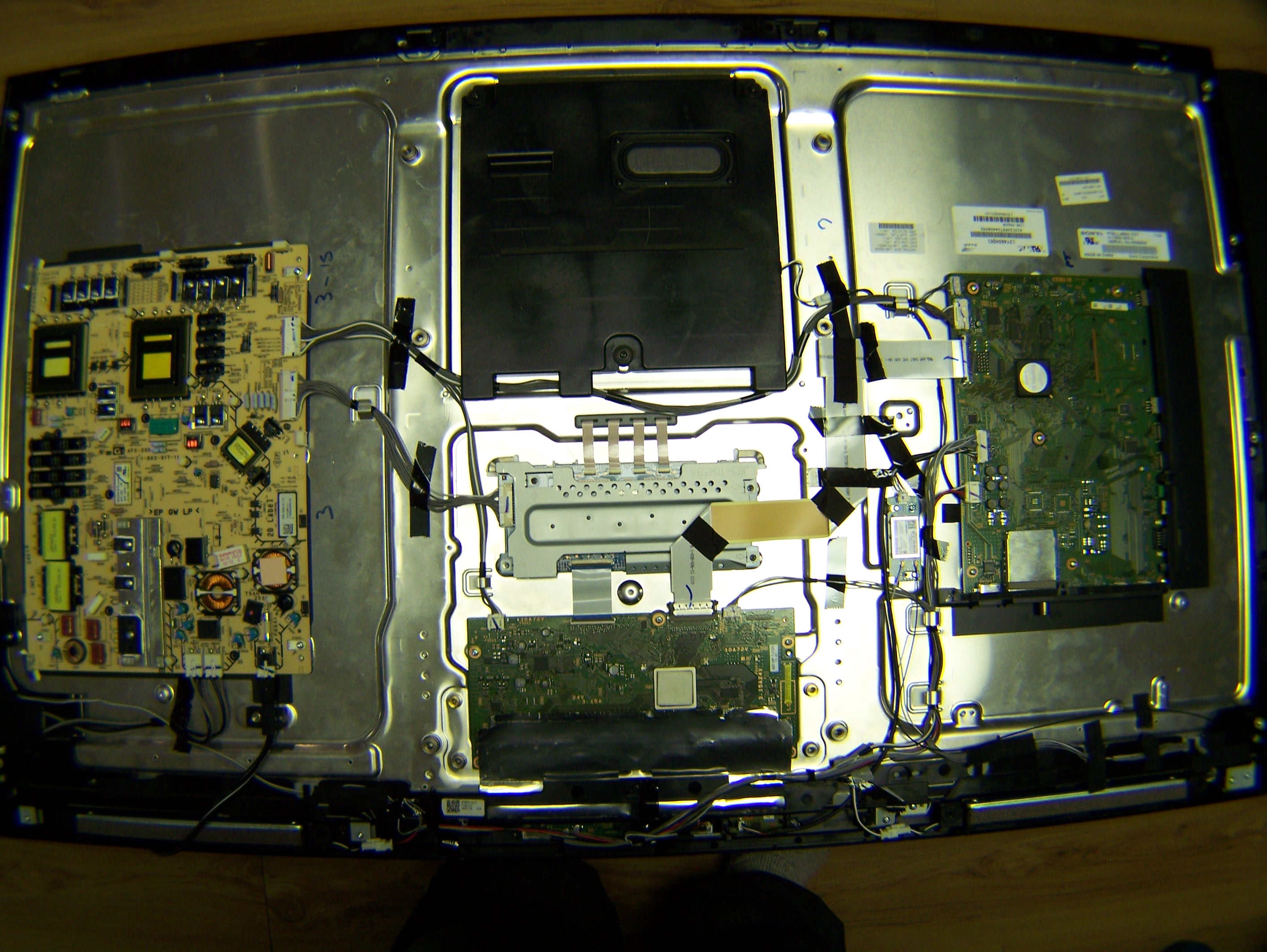

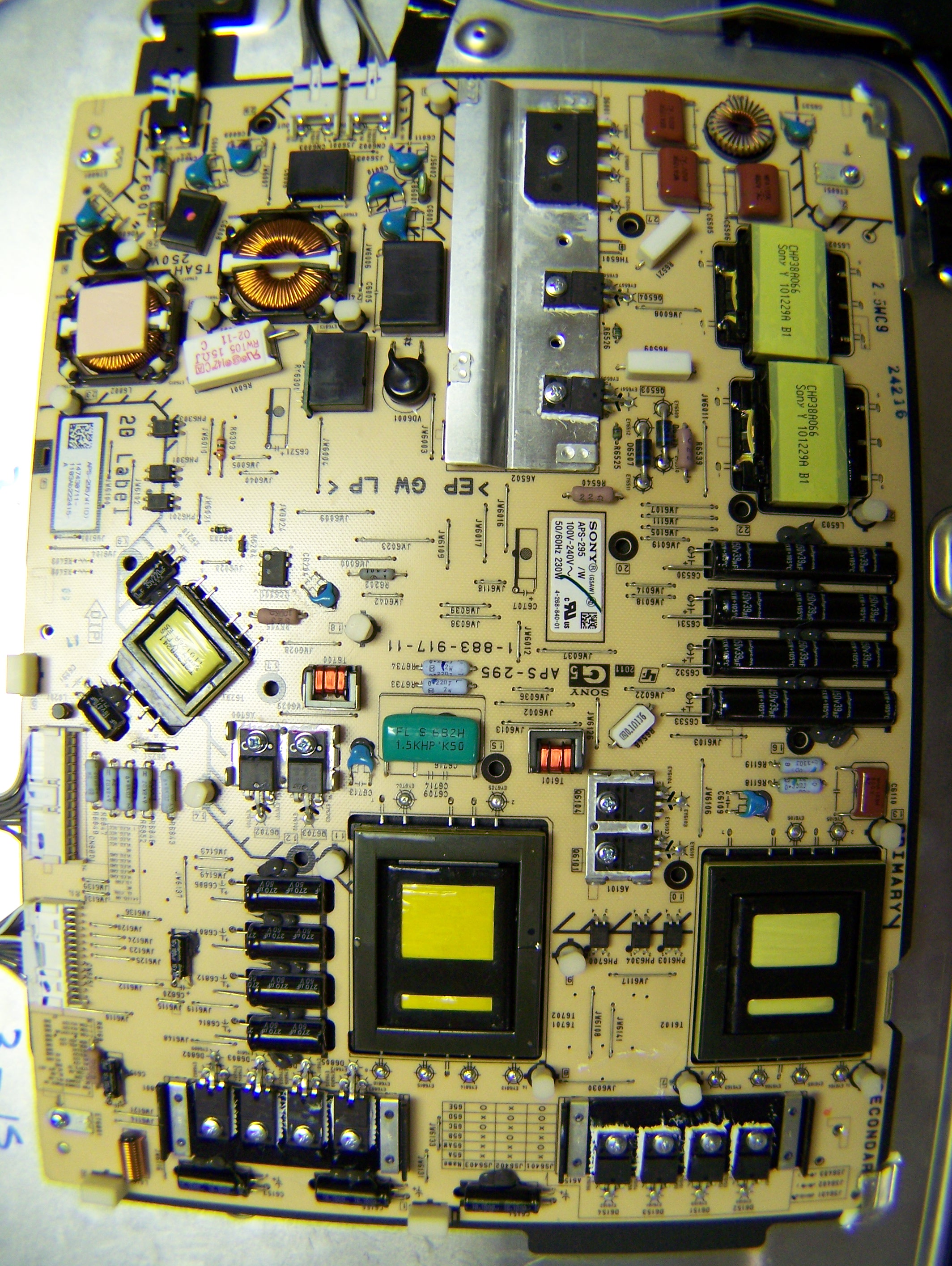

          finally got a few pics of the chassis and boards.Did a voltage test with power on
          pww dimmer o volts
          DC dimmer 0
          bl error 0
          t con on 0
          stby 3.3
          au 12v 12.4
          au 12v 12.4
          reg 12v 12.4
          reg 12v 12.4
          bdr 12v 12.4
          bdr 12v 12.4
          t con 0
          tcon 0
          tcon 0
          other connector to led driver board
          led err .6 volts
          rest are o volts

            Re: Sony Bravia KDL 46hx820 6 blinks
            That backlight board is a known issue. Repaired a 55 inch version some time ago.

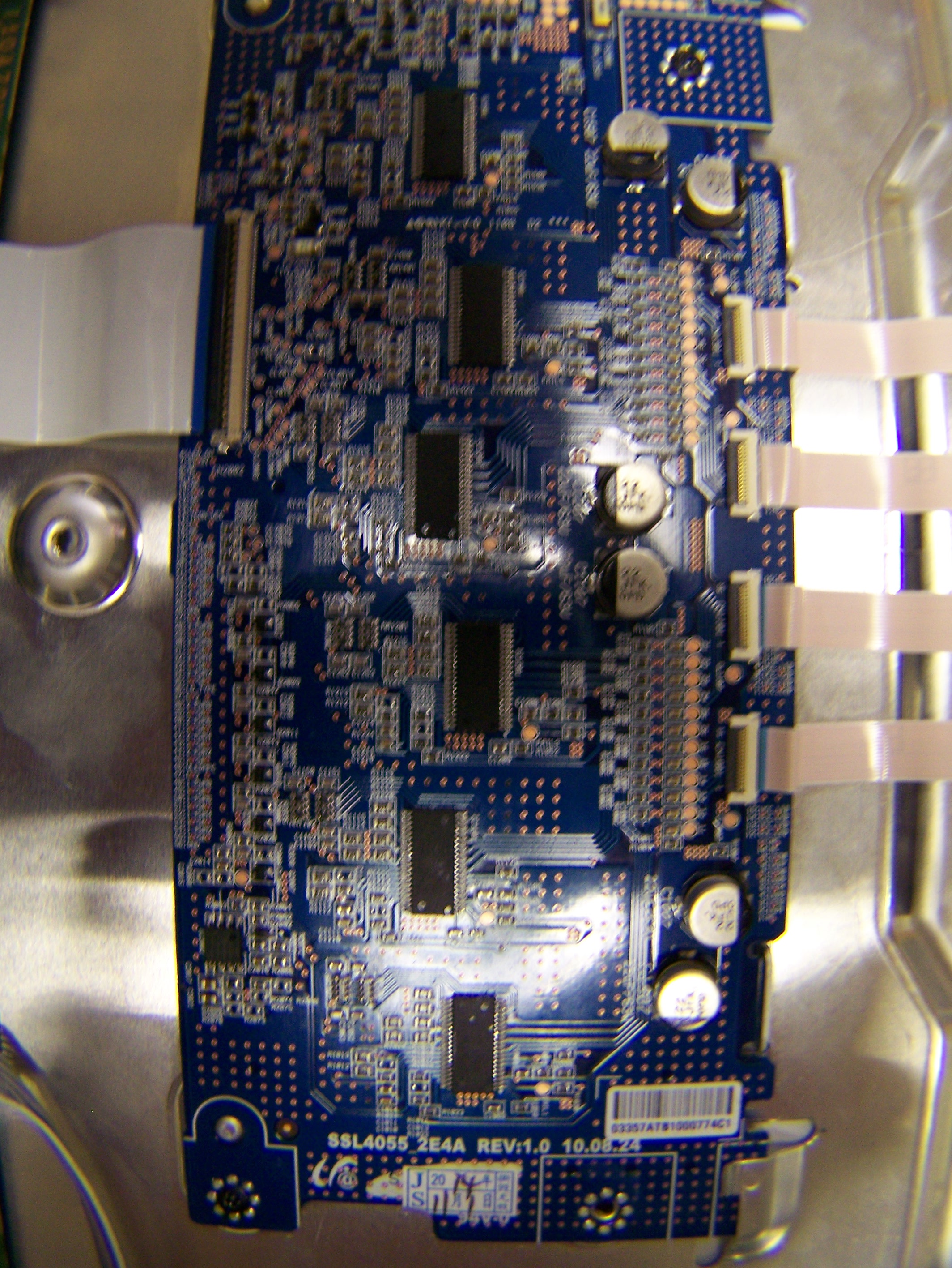

              any way of testing that board?Do you mean the blue board in the middle . Driver board.
                I have repaired a 46" 720 and I have it in my living room.
                There are some test points at each IC. You can compare between them and if do you see one different then the others, replace that IC, or the board. Mine it was ~$58 shipped from shopjimmy.
                    Each IC, has a Fail #1,2..6 test point. Measure those points and see if there is any difference between them.
                    I'm not an expert, to tell you if those voltages are good, but they seem like it.
                    Since there is an issue with the backlight, some voltages are not turning on. Those look like are for turning on the screen.

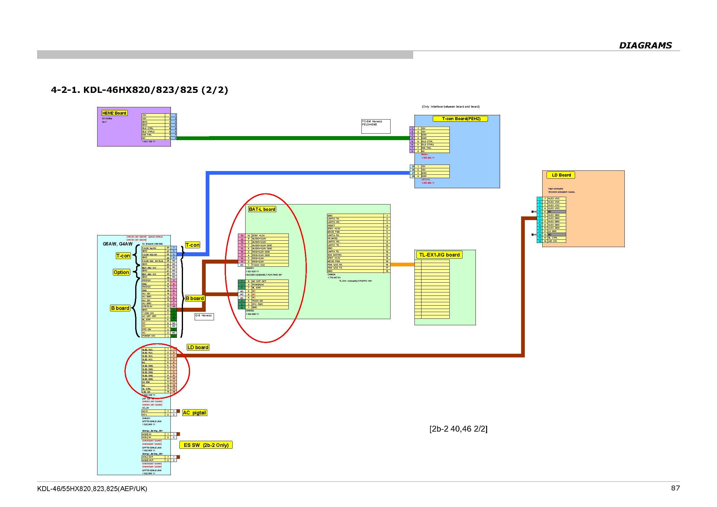

                        Did you download the service info?
                        http://elektrotanya.com/?q=showresul...oria=&kat2=all
                                No. If the power supply is not fully enabled there will be no mainboard power. and yes with that half the power supply will be dead.do this I remember my LVDS cable being loose on the mainboard. its a real tricky connection if I recall I was getting a 4 blink error because the ribbon was not fully seated into the connector that attaches to the main board that goes to the T CON. I would be especially concerned with it if somebody else has been into it before like mine
                                    Did you see page 87 and check the voltages on the connectors?
                                    • waybel
                                      • Nov 2014
                                      • 65
                                      • canada
                                      pww dimmer o volts
                                      DC dimmer 0
                                      bl error 0
                                      t con on 0
                                      stby 3.3
                                      au 12v 12.4
                                      au 12v 12.4
                                      reg 12v 12.4
                                      reg 12v 12.4
                                      bdr 12v 12.4
                                      bdr 12v 12.4
                                      t con 0
                                      tcon 0
                                      tcon 0
                                      led err .6 volts
                                      rest are o volts
                                        I circled 3 connectors, I do not see CN6002 (9 PINS), CN6001 (10 PINS)
                                        Where are the PFC POWER, POWER ON, AC OFF DET?
                                        Unless your board does not match the names of the pin as shown in page 87.
